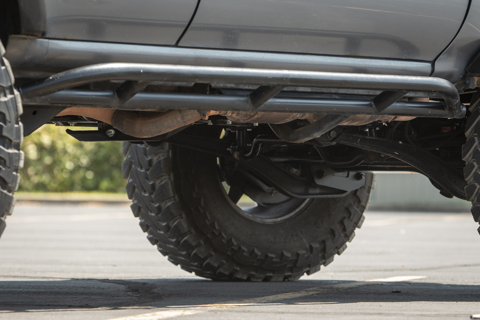

I am using the 67" slider from Trail Gear. They are designed for a 4 door Tacoma but if you're welding to the frame then these work great. I've beat the snot out of them and they are still straight and dent free. Only thing you need to know if you go this route is that the frame tapers toward the front on an 80 more than it does on the Tacoma so the front-most leg that comes with the sliders is too short and you'll have to come up with your own. Tough to beat the price if you can weld.
