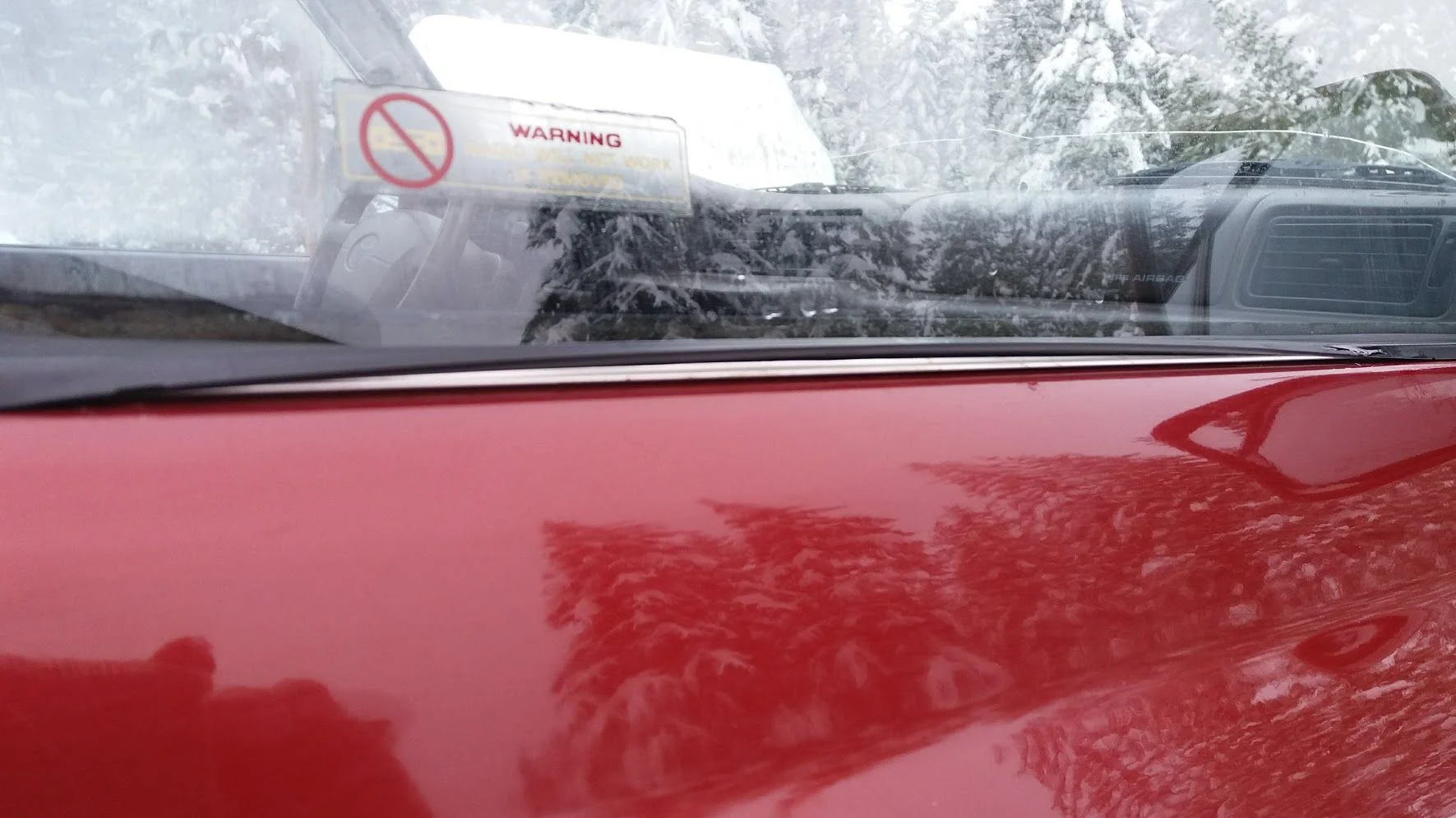

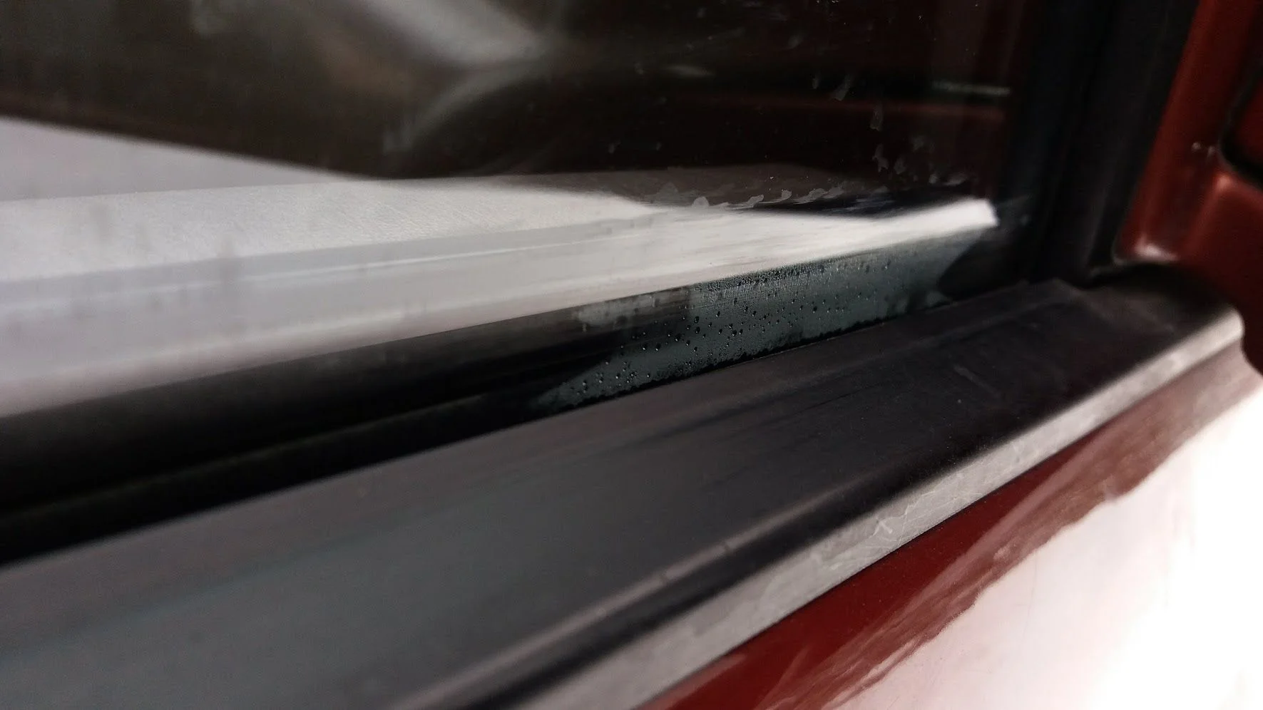

Yep snow everywhere and it is doing great in the snow. Downshifting did not effect sound at all (I suppose that is a good thing). I tried the open passenger window slightly trick and it did reduce volume. It does seem like it could be the passenger window but in this case the passenger window was not effected by vent positions. Also hard to tell given everything is half frozen but passenger window looks like it has some very slight condensation going on along base of window (drivers side is bone dry) not sure if that could be related to sound.
