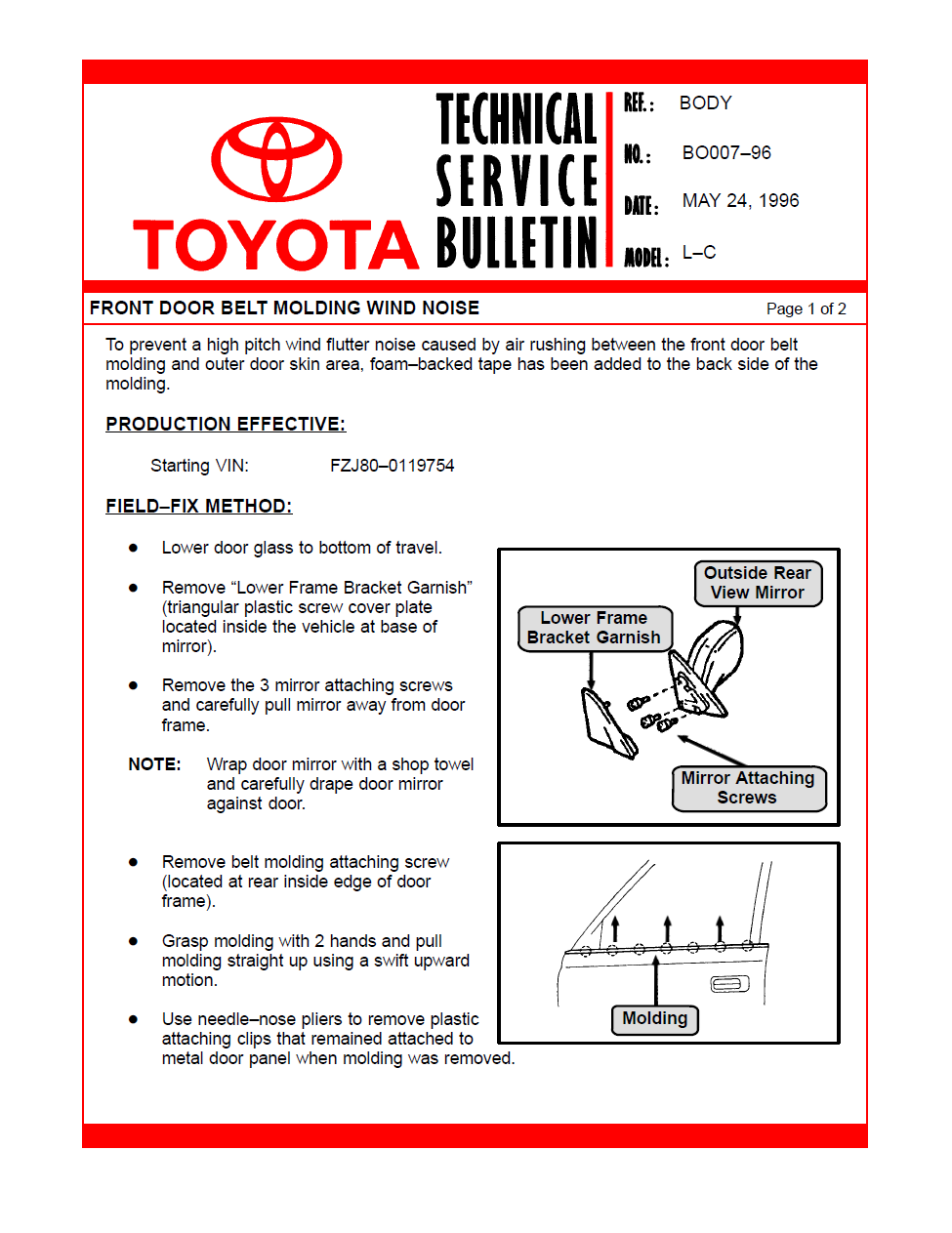

I came across this TSB in my files:
Sure enough - taped that lifted piece on PSD and sound is gone. Actually, on this LC those pieces are cracked on each of the 4 front windows. Anyone know where to replacements for those?
