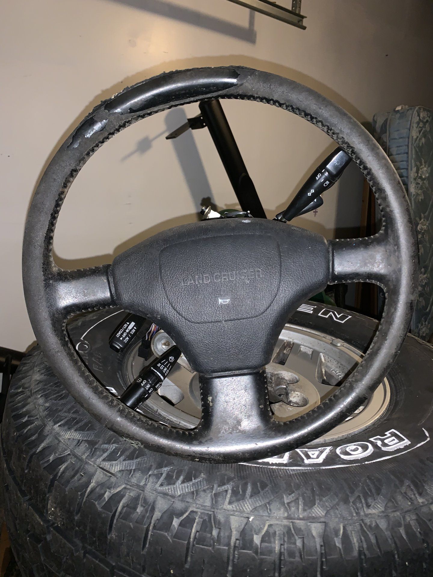

Got this guy to run hopefully it’ll bolt up. The wheel not the entire column..
