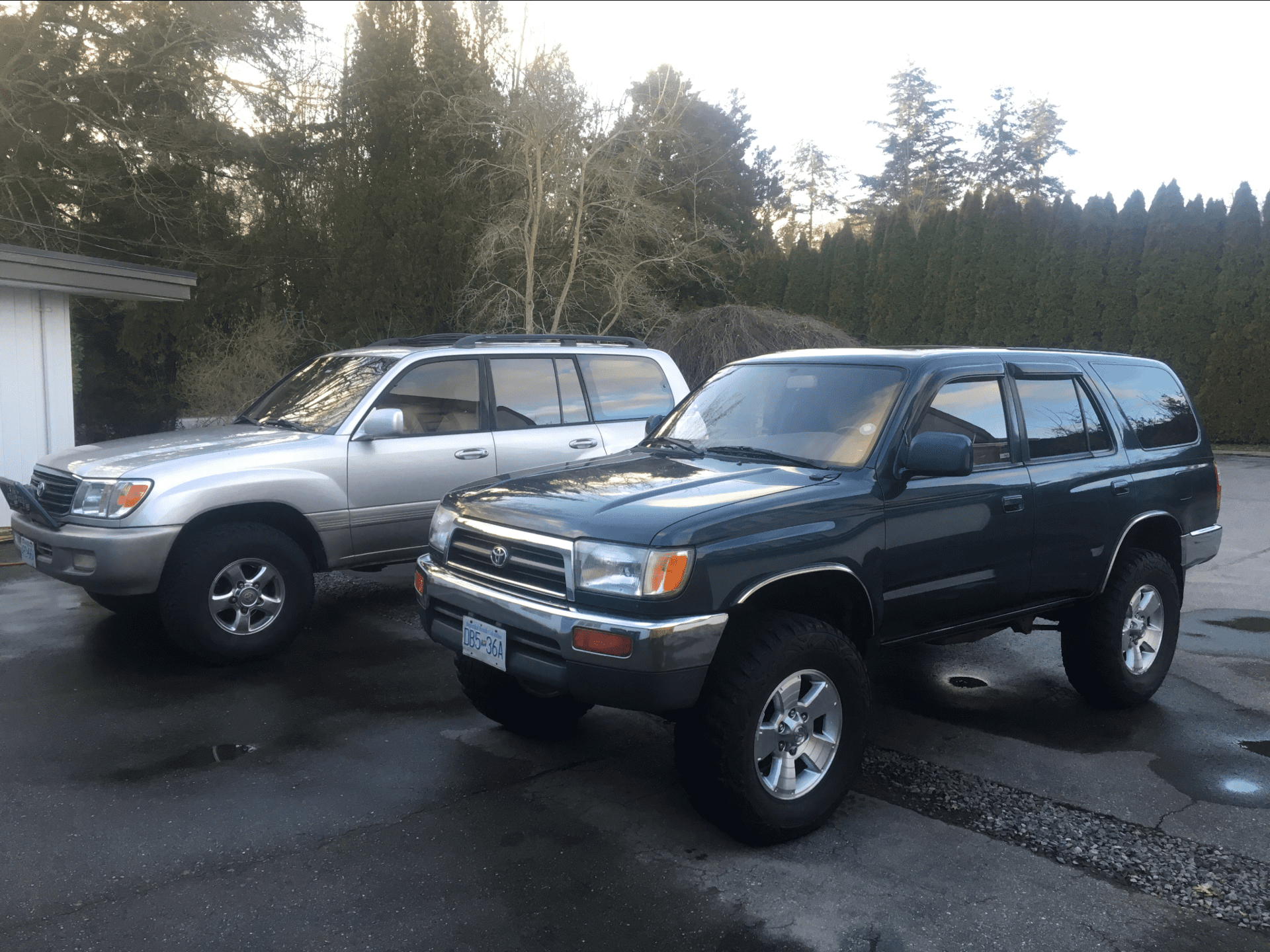

I wanted a convertible so that led me to the only and obvious choice. I have a 100 series so the 4 door box is ticked. If I were buying a 4Runner to daily or build for adventure travel, it would be a 3rd Gen 100%. I bought a locked 3rd Gen for super cheap (it needed a rad and the seller thought it might have a bad head, but nope). I put a basic lift in it, scored some MTs on Taco wheels off CL for super cheap, and had a great little rig for under $3000. The wife hated the color, so I sold it for $6000 and eventually bought my 1st Gen. pic of it and the 100 below just because we all like pics...
