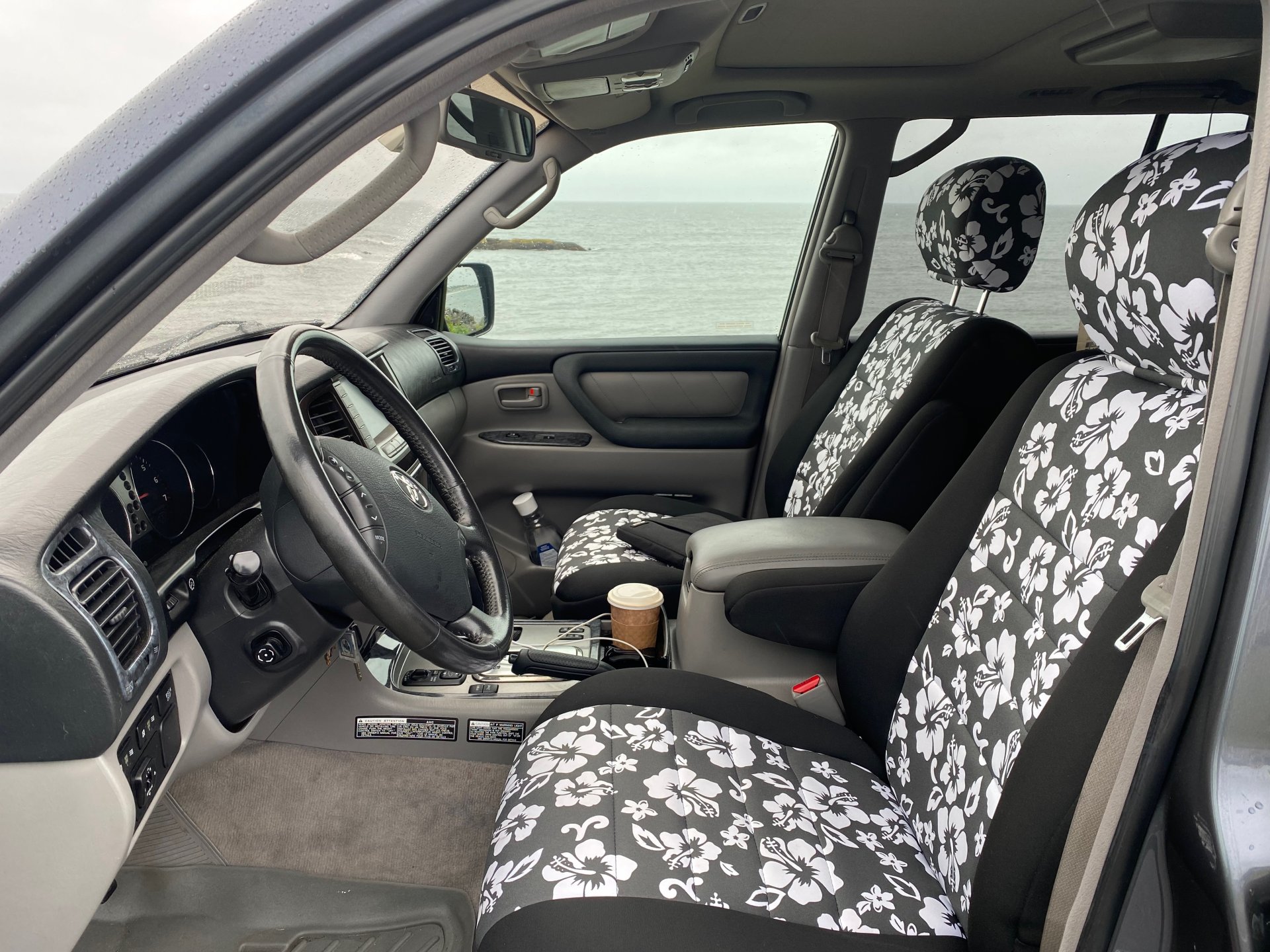

  • Seat covers: Wet Okole neoprene covers

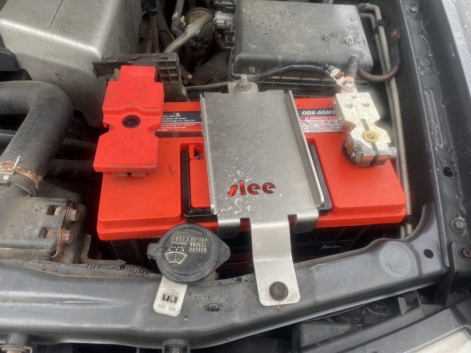

  • Battery replacement: Upgrade size to Odyssey Extreme Group 31 (ODX-AGM31A) with Slee Main Battery tray -> Completed Sep22

Battery: The battery was at the end of its life. I decided it was a good time to upgrade to a group 31 Odyssey battery using the Slee kit. I also upgraded the old ground cable. The hood does sit a tad higher. Not ideal, but it doesn’t bother me.

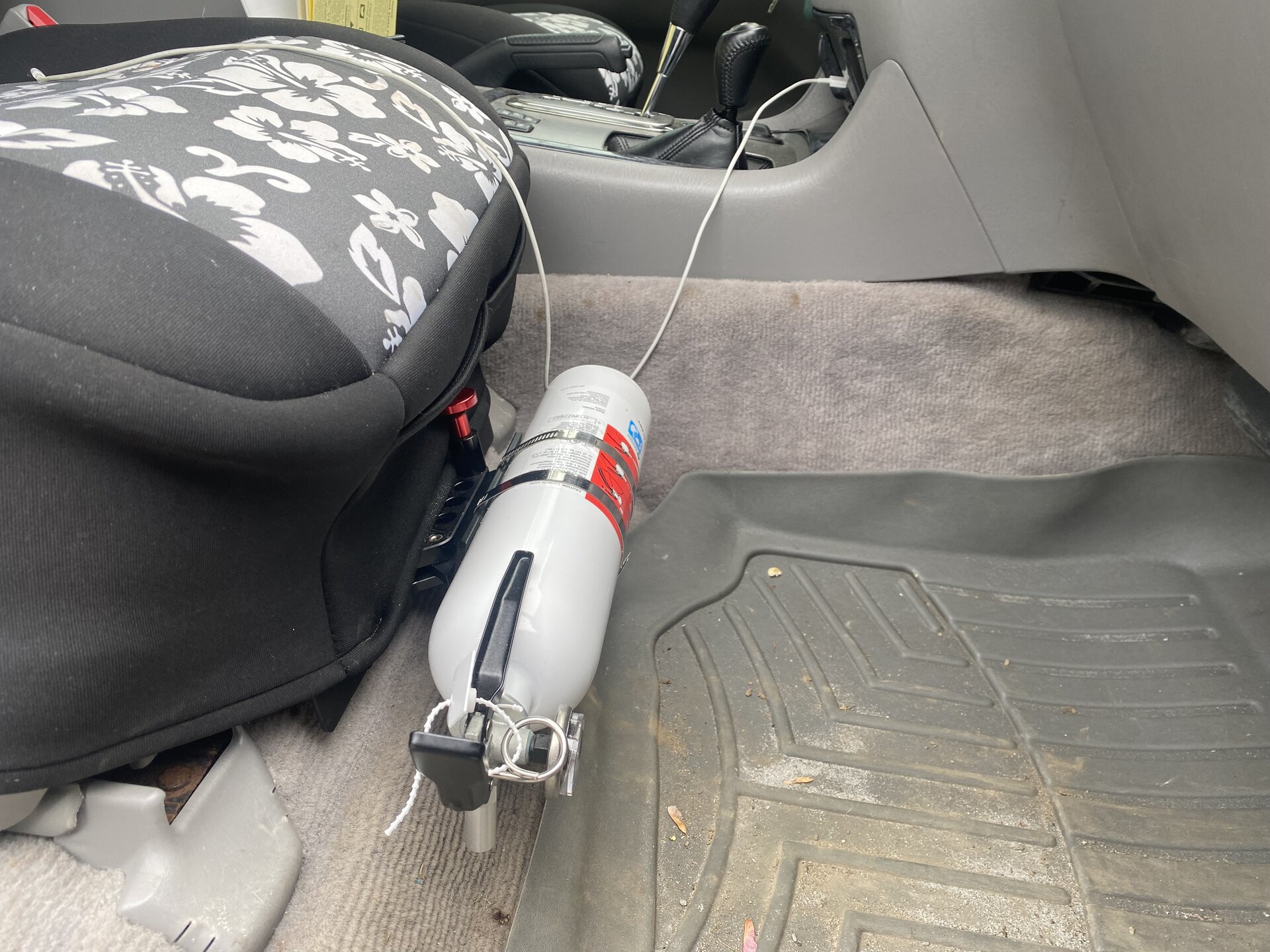

Fire extinguisher mount: I installed a fire extinguisher mount (Cruiser Garage accessory mount) and extinguisher at the feet of the front passenger seat. I’m not a fan of this location. It is accessible but interferes too much with passenger comfort. Often the extinguisher is removed for passenger comfort. It works, but I would like to find a better location for the extinguisher.

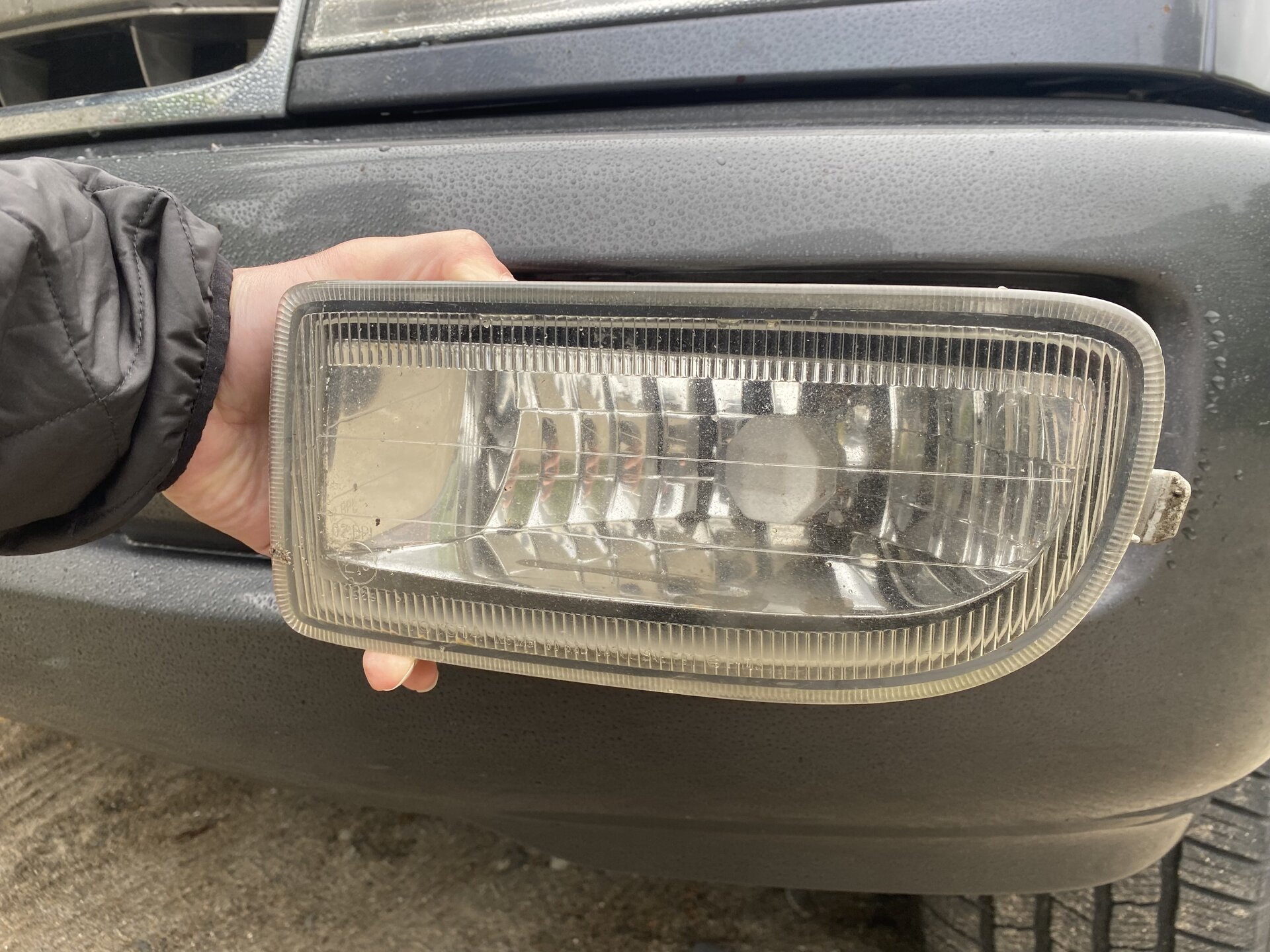

Fog lights: The fog light housings were leaking water at the lens seal. OEM was expensive, so replaced the housings with aftermarket (to pass inspection). The OEM housings are noticeably higher quality and are nicer since the bulbs are reflected within the housing.
Old:
New:
Put one drop of dawn dish soap in your OEM fogs, and fill them 50% with water and put an old blown bulb in them, shake quite hard and let sit for 10 minutes and repeat until they are clear again. Once they are clear (or much, much better) run some demineralized water through them and let them sit and dry. The demineralized water does not leave water spots as it air dries. I did that with my headlights a few times when they filled with mud, worked perfectly every time. Run a nice little bead of silicone around the outside of the lens and you will have nice looking OEM fogs again for under $20
This. This is the correct answer. Aftermarket/non-oems all seem to leak out of the box. Thanks :)

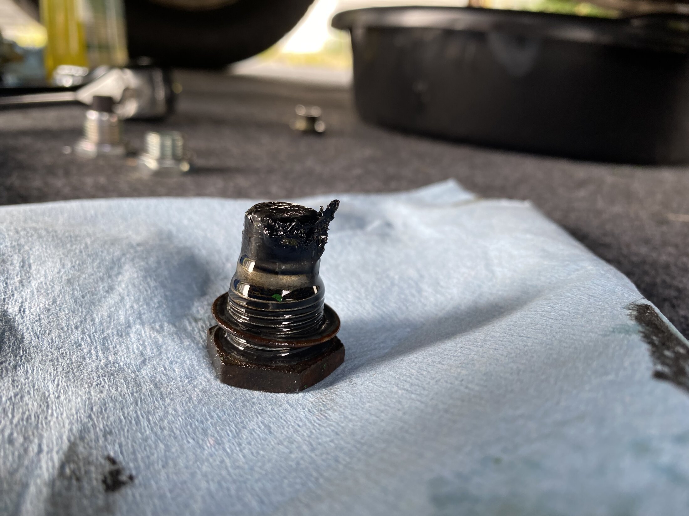

Rear diff drain plug picture: (Was told this was "normal" when I shared the pic with some mechanics)

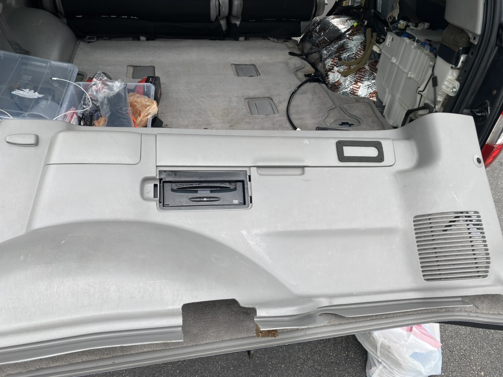

I ran the wiring from the battery along the driver side to firewall and carefully poked a small hole into the factory harness wiring grommet. Once inside the cab, the cable ran along the edge of floor by driver side doors and crossed to the passenger side under the rear seats then to the passenger quarter panel trim. I sleeved the wiring to have as clean of an install as possible. If I did it again, I probably would have done do an 8 gauge wire to an accessory fuse panel in the back.
I also and added disconnects within the wiring, so the trim panel can easily be removed from the vehicle by just disconnecting the wiring. Confirmed power at the end outlet (12.8V, vehicle sitting cold for 5 days). After testing connections, plugged the fridge in and let it sit overnight. Success! Fridge cooled from 55F to 28F quickly and stayed cold there overnight. I made my final install and cut the trim to mount the Blue Seas panel.
I’ve had the fridge installed for about 4 weeks. When the weather is cooler (50F to 70F), seems the battery has no problem cold starting after 48 hours, but after 72 hours or when its hotter, it cranks week and has a battery voltage below 12.6V. I would like a solar solution and/or a dual battery set up if I keep it installed full time.
Carpet cleaning and sound deadening:
While I was ripping the interior apart to install the fridge wiring, I decided to do a good cleaning of the interior. It wasn’t too dirty but it hasn’t had a good cleaning since it was brought into the family. I cleaned the trim panels, used a steam cleaner on the carpet and installed sound deadening to the rear cargo. I only sound deaden the cargo area up to the rear passenger floor. This was very much a “while you are there” project and I expect I will be doing an audio and door refresh next summer. Forgot to take pictures, but it it's noticeably cleaner inside.
