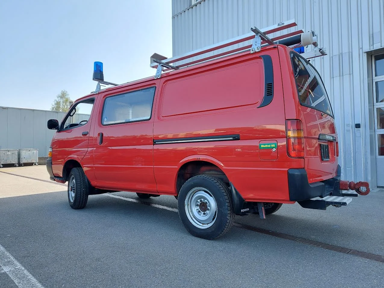

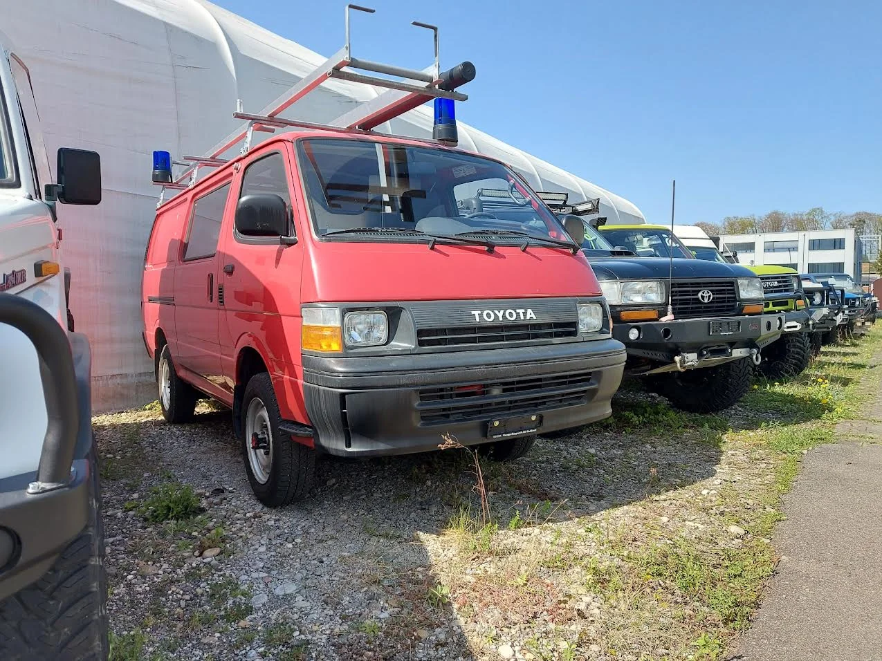

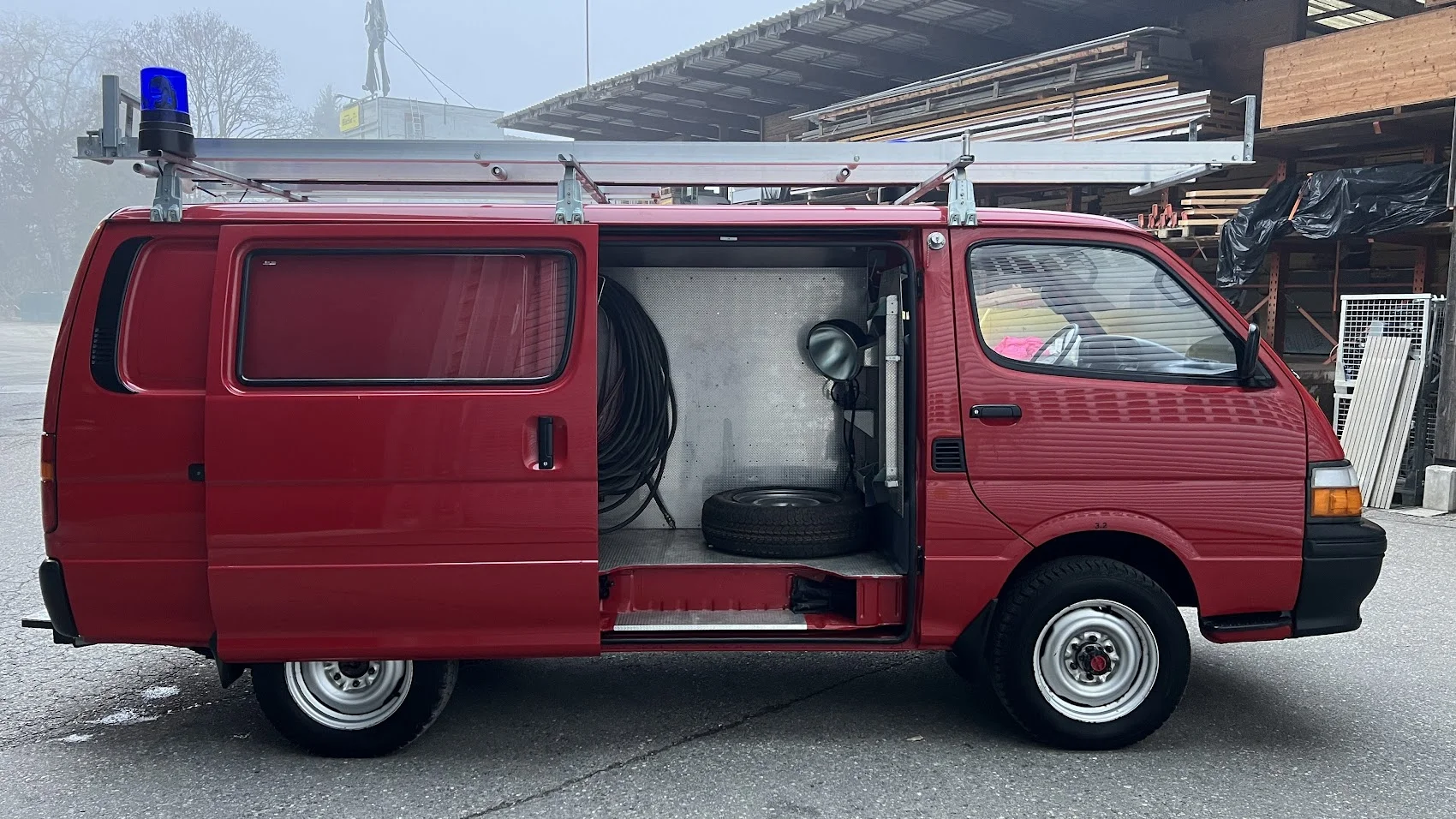

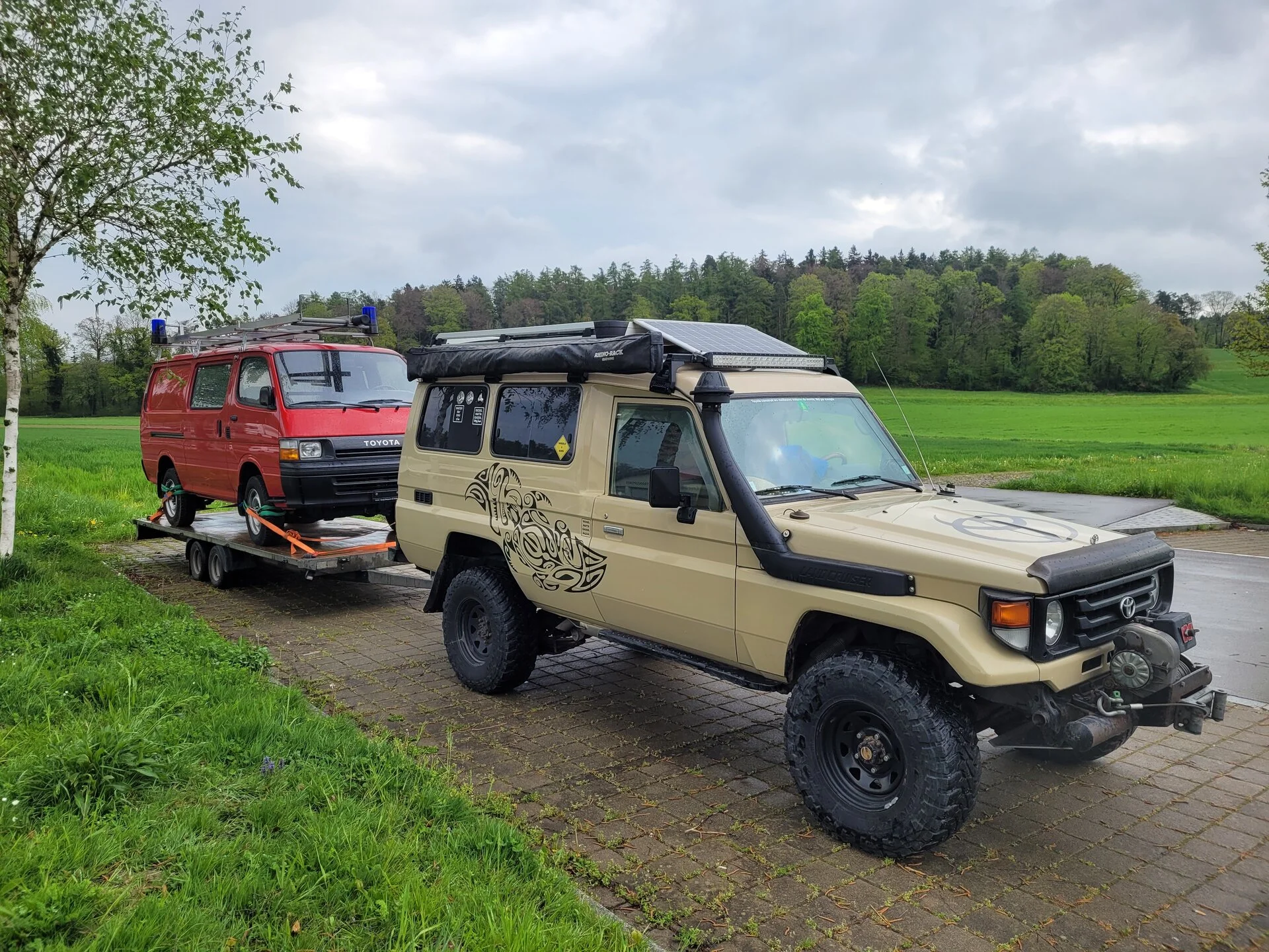

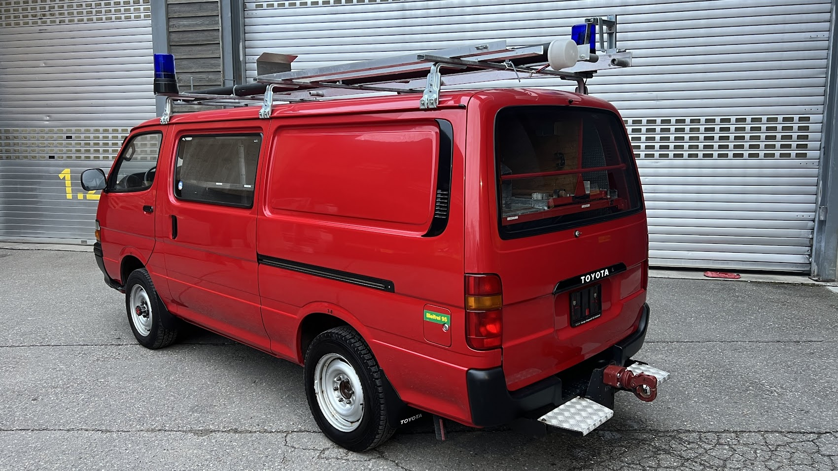

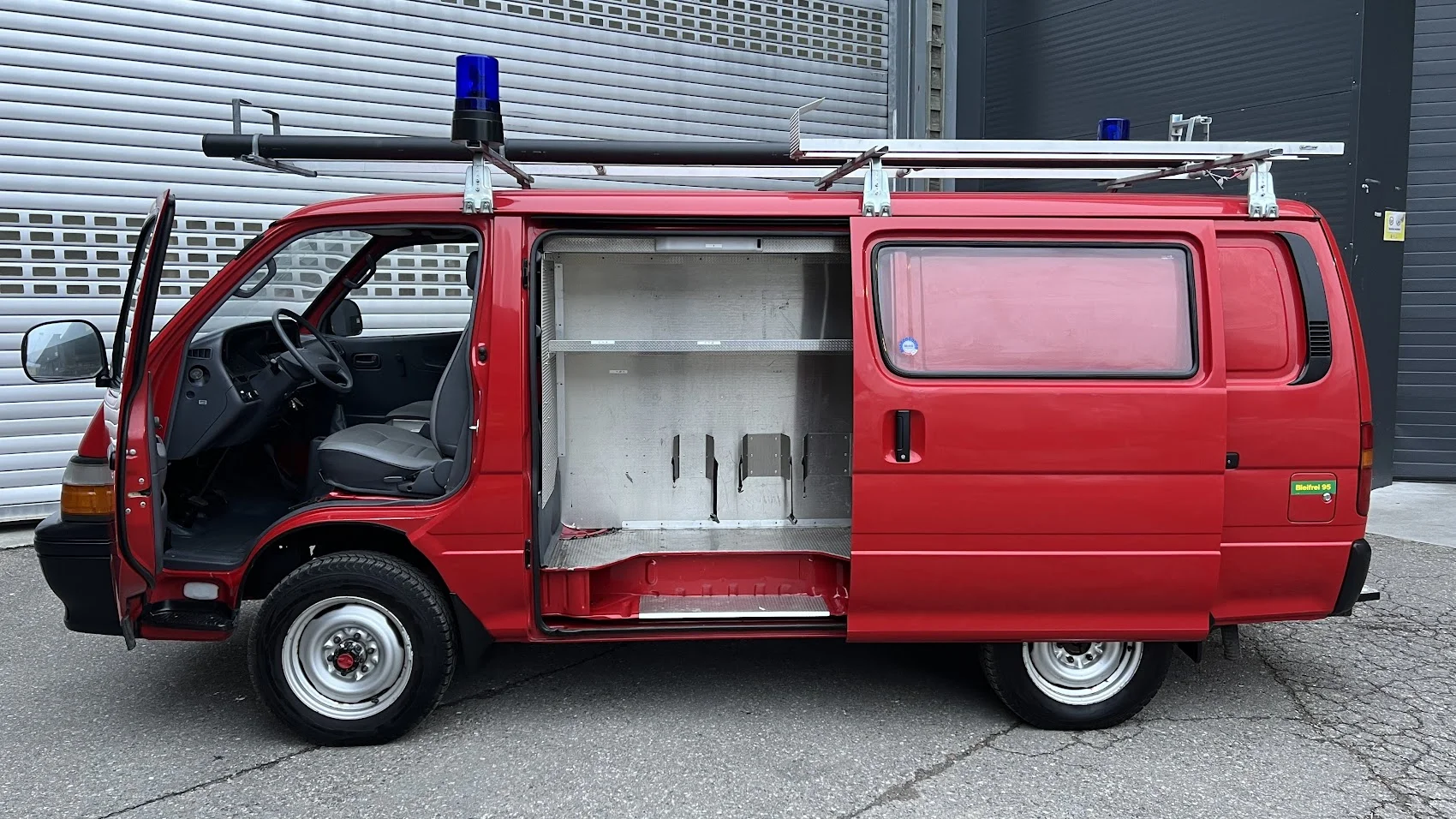

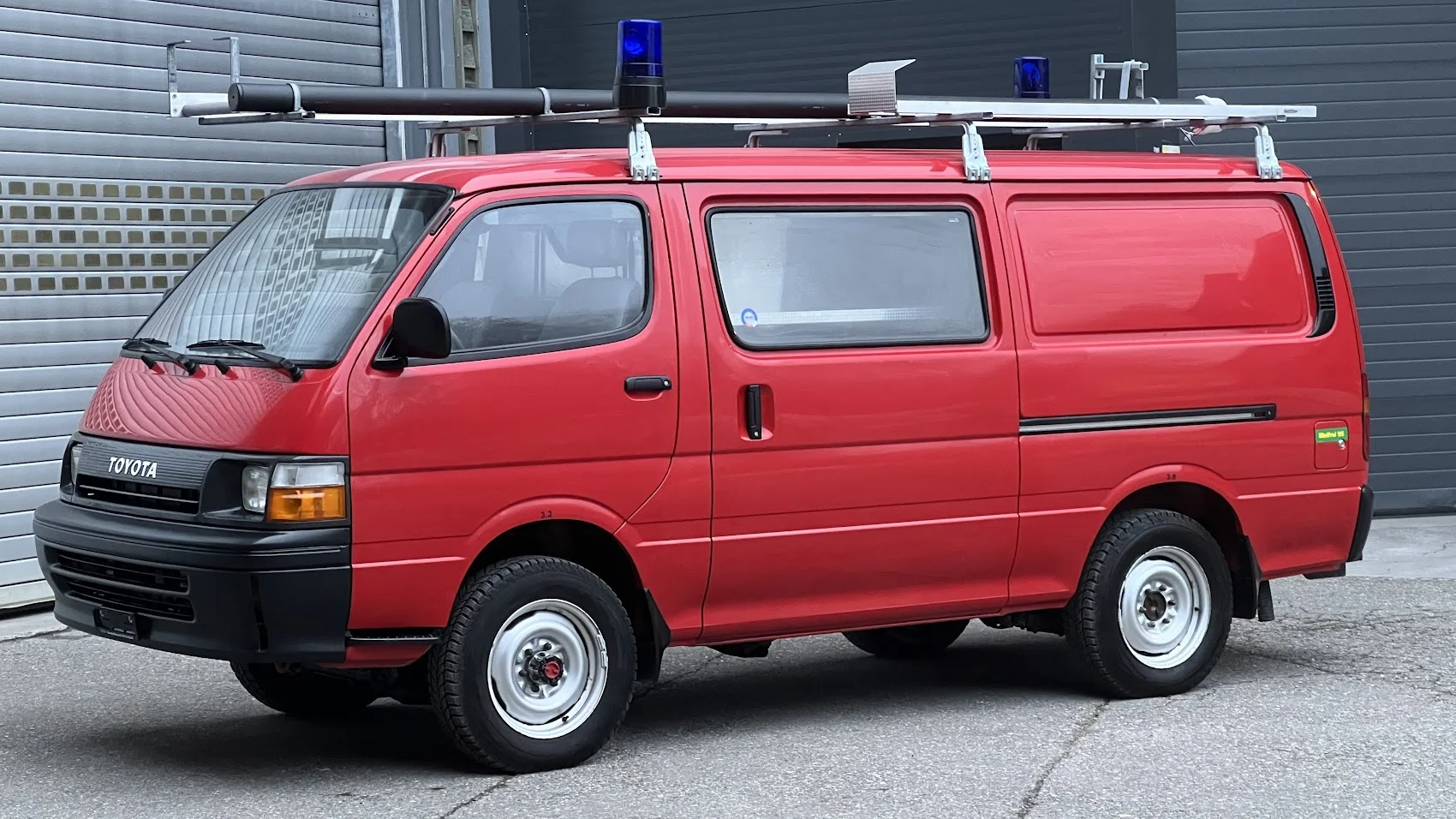

I found this Hiace in Switzerland, it's a 1992 model built in 12/91.
It's a cabover design so a very good usage of space.
It's a 4th generation Hiace (1989-2004, but in Europe they were replaced by the Granvia from 1996).

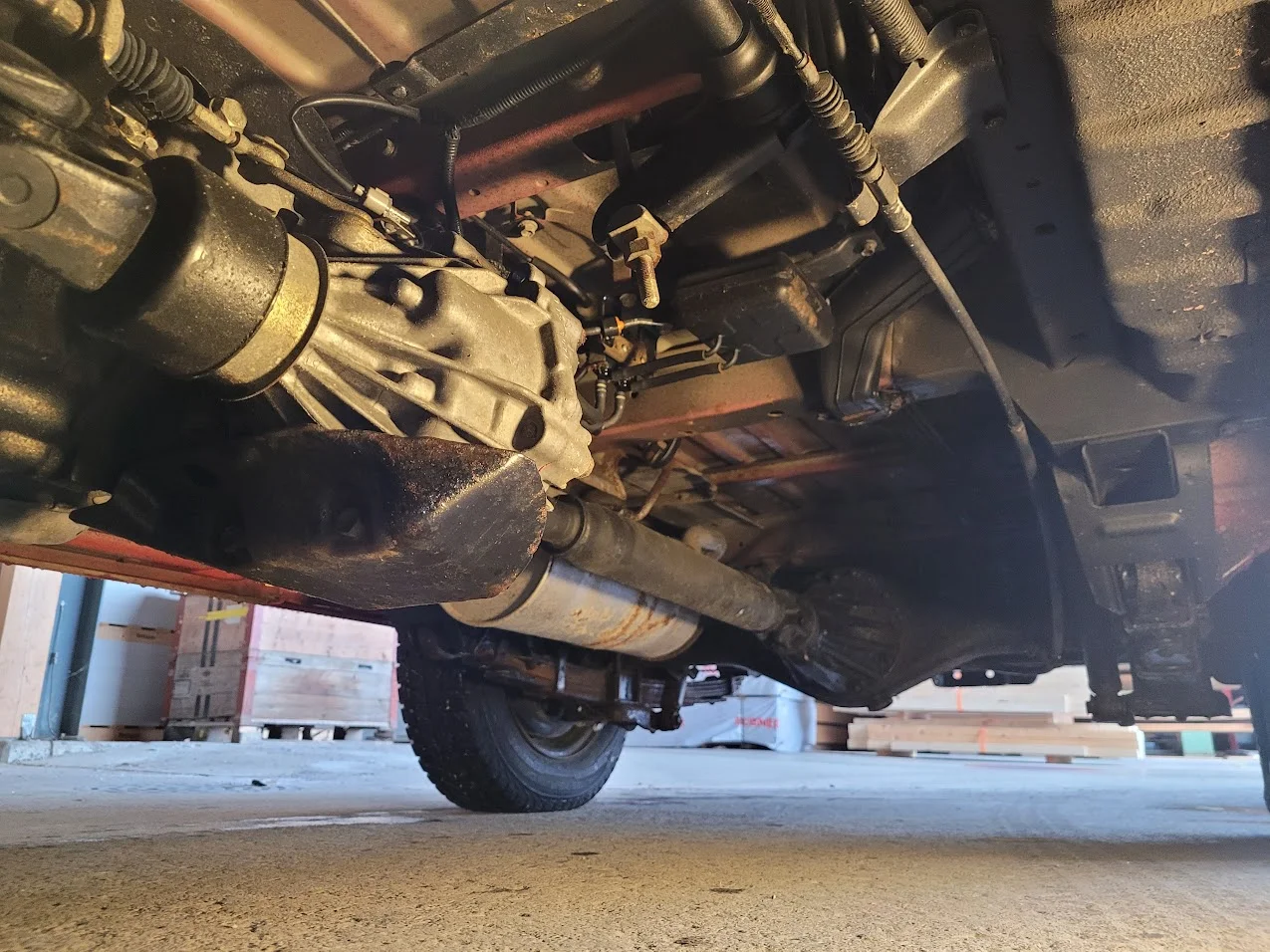

It's a petrol and 4wd (part-time with low range + rear LSD), as far as I know this combination is Swiss only and wasn't available anywhere else.

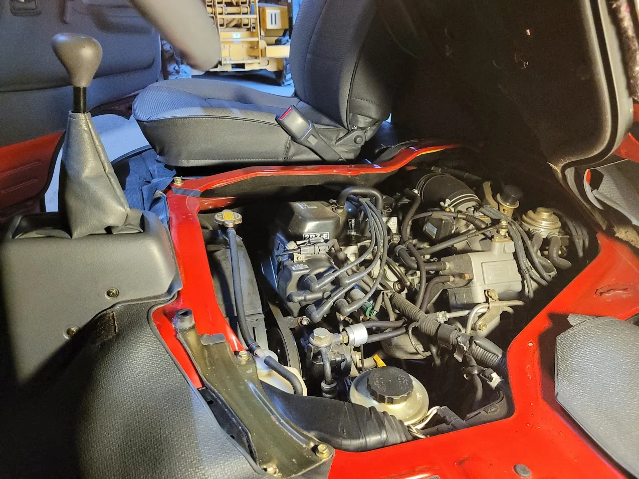

Engine is the 2RZ-E, you may think that you know this engine in the US... but no, in the US you used to have the 2RZ-FE in the 2WD Tacoma (and worldwide in the Hilux). This engine is the SOHC version of the 2RZ and was only installed in the Hiace (my guess is that the DOHC head wasn't fitting under the seats but also has the advantage of more low end torque).
It's not a fast vehicle by any means but it's a lot better then the diesel version we have available in Europe (that are fitted with the NA 2L developing 75ch...).
It spent the 30 first years of its life in a a dry and heated fire station, serviced once a year at the Toyota dealer... and wasn't used a lot.

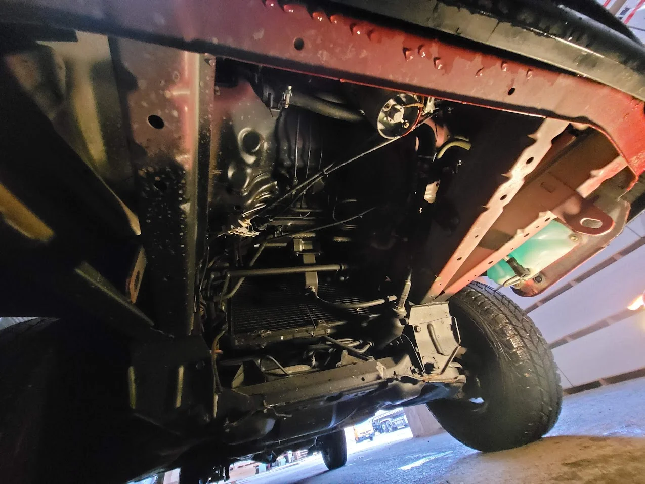

Mechanic component are very similar to other Toyota trucks on the 90's.
G52 gearbox, transfer case, clutch, U-joints, 8" diff, wheel bearing, etc. are the same PN than in a Hilux or 4runner.
Obviously in the front setup you can expect some more specific parts...

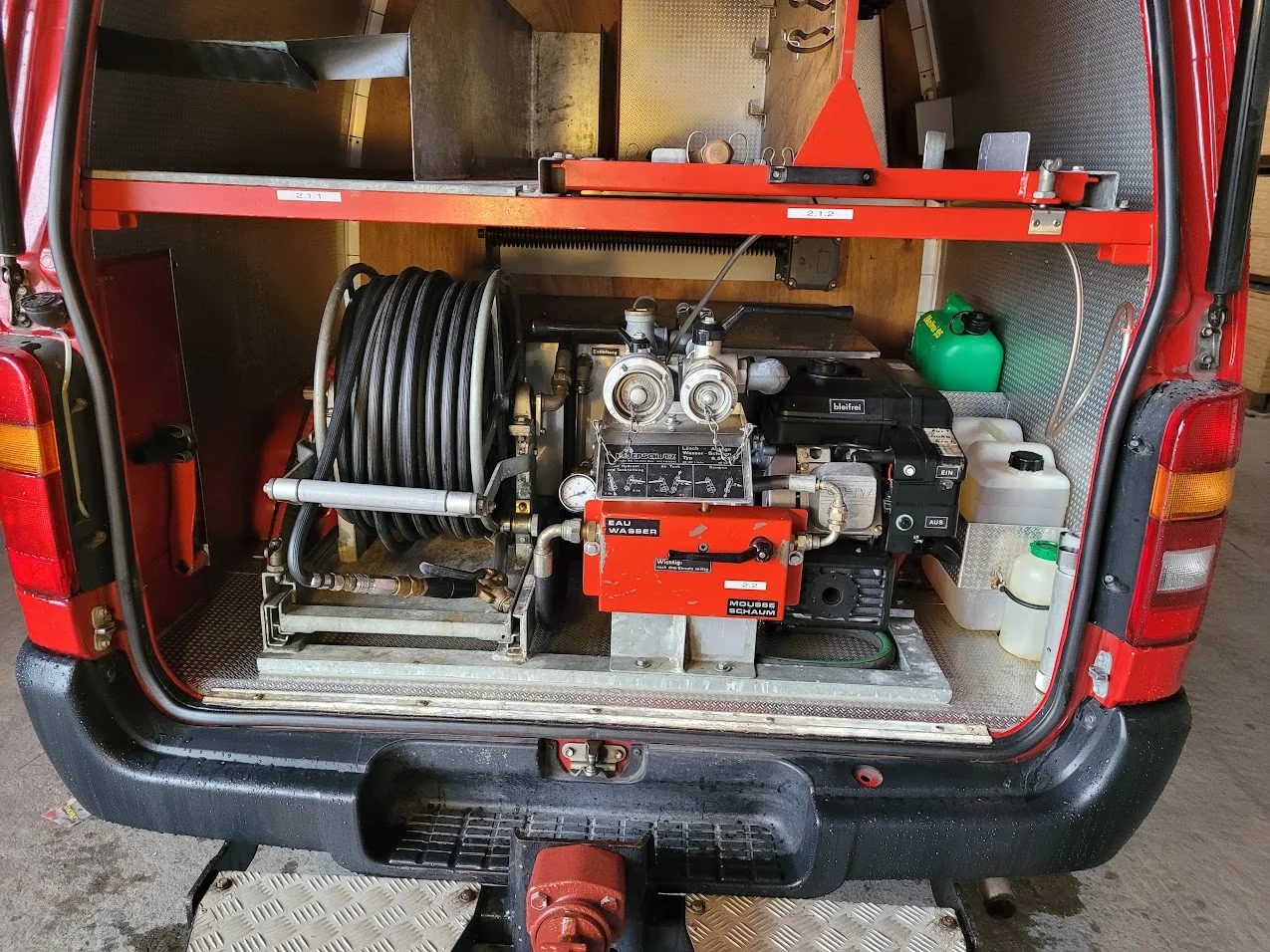

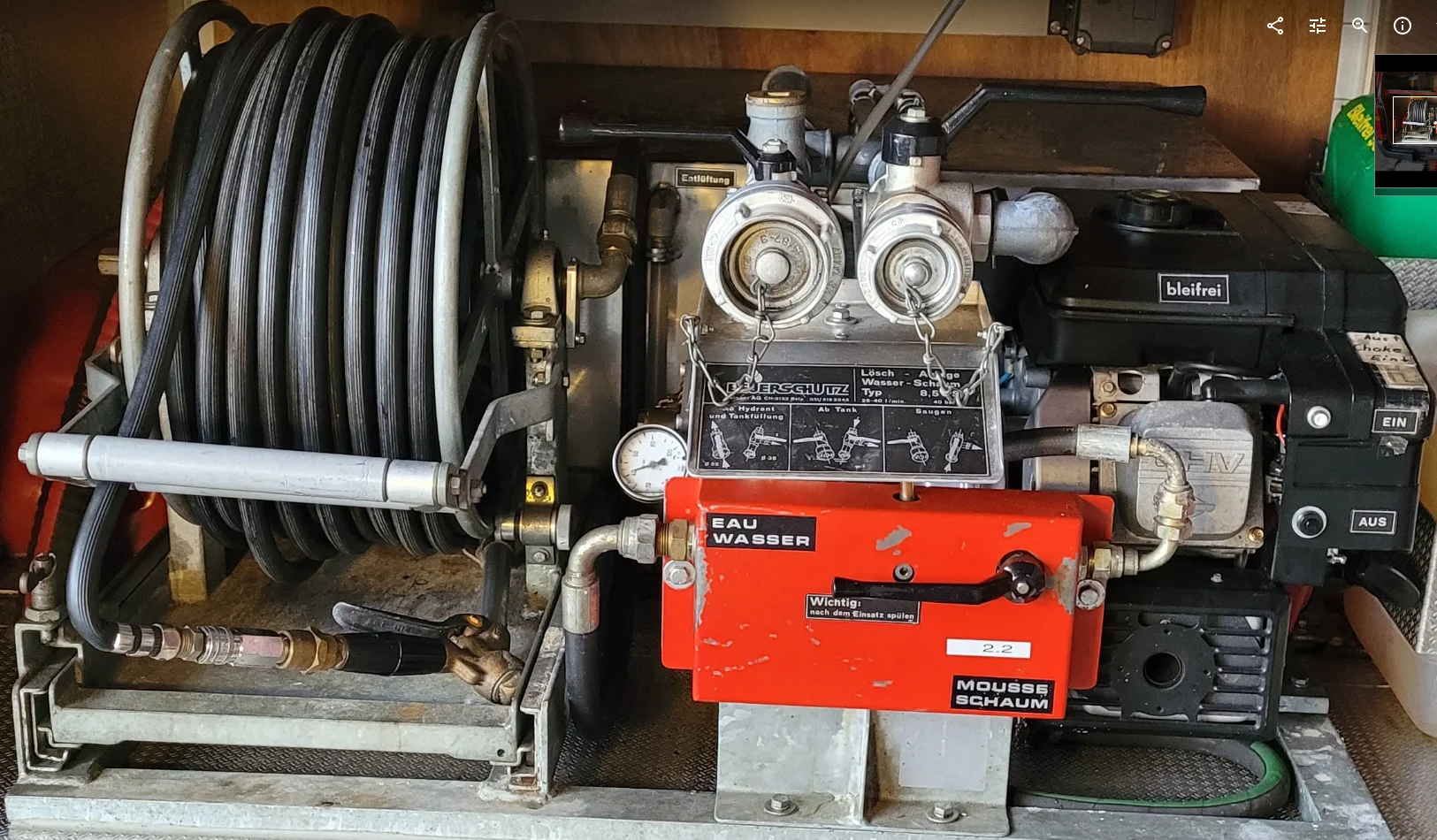

In a bonus it's a provided with its motopump and 250L watertank!

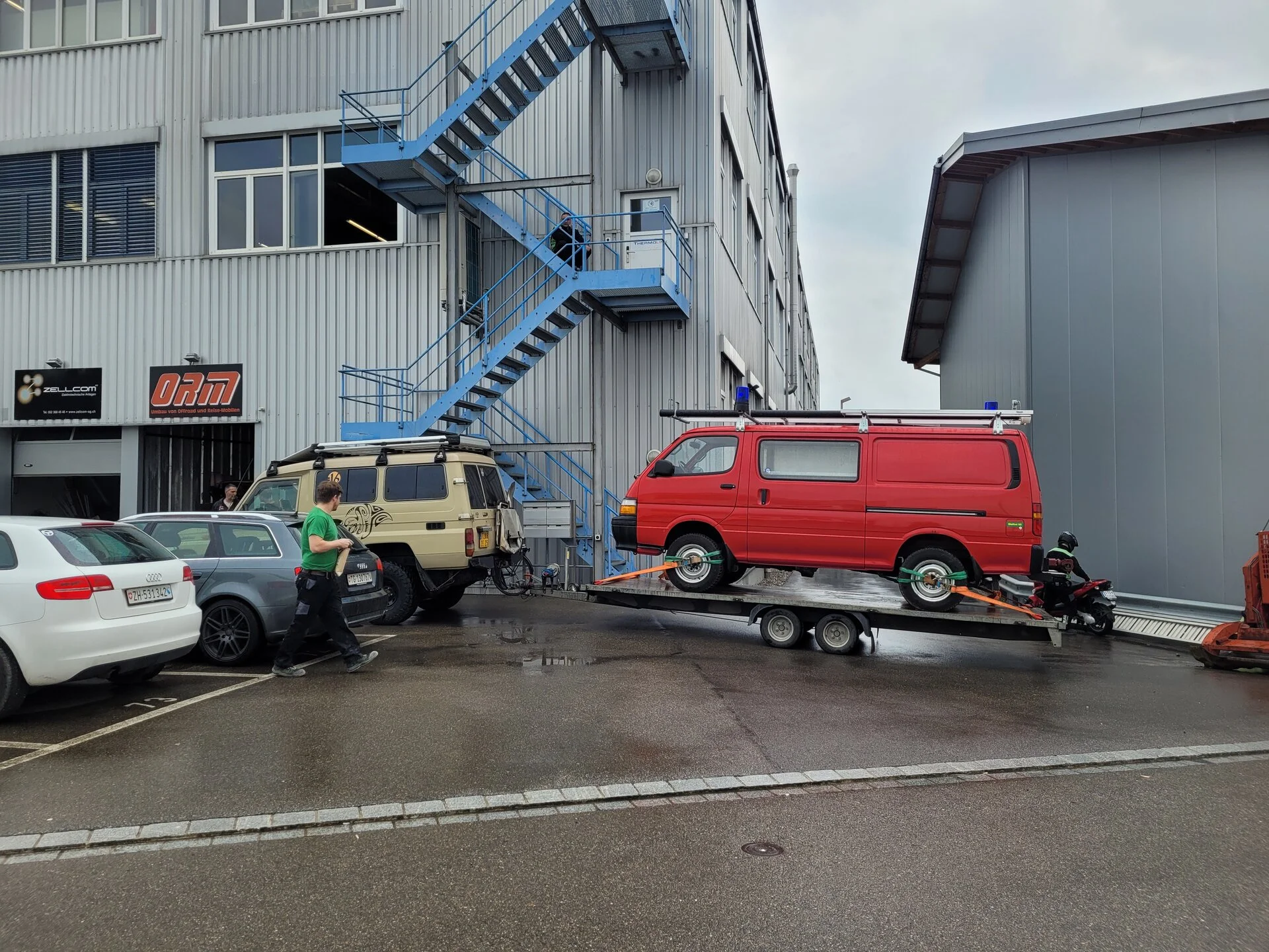

In exactly one week I will go to Switzerland to pick it up from the garage, trailer it back to France, and pay a visit to French custom... Then I will finally be able to drive it in France and start working on it!
Oh and BTW, the blue lights work 😁😇

was that used as a brush truck, looks like a pretty small pump and small diameter hose
I'm not sure what was the exact use of this vehicle in Switzerland.
Yes the pump isn't that big, it says 28-40L/min
And actually both fittings we can see on top of the pump are input (left one to input from a fire hydrant to fill the tank, right one to suck from a water source).
So the only output I see is the left hose reel which is really small diameter for firefighter...

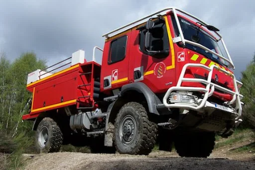

Brush truck if I understand correctly what it is are generally done by much bigger trucks in Europe like those:

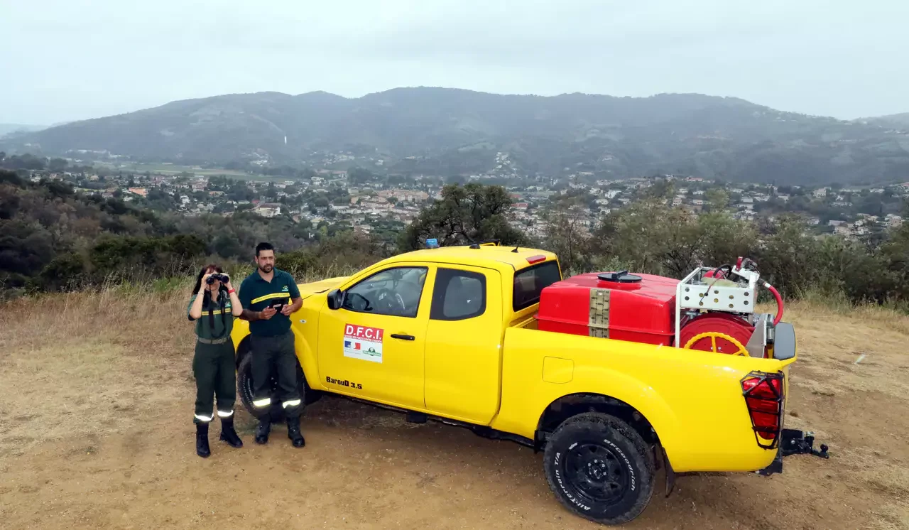

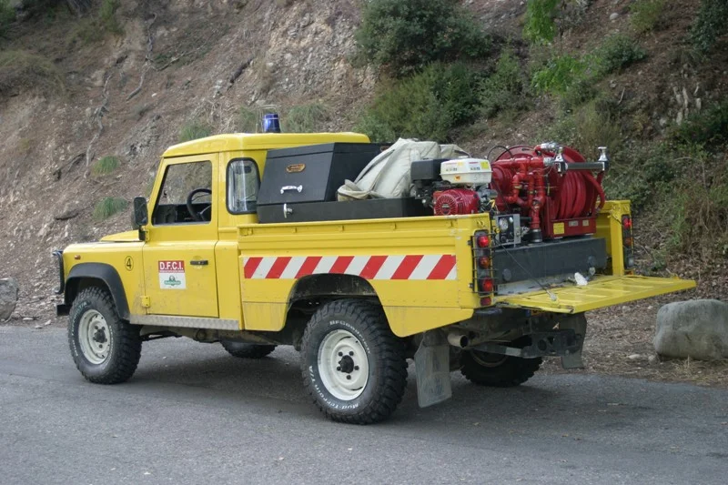

What it could be is a prepositioned forest fire prevention vehicle. In France we use pickups for that, their job during summer is to detect fires and have a lot of them scattered everywhere and hopefully kill fires at their very beginning (or at least alert early).
In France this task isn't handled by the firefighter, it's managed by the forest service and manned by volunteers (mostly retired locals).
A pickup seems a better choice for this task than the van honestly, from what I can find they have 500L+ of water tank vs 250L in the Hiace, not sure of the need of being able to suck water for this usage also... In France they are only allowed to attack fire up to 2m² (~20sq.ft).
So not 100% sure to understand what was the concept of this exact vehicle 🤔
we have bigger brush trucks as well ranging in size from pickup to larger commercial chassis. and the pick ups usually have a skid mounted pump/tank combo with between 250-300 gal with the larger ones having an internal mounted tank. having the suction allows drafting water from a static source so very useful when your out in the woods and your only water source is a river, lake or pond. very odd setup indeed but probably was built for a very specific purpose
