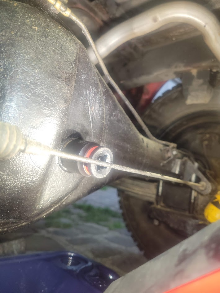

Haven't had time to do much progress on the camping setup inside, I mostly did maintenance, all fluids, treating any oxydation, some paint fixes, fluid film everywhere, wheels rotation, etc.
Fuel tank was the worst... was not happy with it and actually ended-up doing it twice to make sure nothing was left.
Oh and a little compilation of badly placed fill or drain plug x)
