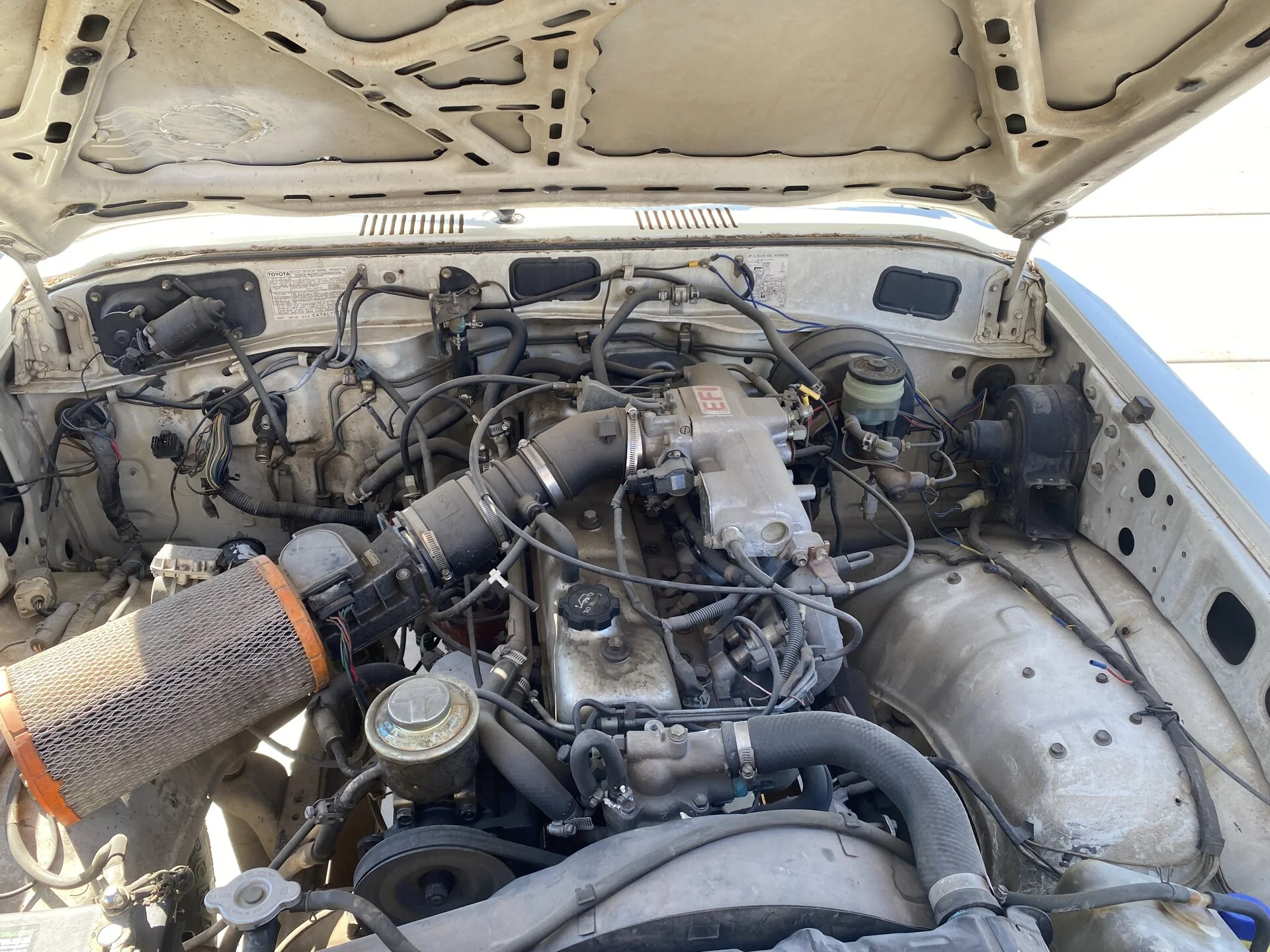

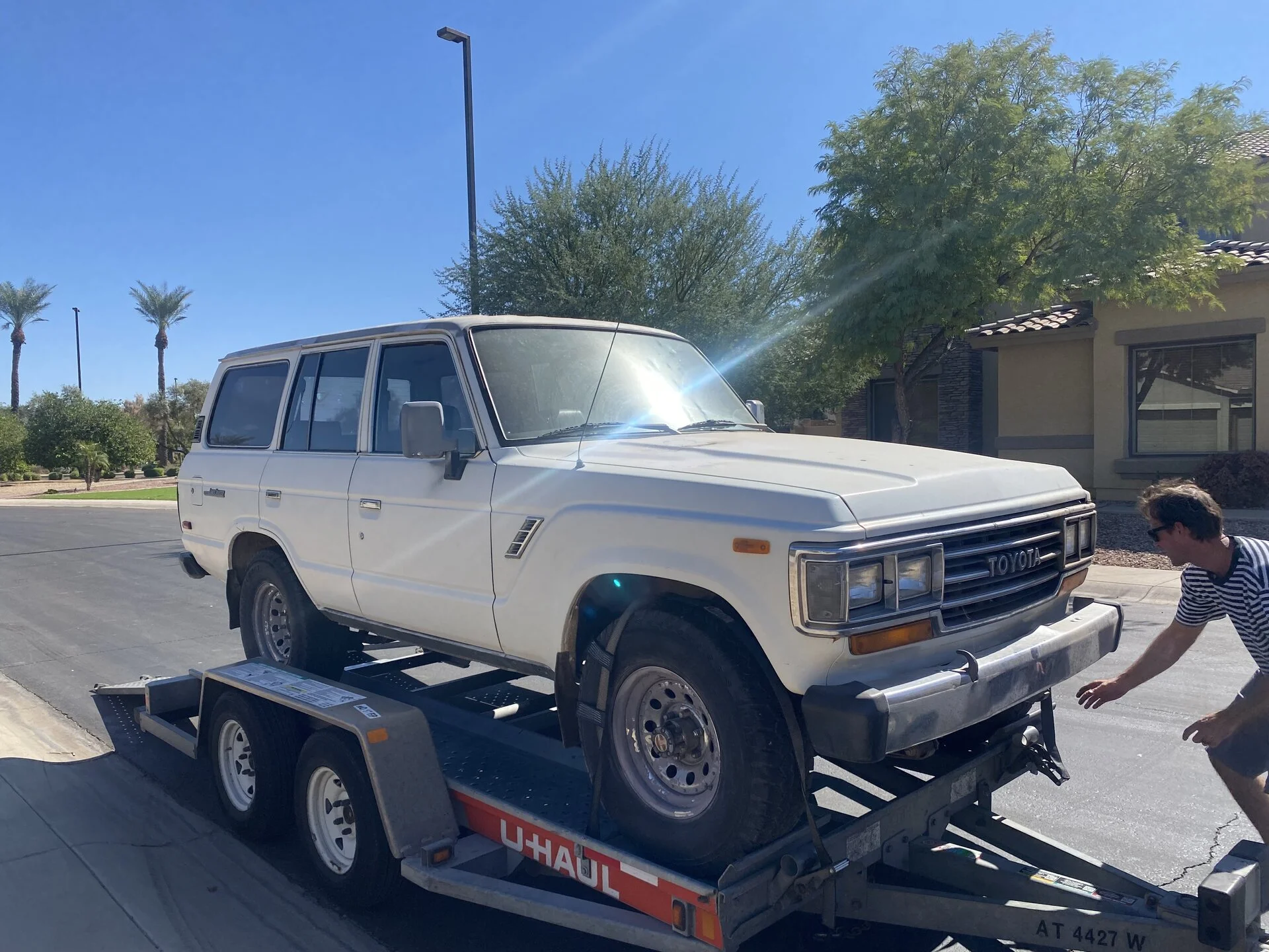

So I picked up this cruiser last week it’s my 6th Fj62…. chose this one because it has a pretty straight body , all original paint, undercarriage is rust free … spent it’s whole life in Arizona…. I paid $12k for it... It’s been desmogged though , missing Ac system (no ac compressor or idle pulley) engine runs strong has 175k on it. Has a kill switch and it’s acting up on starting but once it’s running it drives smooth 65-70mph I have a new carpet kit I’m gonna install after I install dynamat and have leather bmw seats with adaptors it all came with purchase. Passenger dent above rear tail light and roof needs some love cause the og owner had a rack on it that he tac welded but it was removed for sale. I kinda bought it sight unseen I wish I was more mechanical so I could do the work myself but im better at bodywork and interior redos than the engine stuff …. It also came with some regulators so I got most of the windows working. Let me know your thoughts p.s I’m in southern Utah so we don’t have emissions… yet 🤨 thanks !!! Jen
Update:
Toyota Mechanic says it’s a CF with wiring and someone with wiring knowledge needs to give it some TLC but engine is strong 💪🏼

The exterior trim was on my side yard from a cruiser a couple years back I was seeing if I could salvage hence why it’s sad hahaha I’ll prob pull it and add a rack but not surprises and still rust free up there … the person that welded the tiny areas did catch the headliner on fire so I need to pull that dynamat it and install new headliner 🙄🙄

Definitely looks like there's some suspect wiring in the engine bay, but any Cruiser -- indeed any old car I've ever owned -- has had some kind of hackery by a previous owner. If you can get a service manual with wiring diagrams and a multimeter, you'll be able to start replacing the janky wiring bit by bit.
In terms of the hard starting, check out your cold start injector - it's right on top of the intake manifold. It looks like there's some previous hack wiring leading to it. If you can get your hands on a manual, it will tell you how to test it. The manual also has diagnostic decision trees to help you find the cause of whatever issues you're experiencing. FJ62s are more complicated than the FJ60s, but they're still very simple and they want to run!
Thank you! I downloaded a service repair Manual and have a Haynes repair book as well… I’m kicking myself for giving away all my og Toyota service repair manuals … like the original ones that are $135 a piece on eBay to the guy who bought my last fj62 “cause I was never gonna buy another Land Cruiser again” 🤣🤣🤣🤣🤣🤣🤣
