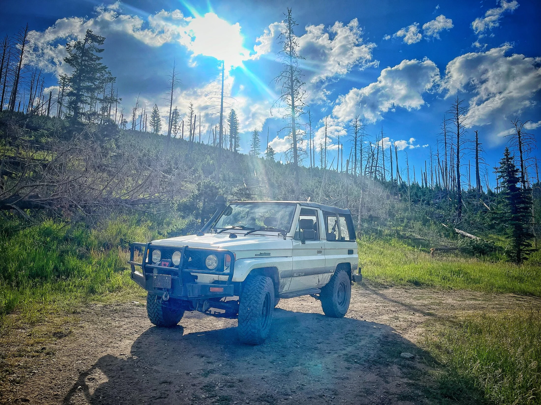

Took a last minute trip up Old Flowers road Sunday morning with my daughter and her boyfriend before he had to fly out. He may be hooked on cruisers with my incessant rambling.
Round trip from my house, 4 hours including stopping to grab cinnamon rolls at Verns and eating said rolls up top.
Took off with between 1/4 and 1/2 tank planning on putting some in, but the last gas station in Laporte didn’t have diesel…this might not last long.
Got home with 1/4 tank. The ol 13bt sips along. Lots of Subarus/tents on the lower side just past sky corral ranch. They weren’t getting much past some water breaks and a few mud holes.
I imagine them at 8:00am nestled in their tents thinking how did that get up here?
On the other side of the trail on the dirt road out, there were a lot more roof top tented broverlanders and one sweet schoolie.
Either way, great trip, good times and the weather had just enough chill to put a jacket on up top. The 30 mile coast down the poudre canyon is always scenic. It’s a 99% 2wd trail, but I could see some rigs needing a rear locker on that washed out hill. It’s more rutted/torn up from last year.

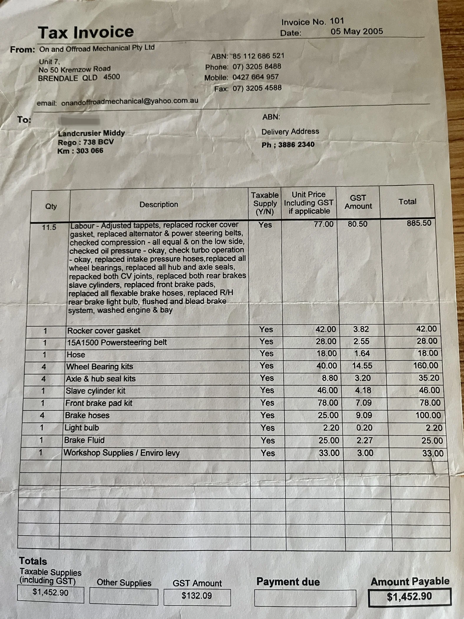

The oldest record I have is from May 2nd 2005 with 303,000kms on her. How many vehicles can you say you have a 12 year 250,000km service history gap? 😂

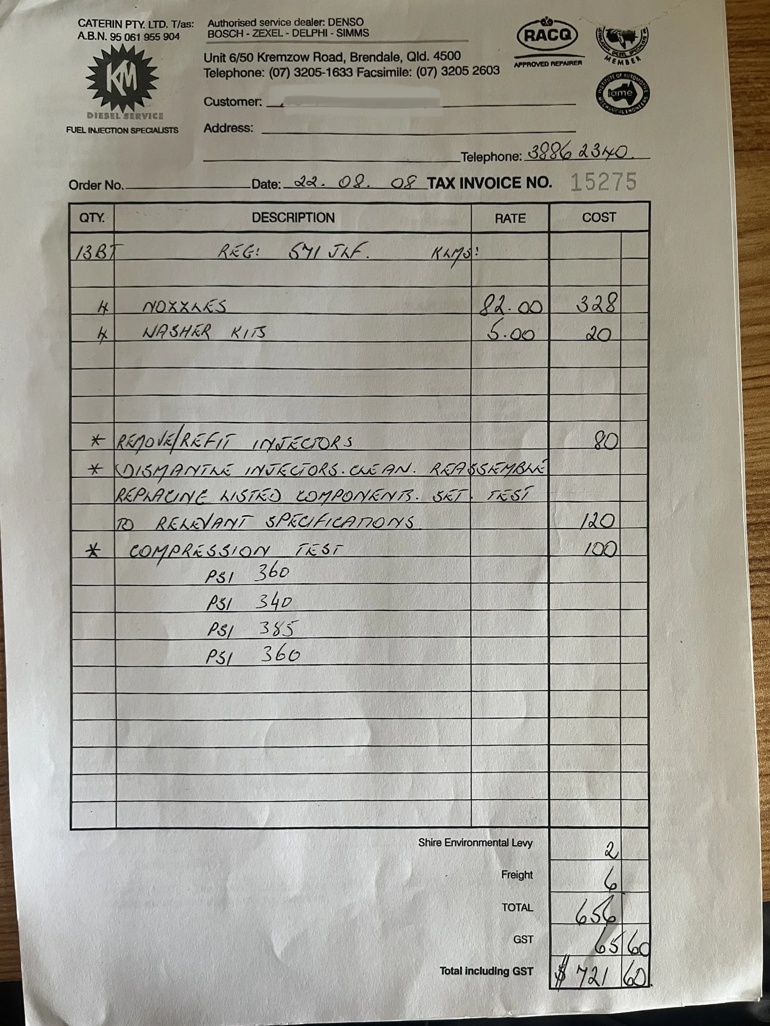

Interesting points: compression low but equal and everyone’s favorite axle job
3 years later, injector r&r and compression test.
Tech time woohoo!
Factory specs are 427 to 284 with no more than 28psi difference. According to this, it was 45psi difference…
A few more.
2009 at 400,000kms
Motor mounts, radiator r&r and clean, misc other bits.
Intersting…compression, radiator…
To be continued.

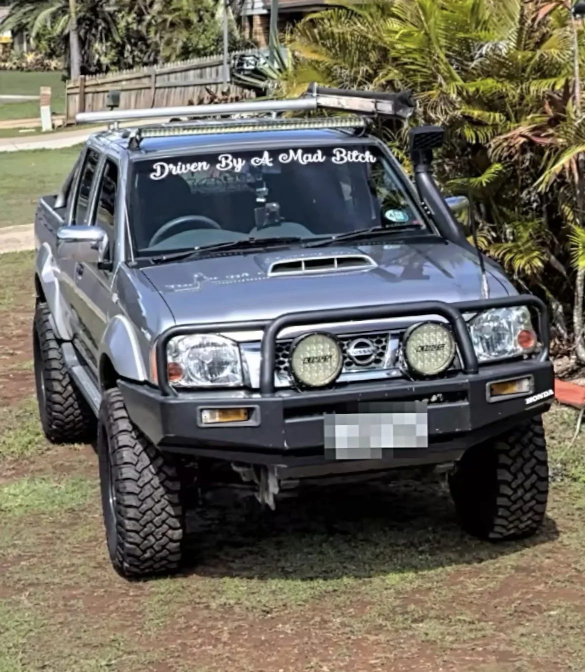

So why did I post up a random picture of an aussies house?
That was one of the longer owners of my cruiser. I’m not sure if they still live there or if this is what everyone drives in Murrumba downs, QLD but it’s cool to see the 4wd love still going.
Part of me wants to reach out to them just to see if they have any old photos and show them the cruiser now, but then the other part of me thinks that’s a bit too stalker-y
So I’ve hired a private investigator in Queensland to track them down….keep ya shirt on I’m only taking the p!ss mate.

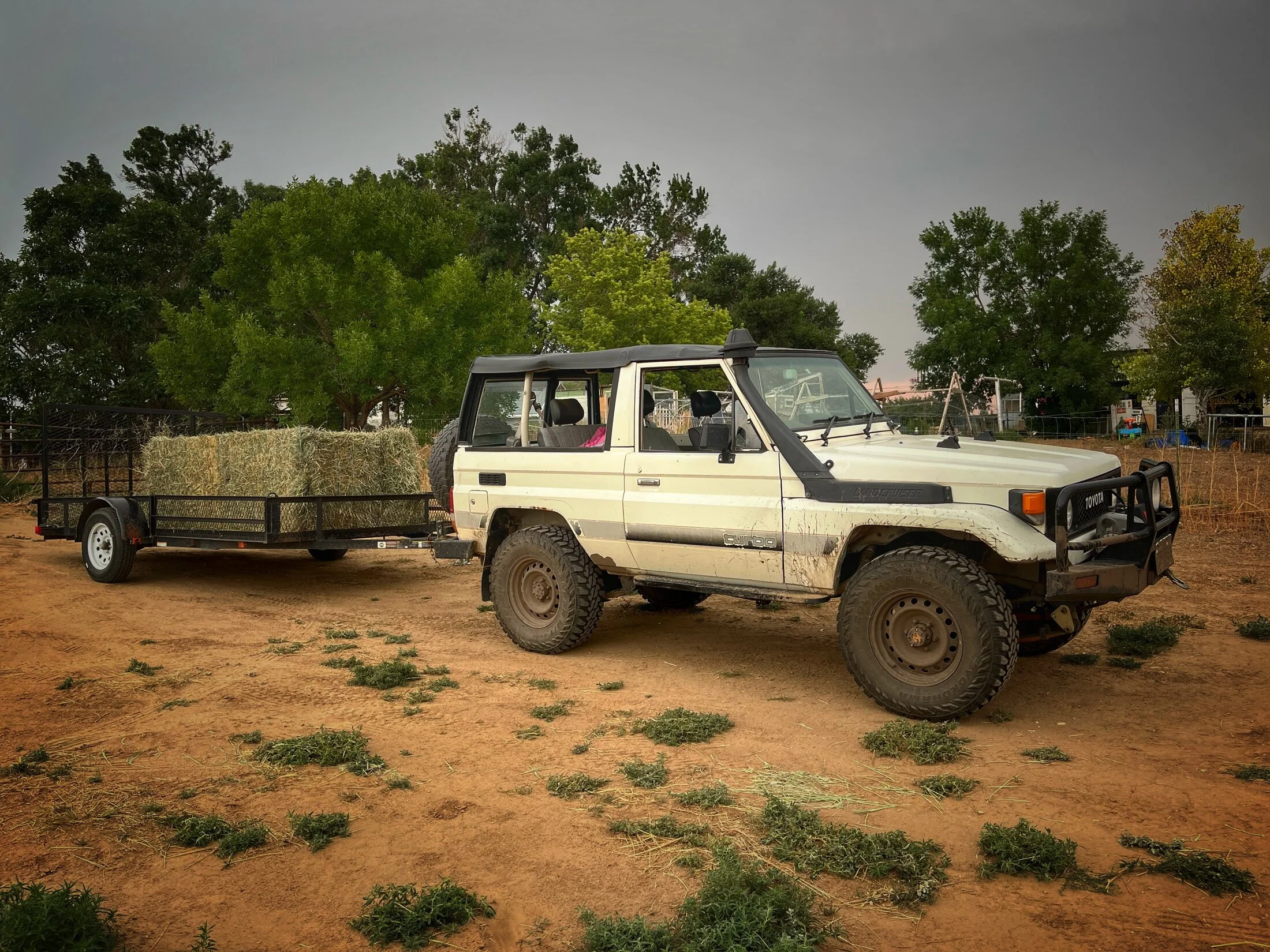

Had to get some hay. 1,500lb bale or 680kg for our metric friends
