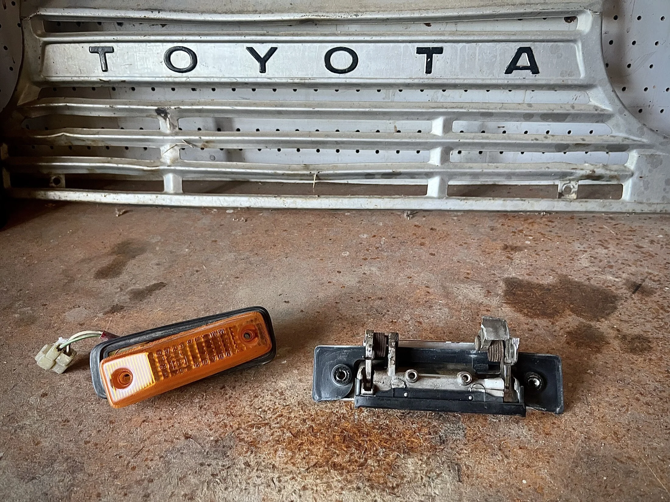

@gilmorneau hooked me up with a used door handle.
Here’s a picture of the broke one from mine. So nice to to have a solid handle again. Took about 15 mins this morning to replace.
He also threw in what I believe is a euro side marker for fun.

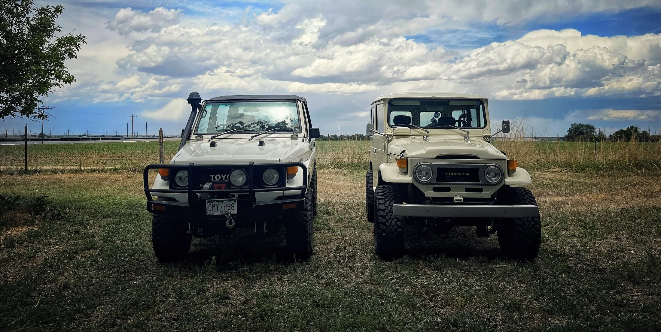

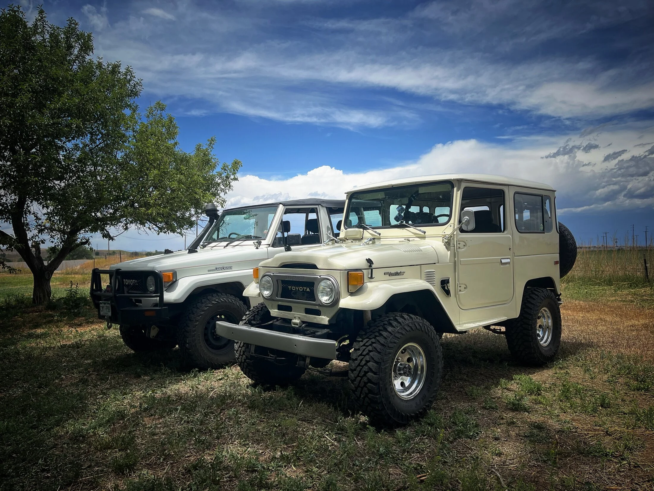

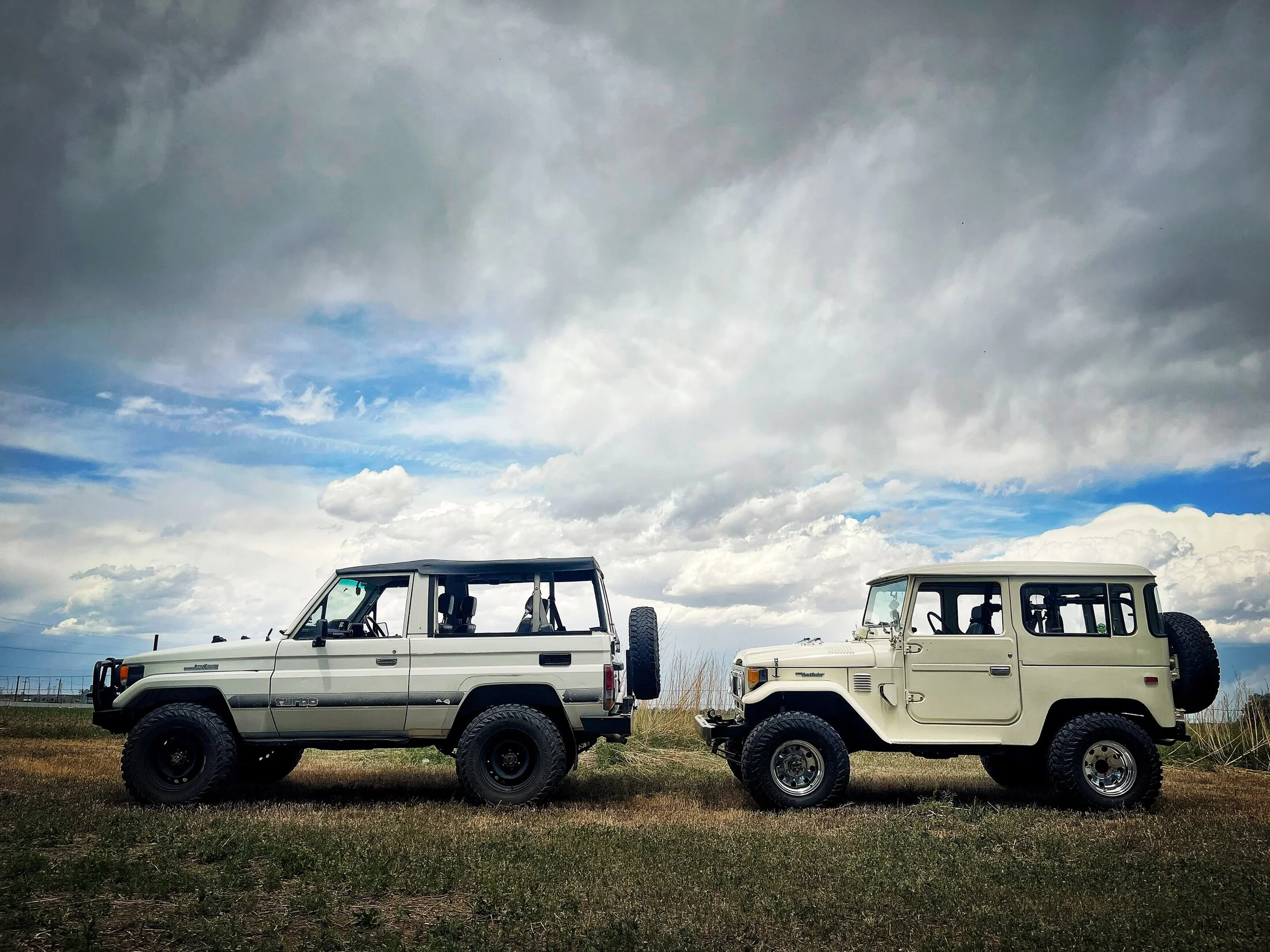

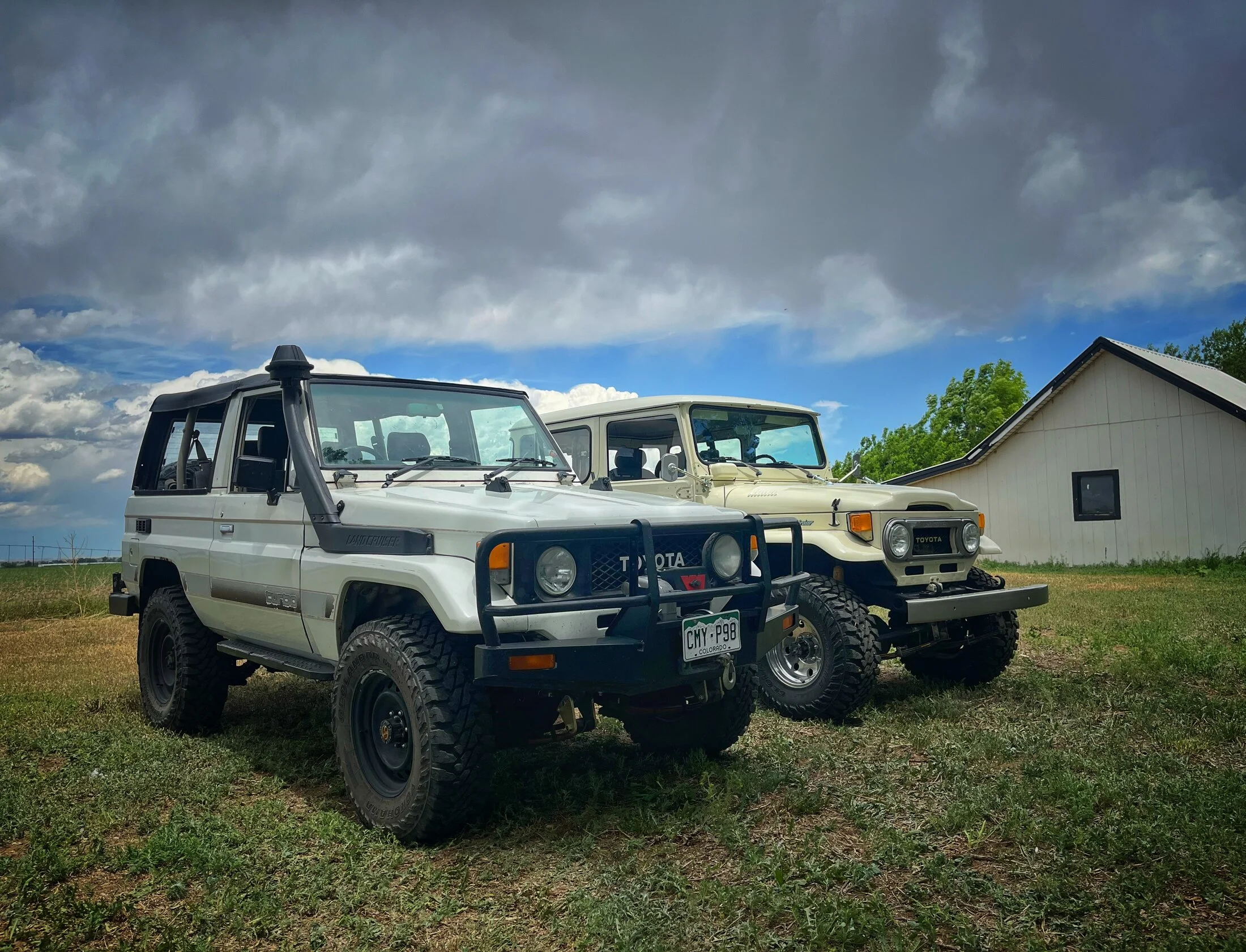

@PabloCruise stopped by on Monday, unfortunately we were in town for a graduation party. So he just took a, see what you missed picture :flipoff2:
Lunch meet up soon.

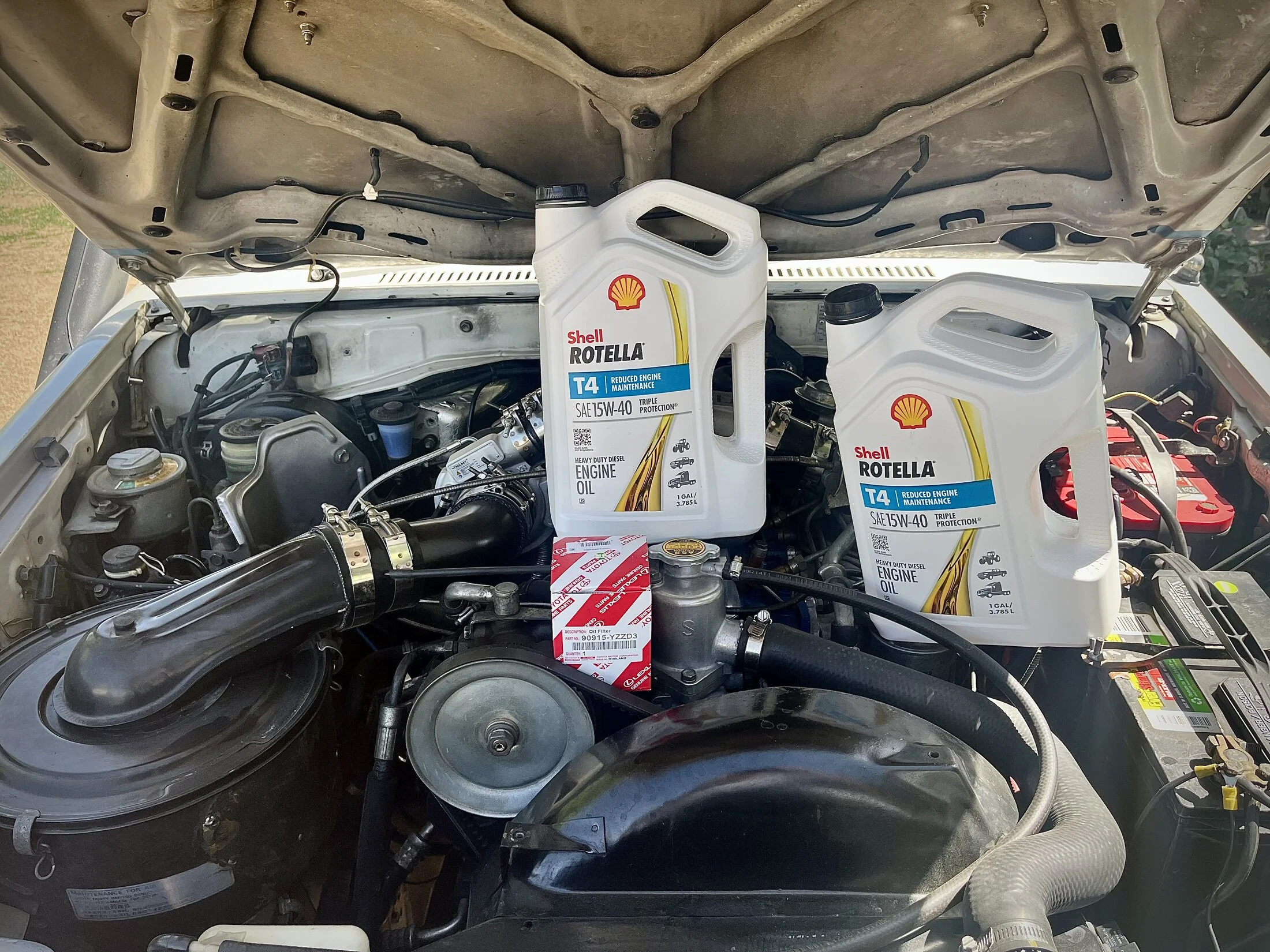

Oil change.

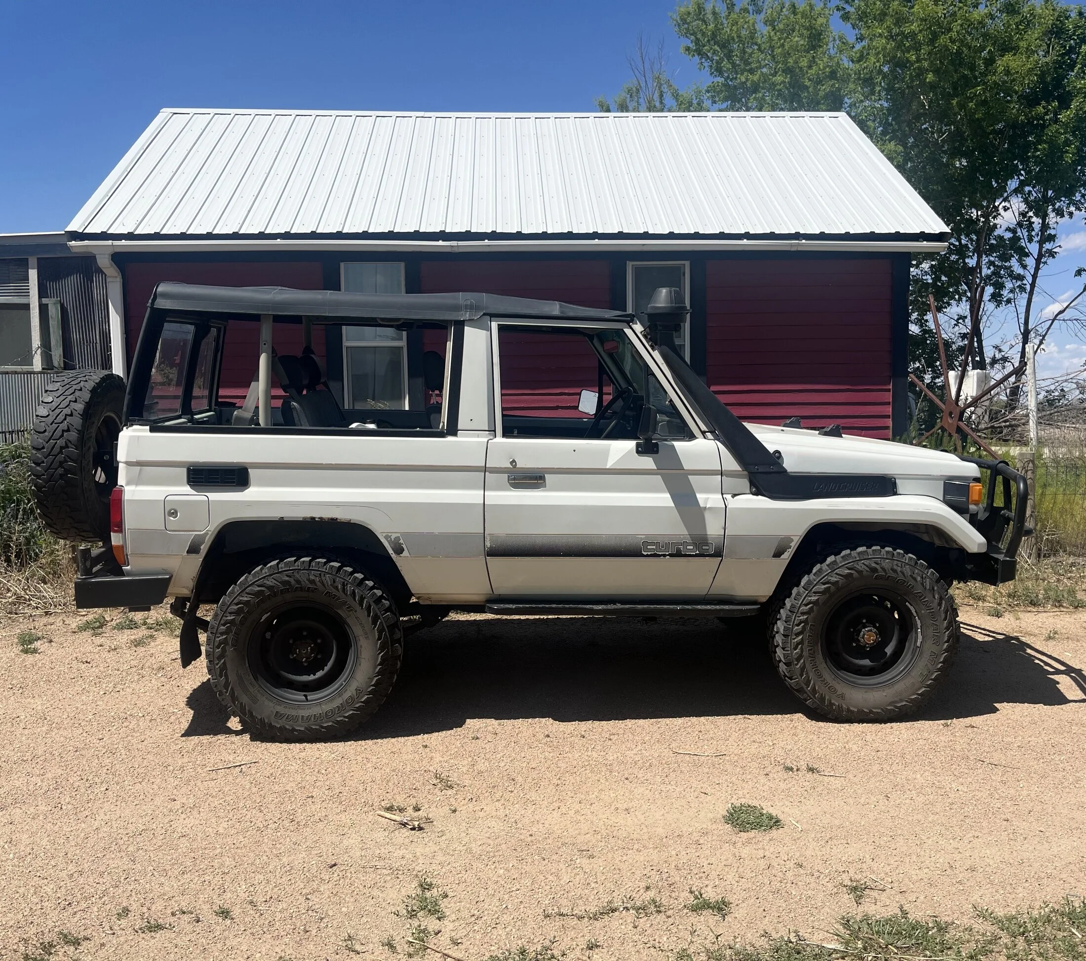

I tried matching his photo, but I have really bad stinkbug, plus mine is nowhere near the cherry-ness of his. It will be fun to get them together and see the size difference. He is running 33x12.50x15, me 285/75r17.
Raise the front or lower the rear…
You take better oil change photos than I do, even if you’re a stink bug 🤣

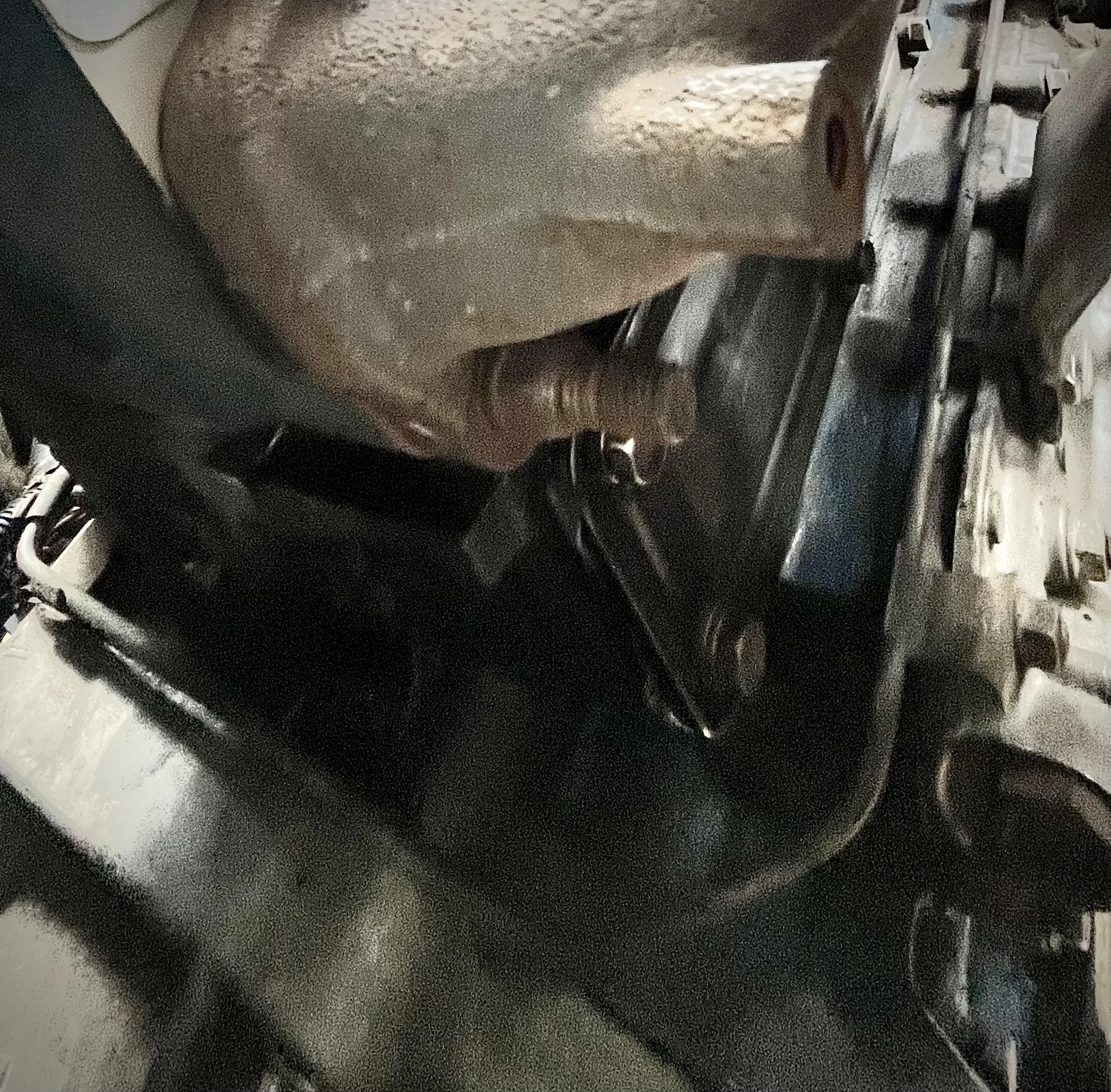

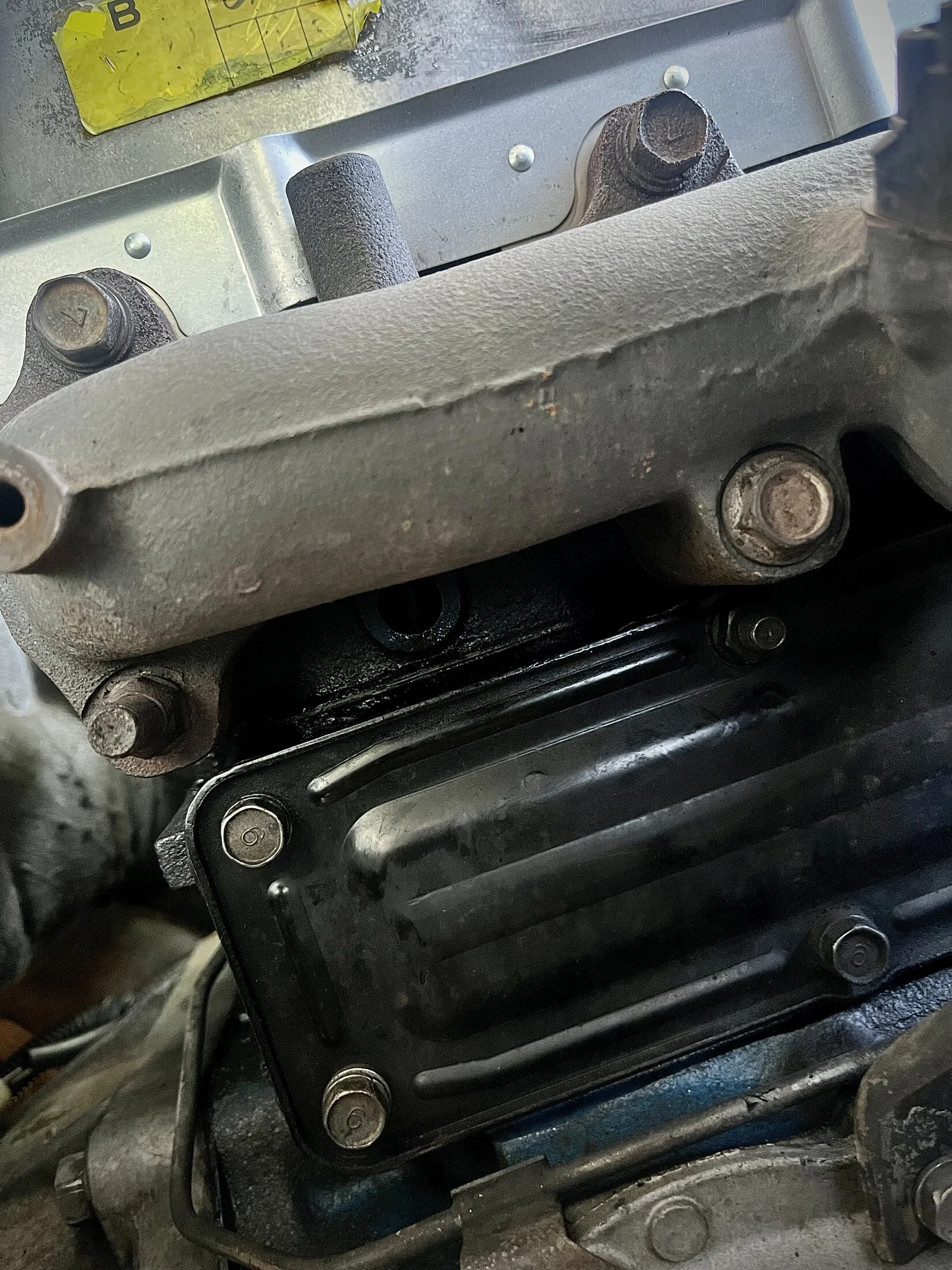

Decided I was going to tackle that leaking pushrod cover. It only seemed to leak on the highway of 60mph for at least 20 minutes. Started taking a few things apart and decided to check the rear upper bolt. Cant reach it when exhaust is on.
Yeah so that one bolt was loose, easily finger turntable. So my idea was to snug it up (13ft lbs…I went more ) and then test drive to save me from tearing it all out and putting new FIPG on.
We running into town, running errands and making stops. Took my daughter on another trip to grab some burgers and truffle fries from Big Al’s burgers and dogs.
After grabbing cookies and kolaches from the Colorado Kolache Company we headed home. After the 30 minute or so drive home at 65mph I decided to check it out.
All dry for now at least. I’ll keep an eye out for it and see what happens.
