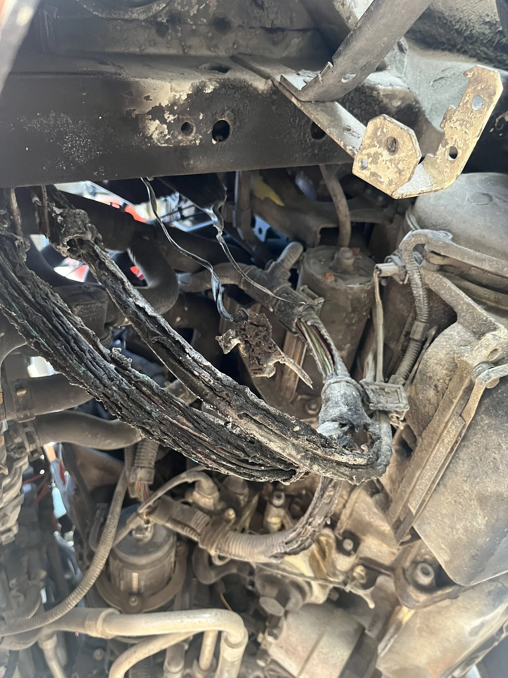

Long story sort of short? My friend from whom I got this from was just taking it to get a heat shield tack welded on at a muffler shop. My friend rents this on outdoorsy so he keeps it top shape. Well, the theory is he had something below that caught on fire from a spark and proceeded flame up and melt the harness.
Then said muffler guy actually tried to start it after…
Insurance got a quote of $17,500 to replace the harness and all harnesses and such. $17,500…. Needless to say it was totalled.
I was looking for one when my friend said he would sell me his for a “smoking” deal. He already bought a used harness but really just wanted it gone. It was very cheap.
He got it from original owners with every gas fill and maintenance item ever since new. It was extremely well looked after, and as I said he continued that formthe past few years as he would rent it out in california. $180 a night.
Excellent shape, no rust ready to go anywhere except for the whole fire thing.
Anyway I shipped it here since it was so stupid cheap to try and fix it. We have wanted another so worst case I could part this od it failed.
So yes @Felde , you nailed it!

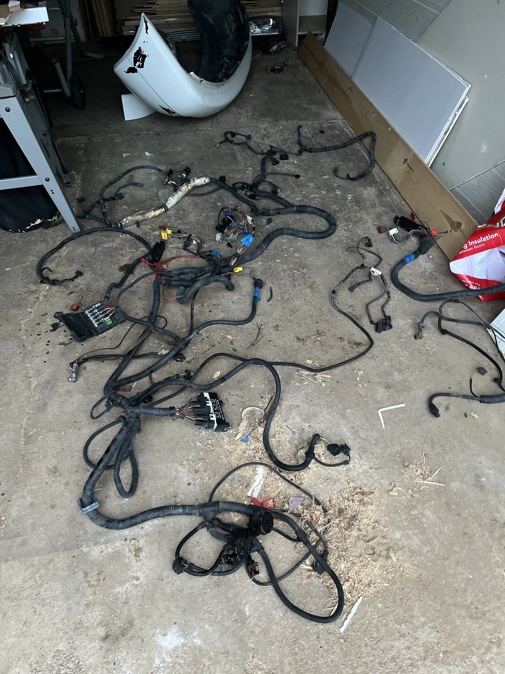

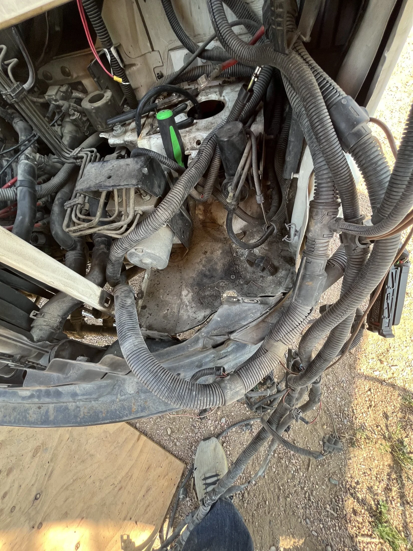

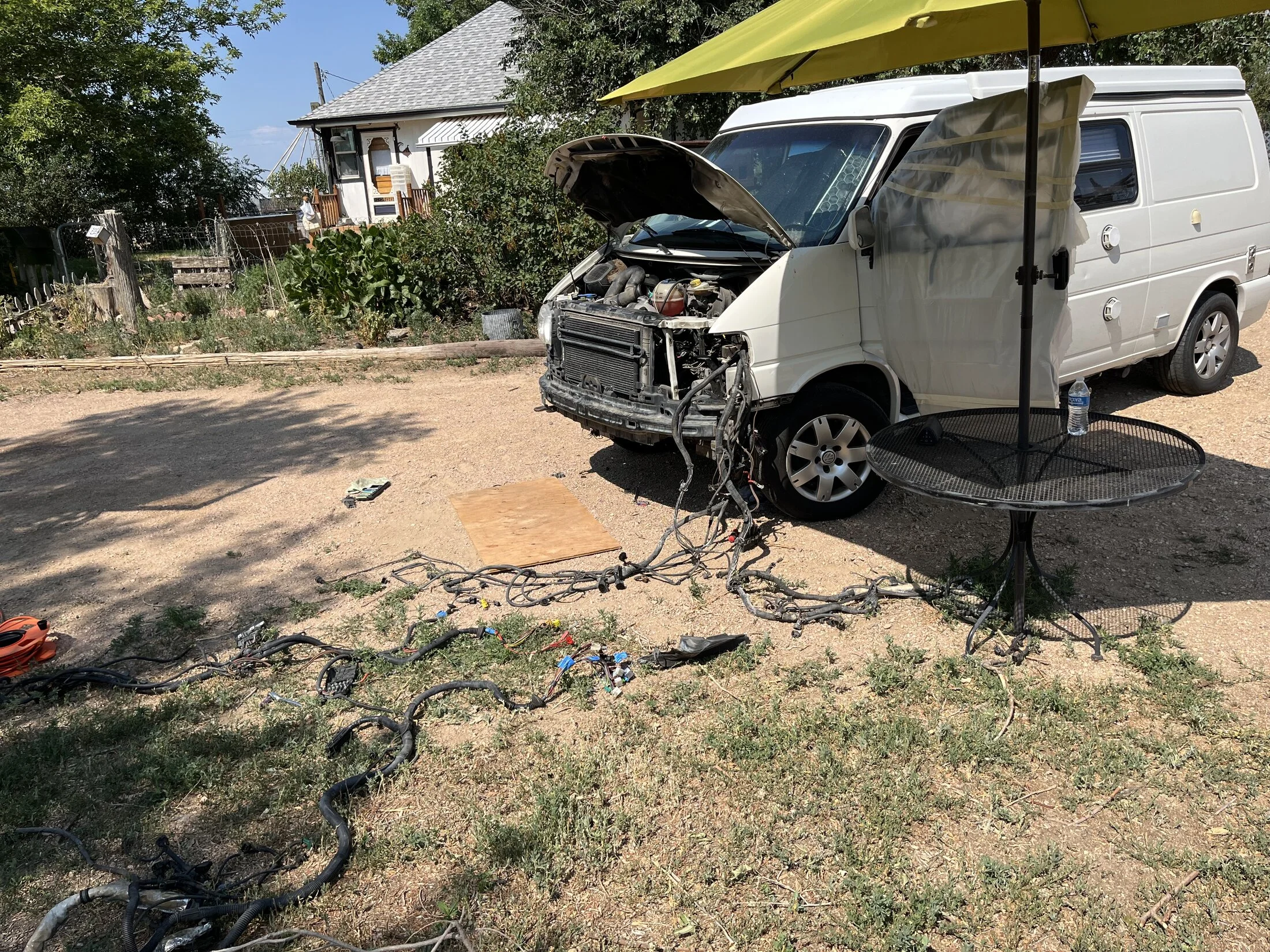

I won’t bore you with a ton more details, but I spent the weekend ripping the harness out, making any changes and putting in the new one. 16 hours…outside.
I got it. Fire extinguisher and hose nearby lol. Started up. Started up, minimal codes. Now we the transmission control module is fried. Charred wire into it so it’s in limp mode. Ordering one up.
So if all goes well, tcm shows up well, we should have a very nice setup for cheap.

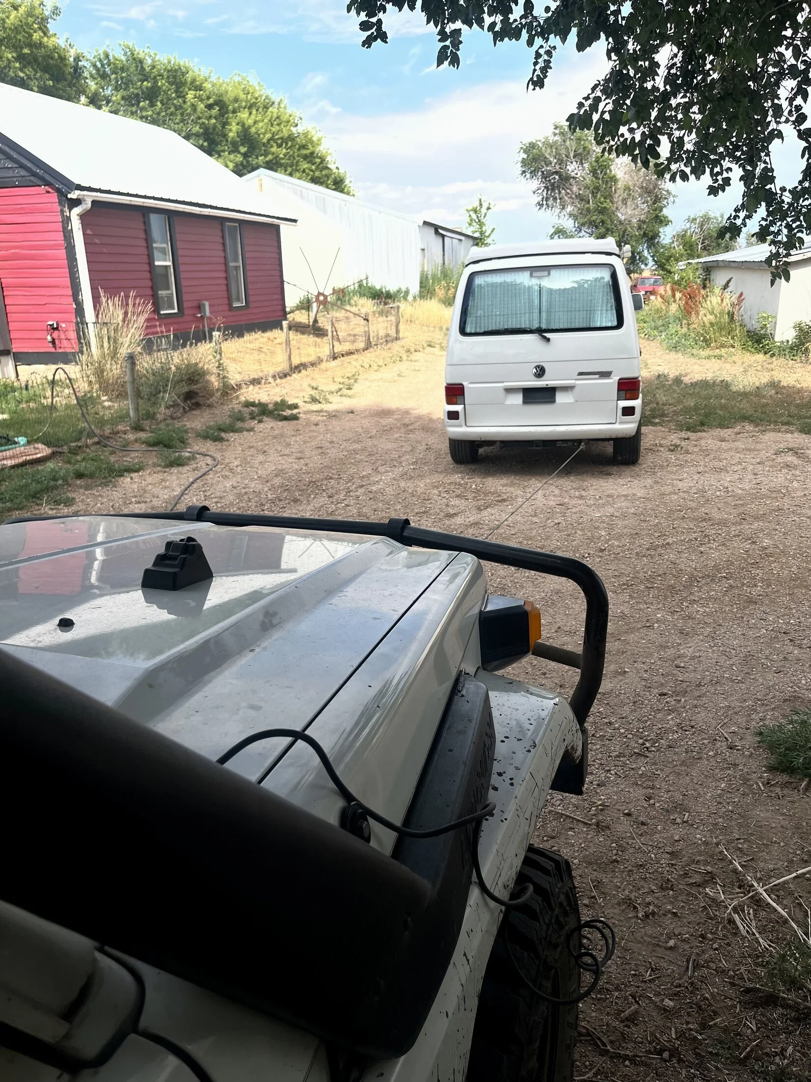

but yea, the Land Cruiser is there to save the day and help again.

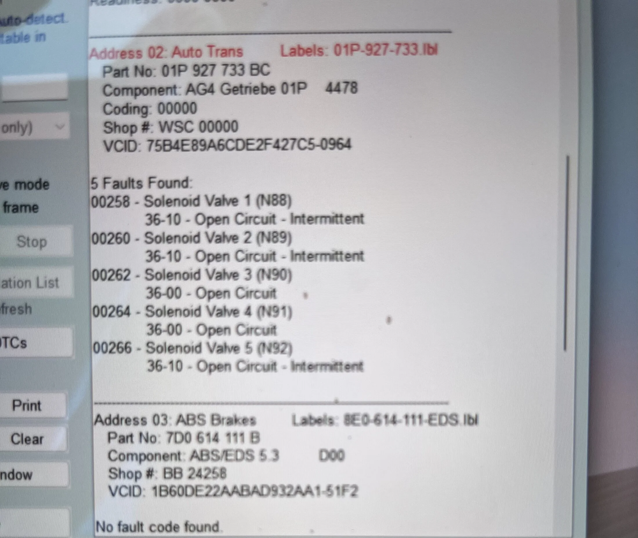

The eurovan TCM came in. No change when I put it in. Off to the drawing board. The great thing about VW is the VCDS program where you can pull all codes and live data and see it all with a $150 cable/license.
I was afraid it burned the cable inside the transmission since it’s electronically controlled. Only $135 and 4 bolts on the pan to drop so relatively easy. When to ohm out the connector on the outside and it was loose. Plugged it in, put the lock connector on, cleared codes and all is good for that. Shifting driving fine.
I’m down to a coolant sensor and vehicle speed sensor to be code free. I have both so fingers crossed.

Thanks, I’m down to 2 error codes now. Misfires…very common, replace the coil fixes that.
Airbag voltage, sounds like a connector.
Almost getting it error free.
