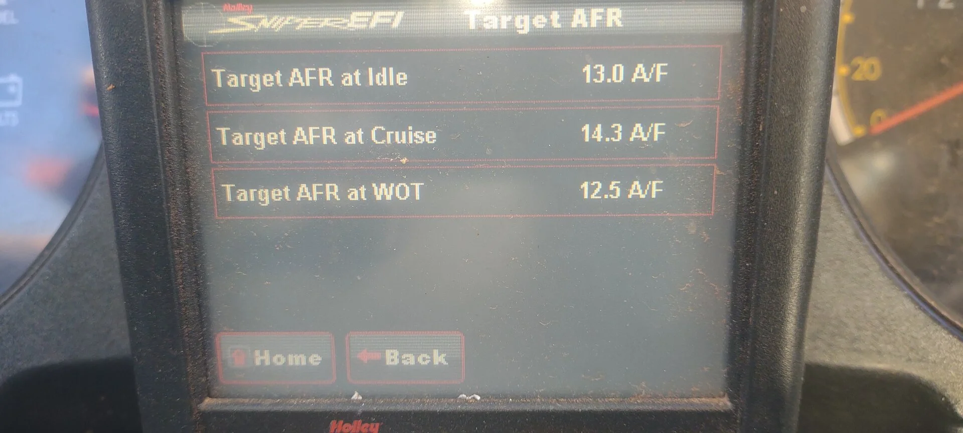

That idle AFR is pretty rich. I think mine is 14.0-14.2.
Yes, way more rich than I thought it should be. This was recommended by Holly tech because of stalling issues after engine braking before a stop. I have yet to get it tuned by the laptop method. I'm getting some smoke from worn valve seals now that I suspect is playing hell with the O2 sensor. Sniper can't get to set AF levels, varies from too lean to too rich daily. I got a spare head to get prepped, that had better fix it.
naa.. thats fine. its just idle, and that fuel will keep the o2 from hunting around and going lean with the s***ball uneven airflow on the 1930's manifold design when you come off a long slow deceleration. keep in mind if you put a modern oem engine management system on this engine, the airflow is so uneven cylinder to cylinder at any given cycle, it would likely go "robbie the robot" and self destruct. A good engine may be .5 higher, but these aren't good engines when new.
