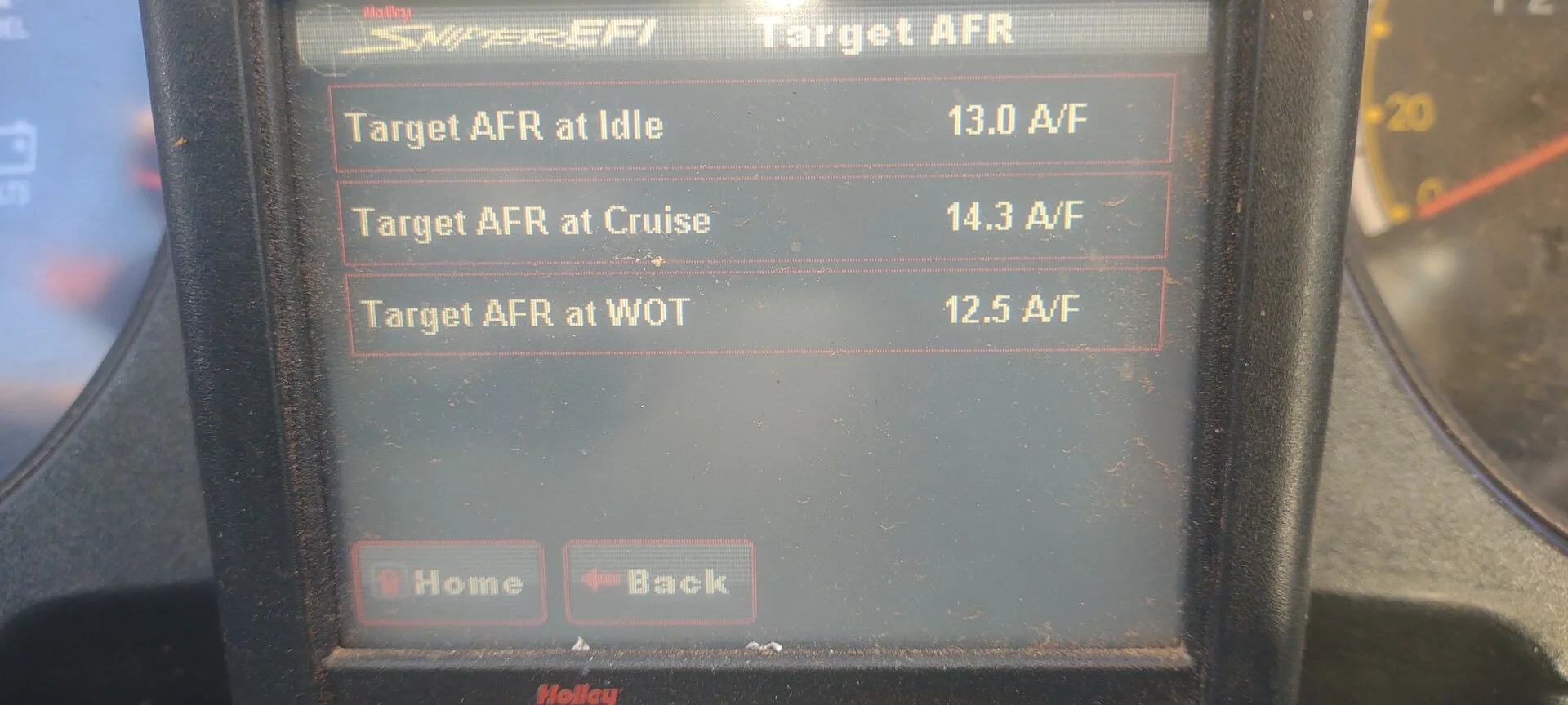

This seems to be the official Sniper thread so I'll ask here. I've fouled another O2 sensor after just a few weeks. It was fine until this morning. It was 20° F and on initial start up, the engine fired, stumbled, and died. Cycled the ignition, stumbled to life and I walked away to let it warm a bit. (I don't like driving it until coolant temp is above 70°). Anyhow, I got distracted and let it idle for probably 12 minutes or more before I jumped in to drive to work. AFR was reading 38:1 but black smoke out the tailpipe indicates a fouled O2 sensor. What did you all set your target AFR's to?

ill download and take some screen shots of my settings when I get home. I'm not stock, but unless you did something really wacky, I cant see that killing an O2. THink about it, you're getting "normal" reading and its running fine, why would an o2 s*** the bed fro the exhaust?

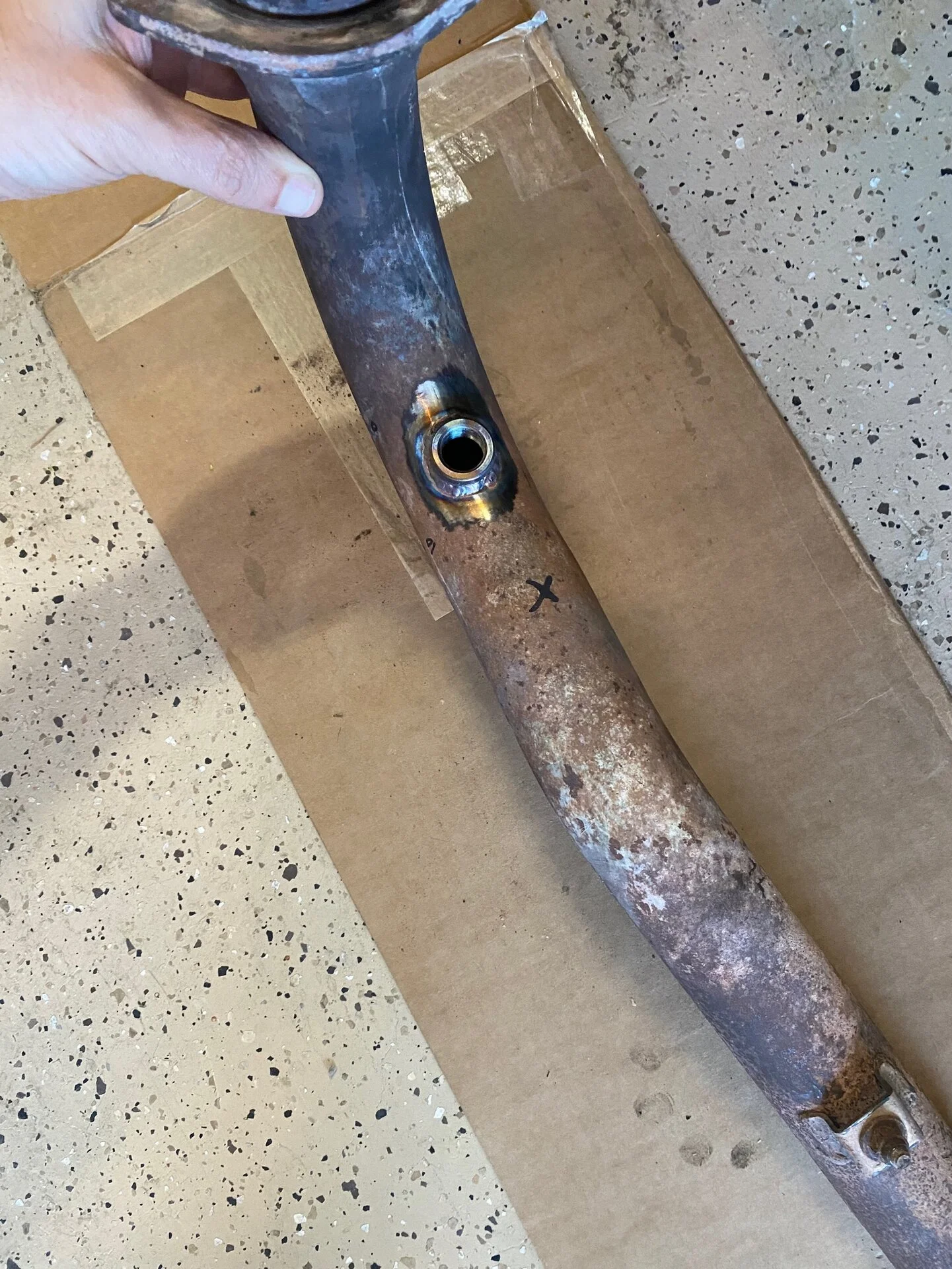

How far is "way downstream"?
My O2 sensor is in the "test pipe" cat' area at 1:30 position.

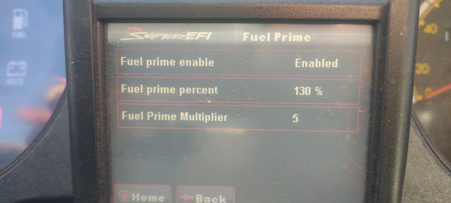

What's whis fuel prime multiplier?

I think the cold is hard for the sniper to adjust to. The coolant enrichment deals with it like a choke. Read page 2 (55) of th manual.
If a header, 6” down from the collector.
If a manifold in the flat spot just past where the EGR tube goes up
That’s about where mine is. (I’m running stock manifold and exhaust). It’s 8” from the flange that connects the pipe to the manifold. Although mine is pretty much perpendicular to the ground. I’ve put about 2500 miles on it over 18 months…no problems yet.
