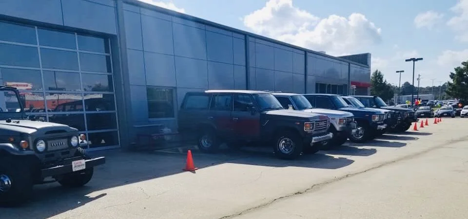

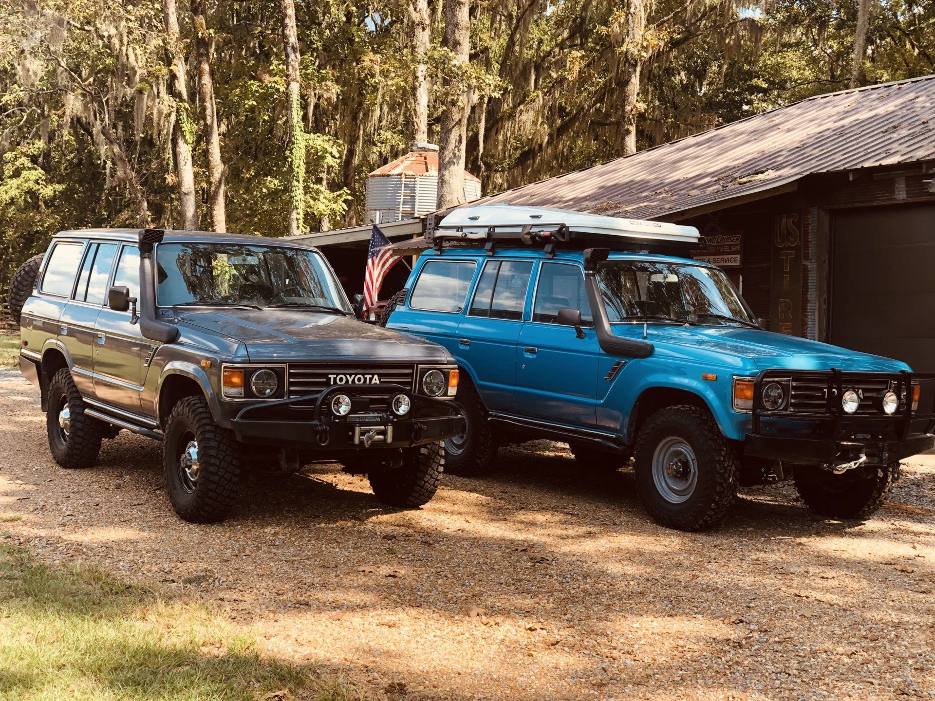

Took the 60 down to Toyota of Brookhaven this weekend for Cruisers and Coffee. Great event by @s0me0ldt0ys and crew! Pulled the 416 for the first time with the 60 and it was perfect. Trailer got some 235/85 ko2s while it was there.

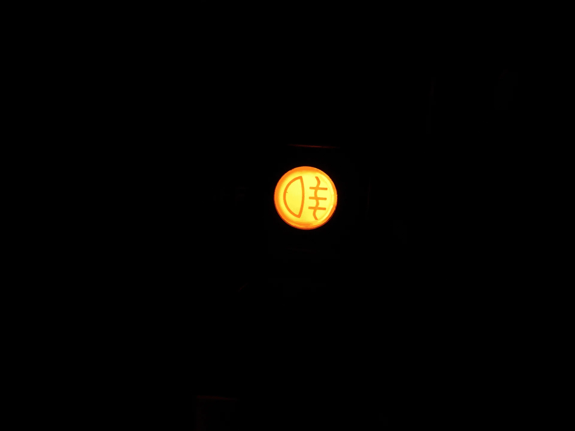

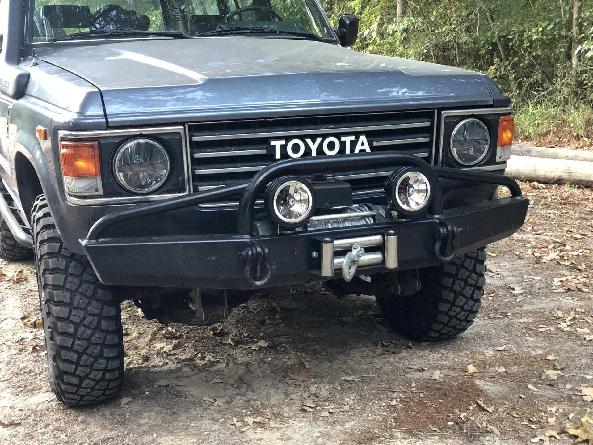

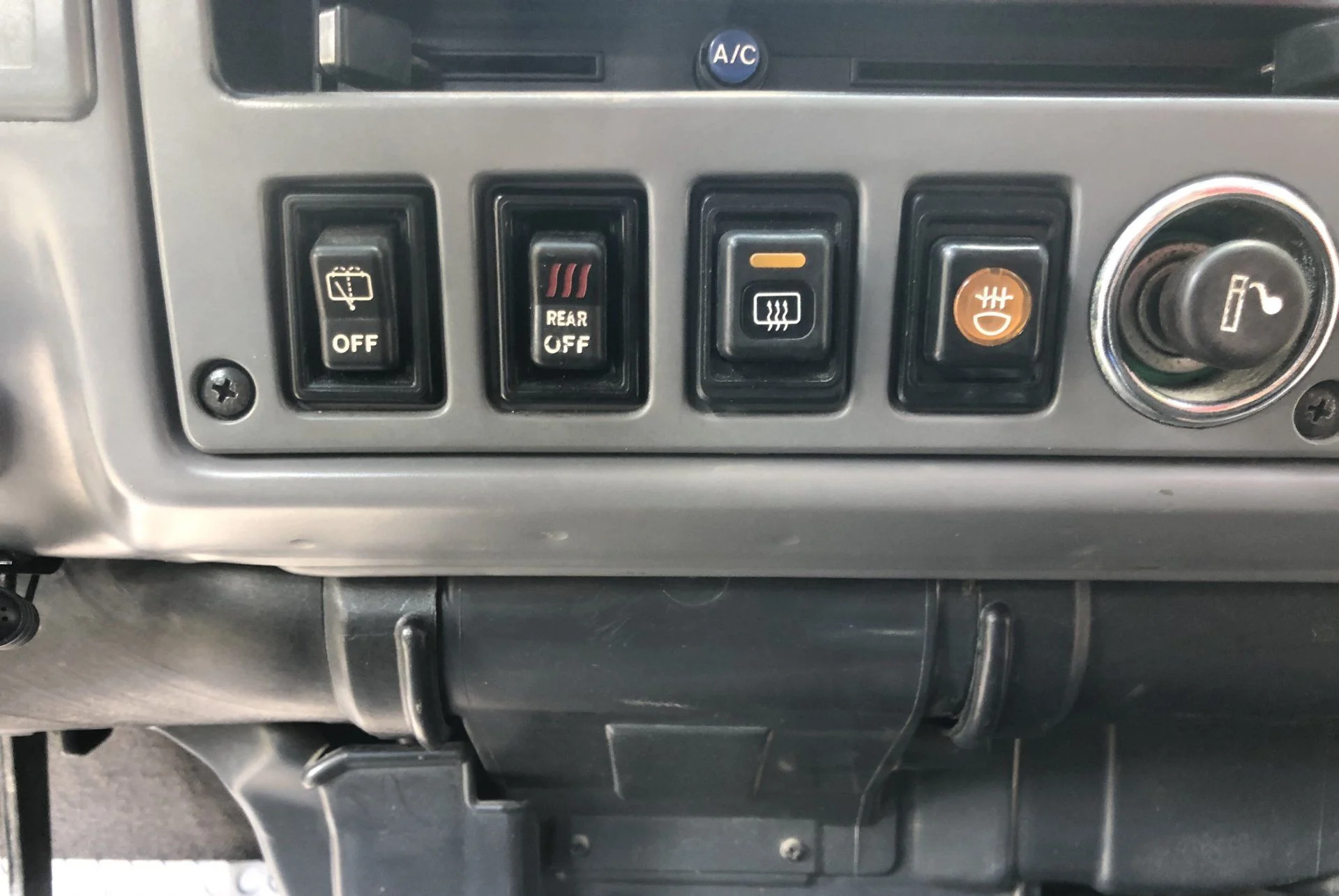

I did get a little work in today by adding a set of KC Day-lighter LEDs to the front bumper. @JTU installed a set on his rig and they looked right, so I pulled the trigger too! I must say they do fit the 60 well. I may be crazy, but my favorite part of this install is the fact that I sourced an OEM fog switch from @ToyotaMatt
.....Also there is a rear full float OEM 60 axle getting built out by @orangefj45 and crew with a Harrop Elocker that will be finding its way into this rig! More to come....
Dustin , :)
The OEM AMBER GLOBE Push Button Fog Switch is Truly a Unicorn part on your truck 🦄
It looks AWSOME and well placed with both a factory fit and finish ! 💥

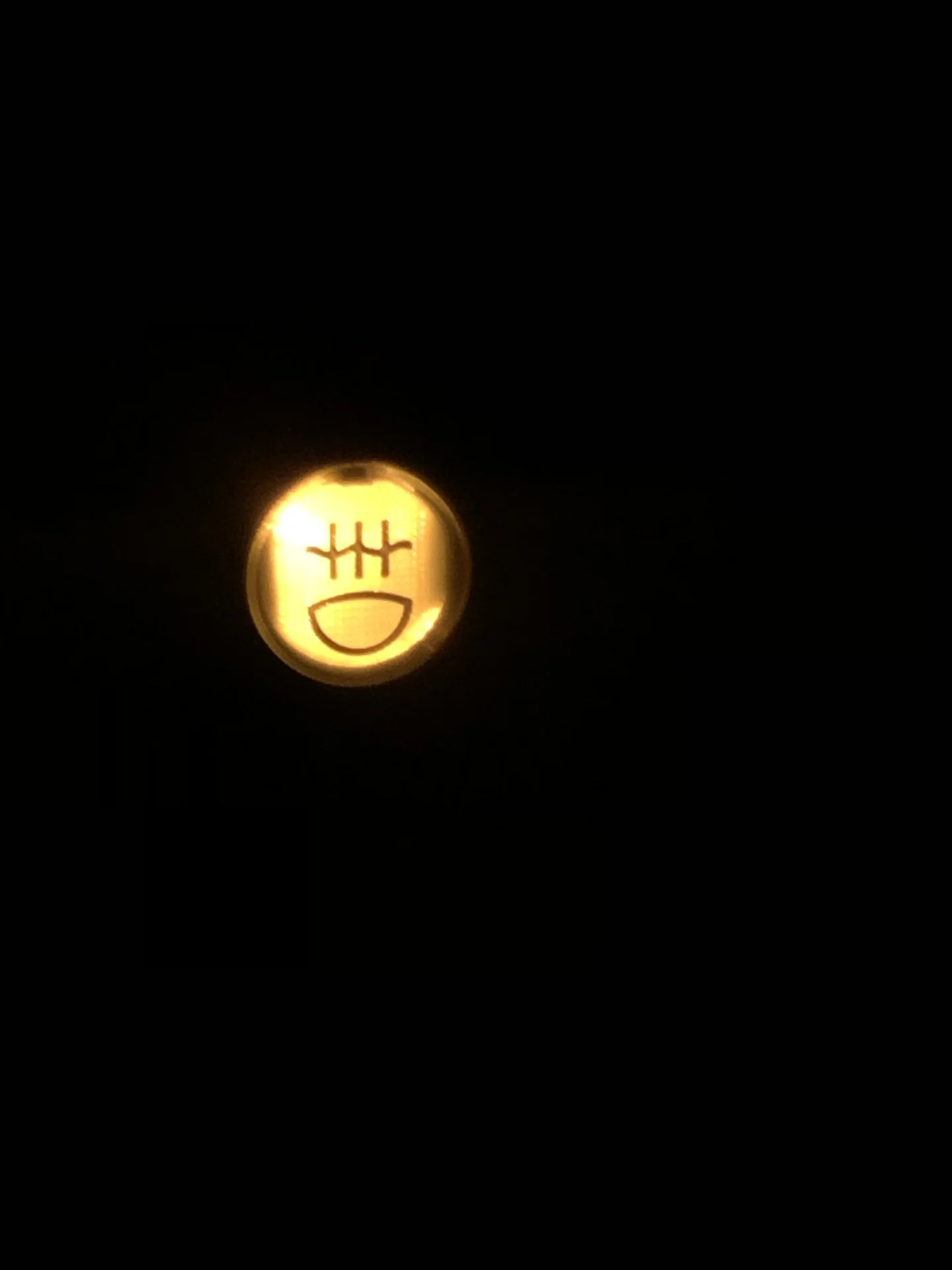

when u have time , lets see it illuminate after dark ...........
Good SHOW !
@ToyotaMatt this is the best I could get with the iPhone....

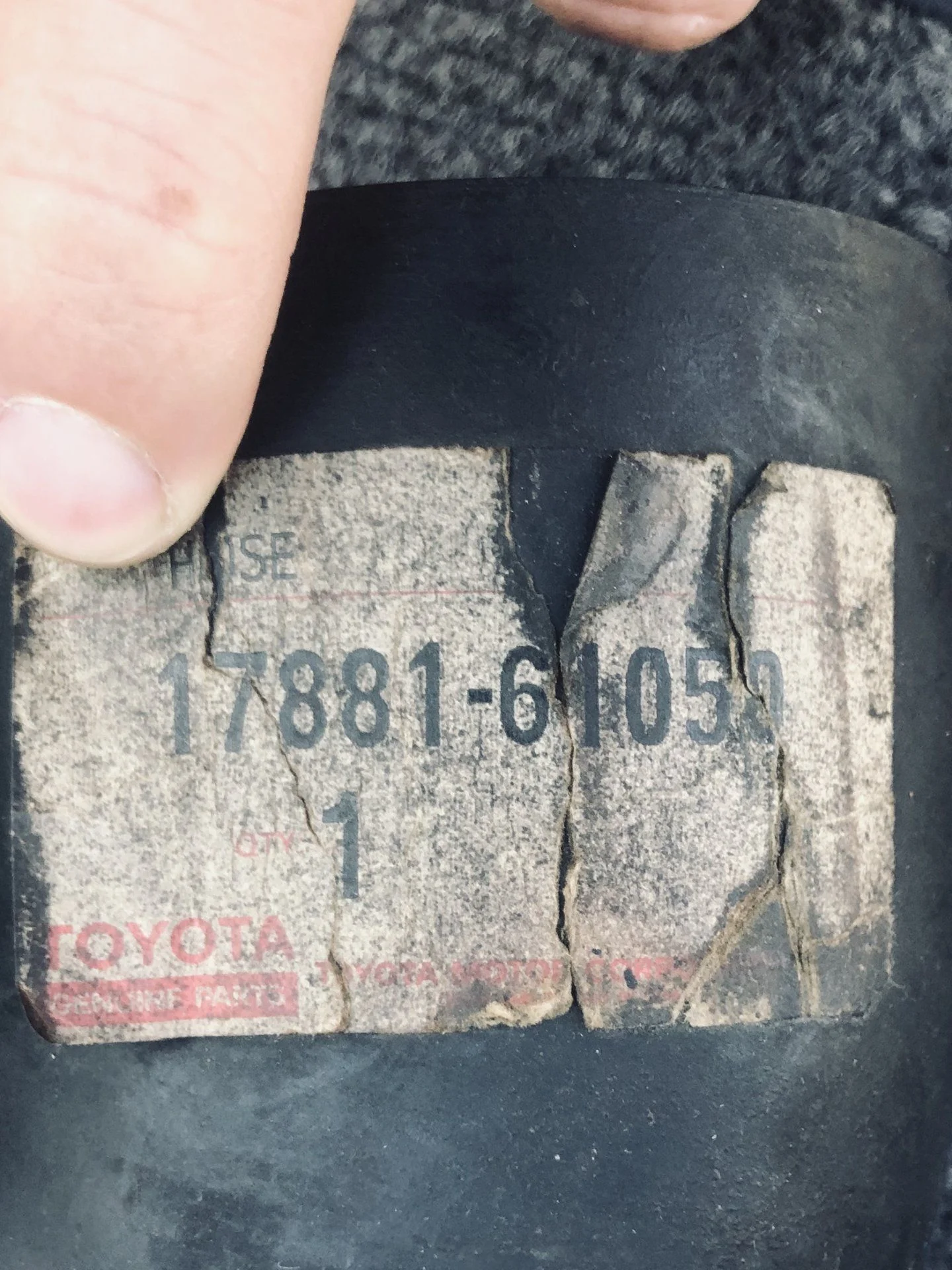

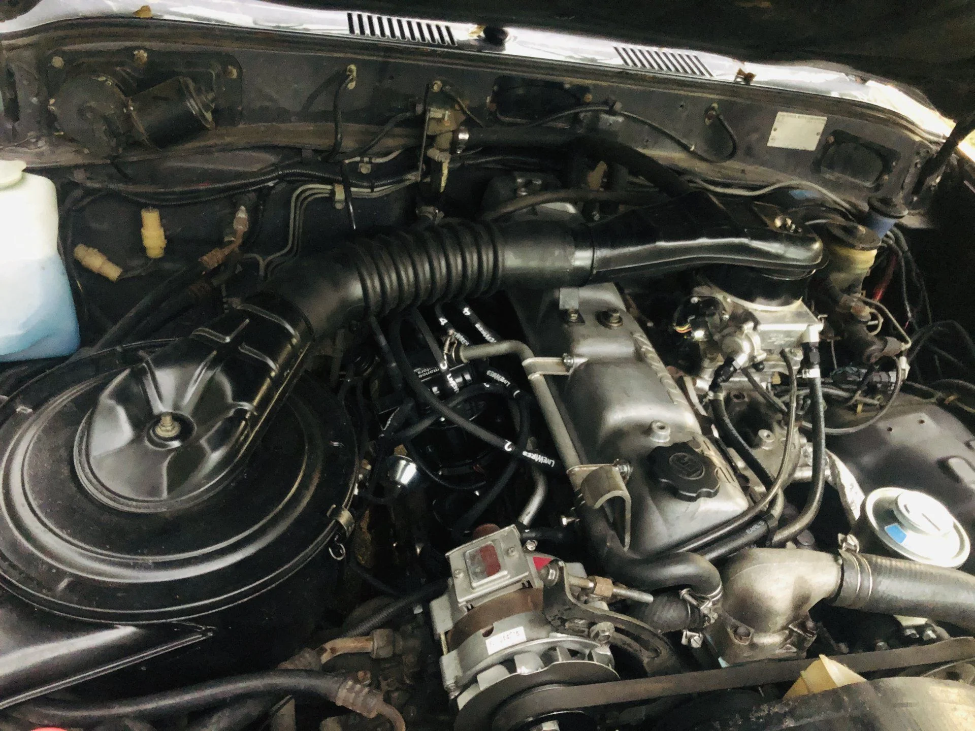

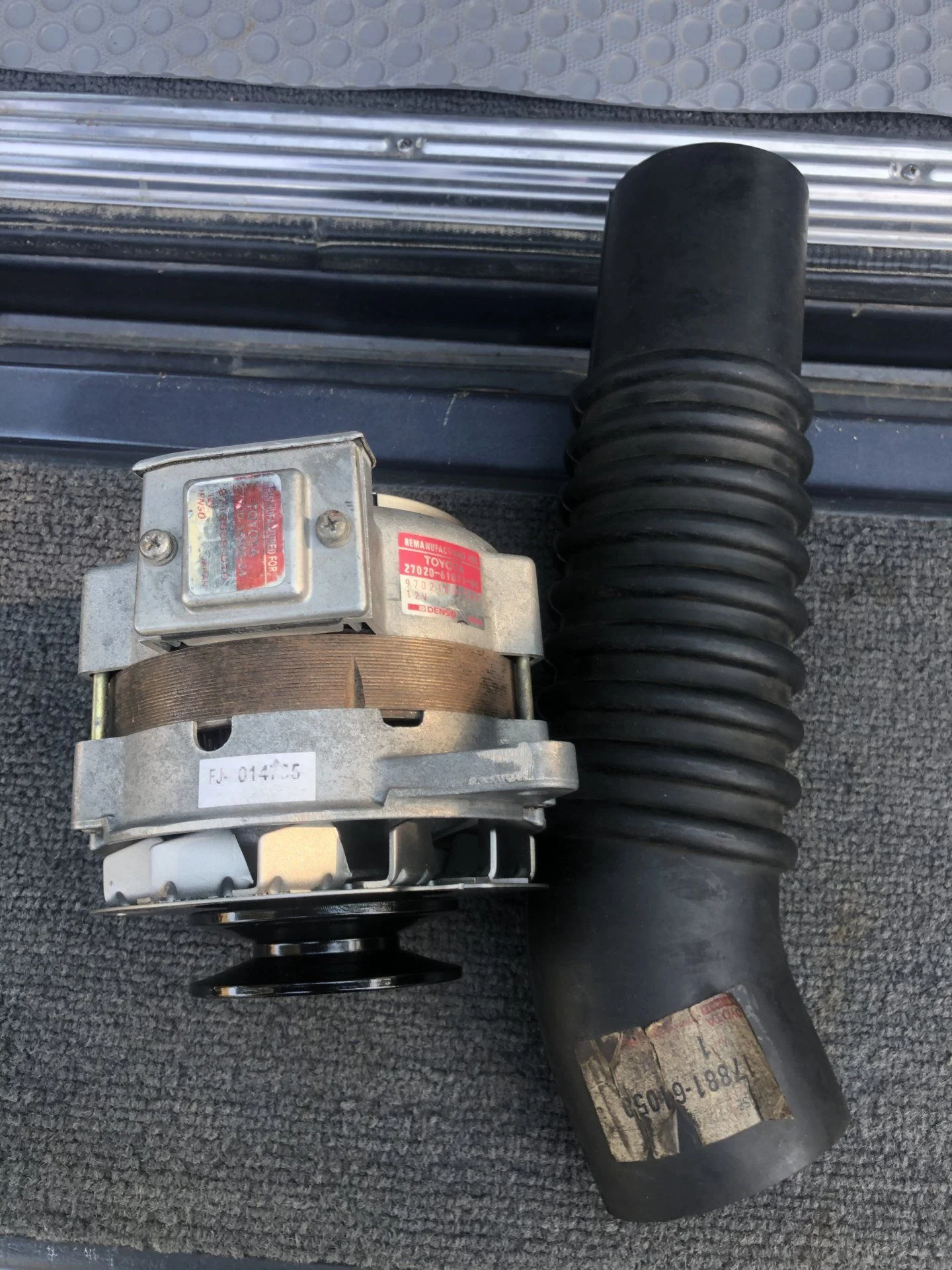

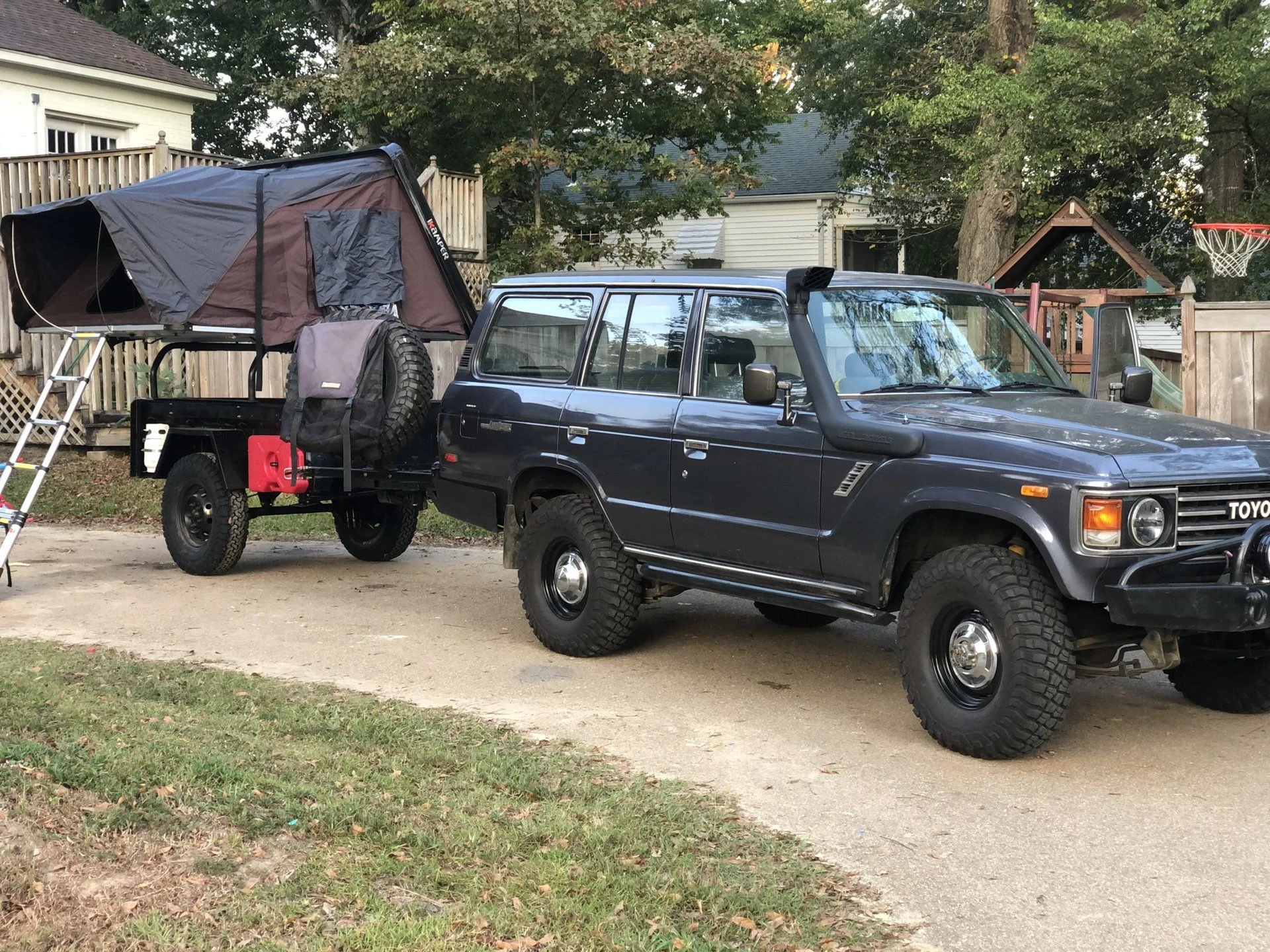

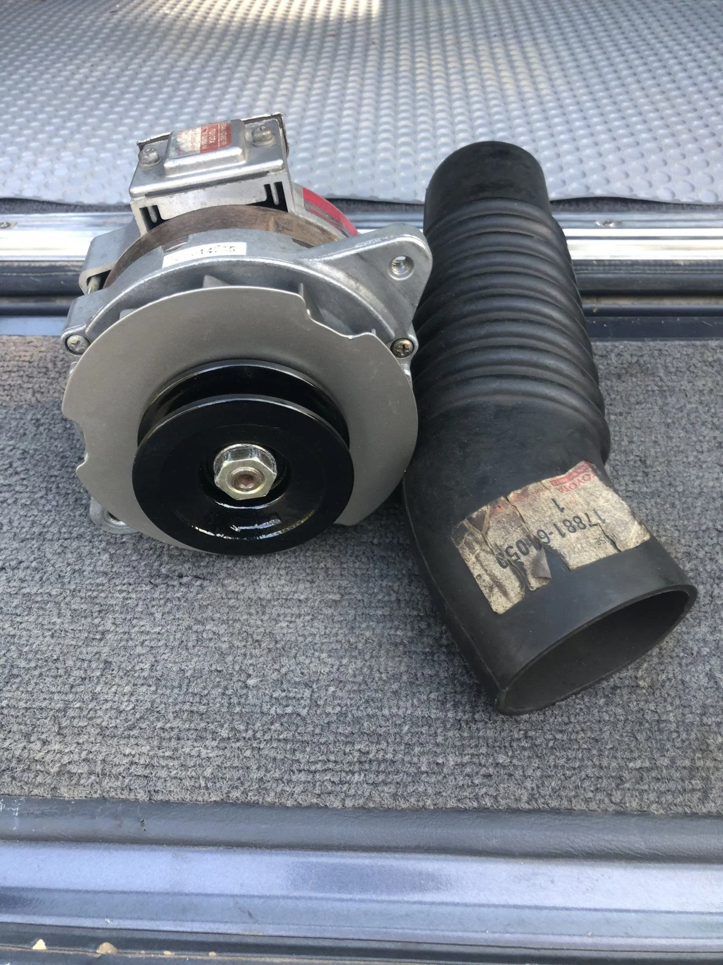

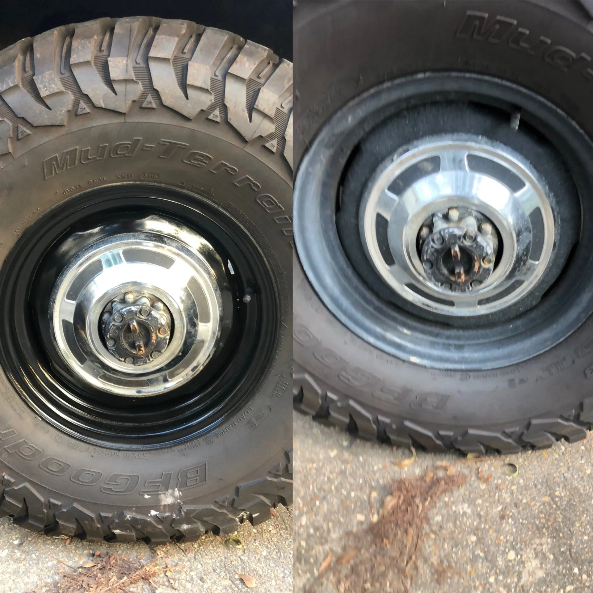

Doing a little Cruiser Crawl prep today and installed two pretty hard to find parts. Thanks to @mattressking for sourcing me an OEM hose for my air box setup. Just need to grab some new clamps. Then @FJ60Cam came through with a hard to find reman Denso 55 amp 60 alternator that looks like an NOS part! I also took the time to repaint my wheels. Oem black holds up like crap. I suggest powder coating before you ever install tires. @wct49 got me squared away with an alignment first thing this AM as well!
Oh, and then I got my AC blowing cold again by retro fitting and converting over to 134 finally. I was blowing freeze 12, but thanks to a lose valve on my high side port it leaked out... however, we are chillin once again.
Part numbers for anybody looking.
