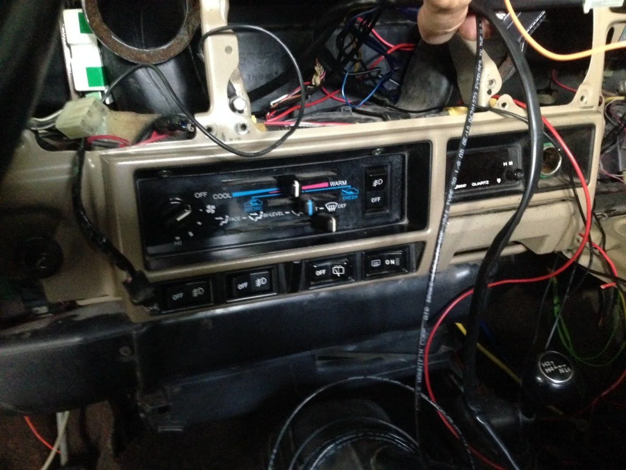

Started taking the dash apart
And decided to poke a little hole in the factory rubber grommet next to the heater hose to run the sensor feed wires for the gauges. I think it looks decently clean and makes the wires and Boost hose a little shorter.
Also presented the switches on the plastic bezel for a little visual motivation :)
Also, found an open/close vent for the dash panel, now I can open and close both side vents of the dash panel

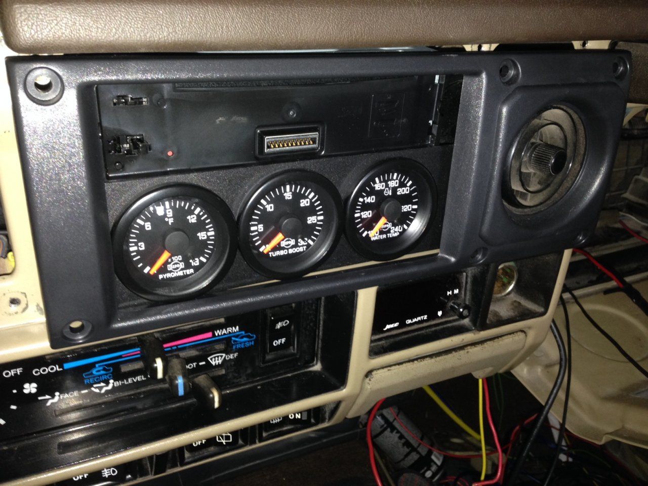

Another photo of the gauges, Wayne's plate is very nicely made
And as you can imagine, the fit is tight with the stereo and all the wires behind them
When using Wayne's @crushers gauge plate, you will need to slightly modify the plastic bezel to make it sit flush against the dash and gauges
I asked Wayne @crushers, Karter @ForealBoreal, and Roger @Shes Mad how they have fitted the plastic bezel on their 70's. They mentioned that you needed to carefully trim the back of the bezel with a Dremel to remove material from the plastic and make the bezel sit flush against the gauges. Thank you Wayne, Karter, and Roger for the input!

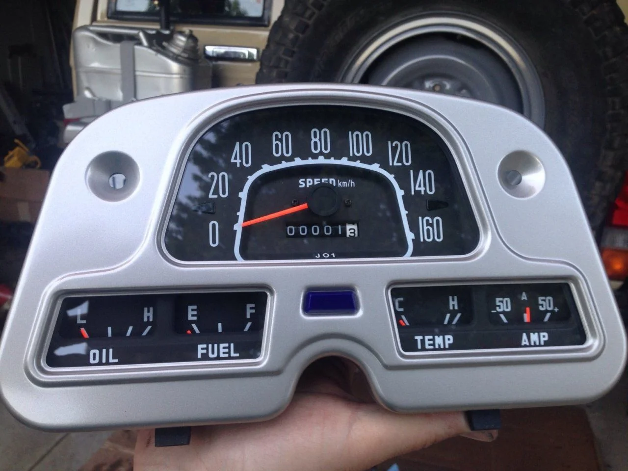

Since we are talking about gauges, I bought this beauty for my BJ40 from Yan @Akella. Yan is a superb vendor and he can find very hard-to-find items from Toyota

That is a beauty. ALL of it is a beauty!
