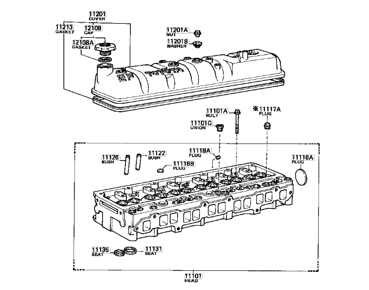

Does any of yoots have a dimensioned diagram showing the bolt hole location for the intake/exhaust mounting holes on the head?

Does any of yoots have a dimension diagram showing the bolt hole location for the intake/exhaust mounting holes on the head?
you simply need the bare cylinder head for your FJ60 2F female fasteners/ threads in the head itself mounting locations and layouts ?
is this what you need as far as the " bolt hole locations intake/exhaust mounting holes on the head? "
I want to draw an exhaust flange with the holes in the correct location. It’s just something to play with for now. I have some ideas and I just want to model them up and see how they look. I can measure the exhaust gasket but I wondered if drawings already existed.
im not aware of a Engineers type cad drawing of a 2f head like that ?
the gasket is your best possible pattern or JIG i would think
