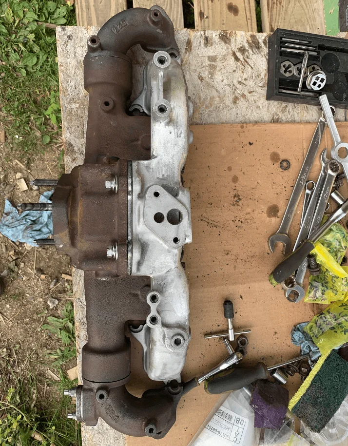

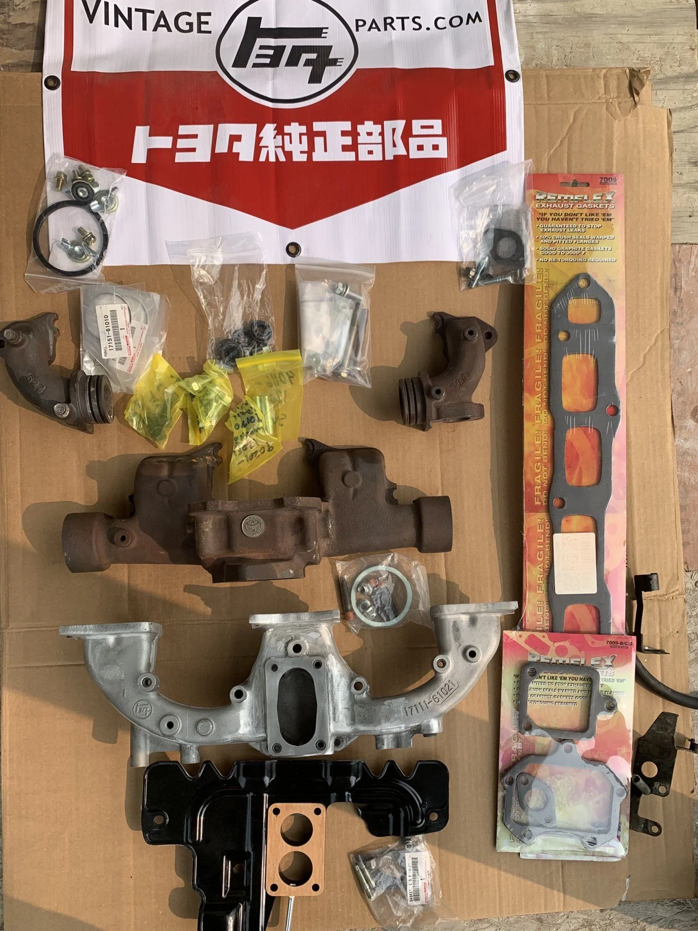

Been a crazy year and finally have a break to start putting truck back together so it can move again. All parts sourced through @ToyotaMatt and a few parts from @cruiseroutfit .
Pre Assembly on my super fancy work bench. State of the art workshop facility
And just like that its in the truck

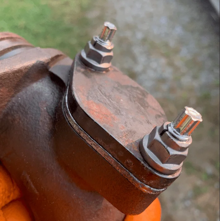

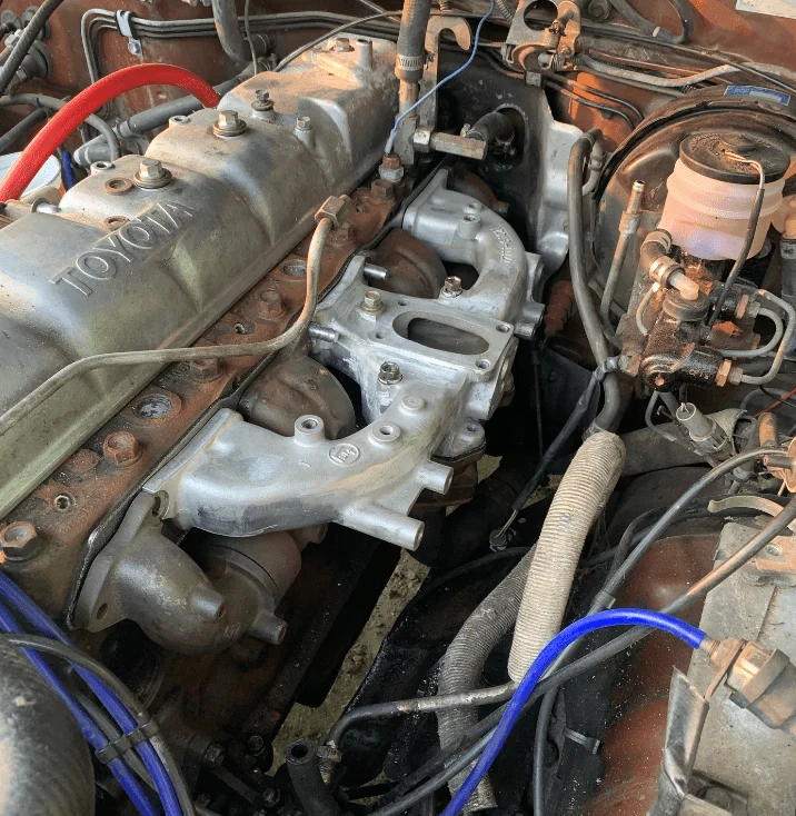

Really wasn't to bad to get it in place. I didn't put the new down pipe studs in until after the manifolds were on the head and then it did take some effort to align the holes. Of course the one fire wall bolt was a pain to get started in the threads but managed. I pulled the power steering pump and bracket out because the pump has been leaking and someone had used the wrong fluid in it prior to my ownership. I was able to spin the pump by hand and pumps a fair amount out. I'll put my city racer pump and new pressure line in soon after I clean up the bracket. Probably pull the driveline this winter to do all new seals and gaskets and clean everything up.

Nice work!! you did it right when it comes to intake / exhaust manifold. Well done.

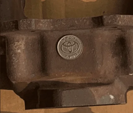

you can get away without having it machined flat using the remflex gasket, but if it does start to leak recommend having it milled flat for the next gasket. 👍
Enjoy a correctly running crusier! getting that job done right, doing a valve adjustment and a lean drop tune is one of the most satisfying things you can do to a 60
The intake and exhaust manifold set I used were match machined flat.
