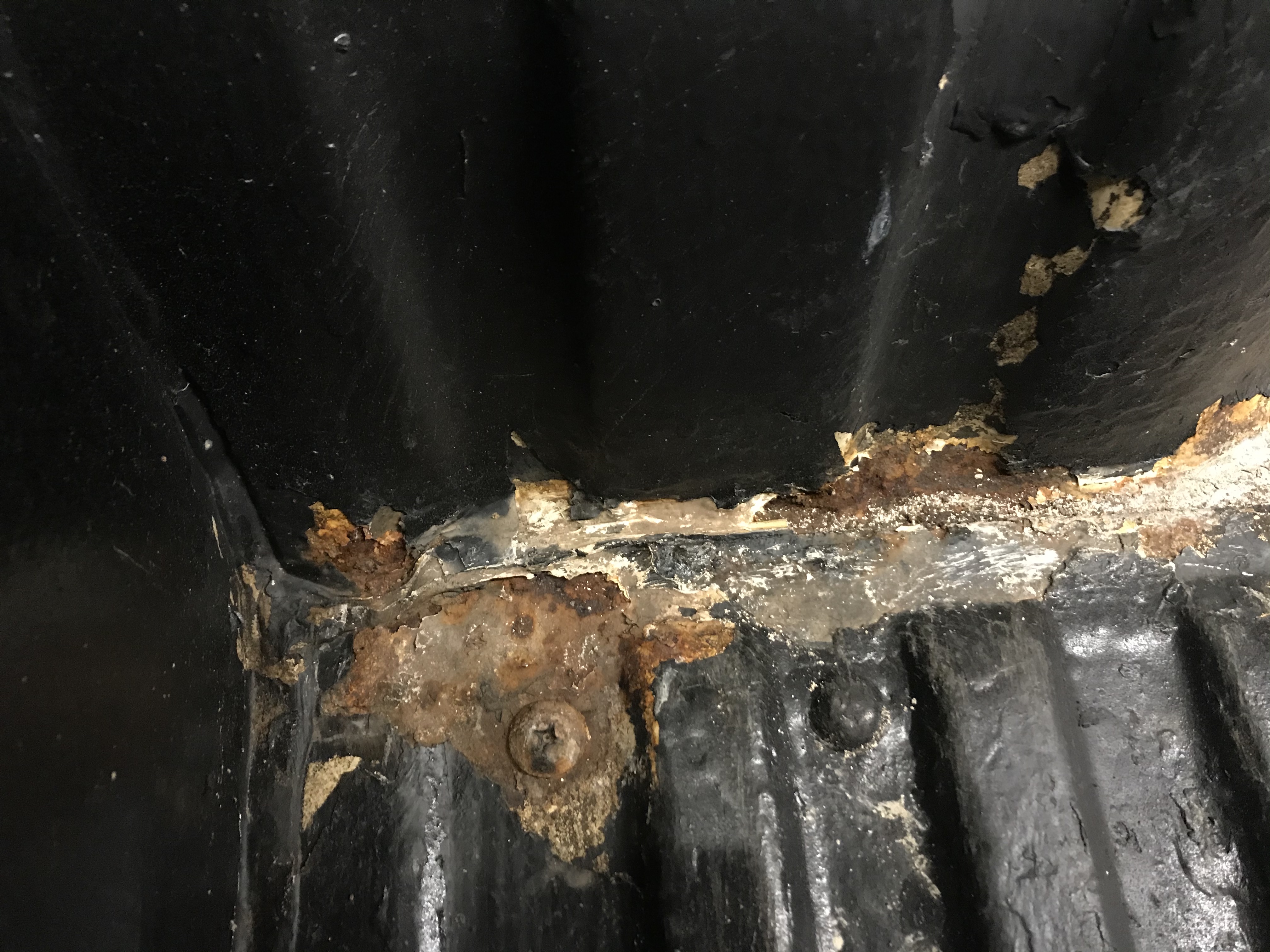

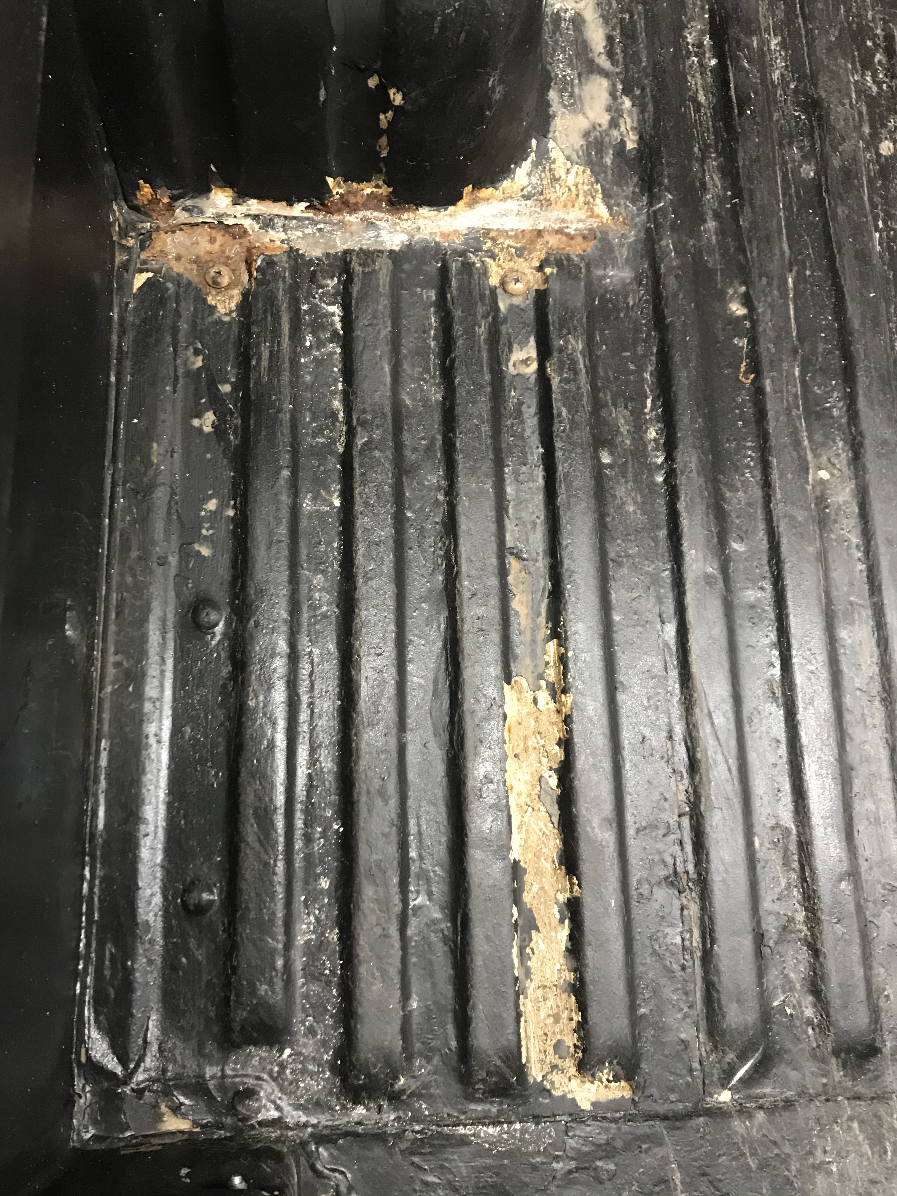

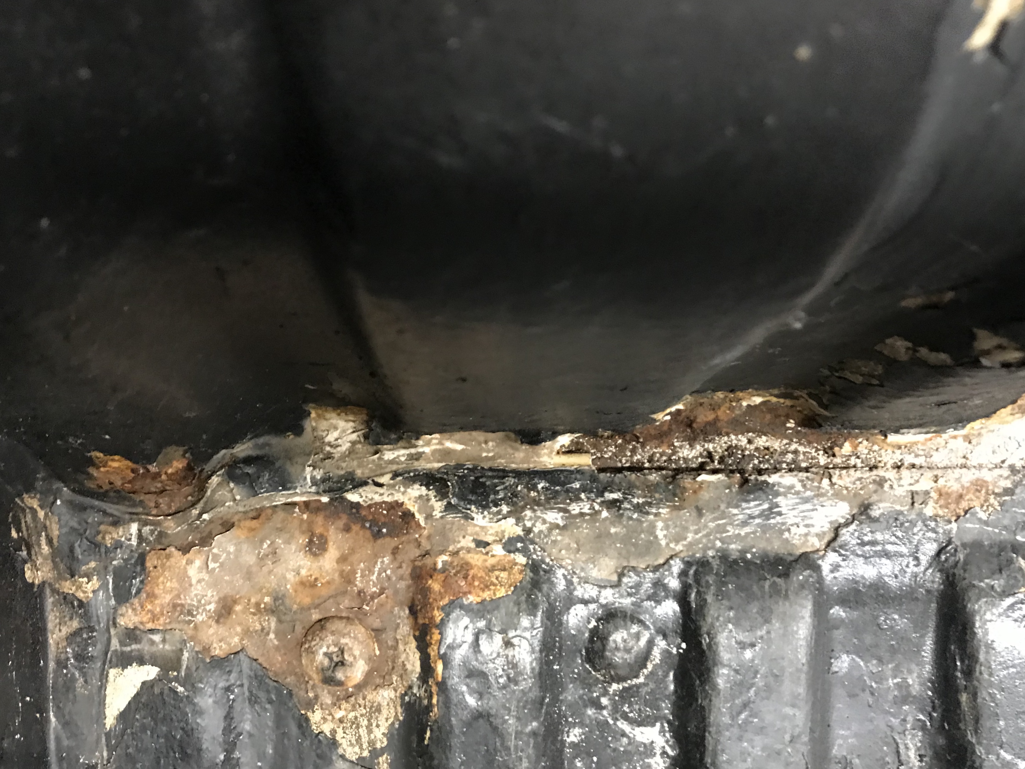

Here are a few photos of the seam in the bed that I was talking about. It is where the wheel-well meets the bed of the truck.
That looks like a quick blast and prime should kill it. On the topic of liner, I’d just stick with the black as it matches all the other accent pieces. I’d also not wrap the bed rails. You don’t want to see that stuff. If you want to protect the bed rails, some 1 1/2” aluminum angle could be cut to fit and attached with double sided foam tape. You could coat the angle with black as well if you didn’t want to see the silver.

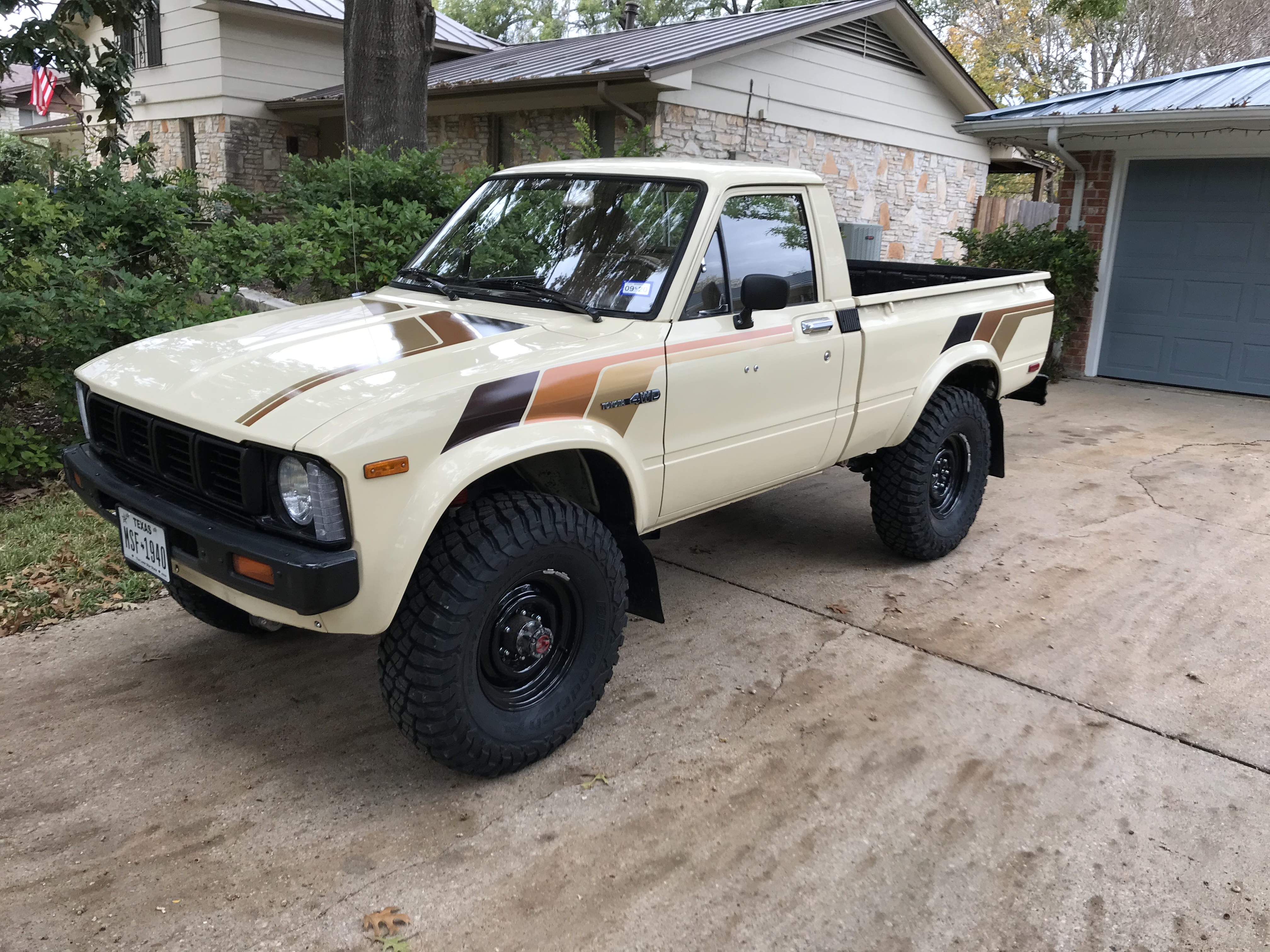

That thing is beautiful. The graphics look fantastic.
Thanks a lot! I’m really pleased with how the graphics turned out. I chose not to install the tailgate graphics because they didn’t quite overlap the OEM painted “Toyota”. And I was afraid they by removing the old “4 Wheel Drive” graphic, I might screw up the original paint.
