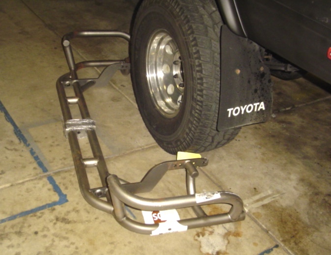

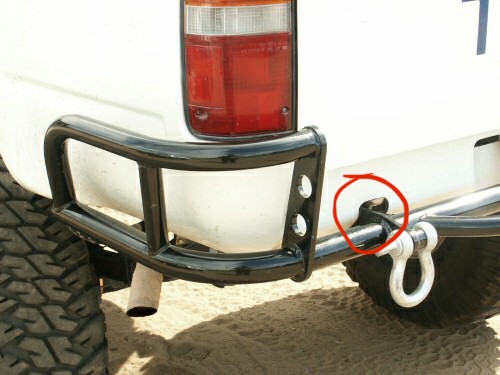

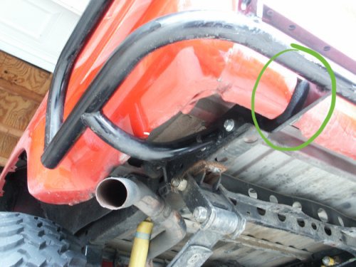

The Marlin Crawler rear bumper requires notching the rear valence of the truck itself for the frame braces to clear. I pulled these pics from Marlin's website and have confirmed this directly with Marlin Crawler on the phone.
Alternatively, the Marlin Crawler rear bumper will clear without notching the rear valence if you use a body lift. You can see this on Big Mike's truck, which has a 1" body lift (and unmodified rear valence).
The 1985-1989 Trail Gear Pickup rear bumper requires cutting and modifying the side braces on the bumper itself (but not the rear valence) to work. This is because the frame brackets seat on the inside face of the frame, not the outside face (like on the Marlin Crawler rear bumper). So the side braces interfere with the bumper sliding into the frame unless you modify the bumper.

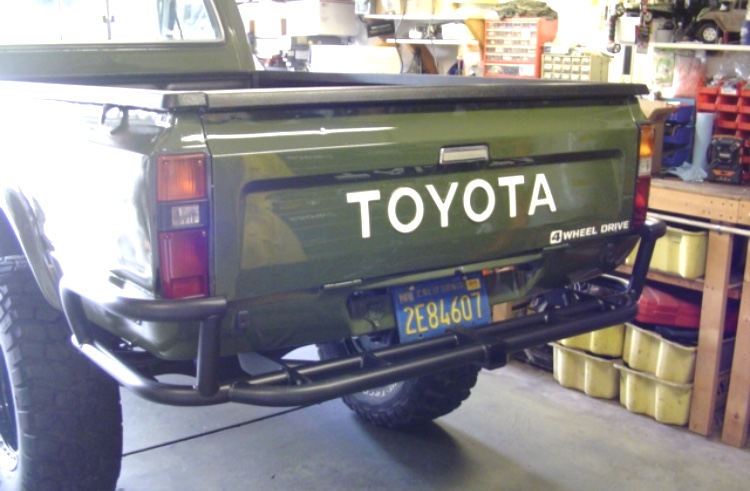

That tube-stuff is all fine and dandy but, by God, it just doesn't look right on these trucks. I had a damn nice RN47 40 years ago and the is no way I woulda hung something like that on it. :meh:

Agreed. It’s hard to find a rear bumper that looks like it’s supposed to be there. They all look like an odd afterthought.

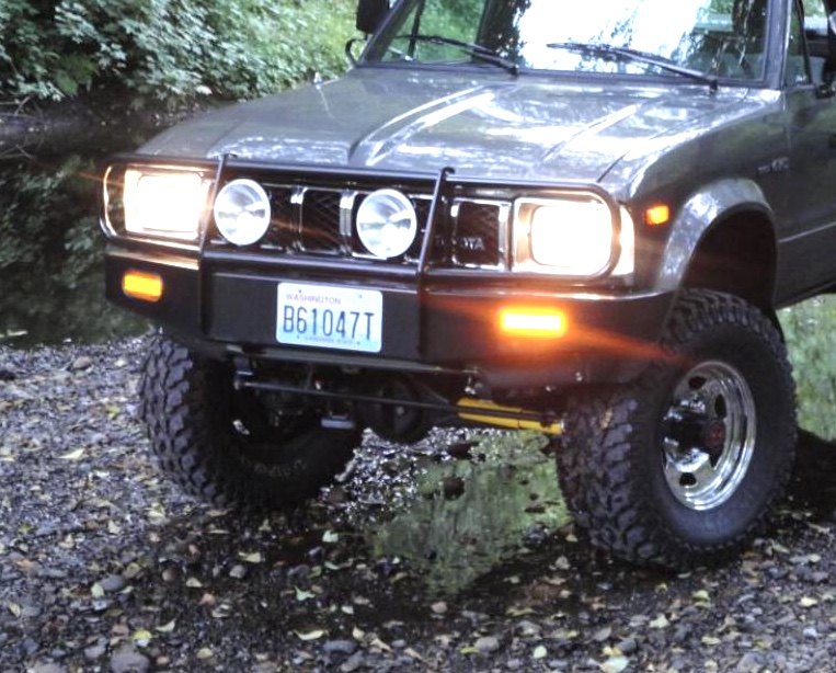

I agree on the tube stuff. It's ironic though... when I searched for a front bumper for my '84, EVERYTHING was tube. I finally found the only ARB left in the country.
Supposedly there is an uber-rare ARB front bumper specifically designed for the 1979 - 1983 trucks, but I have never seen one for sale.
I will just leave this here... Toyota
That one made my short list. But, after paying someone to weld it, paying someone to powder coat it (or painting it myself)... the ARB, at $975, wasn't far off. Plus, the ARB has the vintage style/look that I was after.

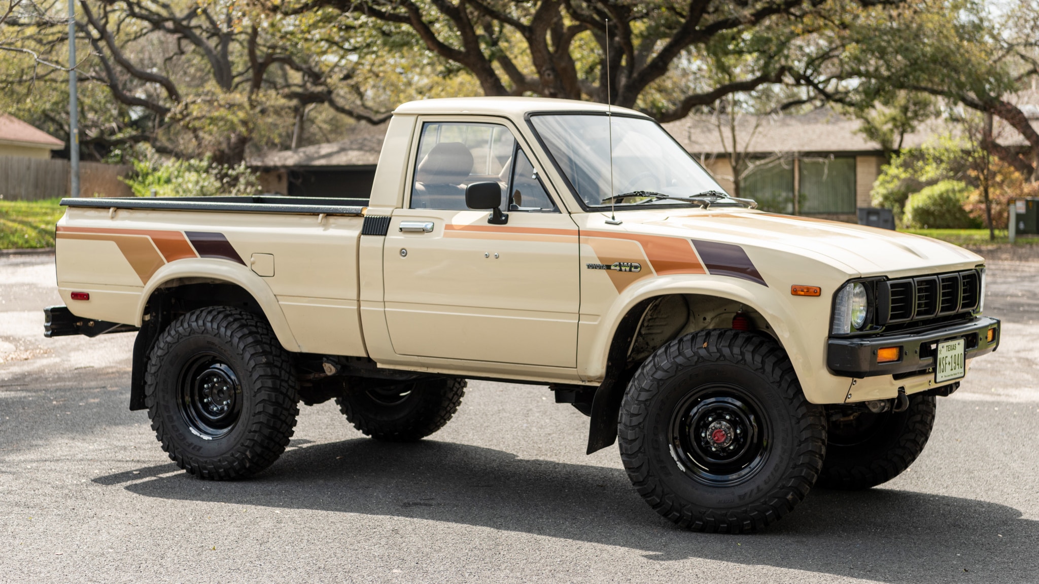

Decided to put the truck on BaT after dealing with a bunch of knuckleheads just kicking the tires.
Bring A Trailer auction is live.
great looking truck. i saw it hit BaT today. Would have loved to take it off your hands when you dropped the price but no room in the stable and can't seem to part with anything. best of luck with the sale. btw, what year 4 runner did the seats and console come from? i'm wanting to do the same with my 85.
Thanks for the kind words!
The seats and center console came out of a 1995 4Runner. The seats were recovered to try to match the rest of the interior.
Glad to see the bidding on the '83 is up into the right range! Good luck!
Thank you so much!
I’m actually not sure I can watch it from here out. #Anxiety
