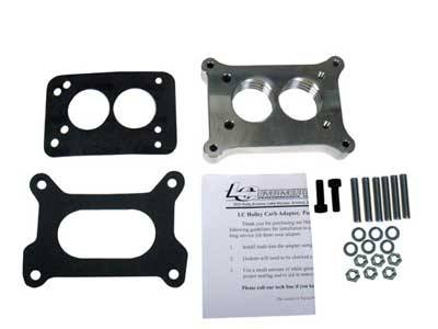

The Pickup currently has lots of LCE Performance products on it that were installed by the previous owner. Including a Weber 32/36 carb conversion and LCE header.
LCE Performance also offers a Holley Sniper kit for the 22R, but unfortunately it is currently unavailable with no ETA. It also requires you to convert to a Offenhauser intake manifold, which I am not interested in.
However, LCE also offers lots of various adapter plates to retrofit modern carburetors to the OEM Toyota 22R intake manifold. The PO used one of these to install the Weber setup. One of their other offerings is an adapter plate to convert to a Holley 350 cfm or 500 cfm 2-barrel carburetor using the OEM Toyota 22R intake manifold.
Holley 350/500 to 22R Manifold Adapter Kit/Spiral Bore
Obviously I am not trying to swap one carburetor (Weber) for another (Holley 350/500). But the Holley 350/500 carb has the same flange dimensions as the Holley Sniper 2300.
I'm not sure why LCE Performance does not offer the Holley Sniper Conversion Kit with just the Holley 350/500 adapter plate instead of the Offenhauser intake. Maybe they just want to sell more intakes? Or maybe the Offenhauser is somehow better suited for the Sniper? I'm not sure.
Either way, I think I could make the Holley Sniper system work on the Pickup with just the Holley 350/500 adapter plate. I would use an in-line fuel pump in case I ever want to go back to stock.
But the truck is already "not stock" with the Weber conversion. Might as well be "not stock" with fuel injection too. Also, the LCE header the PO installed has an O2 sensor provision already welded in place. All I have to do to plumb the Sniper O2 sensor is buy a 2-bolt oxygen sensor to thread-in adapter plate. Simple!

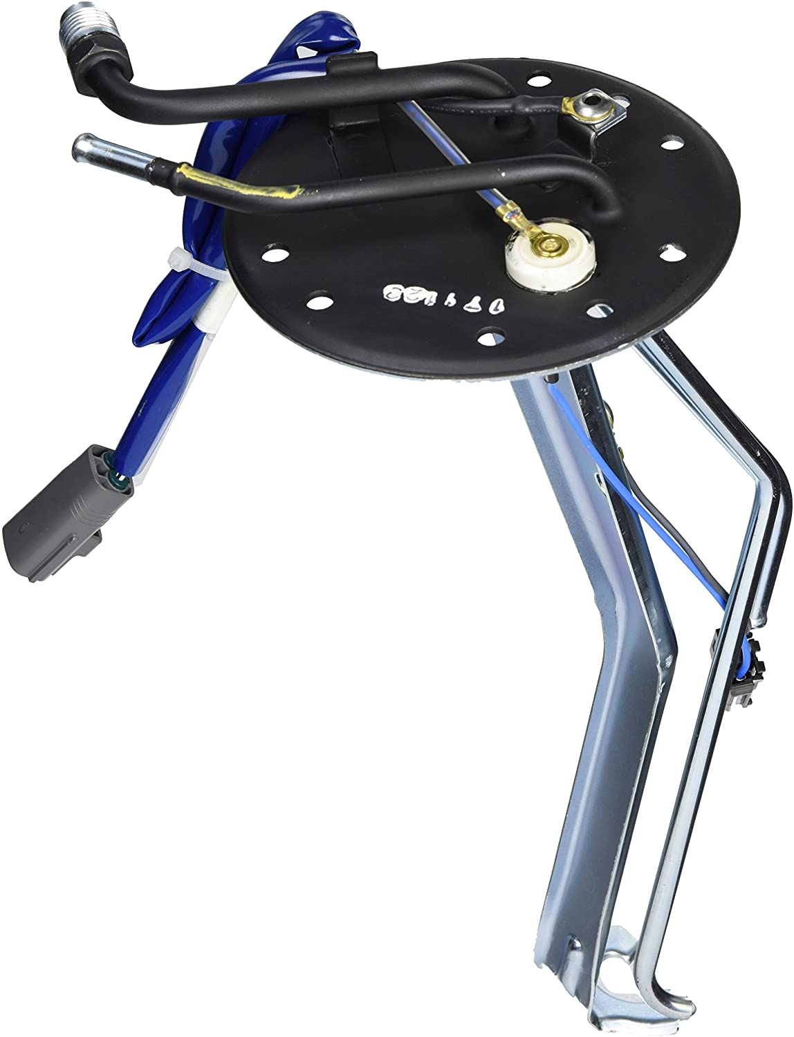

I want to proceed with the Holley Sniper install, but I didn't want to cut up my perfect OEM fuel tank for an aftermarket fuel pump (I used an Aeromotive Phantom setup on my FJ40 that requires cutting a 3.25" hole in the tank). And I don't want to run an external in-line pump. So I figured I'd just order a new fuel tank and retrofit an EFI fuel pump to the tank...
But I had a helluva time trying to find a new tank. The tanks for the 1983 short bed Pickup are NLA from any parts warehouse and are uniquely shaped. They have a 13.5 gallon capacity and are approximately 31"x16"x12" with a pyramid shaped top.
All of the tanks I could find were either 17 gallon or 19 gallon and at least 37" long. Way too big for the space on the 1983 short bed.
Finally, I stumbled upon a photo of a late-model Pickup with the correctly sized/shaped tank! It is a 1986, standard cab, short bed, 2WD Pickup model that has a 13.7 gallon tank and the correct size/shape. It's a Spectra Premium T09A available from all major parts stores for $150 (Also, Dorman PN: 576-213).
What's more, the 1986 to 1995 Pickups also came with fuel injection. So you can order the Spectra Premium T09B (Dorman PN: 576-214) with the correctly sized fuel pump hanger flange for a Toyota EFI fuel pump and hanger.
I also ordered a 1992 Pickup Short Bed, Standard Cab, 2WD EFI fuel pump hanger from Toyota ("Fuel Pump Mounting Bracket" PN: 23206-35240).

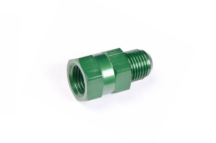

I also found this unique adapter from Radium to convert the M14 inverted flare on the fuel hanger to -6AN.
I still need to receive all the parts and do a final comparison, but I'm fairly confident this setup is going to work. What's more, I can use an OEM Toyota tank, hanger, pump, and lines to plumb the Holley Sniper.
