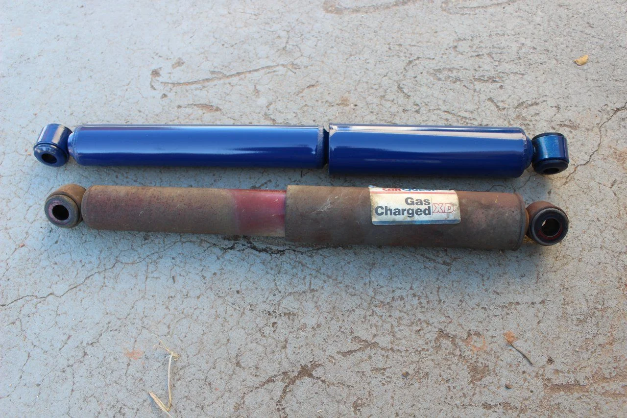

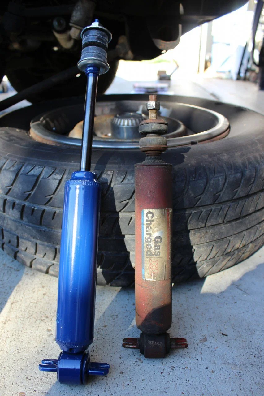

So today I changed the front brake pads and the shocks all around. I have new discs but I need to replace my brake lines. They were fairly far gone so I figured I'd do those jobs at the same time and then bleed the brakes once.

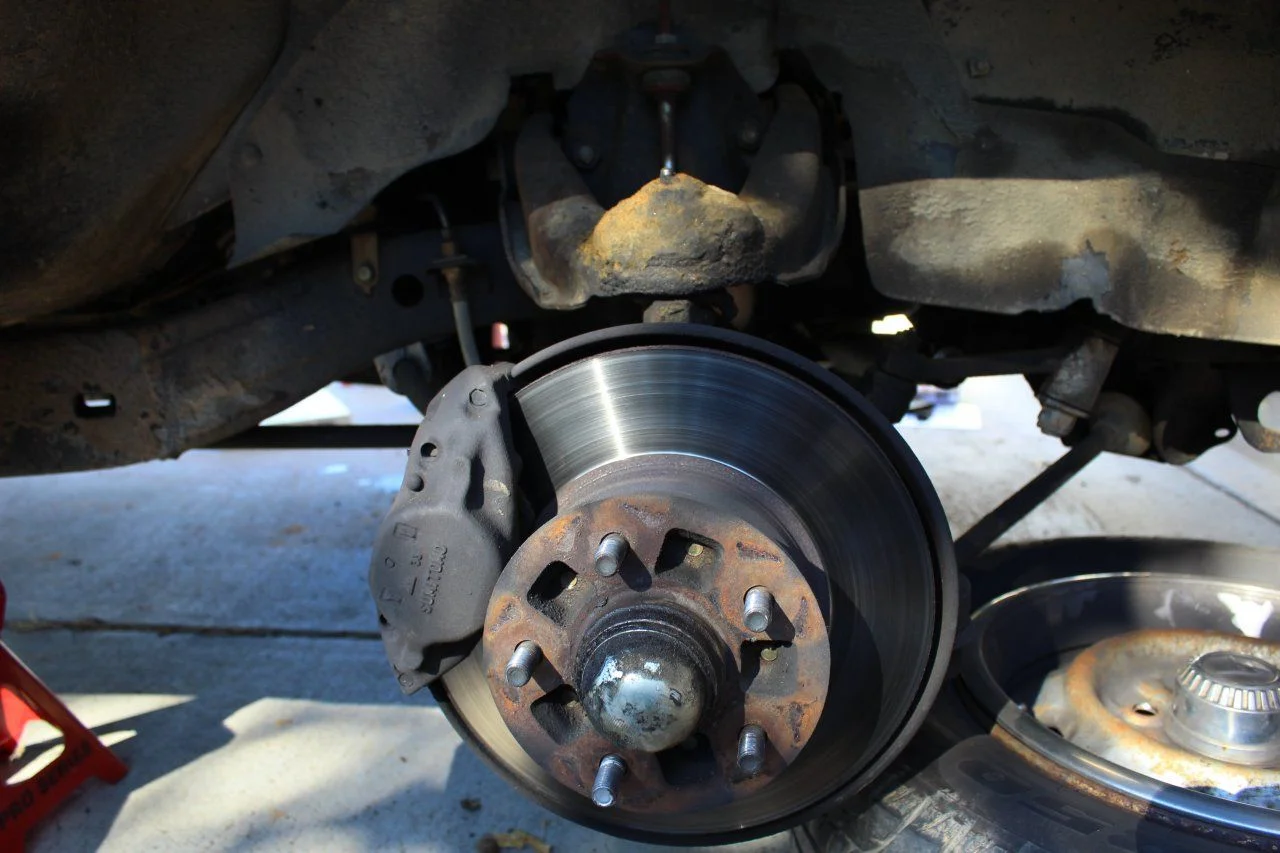

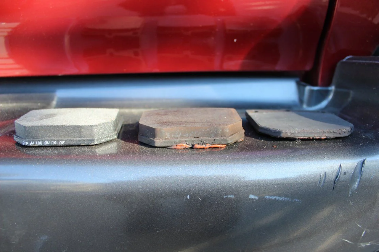

The big surprise was that only one side of my calipers seem to be working. The pad wear is completely gone on the inside pad but the outside pad looks brand new. What are the odds both calipers stuck at some point in the last (lets call it 50000 miles since I have no idea when the brakes were done last)? Is this indicative of a different problem? I have no idea what it could be but the caliper since both sides of the caliper are fed from a common line. Left to right in the pad photo is New, Outside Pad, Inside Pad.IMG_6441.webp
Anyone know if the calipers are still available from Toyota? Should I go OEM or is this an instance where aftermarket is ok? How about the brake lines?
Also I noticed my muffler looks like a crushed beer can, so it looks like I'll be getting a new muffler back...
New rubber is also on the wish list as the dry rot is getting evident.
So to summarize:
Are the calipers for a 2wd 1980 pickup available from Toyota?
Are aftermarket calipers a good option even if they are available?
Anyone know if they make rebuild kits?
Are the brake lines available from Toyota?
Pictures below for your viewing pleasure since I know were all really Toyota voyoures.
