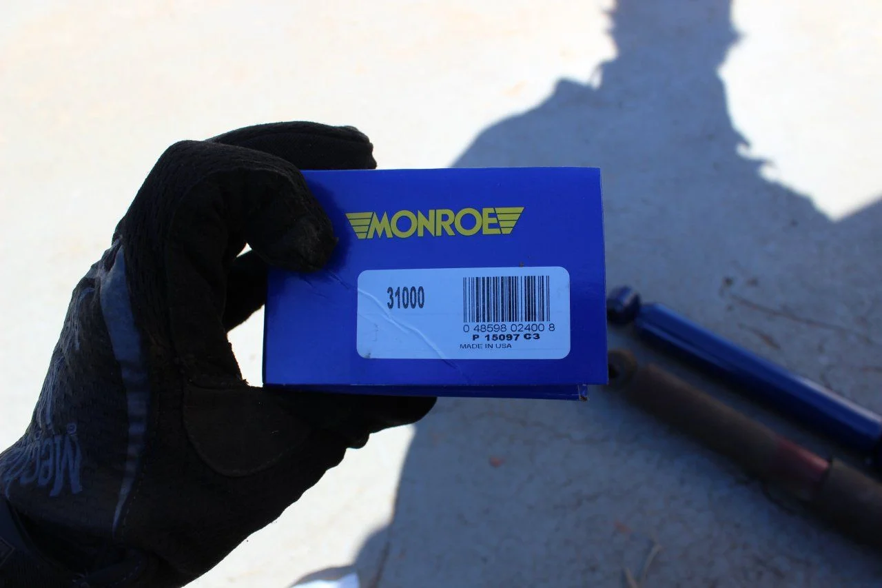

IMG_6448.webp Here is a part number picture for the back shocks.
