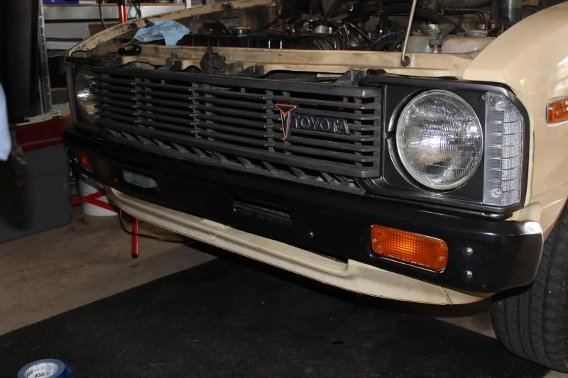

I rewired the new corner parking light and installed it tonight. Looks great. The front bumper is scheduled to show up tomorrow. Tuesday I'll take it and the rear bumper to the powder coat shop. Tomorrow I'm going to adjust the valves, which I've never done before so that will be an adventure. Hopefully that will cure the back firing rough warm idle problem I've got. If that doesn't work it's a carb rebuild for me.

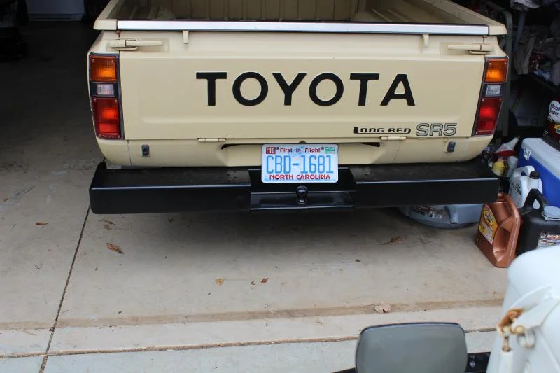

I've got the bumpers back from the powder coaster and installed. I will take some pictures tomorrow. Truck is running great but I have the idle set a little high and the truck still backfires when you shut it off. I guess a carb rebuild is in order...I can't imagine the carb is too different from the aisin on my 40 but if anyone has any advice I would greatly appreciate it. Work has continued on the land cruiser this week. Check that thread for info. Have a great holiday everyone.

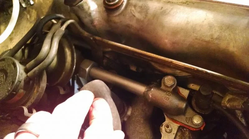

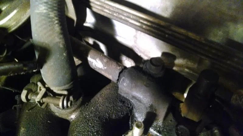

Well there's your problem right there... EGR valve to intake. Cracked all the way around. Currently doing a full carb rebuild. I started a thread in the forum to document. I've already found several issues...broken vacuum lines, plugged vacuum lines, etc. this should be a big positive to truck operations.

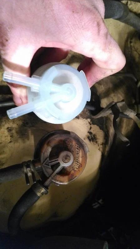

Installed a new fuel filter since I was in there and I had a fellow MUD and ONSC member weld up my EGR downpipe. So a new gasket and that is reinstalled. I love the mud community. The carb is done I'm just waiting on the correct gasket to button it up for reinstallation.
