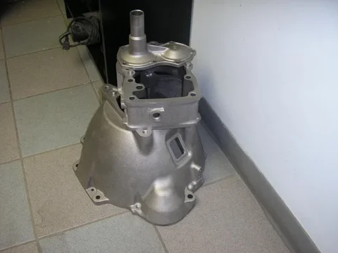

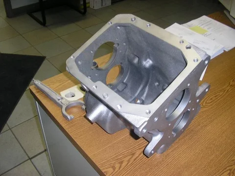

Here are a couple shots of my blasted parts I said I would get... The steel stuff really shows the difference from rusty to shinny

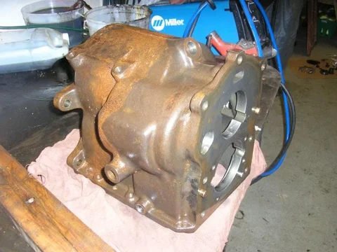

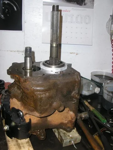

And now to get that last bearing out of the case.
The washers - 3.56" ID x 4.56 OD x 0.125 thk aluminum
Four washers on the bearing
Put the snap ring back on
Stand it up on the nose - make sure the counter shaft is not interfering with the output shaft
Three taps with the hammer on the shaft
et Voila
Pull out the shafts
Washed and ready for blasting tomorrow
