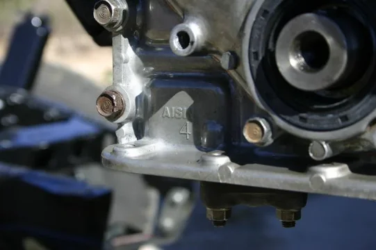

Glass bead and powder is perfect, I have easy access to both. I notice you didn't blast your 3B alum parts but just did a clean and clear powder. Those are the parts that I was told not to blast by an aquaintance of mine - he specifically said "don't blast the aluminum" - and that was why I was asking about it above. without having spoken to him yet I suspect it just comes down to his personal preference. I can't see blasting doing any damage to the covers or cases as long as you don't hit the seal areas etc. to hard.
Definitely doesn't do damage. In this case we just wanted to clear over the original finish. Tried it, and love the results. That said, if there's a spot a brush can't get in to clean, I turn the air way down (30-40 psi) and give it a quick blast with the abrasive.
You can hardly notice the difference. Look to the left of the "Aisin" logo. I blasted there for some stubborn dirt. I guarantee you wouldn't find that in a hundred years of looking without me pointing it out.

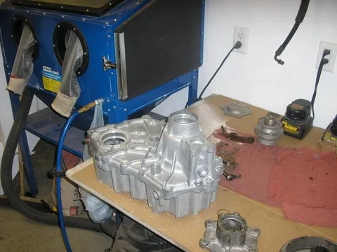

Washed and bead blasted the aluminum cases. Nearly done here - you can see the original darker color on the upper left side there...

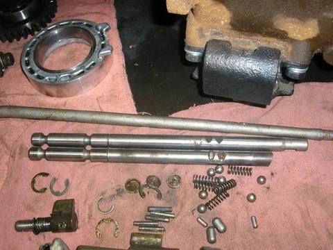

getting things / keeping things organized so I have some hope of finding them later. Stripped the 40 series top plate - you can see the fork bars there center frame
washed the bell housing and top plate - will blast Sunday.
I showed you guys the PO mod where they cut off the rod to actuate 5th gear - well, I picked up the same rod from a 60 series top from a friend hoping it would work but really had no idea if it would. Turns out they are in fact identical. The only difference between the 40 and 60 series tops is the upper bar (and the shifter location of course). The three fork rod assemblies are the same.

How do you like your PA blasting cabinet? Is it worth buying or would you buy something different if you do it again? I've been eyeballing one for a long time.
8100 feet thats life at altitude I can,t wait for cruise Moab I am just going to lay on red rock and thaw out hope you Canucks can make it , if you do bring me a chocolate bar eh ''''
I think there is one or two from the RMLCA going down to Moab
It works pretty good. Size would be the only complaint I have. Seal all seams with caulking or silicone as you build it and use a shop vac to keep the dust down so you can see. I have a light inside - two would be better. When you open the door it makes a mess on the floor after a while. #7 glass bead is slippery on the concrete.
A couple tips for blast cabinets in general (we have two bigger ones at work):
-Don't put too much media in the hopper - the added weight can prevent the suction hose from being able to pull media up to the gun.
-Keep the air dry - we have a big dryer at work but at home I get a little moisture in the gun and it causes a clump in the gun. Also, I put it away wet one time and got a bit of corrosion in the gun that I had to clean out before it would work.
-If you start to notice the abrasive force trailing off but still have lots of air flow - take your finger off the trigger (or foot pedal) to stop the air - plug the gun with your free hand - pull the trigger. This will force the air down the suction hose backwards and blow out any debris that may have stopped the media from reaching the gun.
