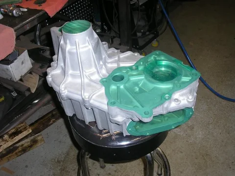

Masking
Clearance for the Toybox

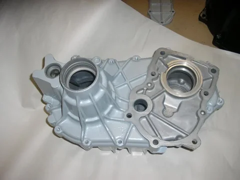

Powder done. Went with a silver (RAL9006) at the last minute for the aluminum and gloss black on the steel

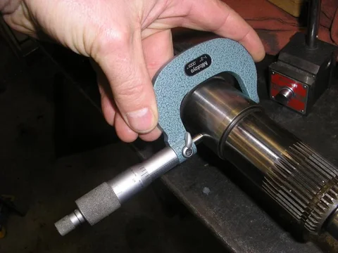

Measuring up
More measuring
Annnnnnd more measuring

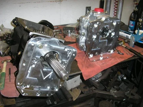

bearings in - now for that Toybox install without instructions....
I took 0.100" off the fifth gear fork bar (thanks Rufus!) because it hits the adapter plate preventing fifth from fully engaging.
And I did not receive the spacer clamp thing that is required for a 5spd toybox install. Again, I had to glean that from another Mudder's frustrated posts.
For those contemplating the toybox and all it's lack of info - it's really not that bad. Use the search function and for god's sake - dry fit, dry fit, dry fit everything. I still have to cut the output shaft but I will do that at the last possible opportunity after I have the first adapter plate fully mounted.
for you eagle eyed lurkers - the fifth extension housing is not yet permanently mounted in this shot. I still have to install the fork arm thingy.
So that's where I stopped as I cannot go any further without the clamp that supports fifth gear. I suppose I could mount and assemble the transfer to the toybox but that would be a bit cumbersome to assemble and test fit later. Also, I am going to order some new bolts and bits so I'll wait for the parts to continue.

So what are you using for masking, this looks like it would be a lot faster than newspaper and tape :meh:
BTW, cool build :cheers:
That green stuff is high temp plastic masking tape for powder coating. It can take the heat of the oven without shrinking or melting. I borrowed a 3/4" and 2" roll from my PC guy. He also gave me some 8.5x11" sheets of the stuff for some of the bigger openings.
