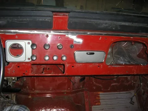

i am thinking move the light switch to the other side and stick the bezel on the left...
I have already pulled the light switch out for the roll cage mount through the dash on the left side. So I will use the bezel with a 60 series tach just to the right of the stock cluster. I will move the hazard switch to the right and delete the lighter and choke and add the headlight switch in there too. Basically only the heater controls will stay put. If I have to I'll lose the ashtray also - never been a smoker.

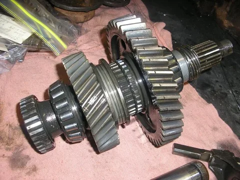

The fifth gear actuator rod coming out of the top plate has been torched off and the fifth gear is locked out with this tab bolted to the nearest bolt. I guess the fuel economy of a 5spd is lost on those miner guys
She was also locked in low range in a similar manner with a bolted tab holding the hi/low shifter in low (already removed)
All evidence shows this system was only ever used in the 4 lowest gears during it's work life. I wonder how many times it actually ran at high speed before going into service :hhmm:

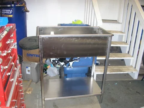

I followed the FSM and pulled off the transfer case. My first one. Pretty simple really, just took my time and a few pictures for reference. She looks fine with no obvious issues, no chunks in the oil. I haven't inspected everything closely yet cuz I had to build myself a parts washer/ wash basin - I'm too cheap to buy one :hillbilly:
We got some new material racks at work and were doing some clean up/ tossing out/ recycling of smaller scraps. I pulled enough stainless out to make this parts washing basin 36x18x12 deep. I made it nice and tall cuz I hate being hunched over when working. I just put a simple drain at one end and let the slope of the garage floor get the fluid into a bucket with a cheap submersible pump. Works pretty good. I started cleaning the splitcase case with a "simple green" type water based degreaser but it was taking way to long to cut through the grime. So I grabbed another bucket and switched to good old varsol - much better and faster. My basin design makes switching back and forth between varsol and water based environmentally better solvent as simple as pulling the pump out and swapping buckets.

i have found that soaking the parts in diesel works pretty well.
Home Despot used to sell a orange colored cleaner that smelled very nice and cleaned parts wickedly. run the stuff through a filter and reuse often.
just suggestions.
Thanks for the input Wayne - yeah, the citrus or pine smelling water based stuff would likely work good on the gears and internals but these cases were caked in some kind of sticky oil/dirt/potash mixture and it was slow at disolving it out of the nooks and crannies. The varsol was just faster. I will most likely use the water based stuff most of the time and save the varsol for tougher applications. It (varsol) is tough on the nose and a bit flammable right beside my welding/grinding bench. It will be kept in a sealed container when not in use and I'll have both doors open or a VOC mask on.
