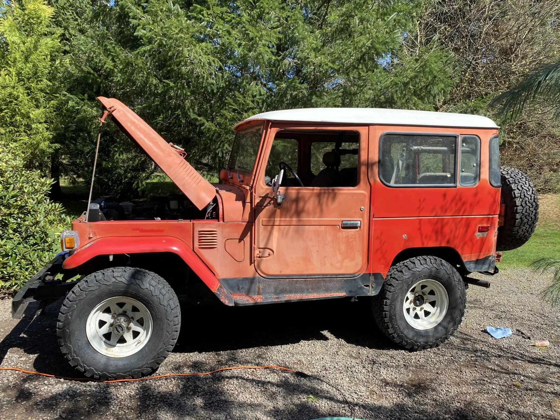

I think I said I was going to take the day off from the Land Cruiser. Well .... my daughter said she wanted to work on it so here’s a teaser of what she has so far! Wow! Hired! Just using some combination oxidation remover plus wax that I had in the garage. Probably five years old. trying to minimize my trips to the store.

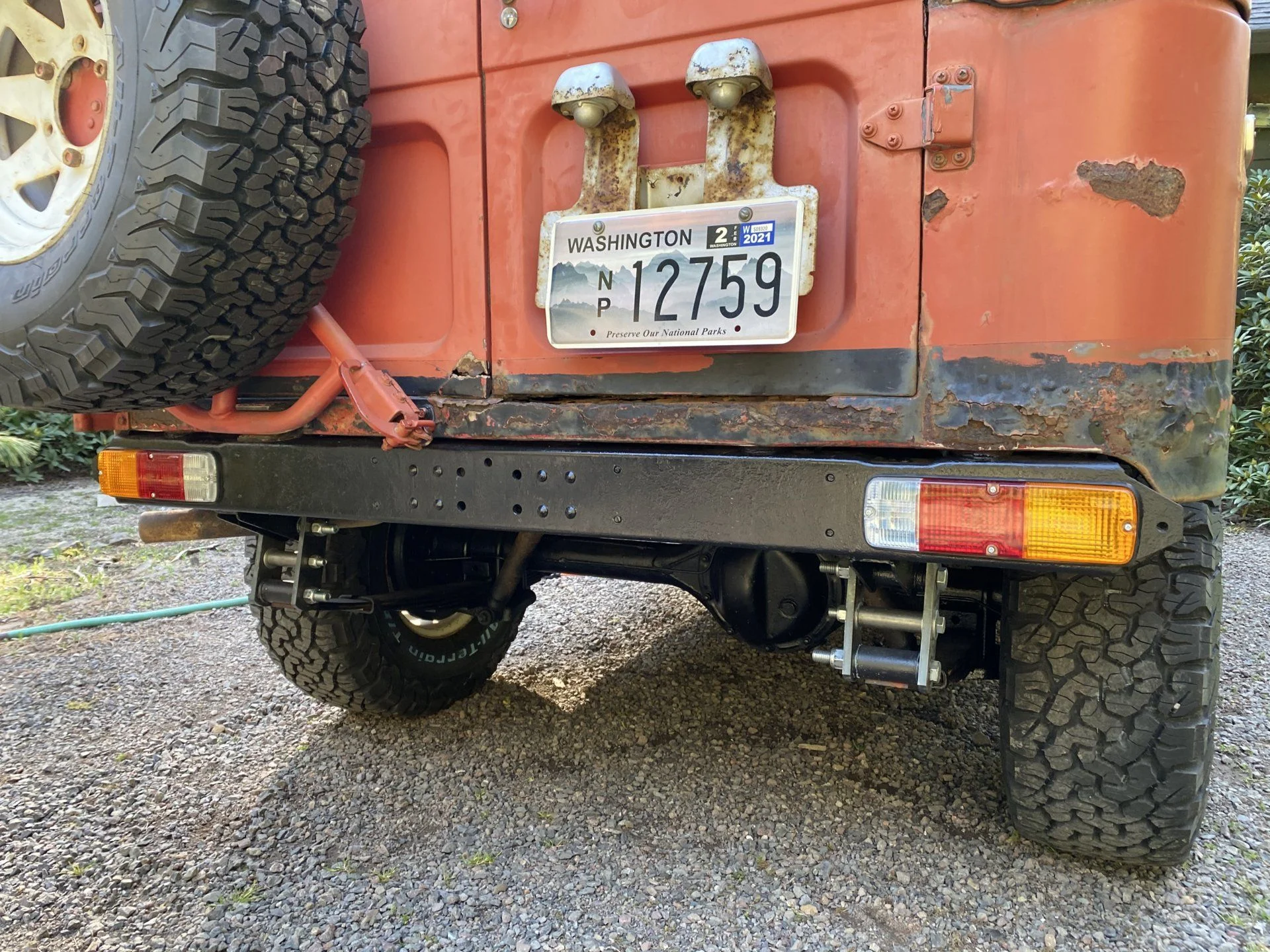

Tonight she is officially street legal! Tail lights installed and they actually work and do what they’re supposed to do! Surprised by that! Woohoo. Got some replacement side mirrors as well. I might try to pick up something a little more aggressive tomorrow for the paint. That quarter panel took about an hour and a half of non-stop buffing with the power wheel.. Trying to ignore that rust for now. Maybe I’ll tackle that next winter. So really all I have left to do is shocks, alignment, and work on getting the windshield wipers working. Then I’m just going to drive it through the fall....and maybe new weatherstripping… rattles like crazy. All the felt is rotten and there’s no weather stripping left on anything...oh and the parking brake...and....😂

Another bonehead move on my part yesterday. Probably spent eight hours on the paint. The polish and buffing wheel was taking forever. Took about two hours just to get the driver side door. Figured there had to be a better way so I went out to my shop and found some sandpaper. Ive been a woodworker for years and 220 gives a glass surface so I found some 400 thinking wow this is going to be beautiful…oh dear. Wet sanded and did a great job of taking the oxidation off. It looked beautiful. Thinking I was a genius… And then it dried. Turned it into a dull, reddish pink. Crap. Figured I could fix it with the buffer. Nope. This morning I’m heading out to get some finer sandpaper. Hoping I can wet sand it with 1200 and maybe a little finer and then back to the polish. I’m really good about creating more work for myself! Photos dont really show how bad it looks but when you compare it to the left rear quarter which we did with just the buffer, the difference is huge. Oh and my shoulders are trashed! 😂

I believe so. I've been calling it "rust red." 🤷‍♂️
After seeing yours, I'm tempted to buff it out, but I'm afraid my paint is in worse shape.
I don’t know about that. Mine was actually a spray over. Decided it would be too much work to try to get to the original paint. right now I’ve been going through sandpaper. Wet sanding with 600, 1000, 1500, 2000. Then I hit it with the buffer and rubbing compound and then wax. I’ve got a lot of time into it but the results are pretty good. I was surprised.
