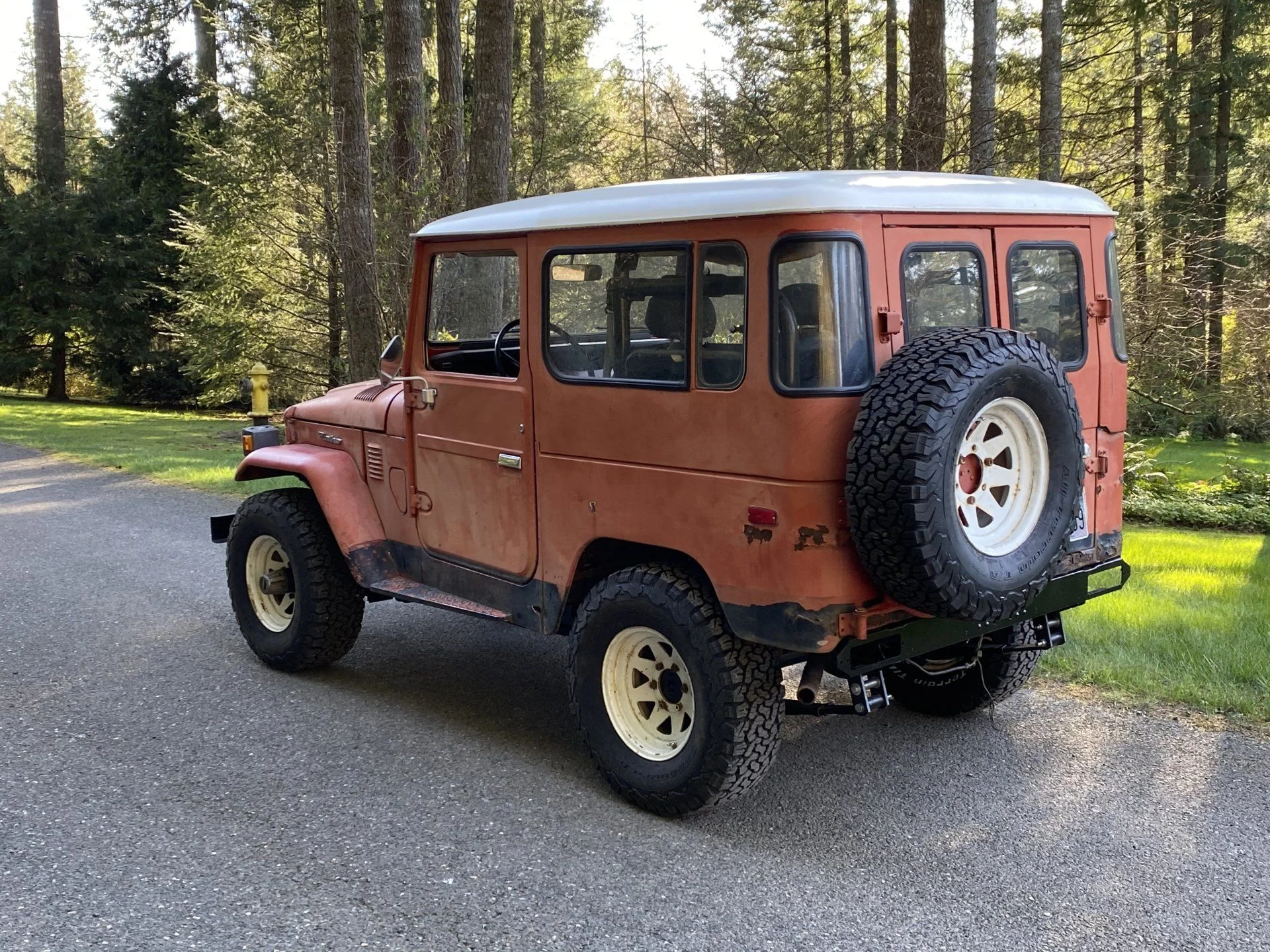

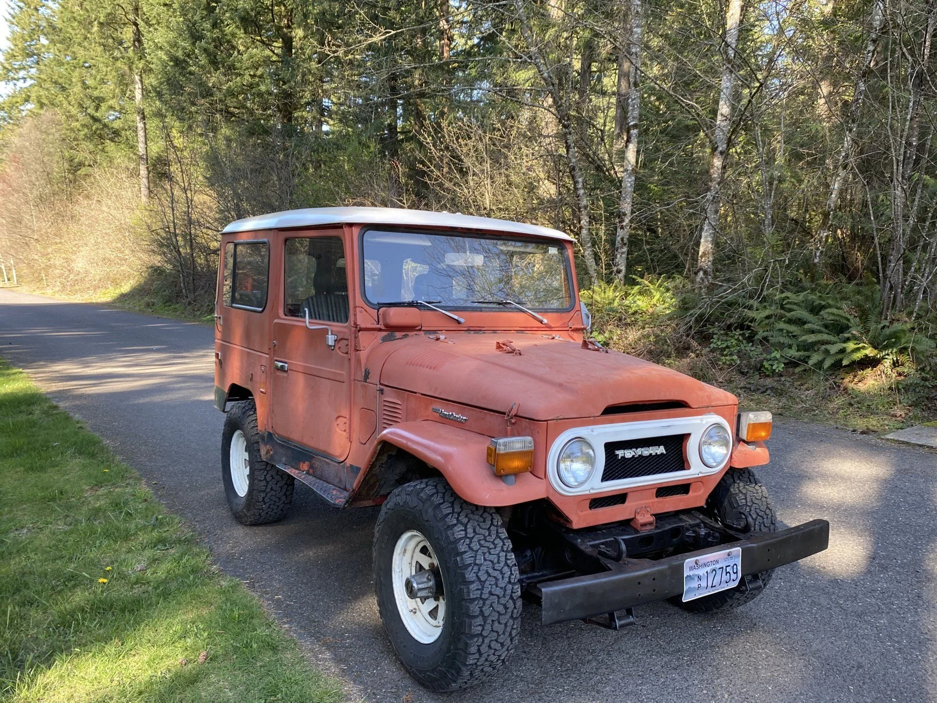

I too was once there. I say paint the top as well. Usually spray paint fades quickly but there are ways to scuff up, dull paint.
Your fender looks great. I would try and get all the paint like that and paint the roof, OEM wheels and drive the heck out of it.
My old HJ45 right before @Wadesters made it amazing. I had to paint the bezel and roof to make it look a little more cruiser like.
That is a sweet rig! My top and bezel look pretty similar! So much better now though!
Woke up this morning to sunshine and the possibility of 70°! Paint day! Didn’t do a huge amount of prep cause to be honest, it wouldn’t look right if it was shiny and perfect. Spent about an hour with the sander, taped it off and sprayed. 4 cans of Rustoleum Appliance paint in biscuit. I’m pretty happy with how it turned out. I’ll let it cure for a week and then dull it a bit with some 400 grit. Also “aged” the headlight bezel a bit. Looks better. Hope it holds up.
It looks really white until you put it next to plain ‘ol white. Then it looks more biscuit...

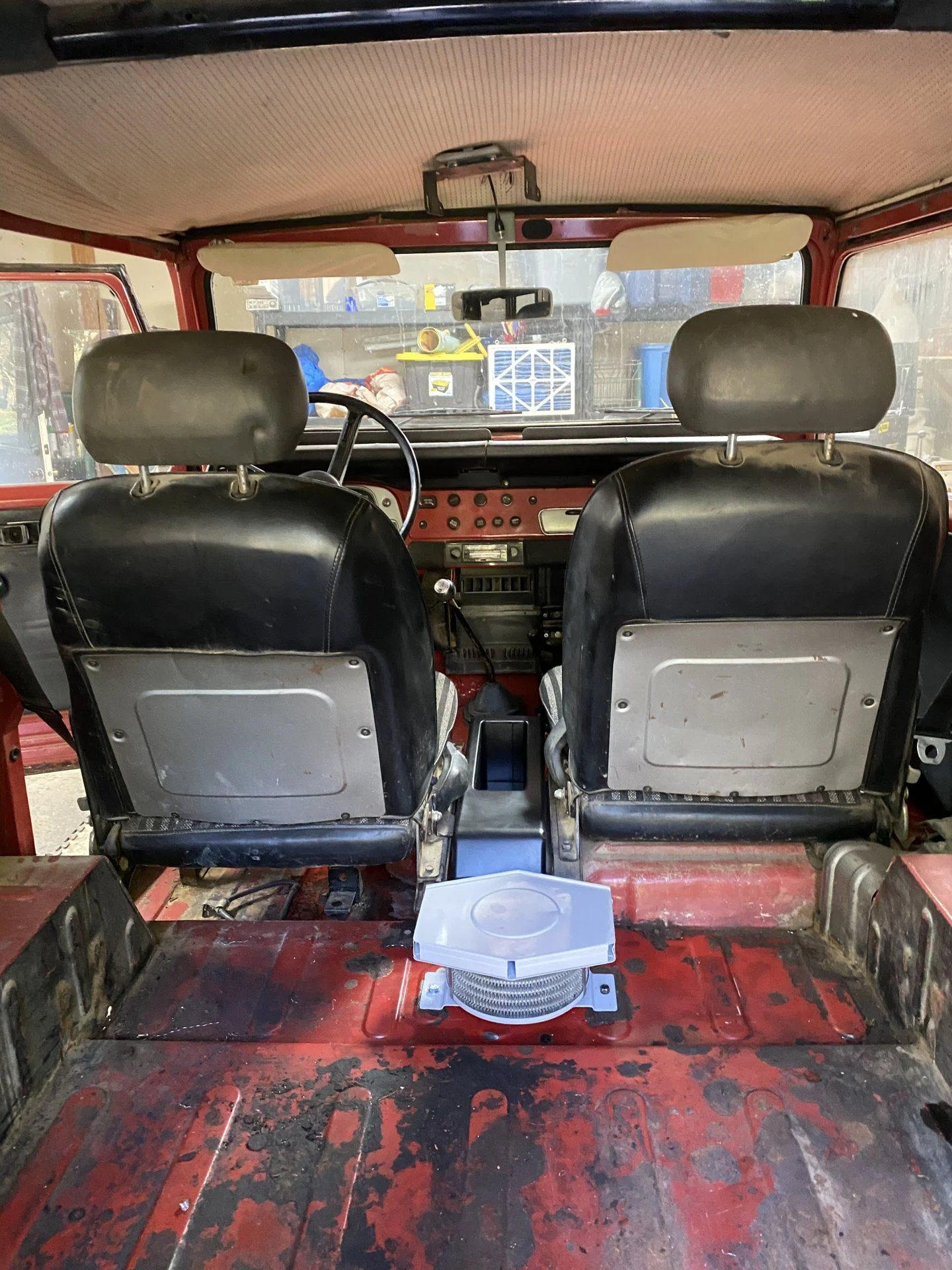

Cleaned and lubed the rear fan and heater assembly. Good news it runs great. Blowers are no longer blowing the fuse. I had read that Rustoleum Pewter Gray is a good match to the interior gray/silver parts. Well....it’s not. I don’t think my ocd will let me live with it. May have to order a can from cruiser corps or just paint it black which is my go to!
Hit that super oxidized red with some compound and a buffer, you'll be surprised. Once you do that the bright roof and bezel will blend in better also.
How much coolant do you lose when you disconnect the lines at the rear heater? Or I guess you can just pinch them off to keep from draining too much.
Lost about half a cup. Was worried about that. There is a low point between the seats so I think that keeps it from all draining out. I put a block of wood under them once I took the core off and it seem to help.

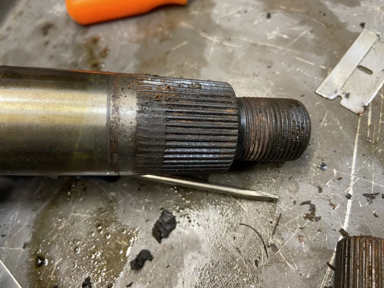

A picture is worth a thousand words. You asked about spline seating on the pitman arm. Here’s a pic of your core:
