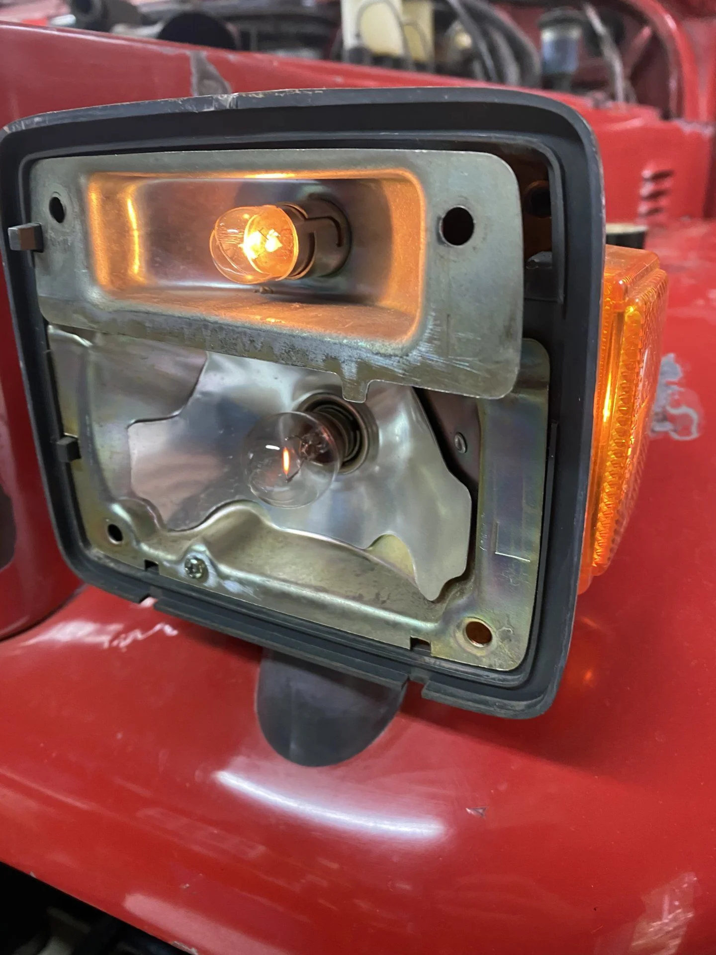

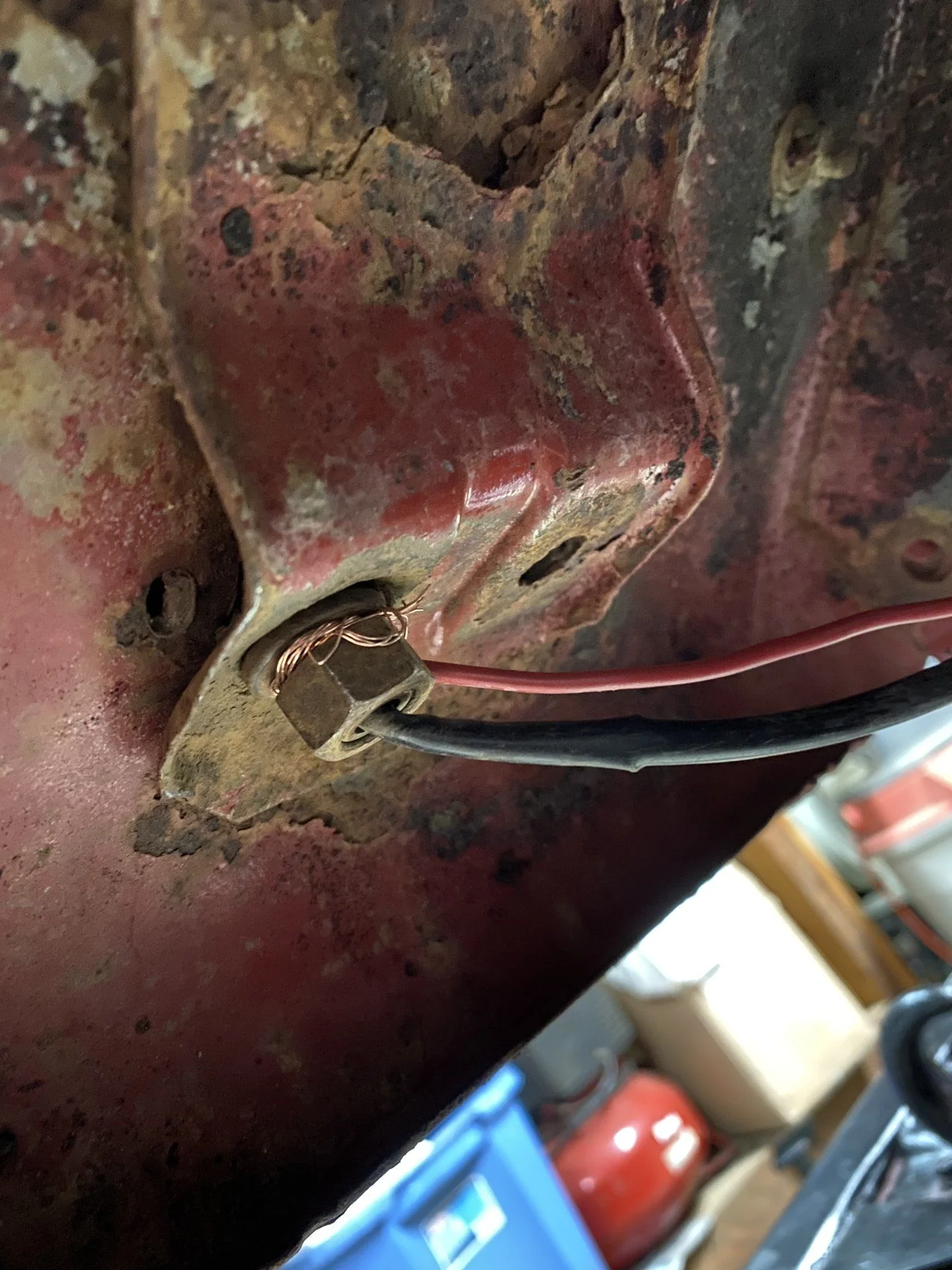

So my left front turn signal stopped working a few days ago and I decided to dig into it yesterday. Electrical is definitely my least favorite...don’t always have the brain for it! The first thing I noticed when I tore into it was the lights on the left front were definitely dimmer than the lights on the right front. Also when I took apart the light housing, you could see that there was some bleed over to the larger bulb causing it to glow just slightly. To me it seems like whenever there’s an electrical problem with these rigs, you start with grounding…weird huh?

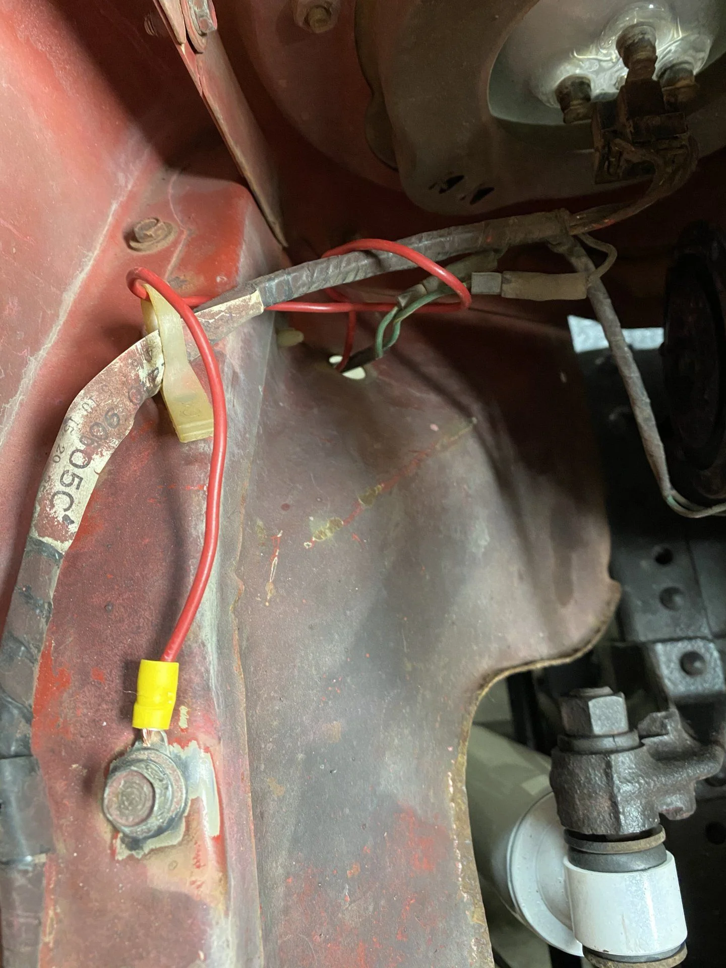

My left front fender is full of rust and Bondo so after tracing all the wires to the flasher I went back and started at the fender. I hooked a wire to where the light housing attaches to the fender and then ran it to a decent ground under the hood. All of a sudden the lights were brighter! OK I’m getting somewhere. Flasher still doesn’t work… Neither does the larger bulb. Smaller bulbs are working and bright as can be. Also the hazards flash except the left front... Don’t worry, the red grounding wire is just temporary as I troubleshoot. (Yes I changed the bulb 😁)

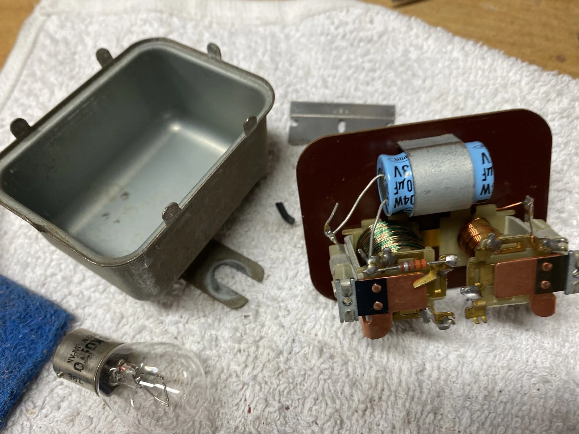

So now the hazards work except for the left front and the right turn signal works. When you turn the left turn signal on it clicks a few times and then stops and the smaller lights glow but the larger light which is the one that’s supposed to be flashing, still does not work. Checked all the connections again and cleaned the grounds one more time and then decided it had to be the flasher. Came inside and got online to order a new one. I’m really sensitive to spending money right now under the current corona madness. Had the flasher in my basket to check out and thought I’m going to go out one more time. Maybe take the flasher apart and just look… It’s a huge pain to remove because it’s tight up above the clutch pedal but I got it out. It was interesting to open up and see what’s really happening in there. I had no idea.

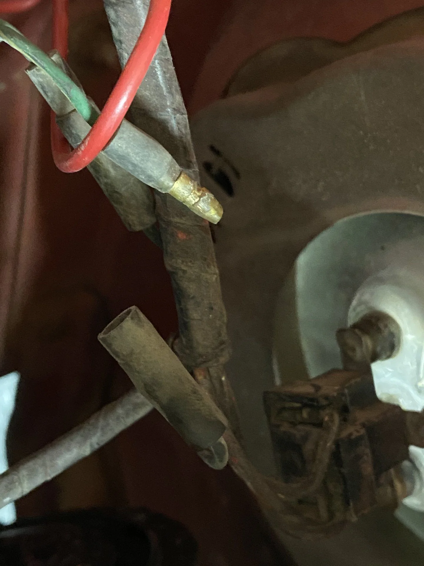

Anyway, relay works and I feel like the grounds are all good. Made one last effort to trace all the wires. Just behind the left headlight are a couple connectors that go out to the fender lights. I unplugged them and plugged them back in and all of a sudden it started flashing. Really?! 😡. I had checked all the wires but I didn’t actually unplug them. Connections were a little corroded and that was all that was wrong. Could’ve save me a few hours. Oh well, I learned a lot.
Couple things I learned. If the flasher is working for the right side and the hazards, then the flasher is working right? Not left and right specific. I was ready to just replace it. Glad I didn’t.
