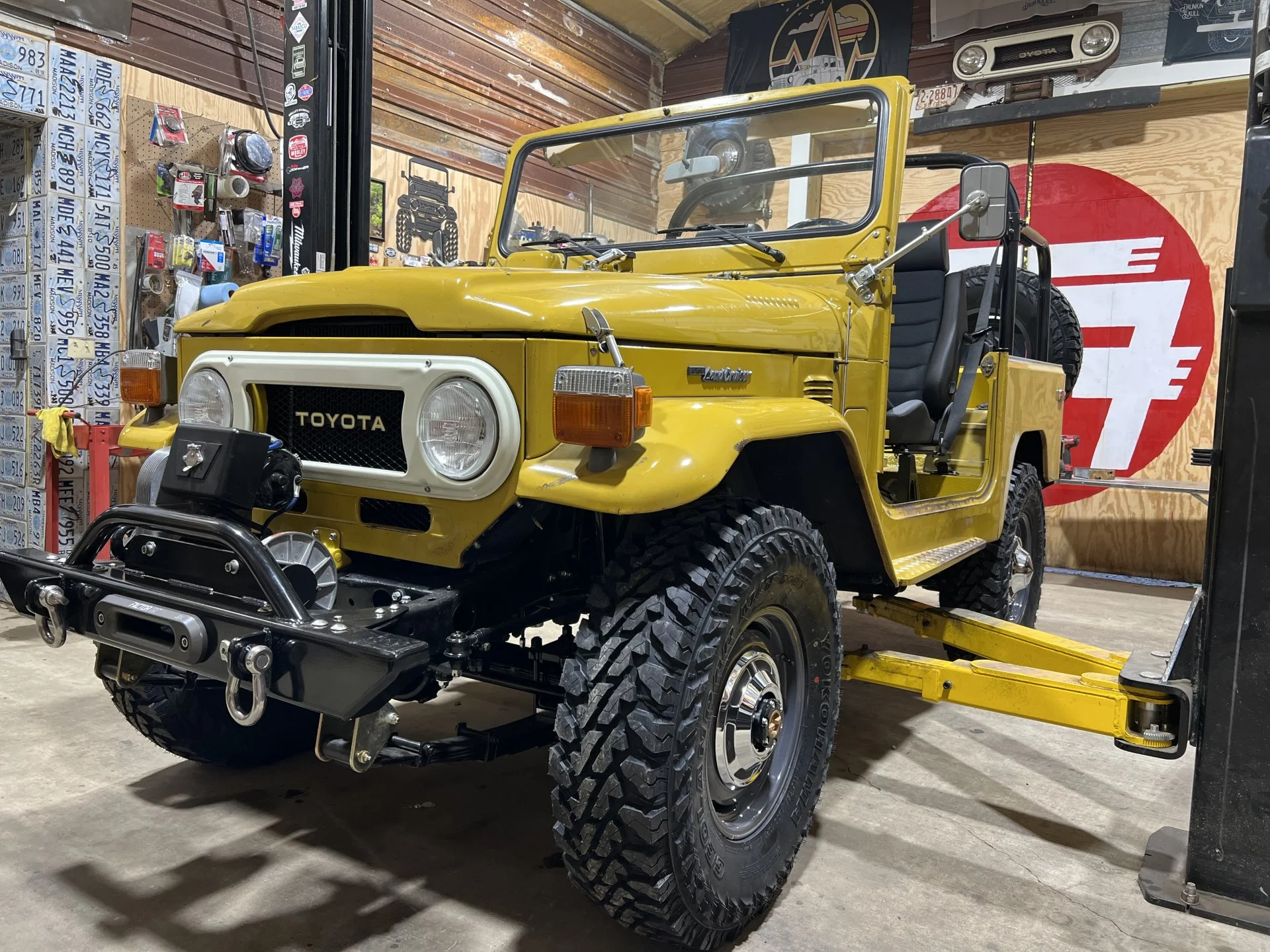

This morning @under_psi came up to be a second set of eyes on it when we fired it up.
No spark at first. Turns out the DUI wire had come unplugged.
Once it fired he kept it going while I adjusted the timing then we set the cam. We were at 18 minutes in the cam burn and we ran it out of the 4 gallons of gas I put in.
I almost s*** myself when it died. No idea we burned that much gas in 1/2 hour
Well at 60mph that’s an mpg of 7.5.

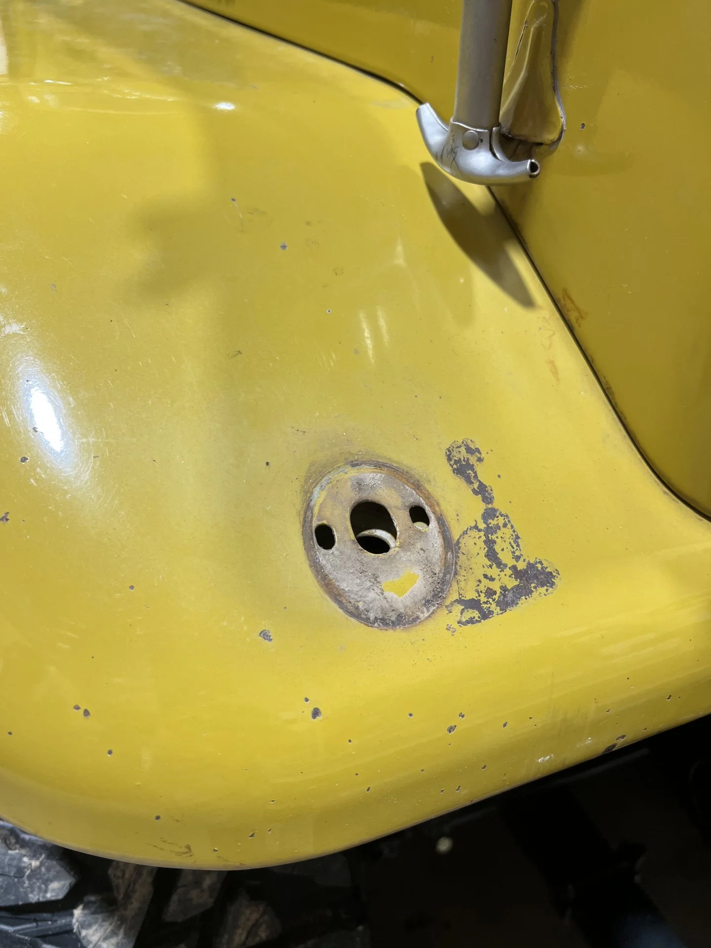

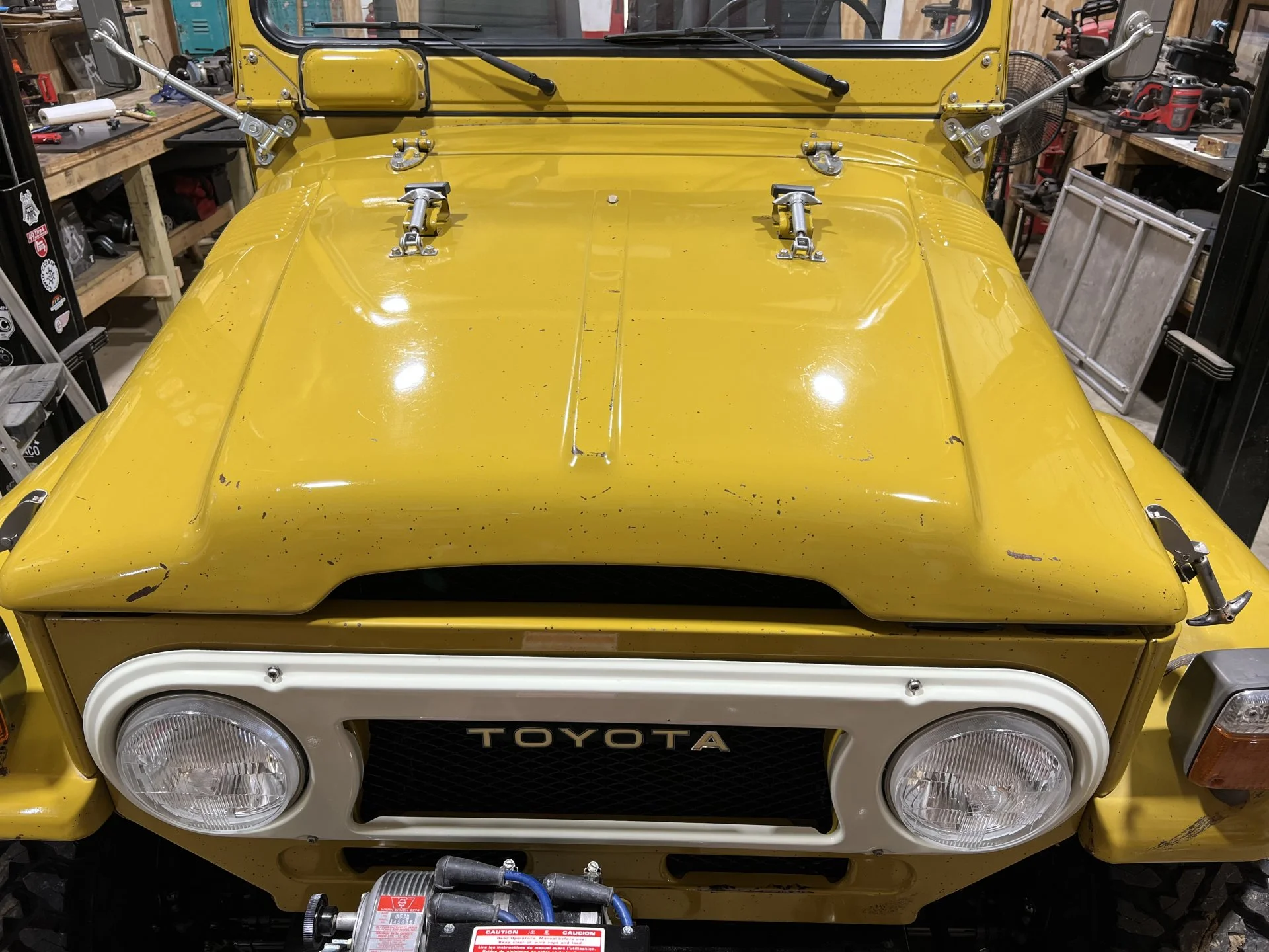

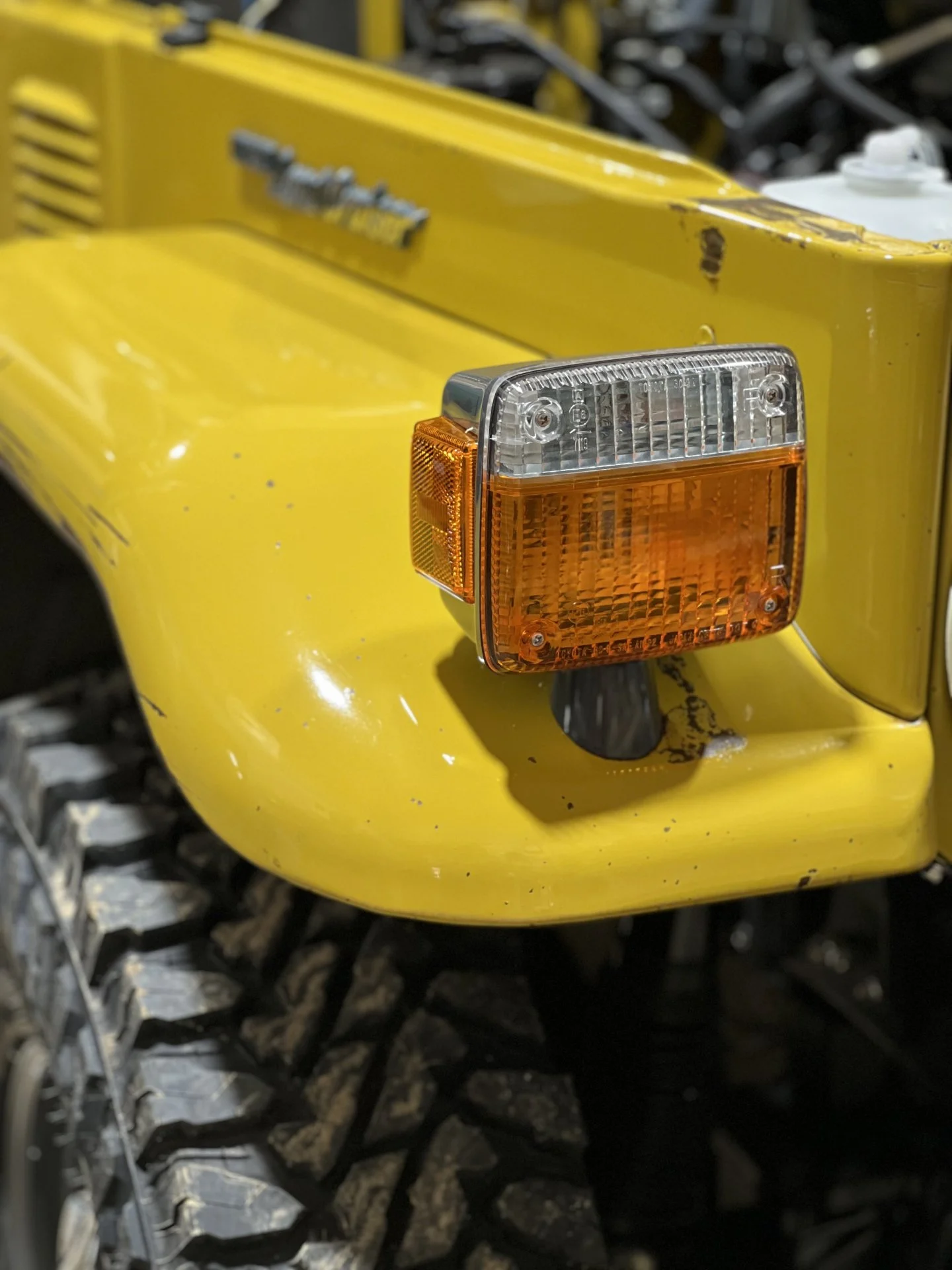

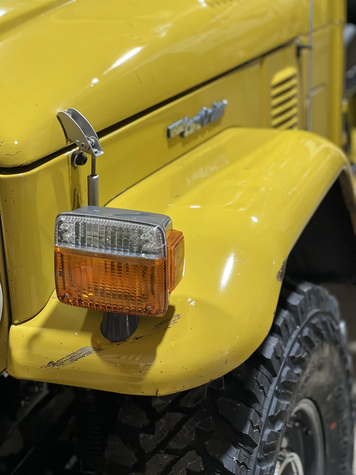

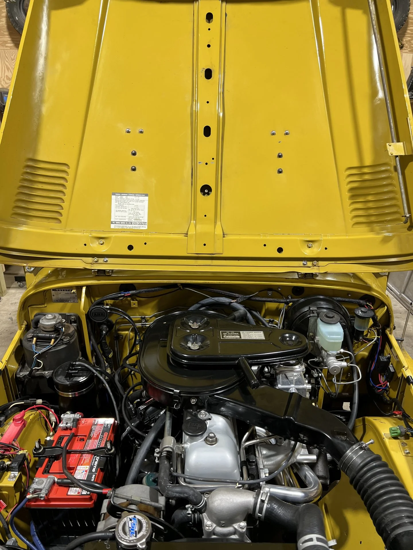

I figure the hood will be up plenty to admire the Cop motor so I went ahead and polished both sides of the hood. Shiny new flashers via Toyota 💥
I don't remember if I previously commented on the winch or not. If not PTO the only electric winch that should be found a FJ40 is the Warn 8274, and this NOS 8274 is the perfect compliment to this 40.
Yeah… when you can find one in decent shape! I cannot!
Keep looking, and if complete enough and rebuildable you can upgrade and improve upon it
One approach is to scan ads for old domestic trucks and 4x4 and if one has a 8274 contact the owner and ask if the winch can be purchased separately. I picked up one locally earlier this year for $75 unsure of internal condition but it was good. Had to buy a new Warn part or two, upgraded to 6.5 hp motor and Albright contactor and have a killer winch.

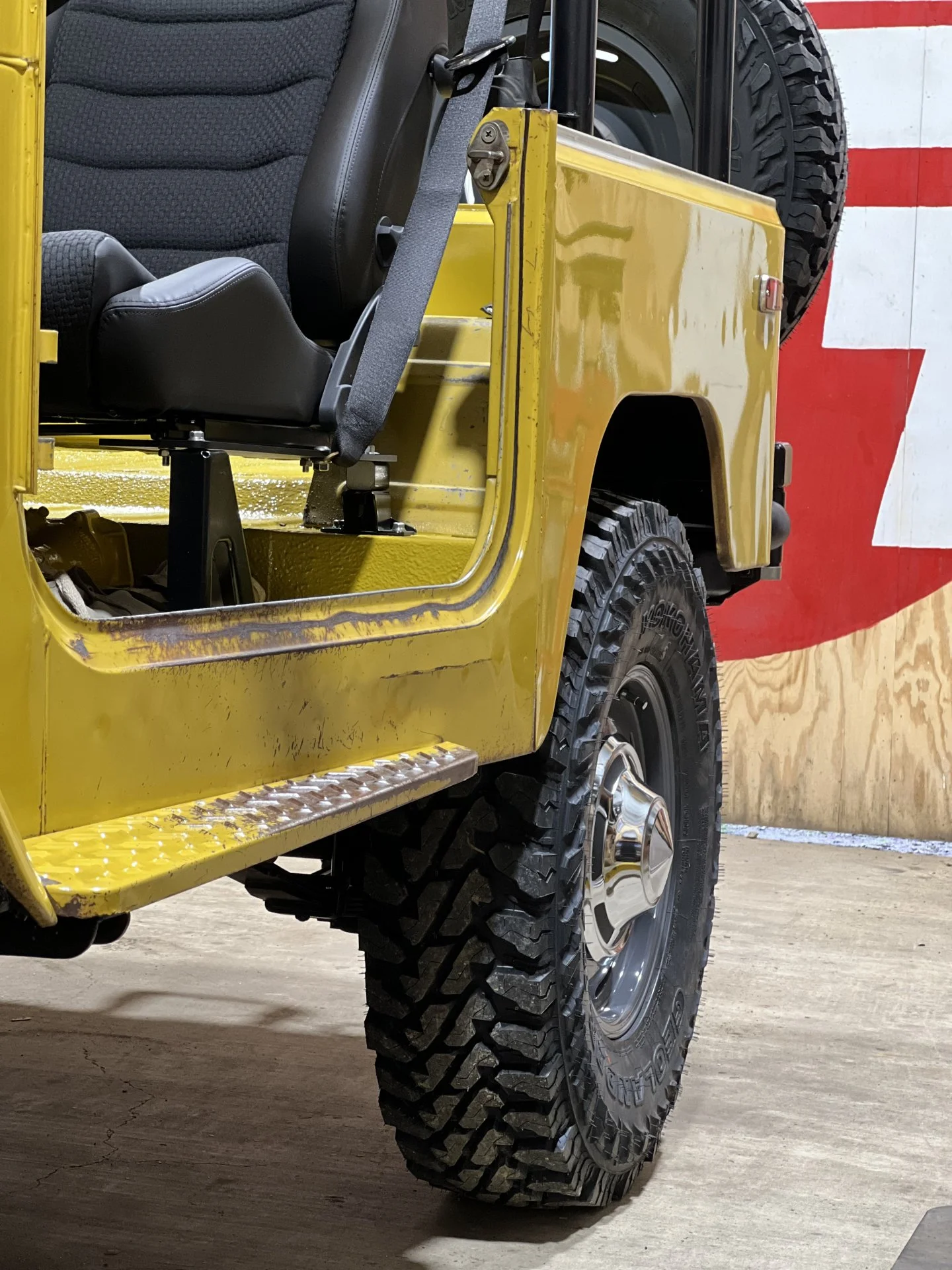

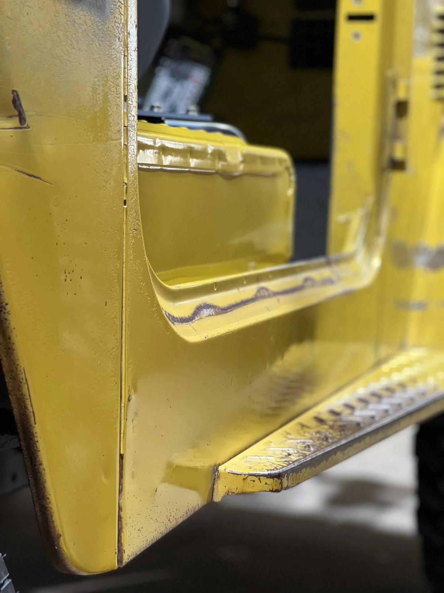

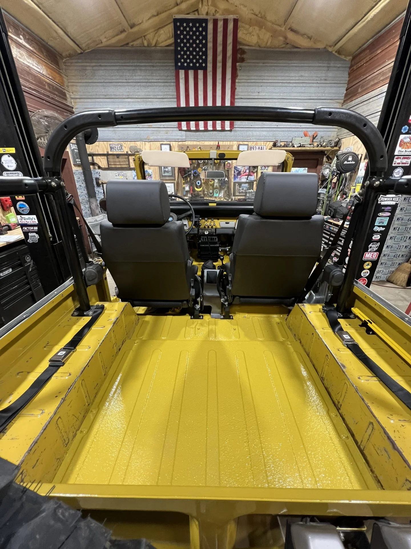

Finished up the polish. This thing really pops for original paint. The inner fenders really shined up nicely as well to match the new floor paint.
