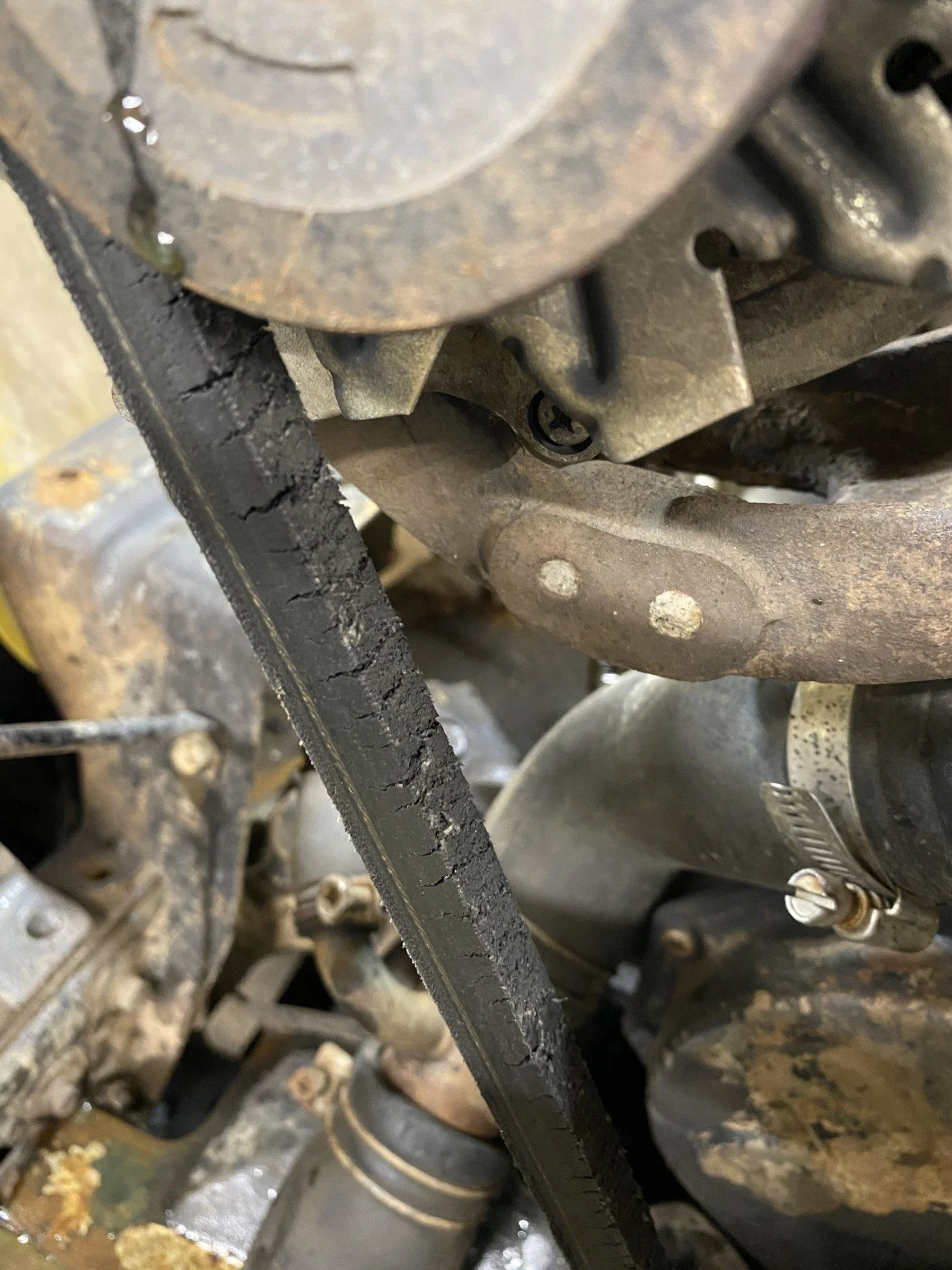

This belt looked OK until I was able to see under it.
If it’s rubber, it’s getting replaced.

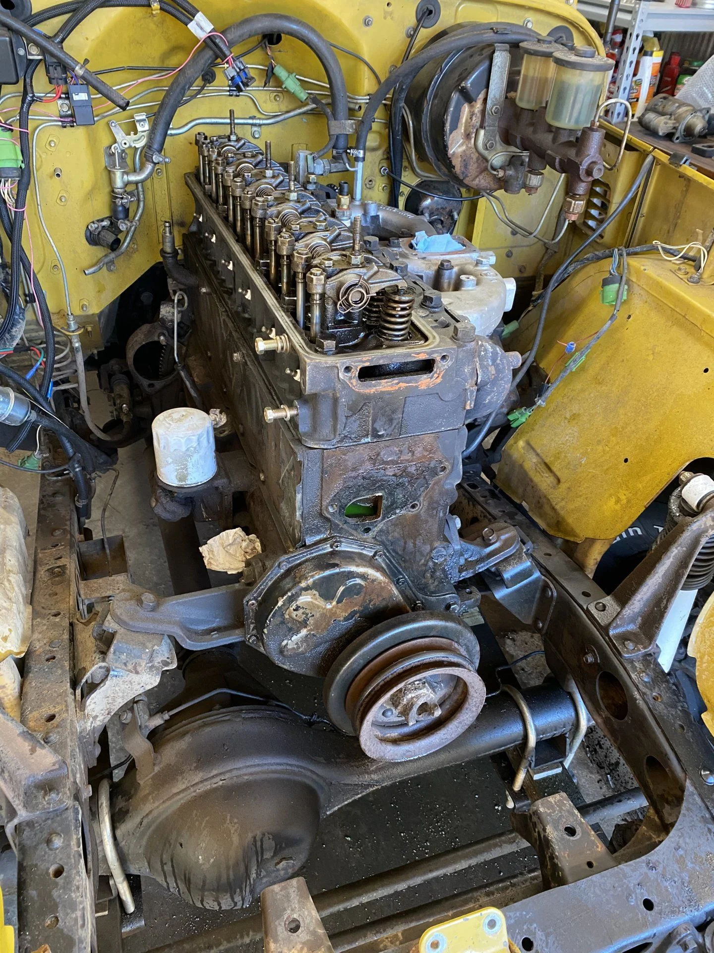

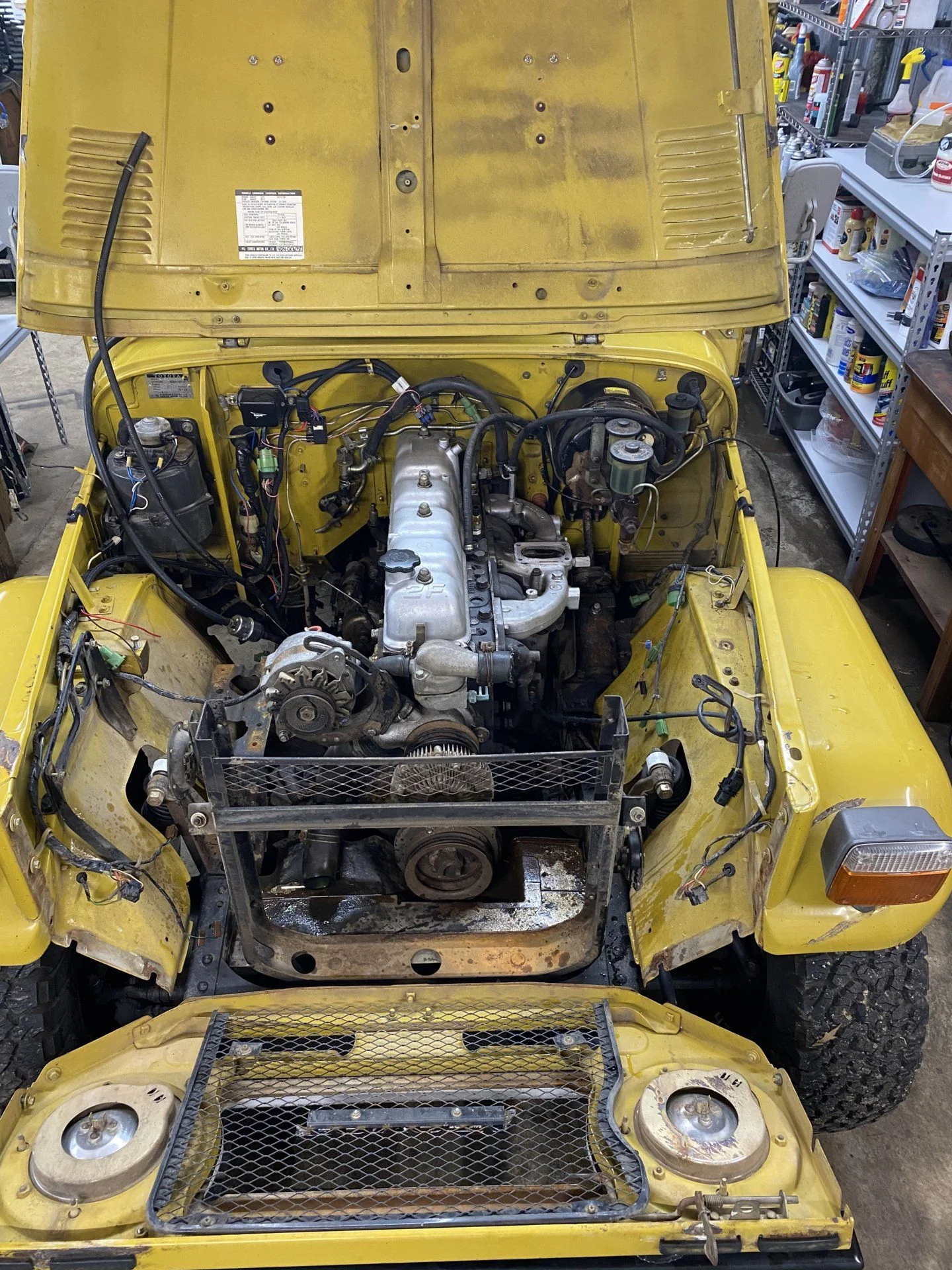

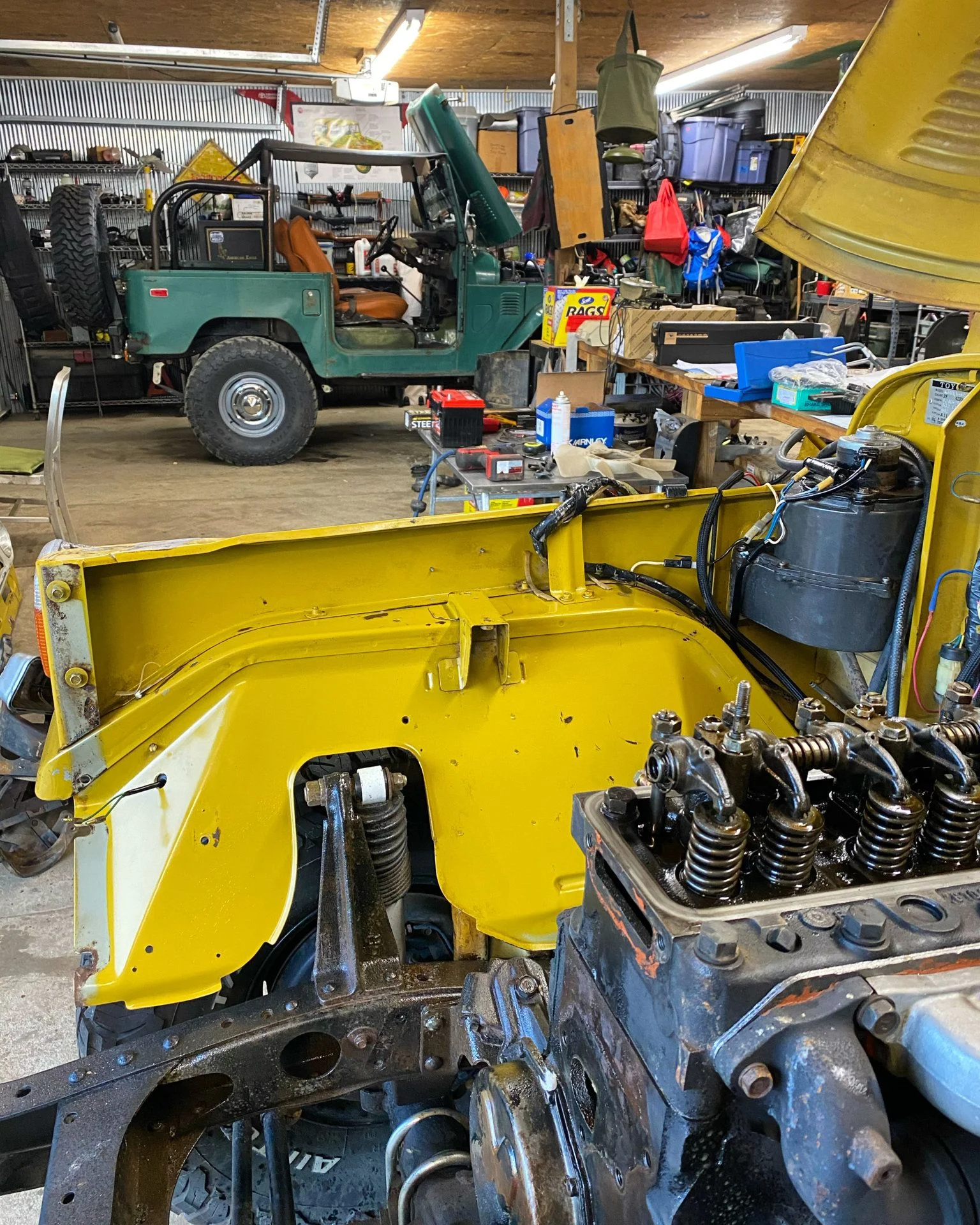

Spent the morning getting the new/working master installed and the brakes tuned on Weenie 3 then moved over to Project Mustard 78 after lunch.
Sitting 2 days I noticed a leak that could be one of two things. Rear main or loose oil pan. I climbed under with my trusty scraper and got a few decades worth of crap scraped clear and clean then put a good 270-360* turn on all the oil pan gasket bolts. I’m guessing it’s the later. They were super loose. I’ll know tomorrow.
I made a big pile of stuff that will be headed to
The powdercoater on Monday.

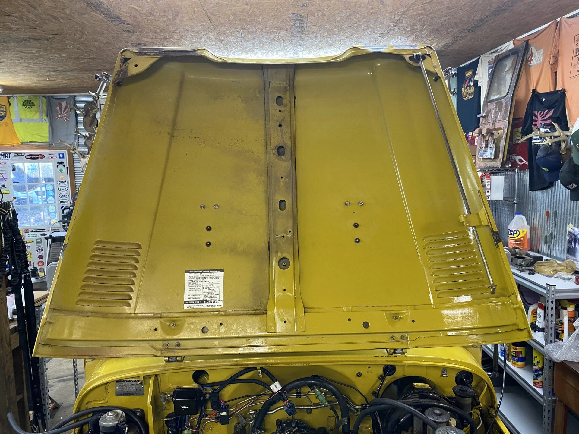

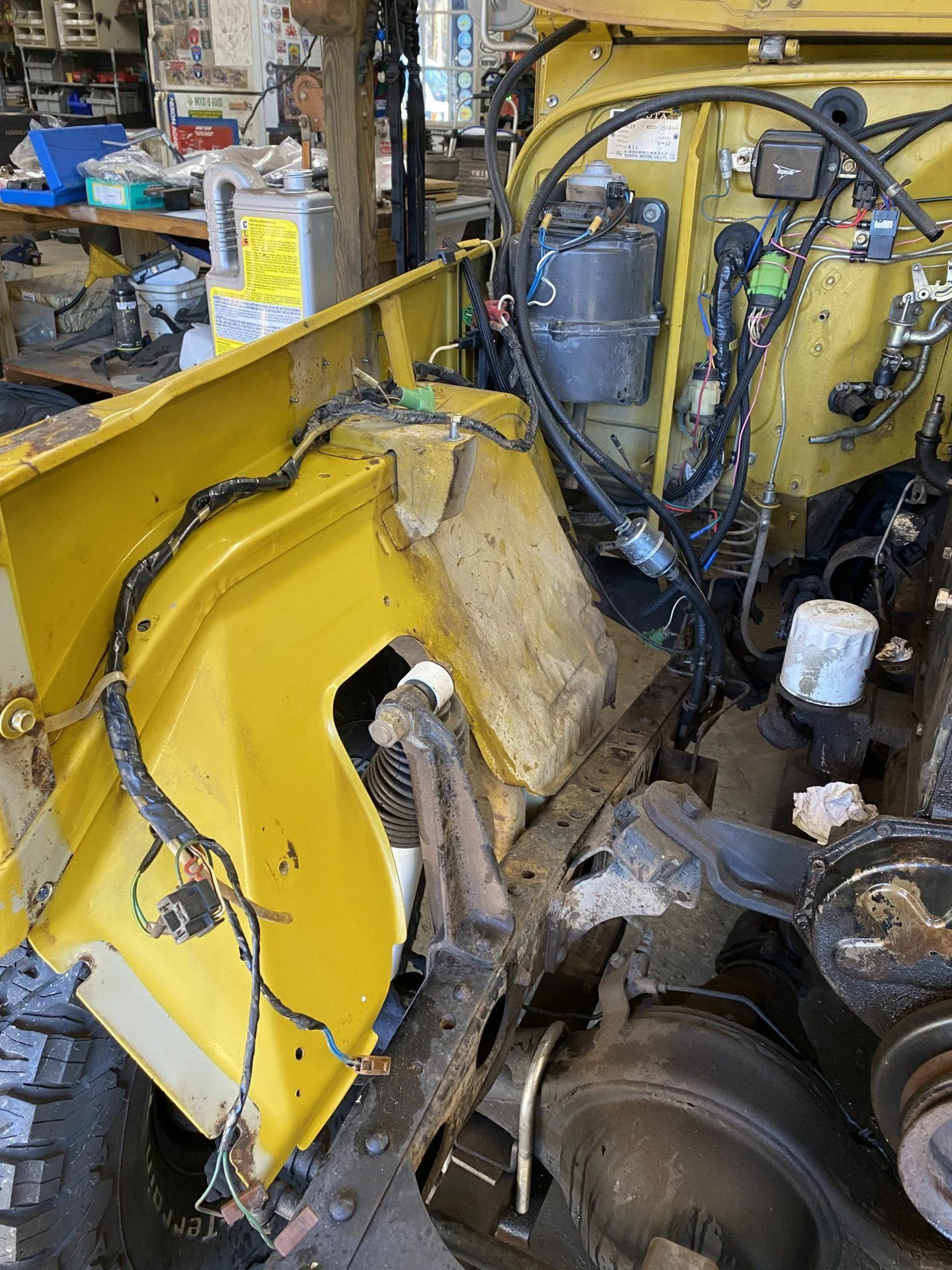

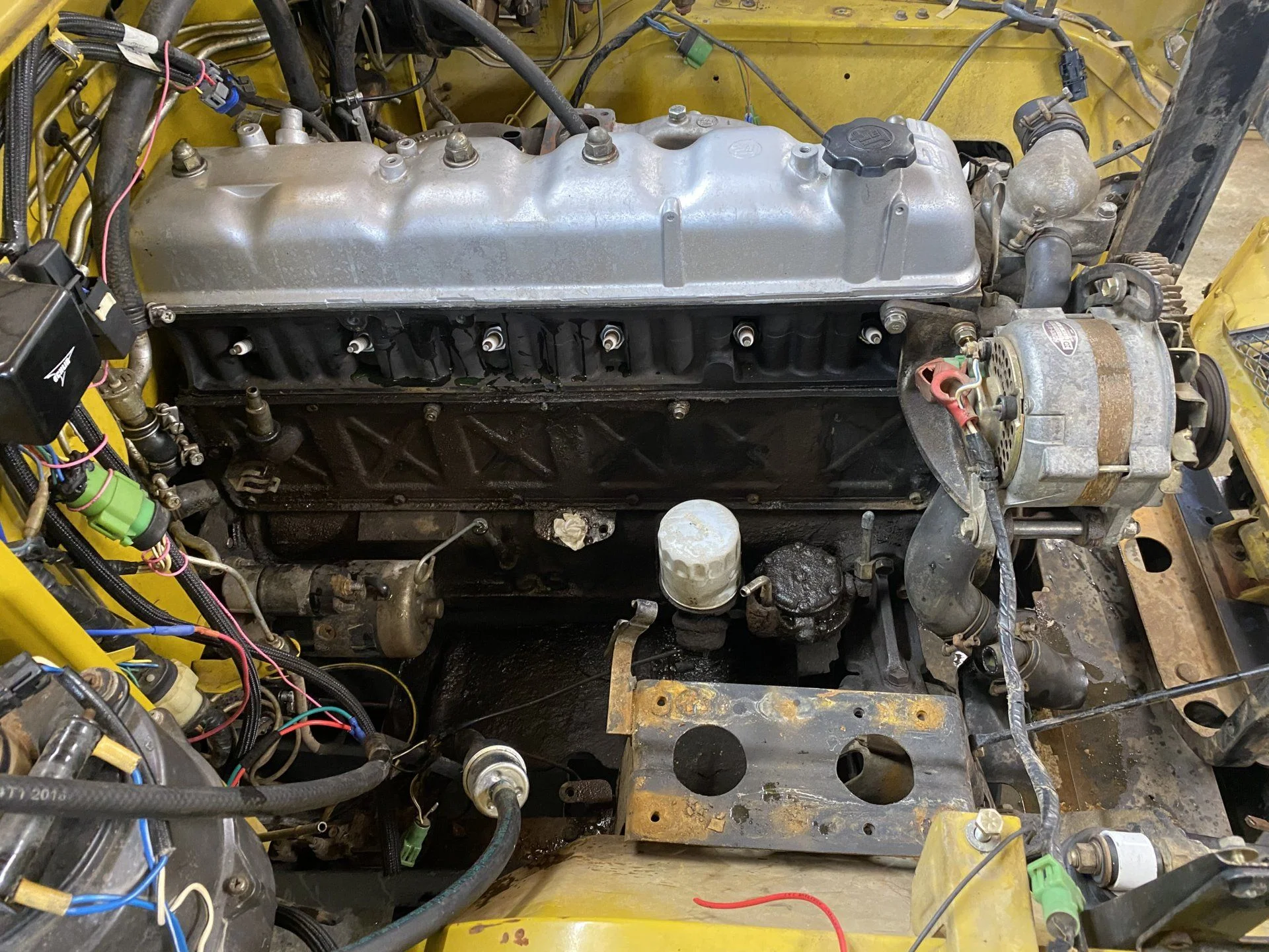

While everything Is out of the engine area that is coming out, I went ahead and started a good CLR scrub

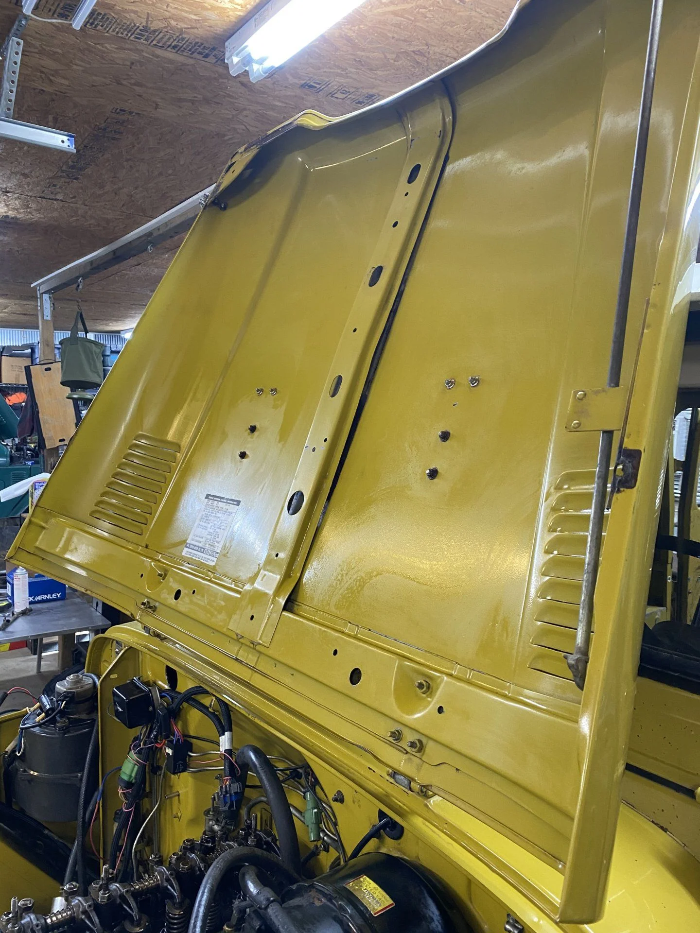

@thecrazygreek stole my thunder on the exterior. It’s great. This part is cleaning up nicely The firewall will suck. Still lots there I won’t be removing to clean around.
One side done.

What is the advantage to not removing the engine?

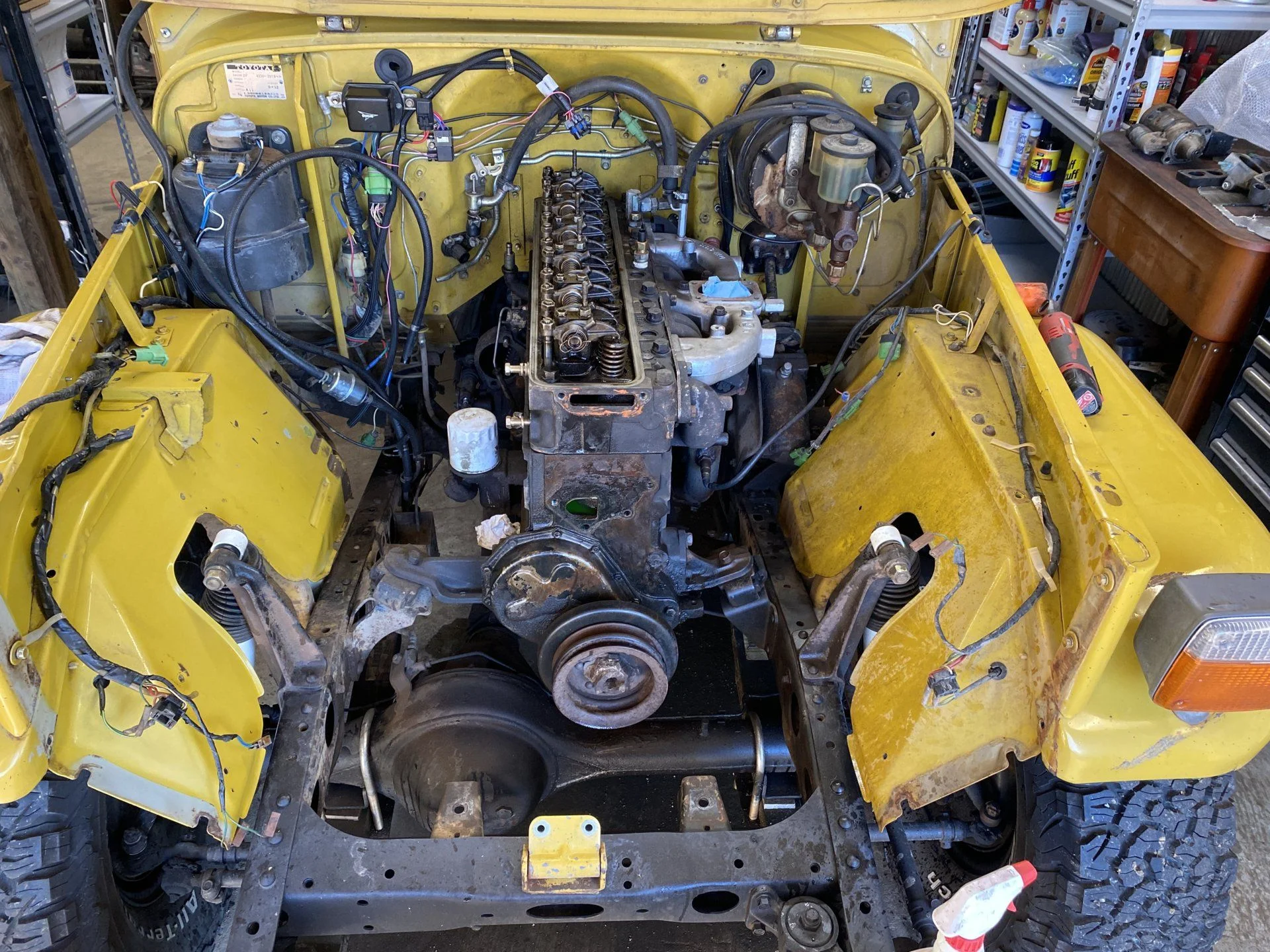

Well at this point not a ton, but I can get to everything I want to do without going that far.

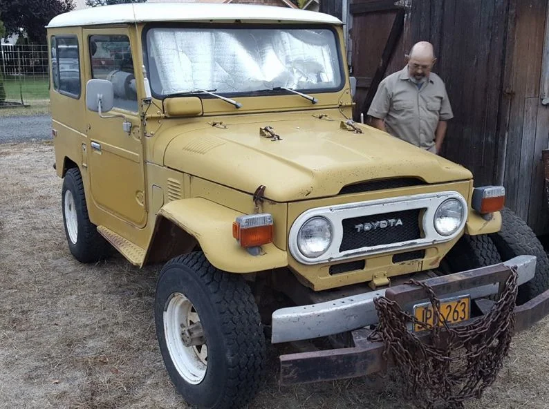

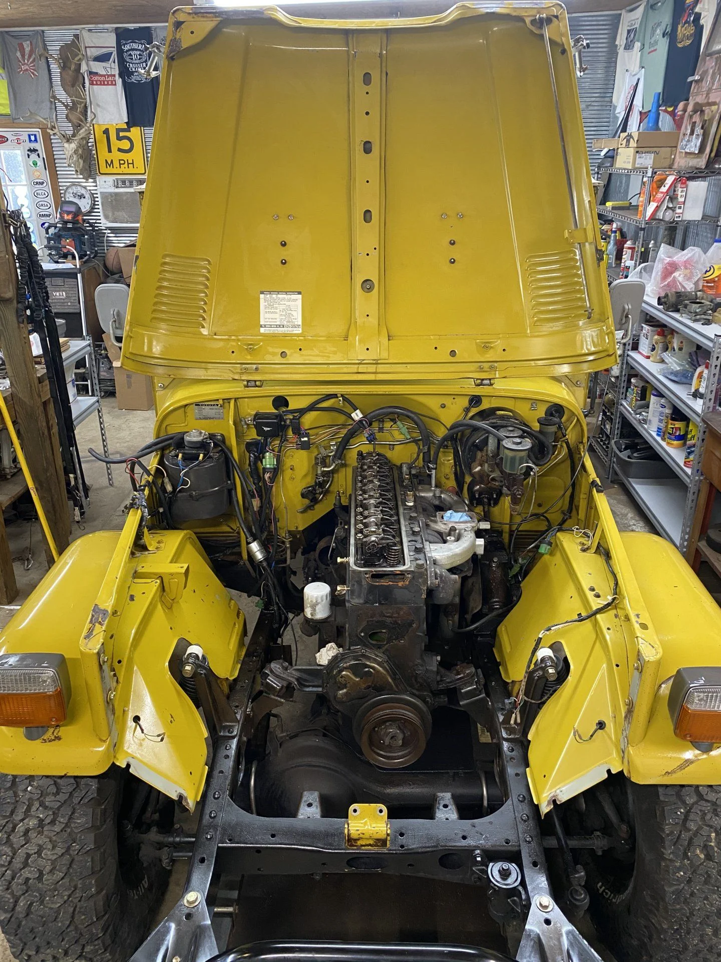

It’s probably appropriate to explain how the truck got where it’s at. I did not know @wngrog other than seeing his projects on Mud. We had never talked or exchanged messages. About 2 weeks ago I sent him a message introducing myself and the project. I did not even know if worked on anything other than his own trucks. At that time, I really just wanted to get the truck running better and I knew Nolen had some luck with the Sniper setups. Lucky for me, the yellow patina won him over and he agreed to tackle the project. It was at his shop within a week and after a quick look over we had an enormous parts list and the beginnings of a dismantled 40 series.
I am thrilled.
