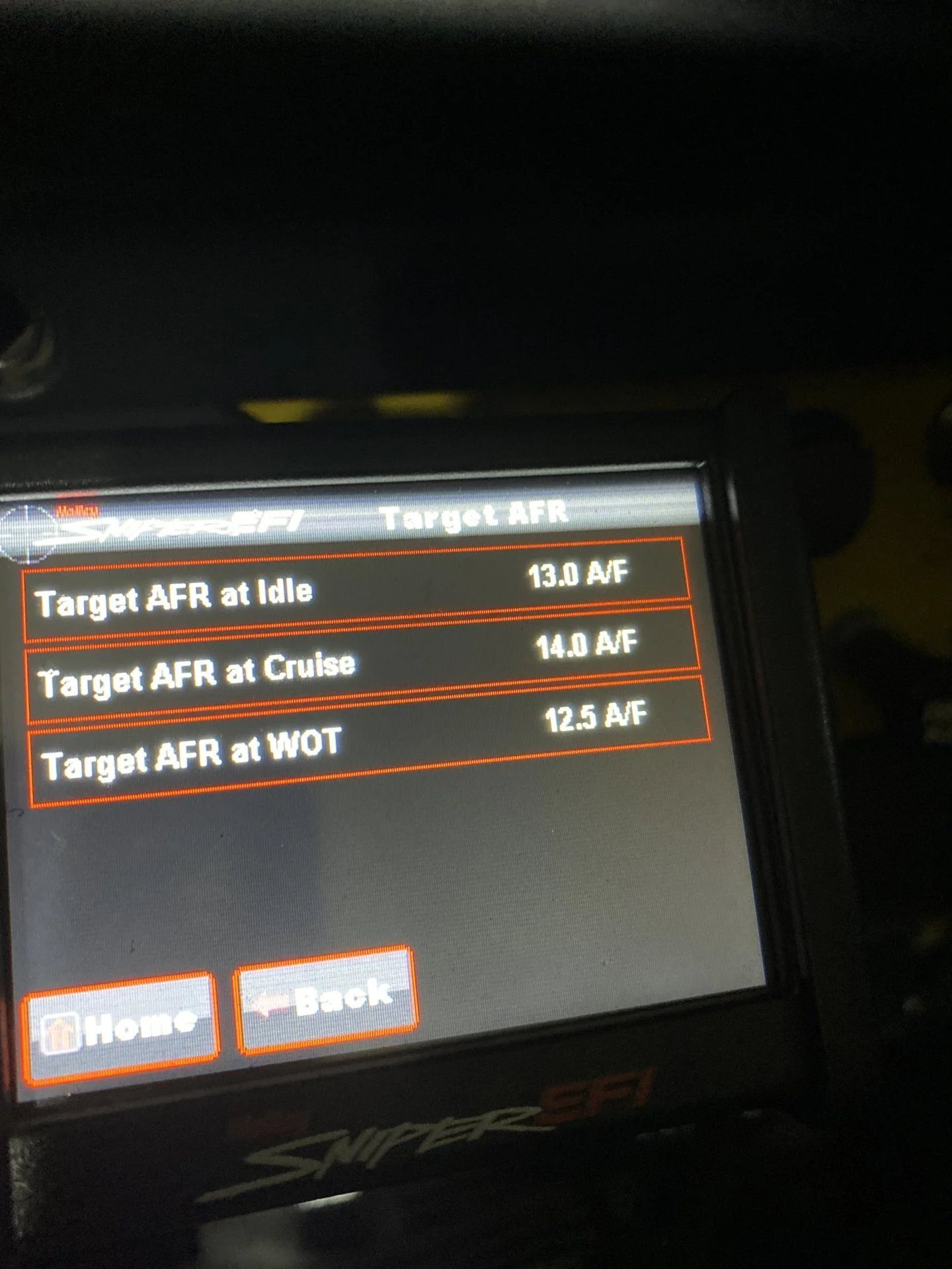

What were your final settings on the sniper?
Target Idle, cruise and WOT AFR? Will you transfer learn table once everything is dialed in?
Would like to get a good baseline of what actual 40 users are ending up with. On my current install I am noticing my target idle AFR (when cold) likes to be higher. (leaner) and also notice my learn % is always neg (subtracting fuel). Wondering if you had a similar experience? (this is based on the initial wizards baseline set up)
Perhaps a new Sniper users thread with config info might be useful.
BTW, great work on everything, I picked up some good tips as well, and appreciate your insights!
I don’t usually mess with the stock tune. @FJ60Cam has been playing with settings but this one and my other two are doing great , no hesitation, no dieseling, no cutting out as I let off the gas. Just smooth sailing.
10* timing
OEM FJ60 plugs gapped to .040

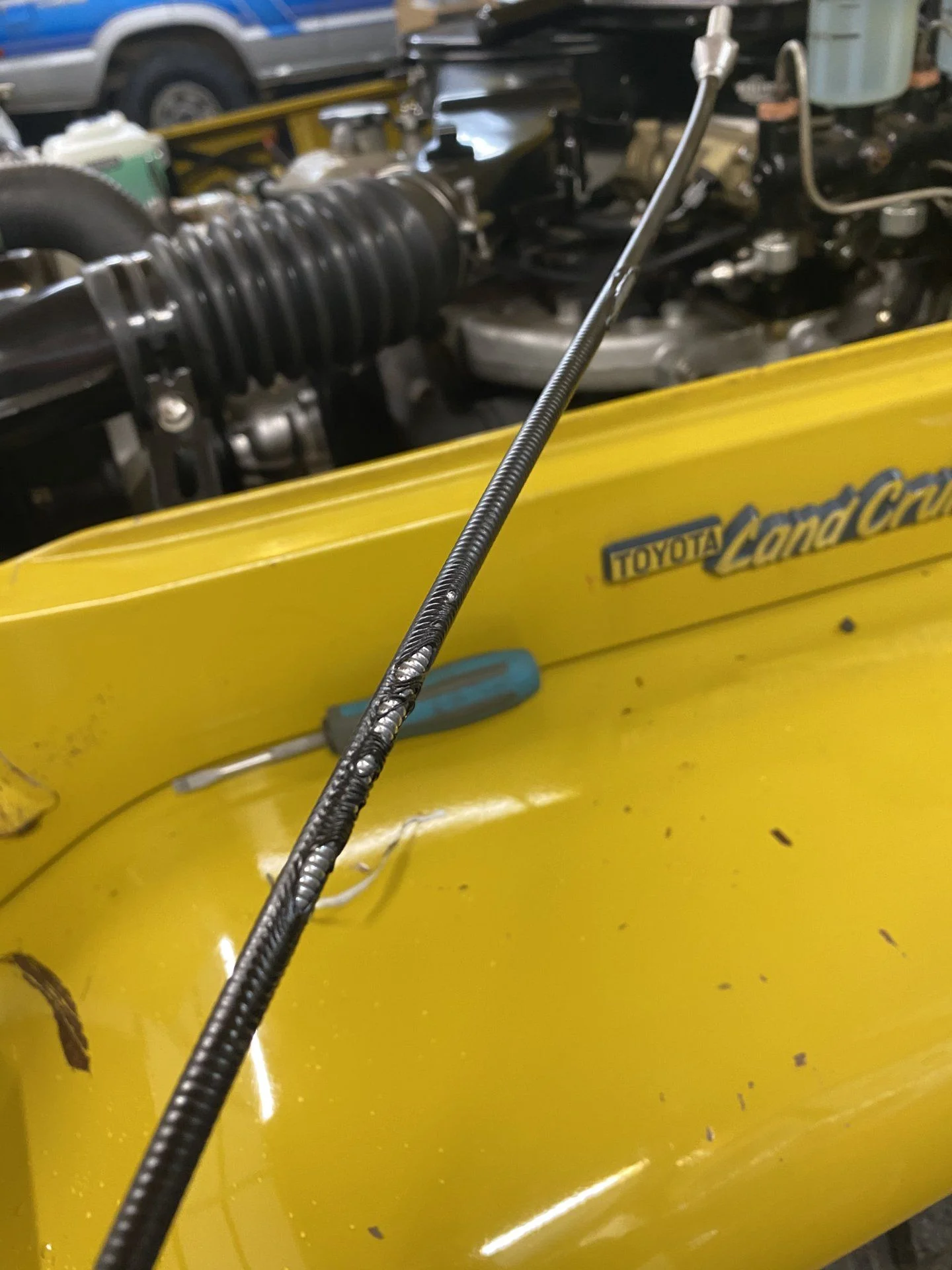

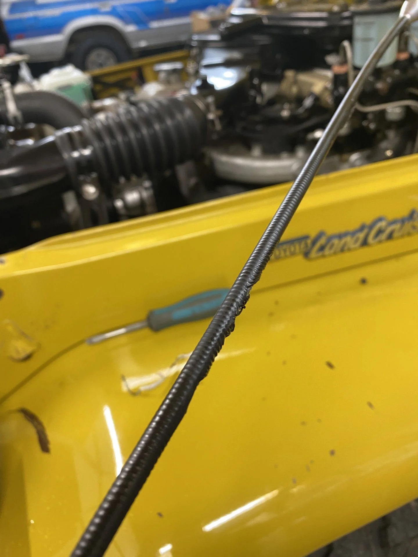

Was on the way to the airport in the rain and the throttle stuck wide open.
s***! Pull over in the rain and see that when I fixed the vacuum leak I did not properly reroute the throttle cable and it burned it.
Luckily I had one at home so I booked it back and replaced the sheath. I was able to keep all the setting and brackets in place so it Went fast.

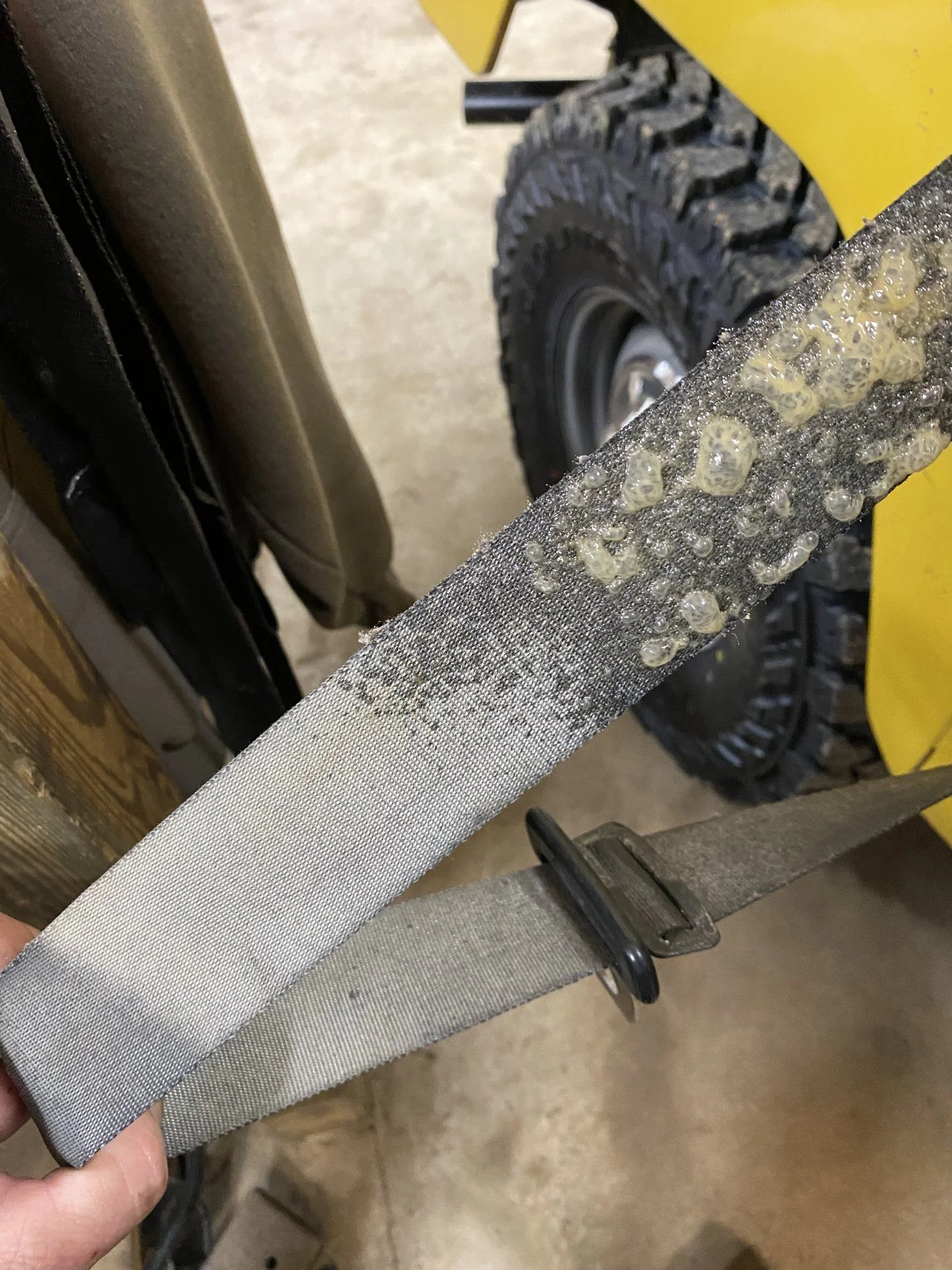

So, one thing.....if Lockwood hates the smell of Fluid Film he might have the sell this thing
I’m treated the faded seat belts with it. I’m anxious to see how this looks after it soaks in. My bet they look like new. All the other faded rubber parts look new after soaking in this stuff

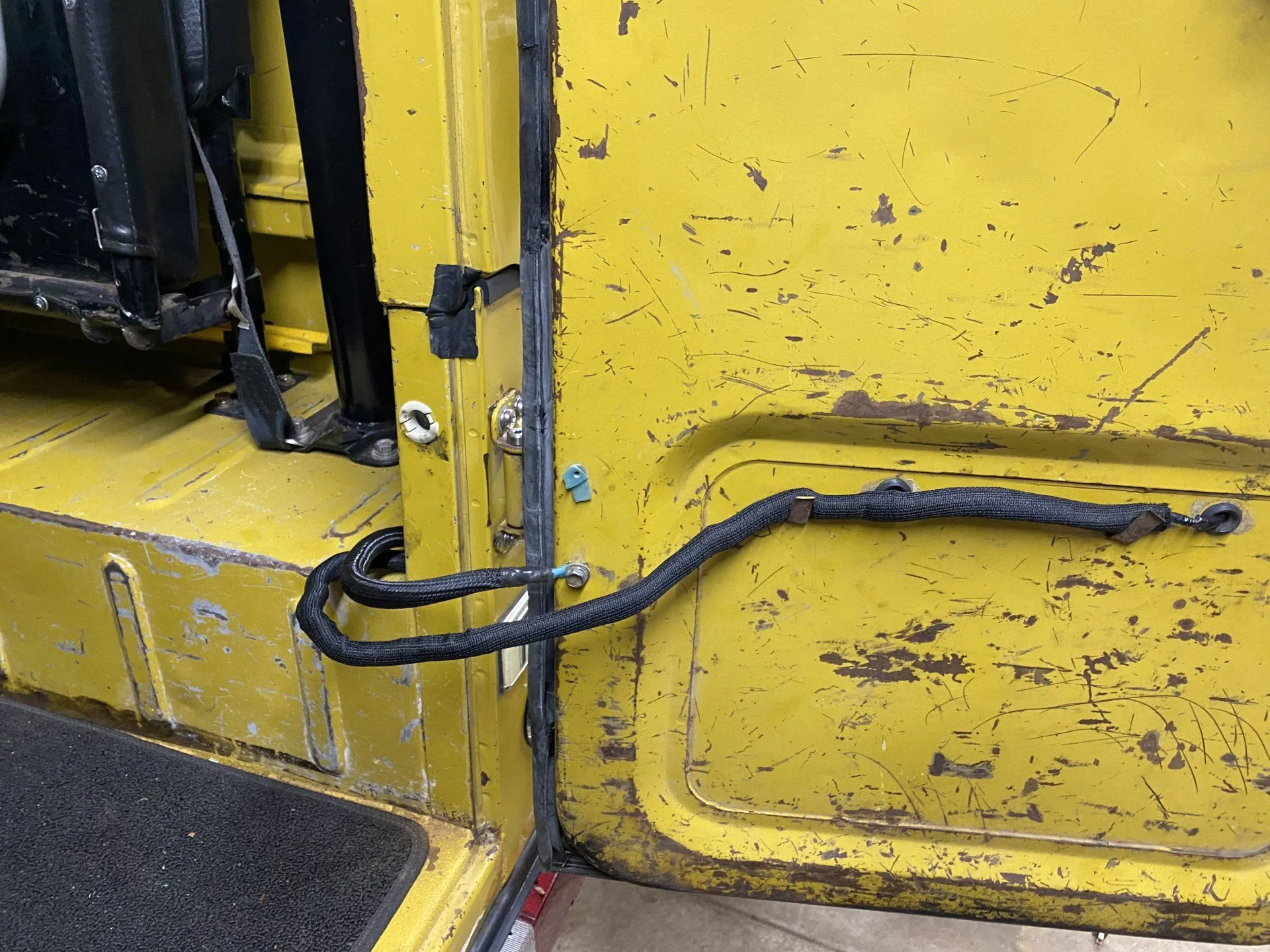

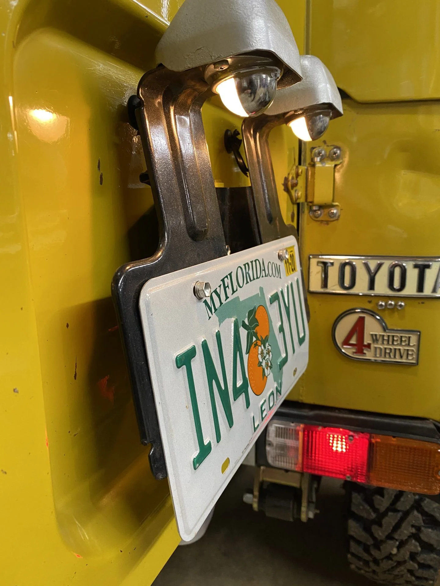

The Amby door light harness has been clipped clean so I had to get that hooked up for lights on the tag.
View attachment 2198705View attachment 2198706
I know it’s supposed to pass through the white grommet but they always bunch up in there
