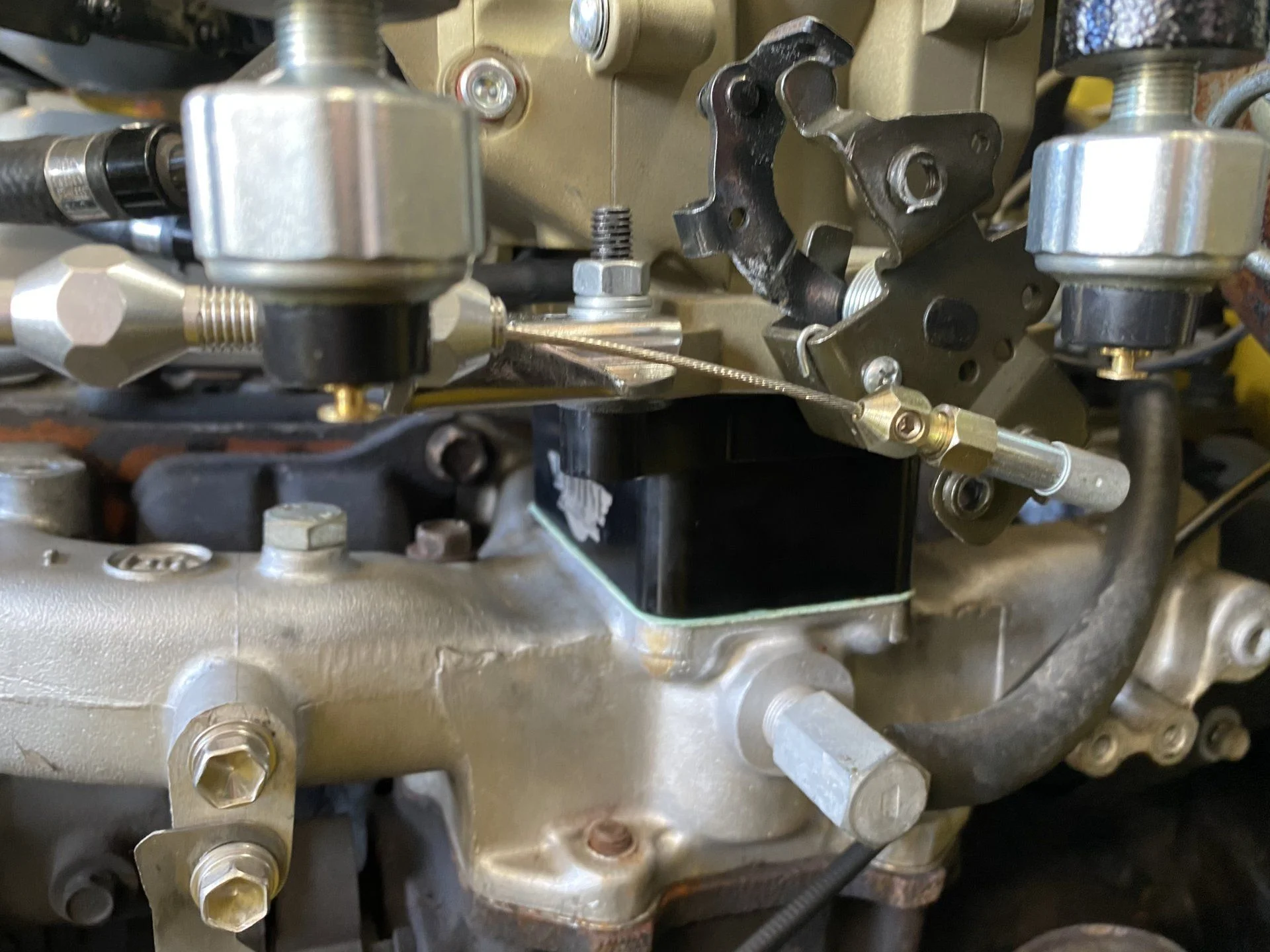

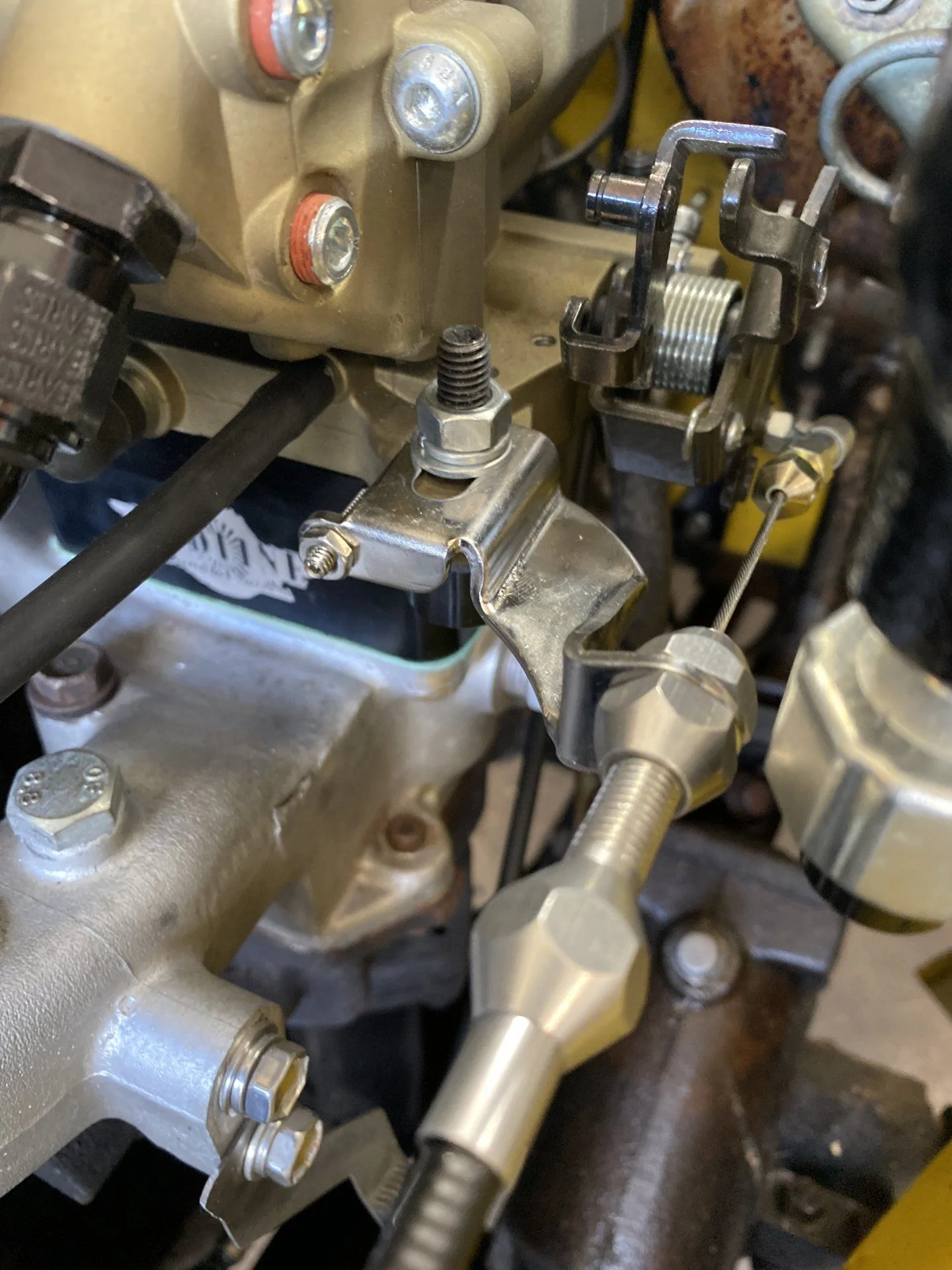

The throttle cable was a bit sticky....

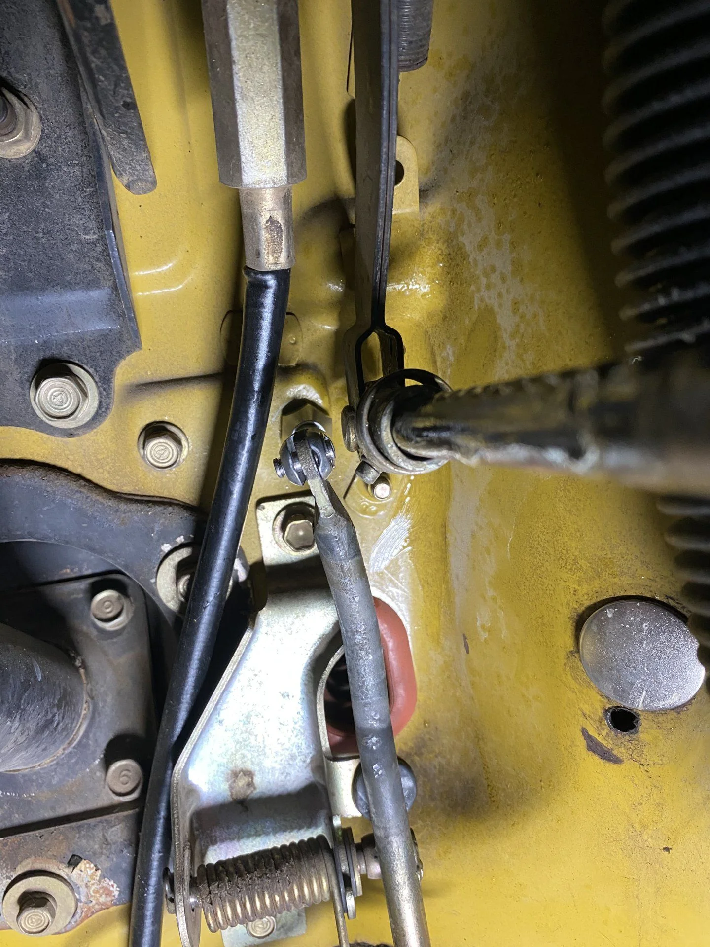

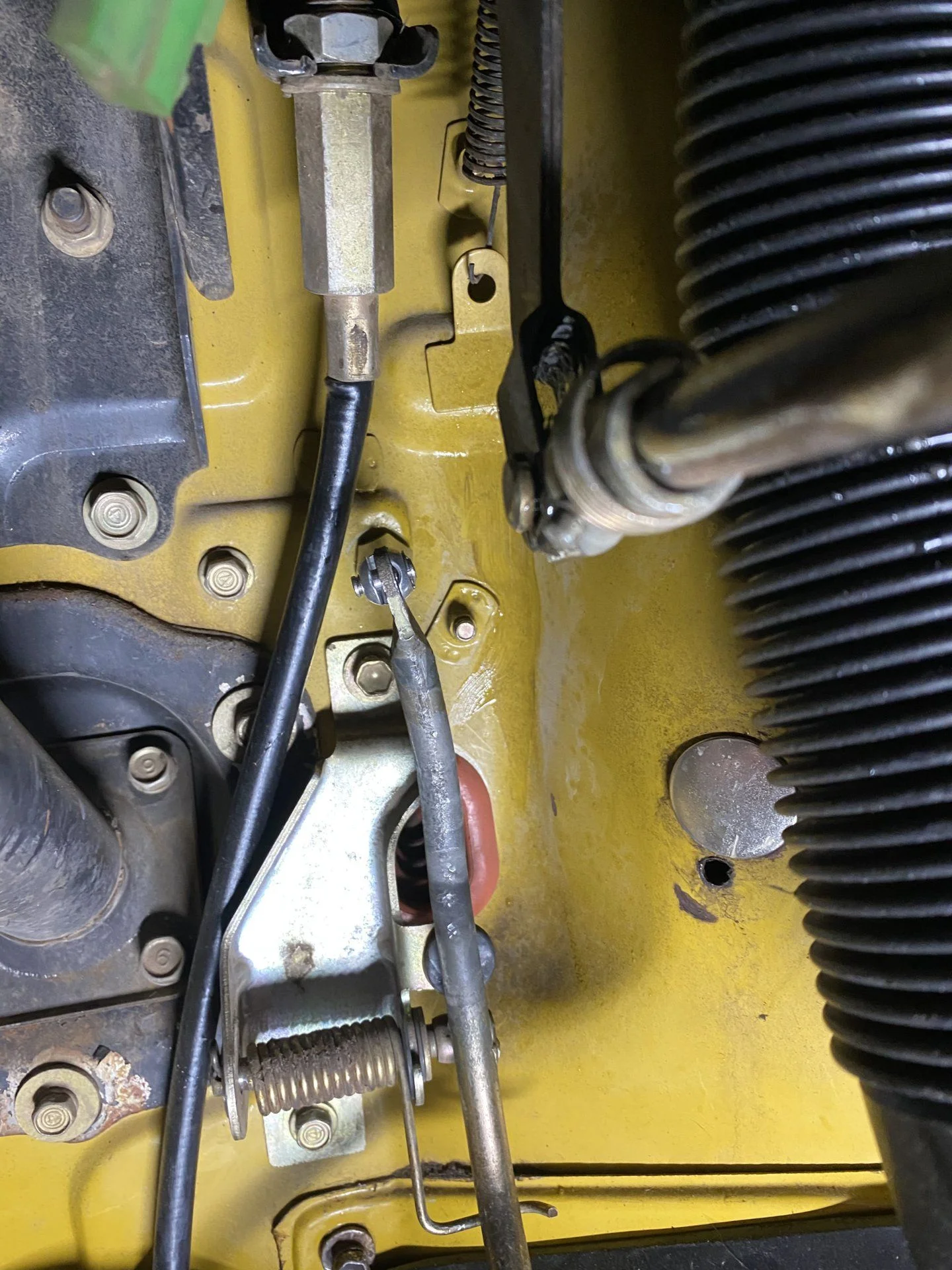

The Parking brake handle by the firewall is hitting the bent gas pedal. More bending incoming.

The pedal needed to be bent a bit to the left to clear the parking break. While I was in there I added a new cable that had the proper Sniper end connections.
It’s butter smooth now.

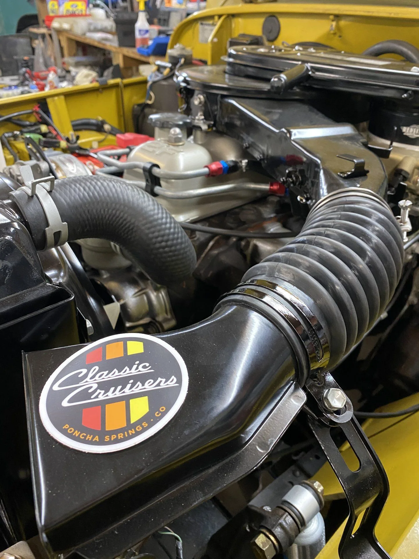

Also got this hard to find hose clamp and some clamps for the tool kit installed from Classic Cruisers.

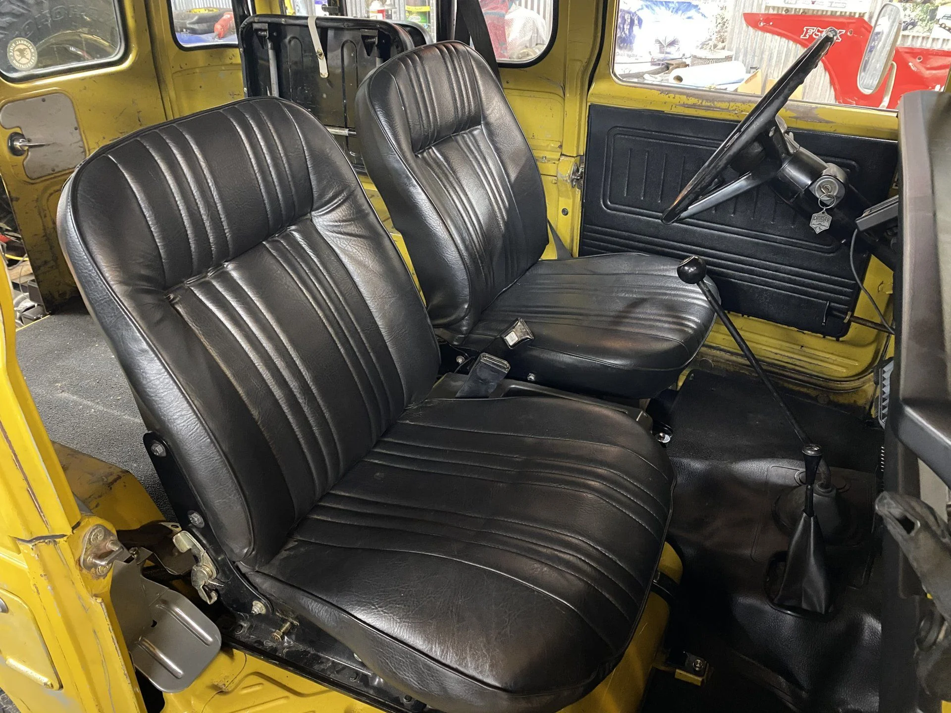

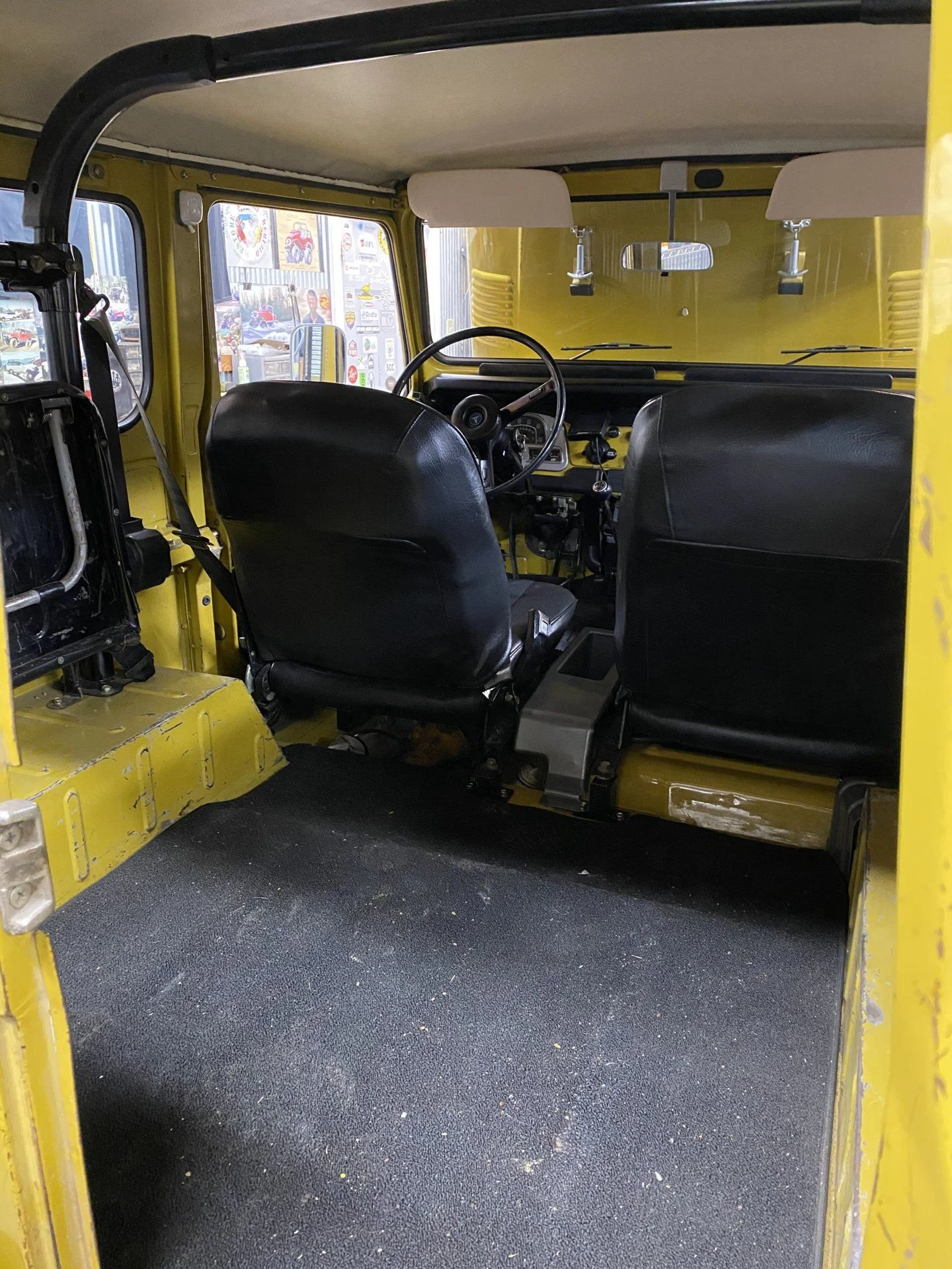

Got the seat back in. I had to clearance the bottom of the seat and add a spacer to the rear on one side to comfortably clear the fuel lines. Luckily with the big ole Cush seats you can’t tell it’s got the 1/2” lift kit.

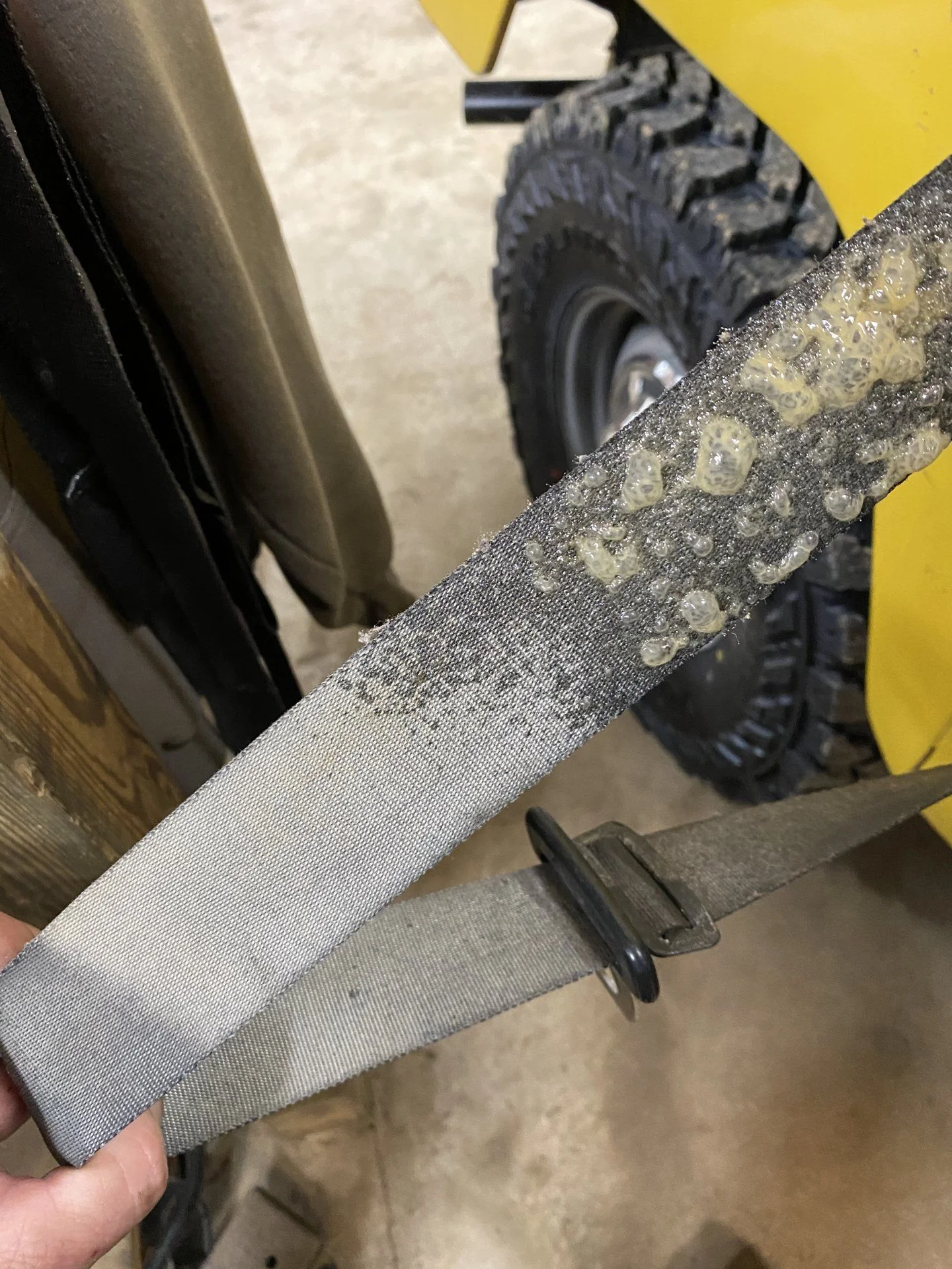

So, one thing.....if Lockwood hates the smell of Fluid Film he might have the sell this thing
I’m treated the faded seat belts with it. I’m anxious to see how this looks after it soaks in. My bet they look like new. All the other faded rubber parts look new after soaking in this stuff

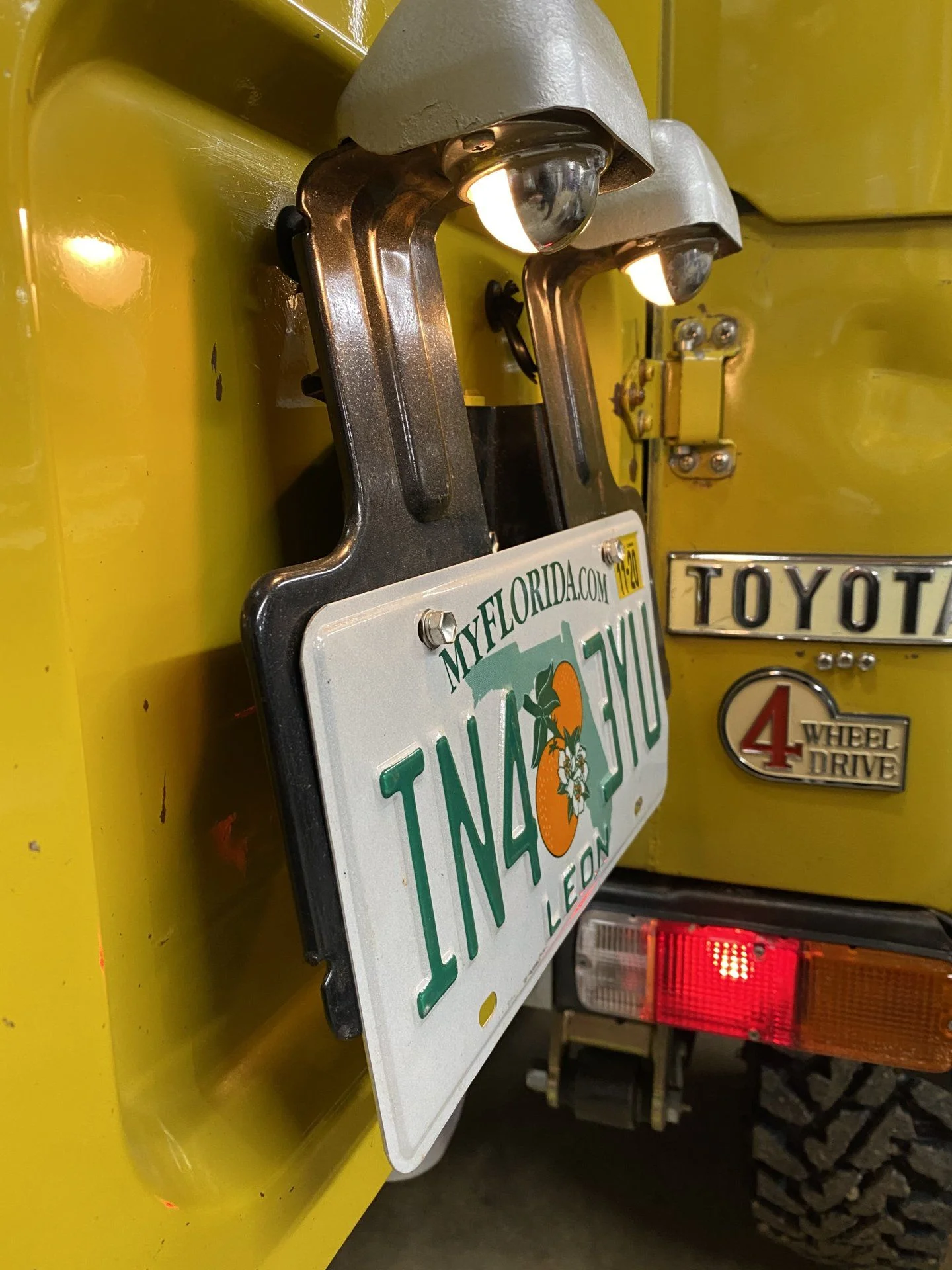

The Amby door light harness has been clipped clean so I had to get that hooked up for lights on the tag.
I know it’s supposed to pass through the white grommet but they always bunch up in there

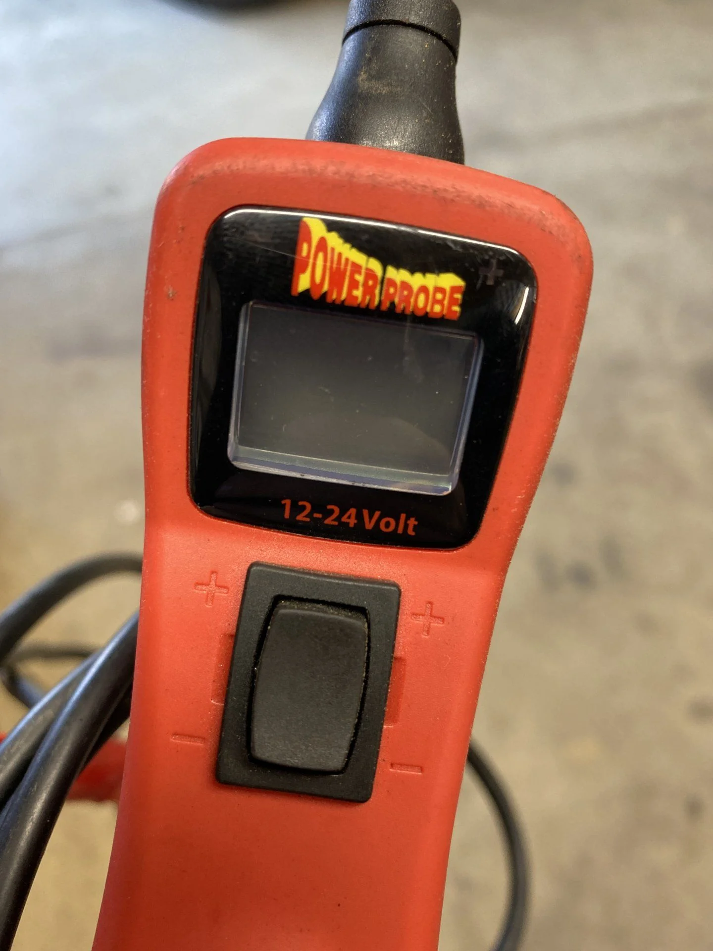

If you don’t have one of these test lights, get one. Not only it is a tester, it gives voltage, has a bright LED and the best part, a trigger that will send 12 volts to something to test if it actually works

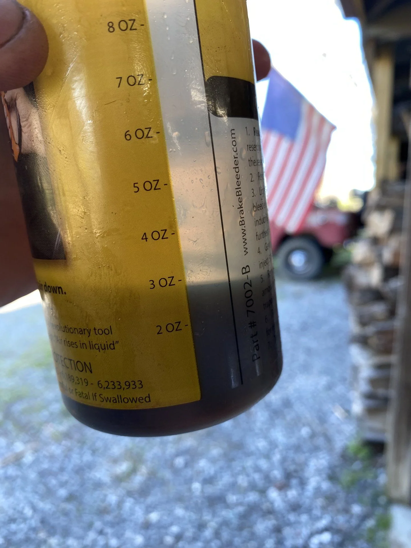

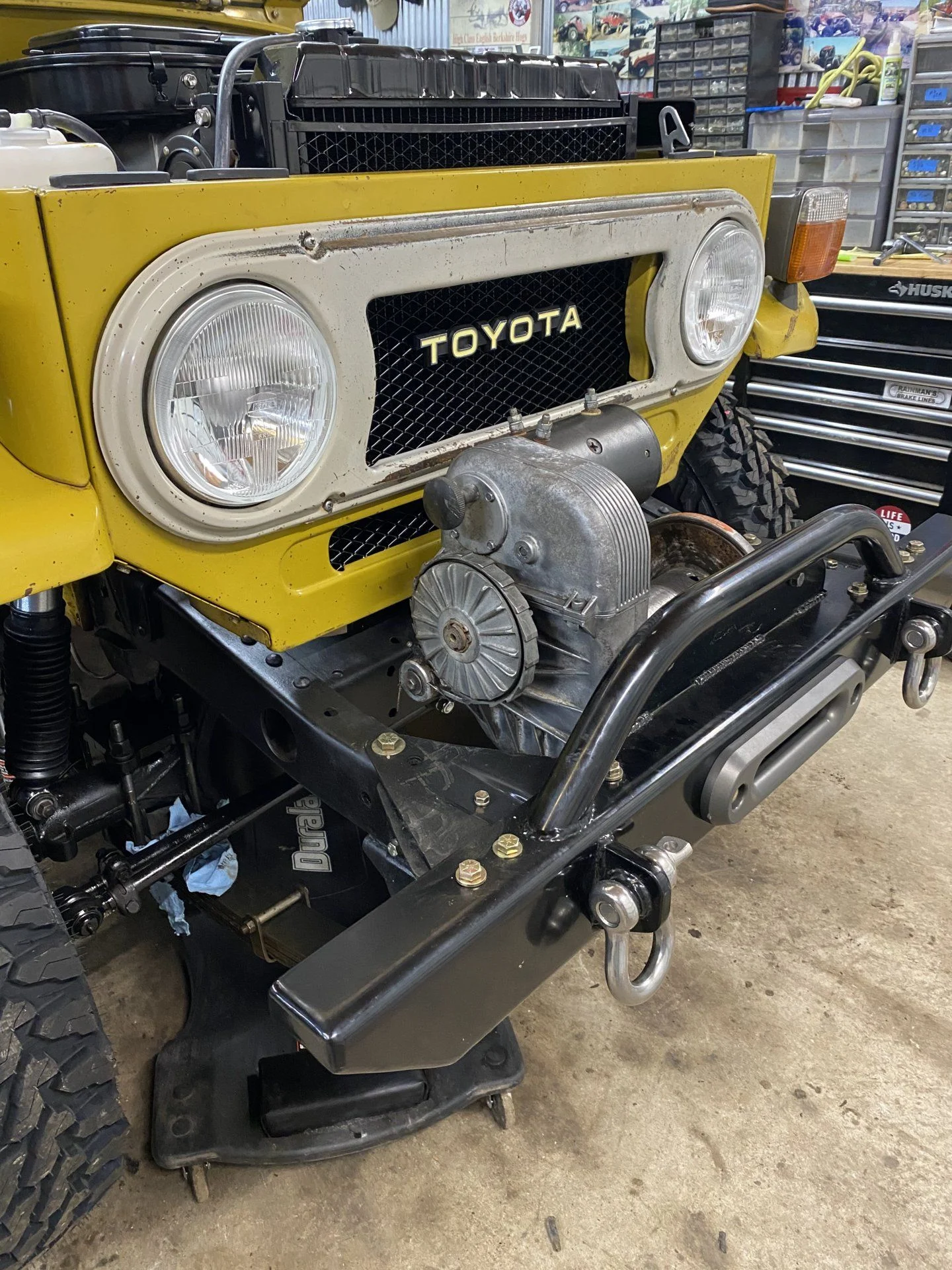

I started in on the brakes using my pressure bleeder on the rears to pump out all the black fluid. We did not do the rear brakes this time but they will be in a possible v2 project down the road
