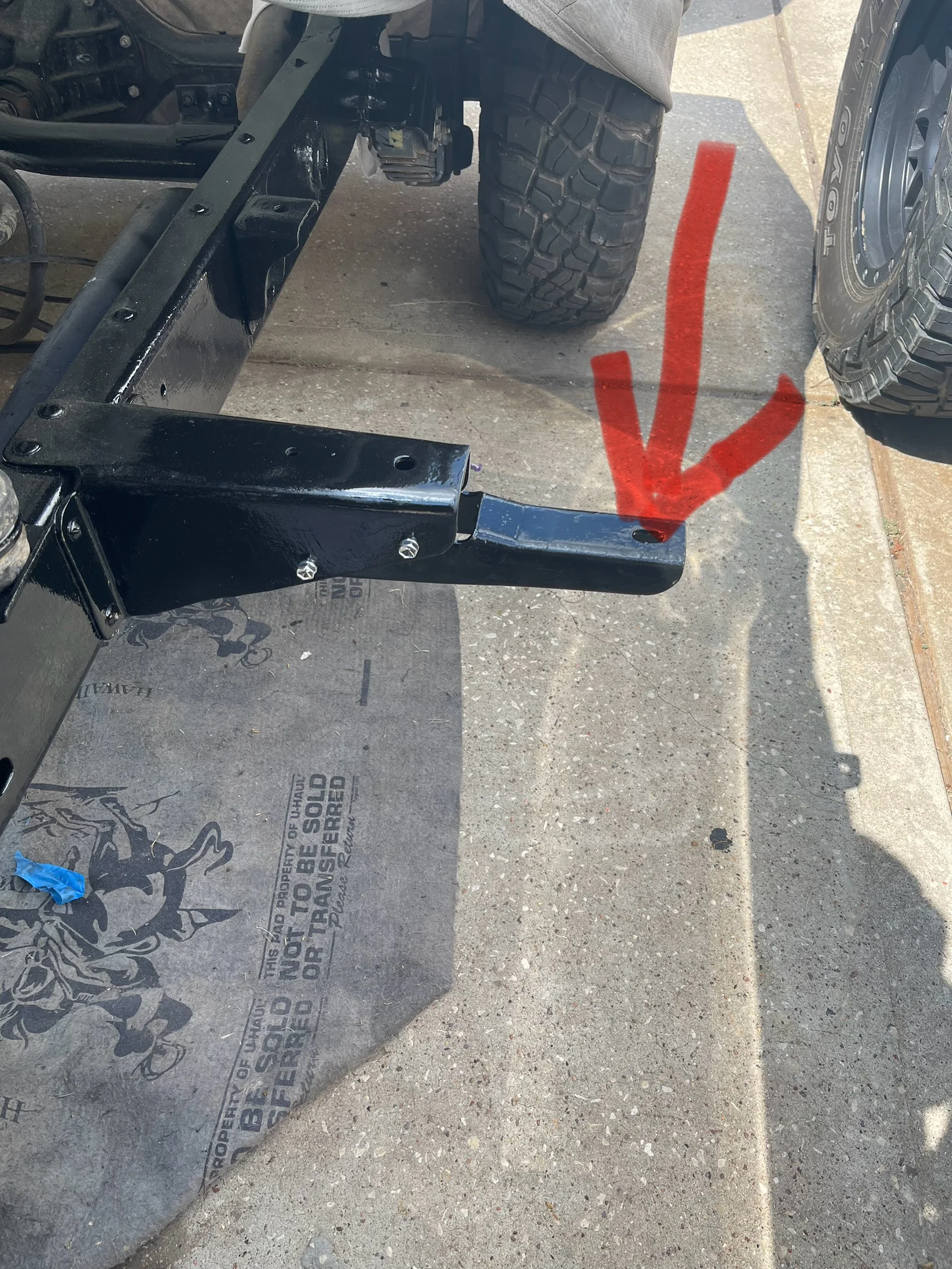

Tommy, if you don’t want to drop the transmission to see if you can run a tap through the hole, then run a bolt a little bit longer that will go through the bellhousing and put a nut on the inside. It’s 12x1.25. I think a stock tow hook bolt should work for you.
You could also one of those steel inserts to return to the factory thread. The drill threw and use a longer bolt with a nut is likely the easiest and most cost effective.

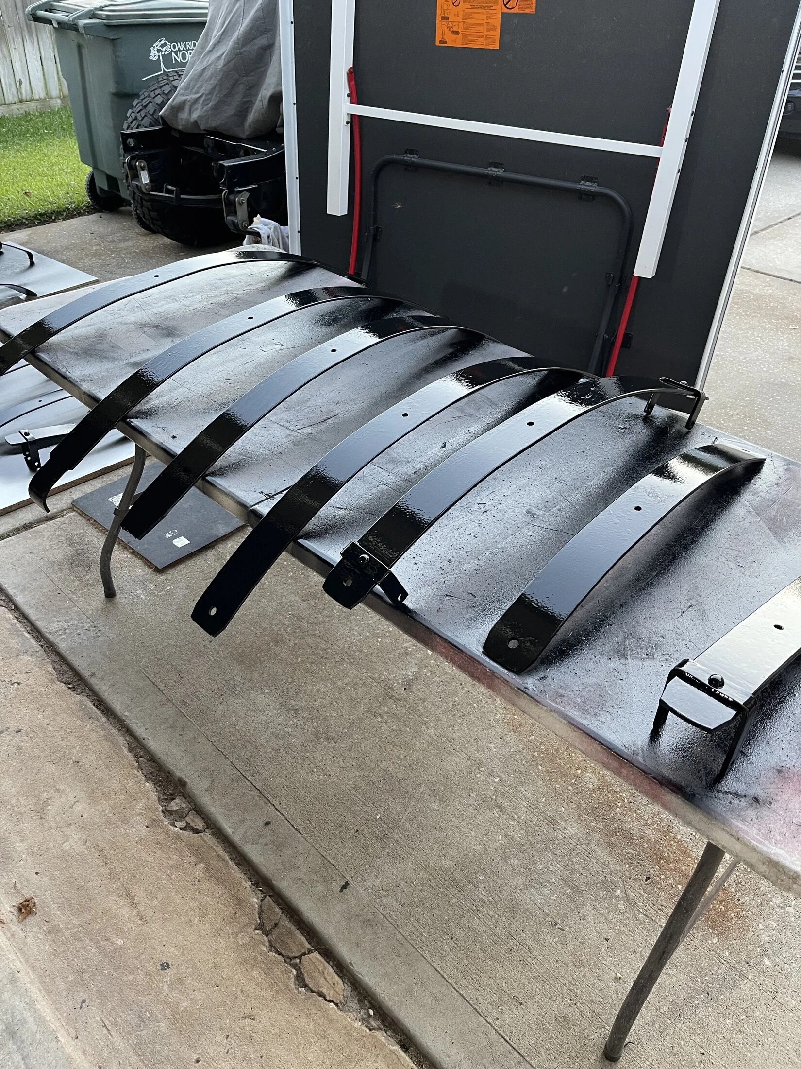

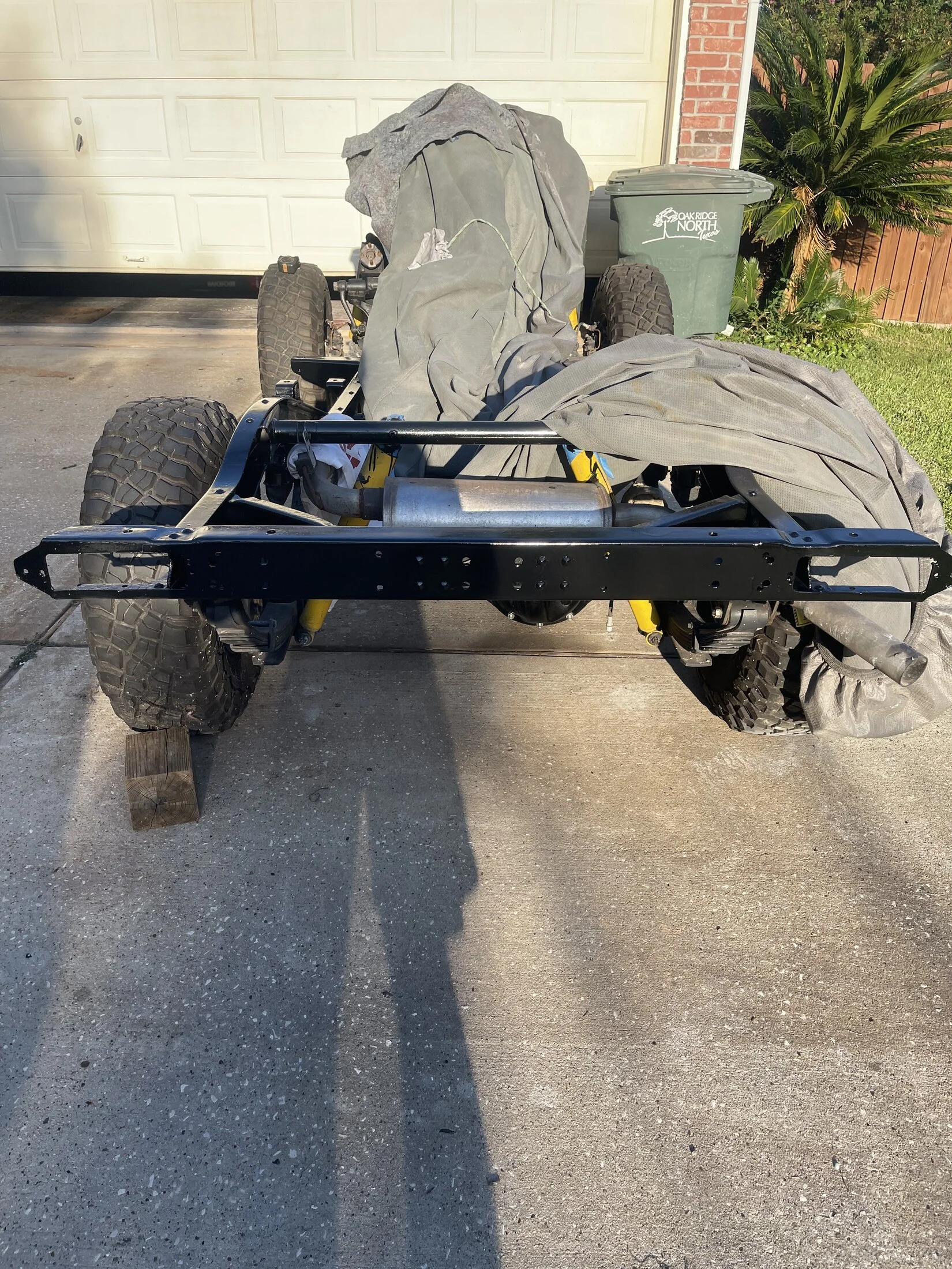

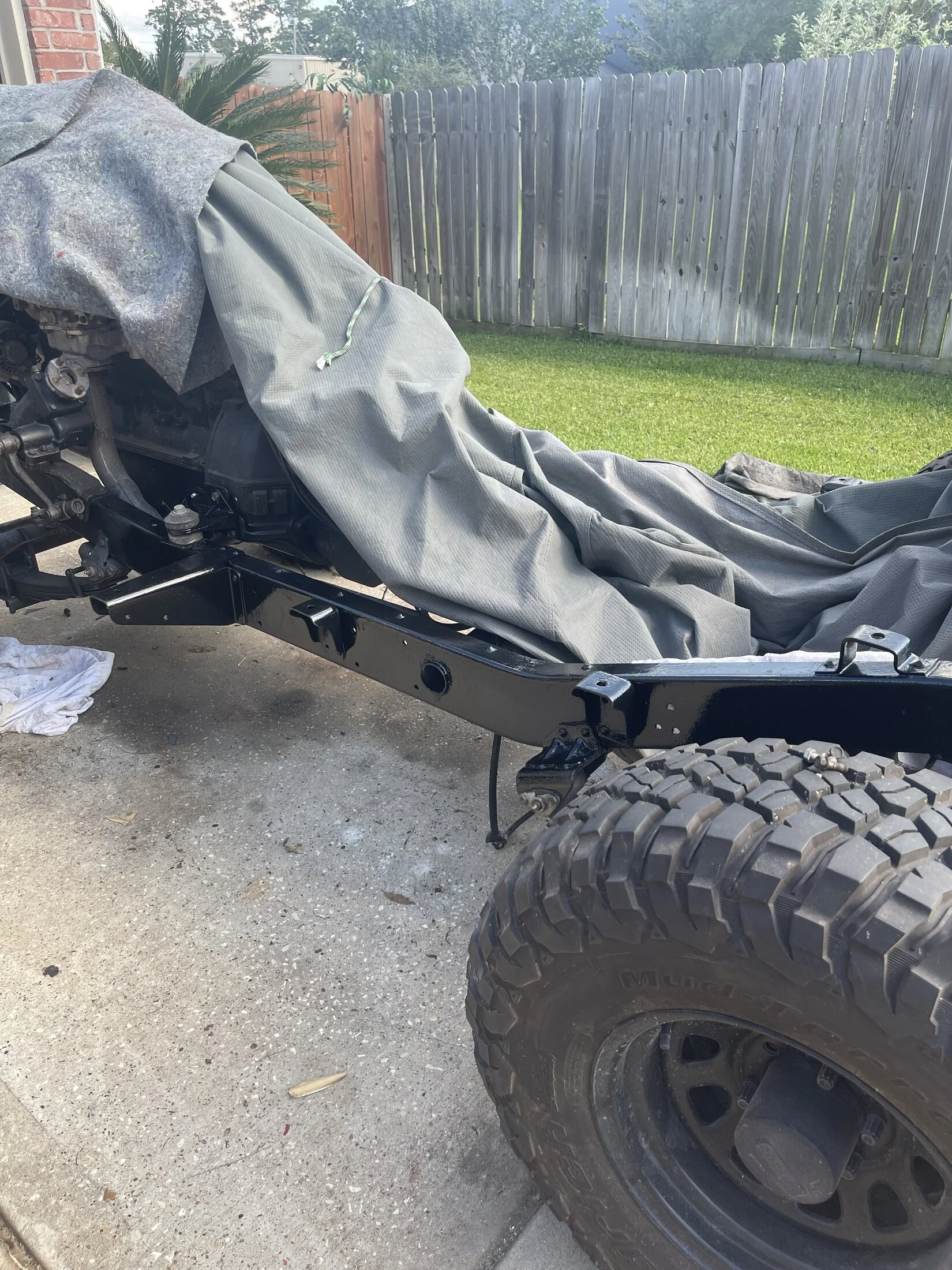

Partly done with frame. Using chassis saver and then spraying engine
Have to rebuild trans. Needs synchro gears, and clutch and pressure plate.
So guess I will look into the insert method.

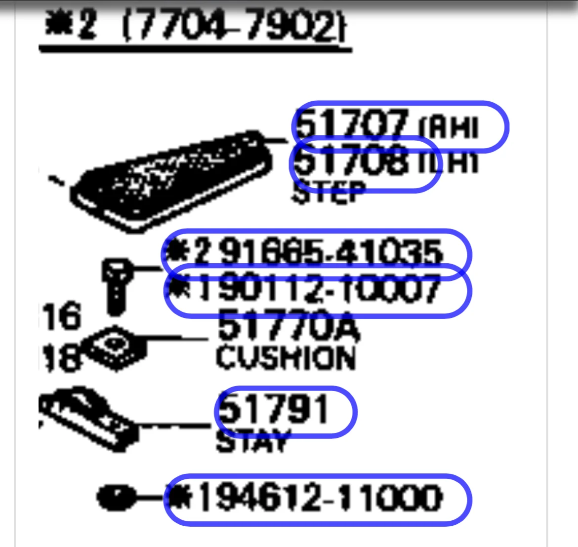

There’s a carriage bolt that slides into the bottom of the step, goes through a cushion and fastened to what you have there with a nut. You can buy a replacement cushion as a ~1/4” thick piece of rubber.
THANKS!

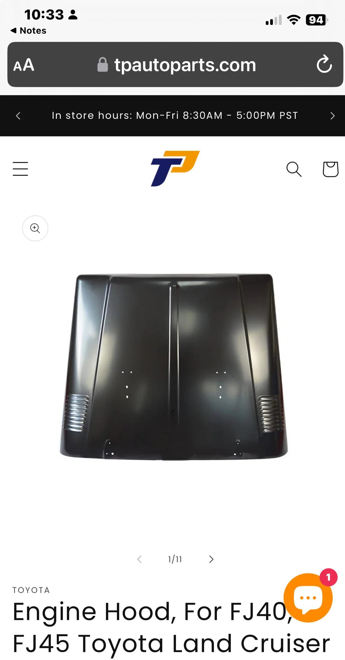

Also, regarding your Topnault hood question, take a look at @dmaddox's latest build, post #1201. He wasn't happy at all.

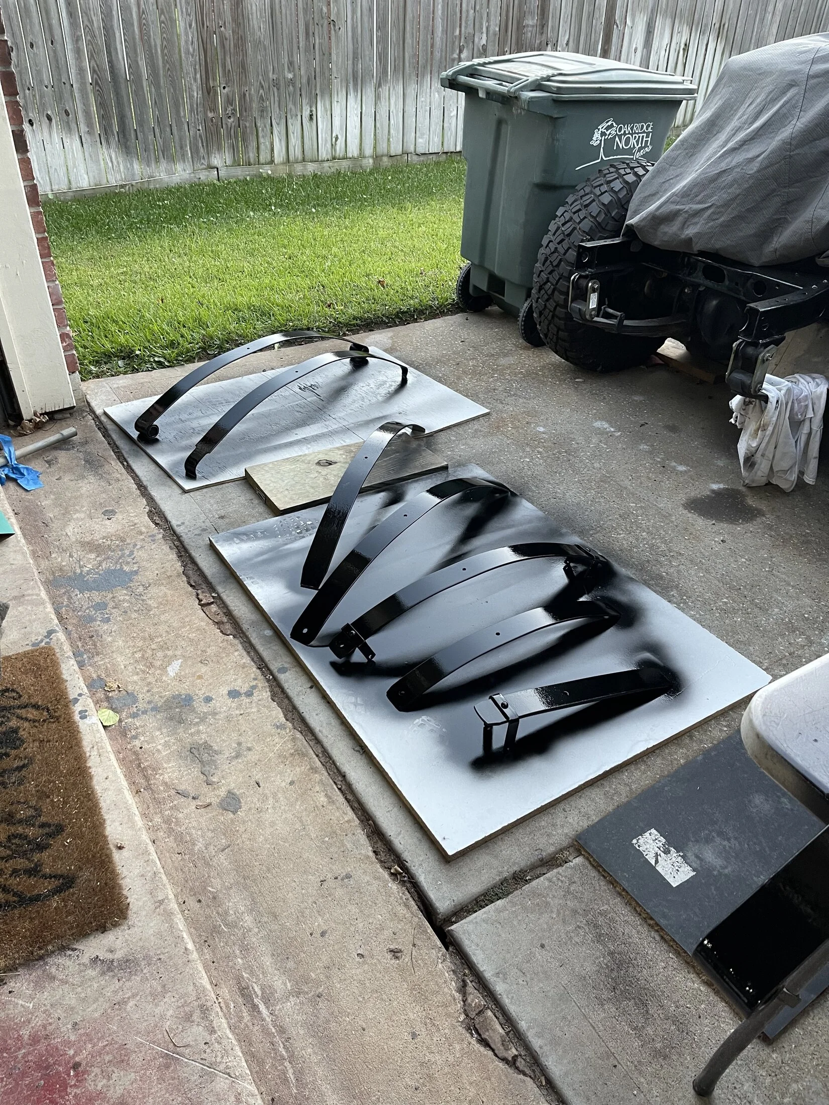

Been very slow going right now. Worked on a few small parts that need my attention.
So what are you guys using for paint on this part, fan shroud and the radiator housing?
Chassis saver?

I use satin enamel black with preparation being key. Lasts and is easy to touch up.
