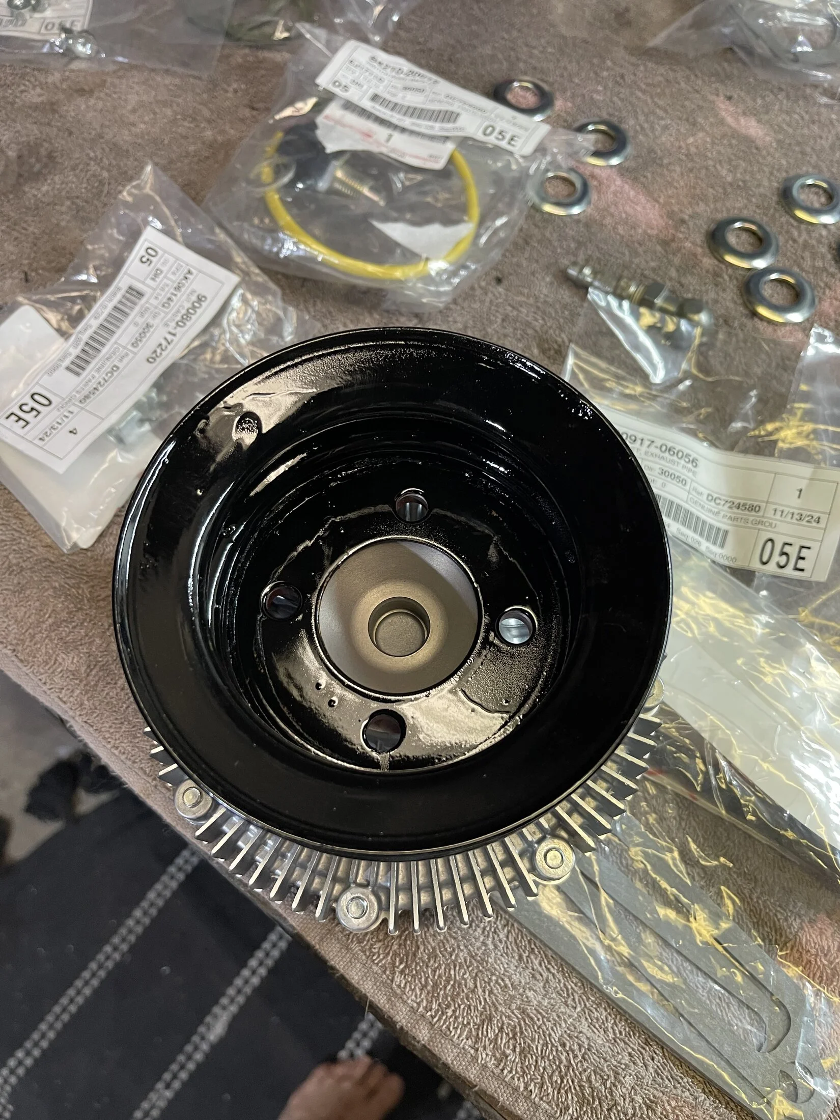

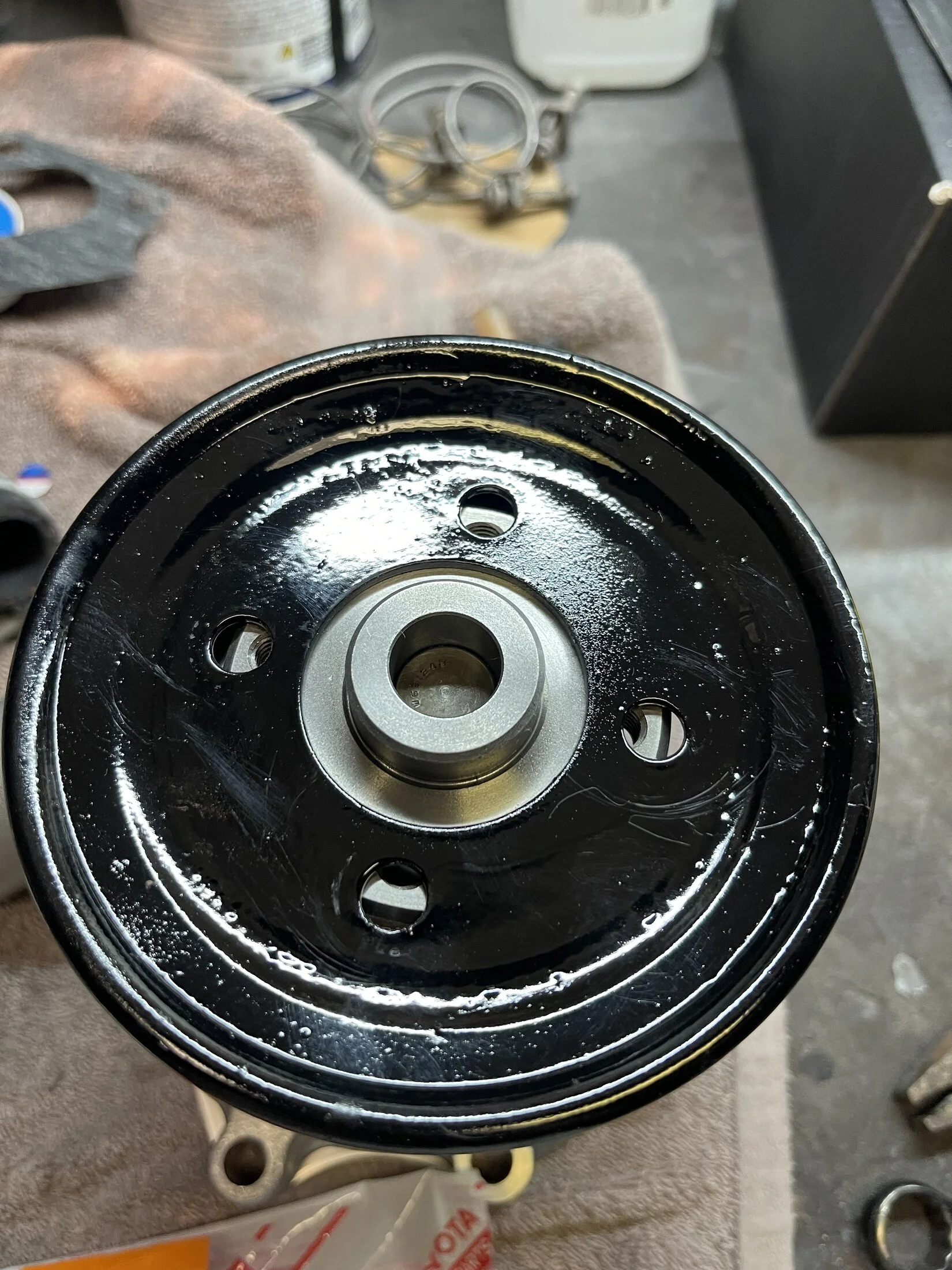

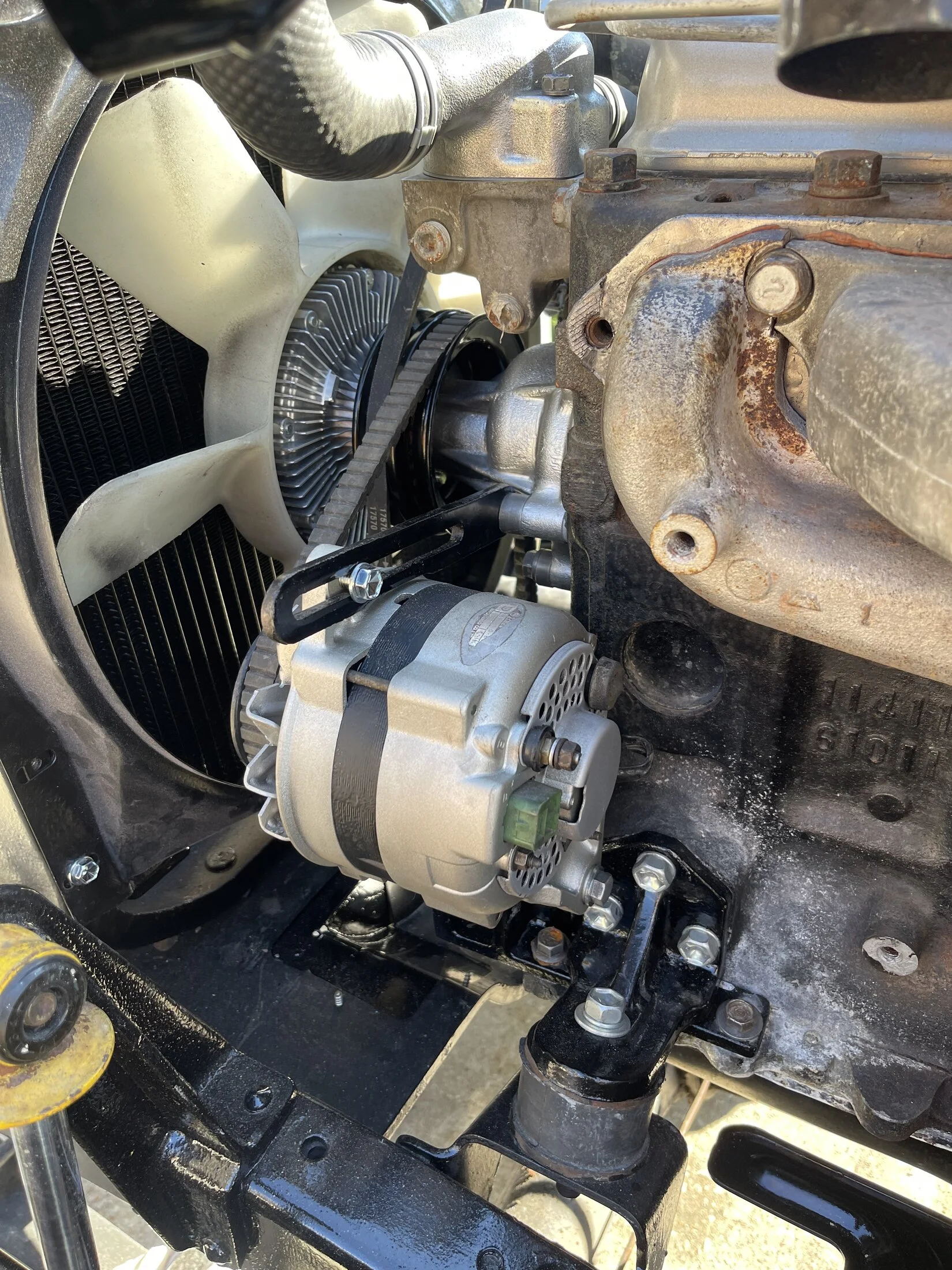

Few more bits cleaned up and painted😍
I enjoy the small things 😂

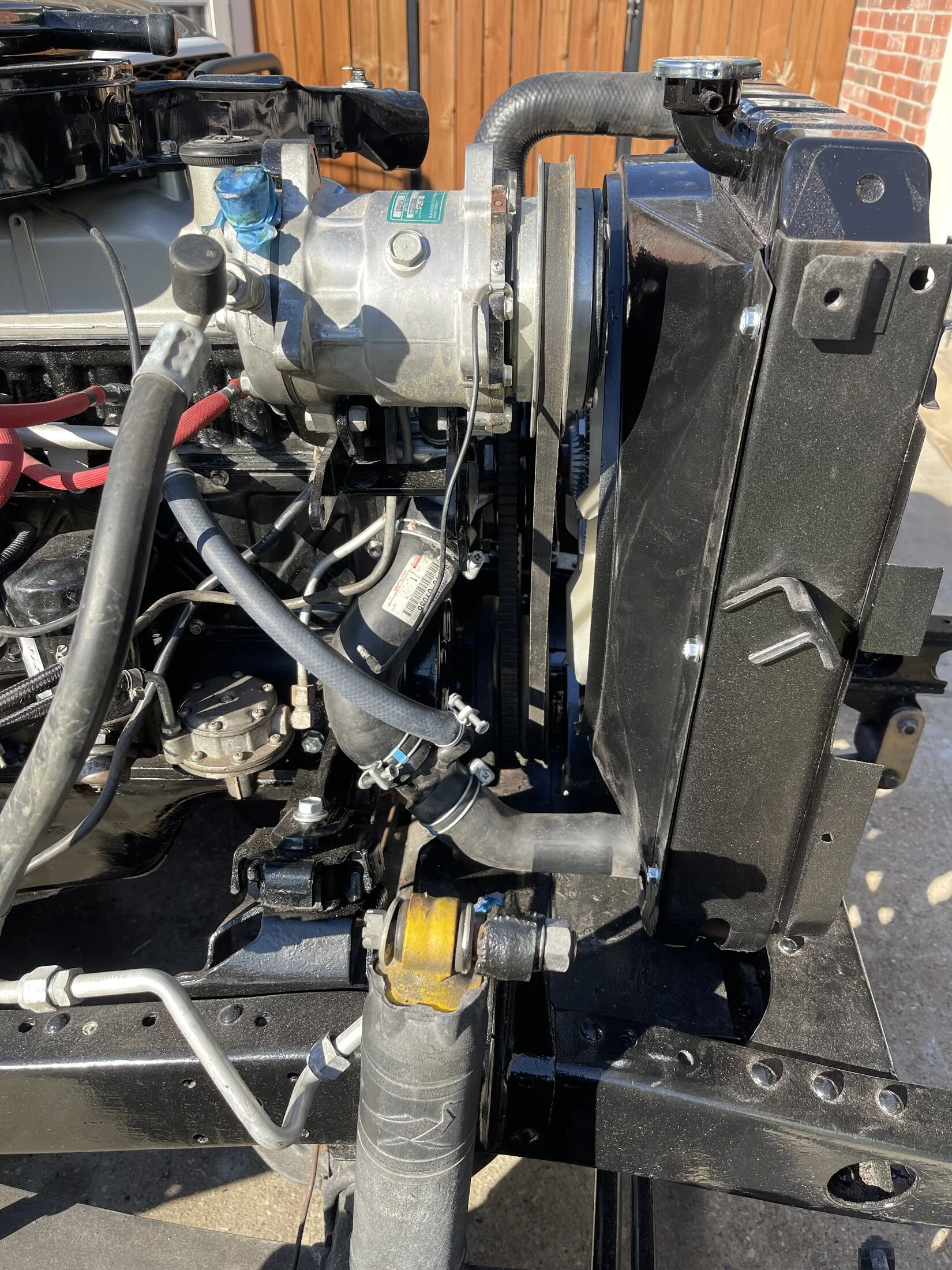

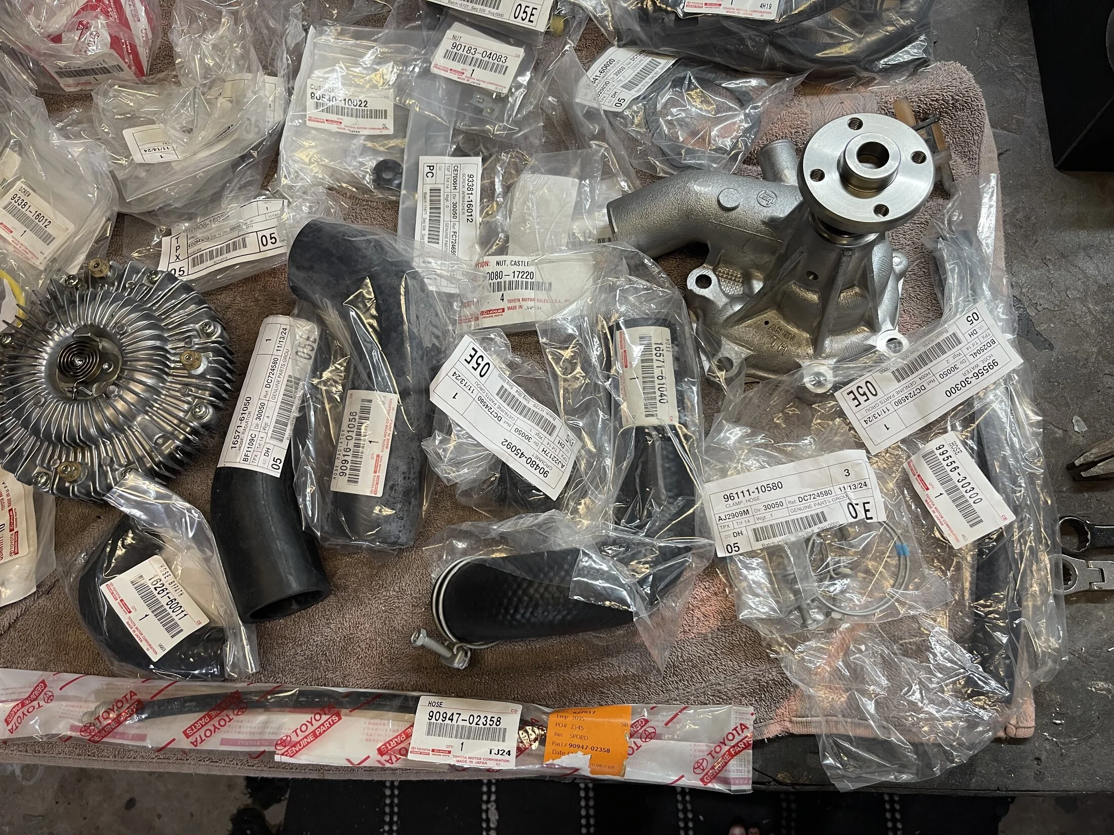

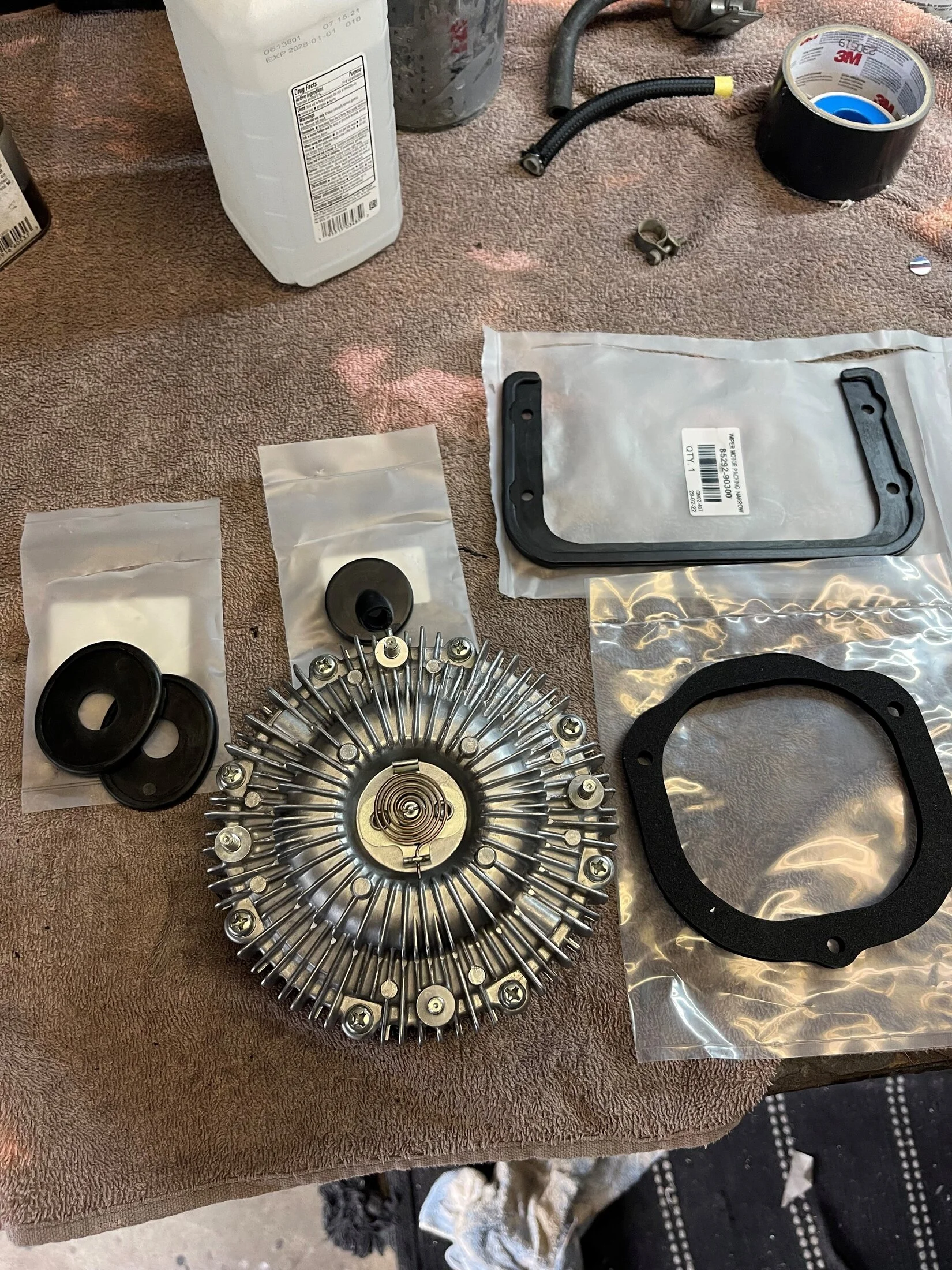

I picked up the hose clamp kit from CityRacer.
It’s nice to have a back stock and change out the rusty worm drive ones as I work on the truck.

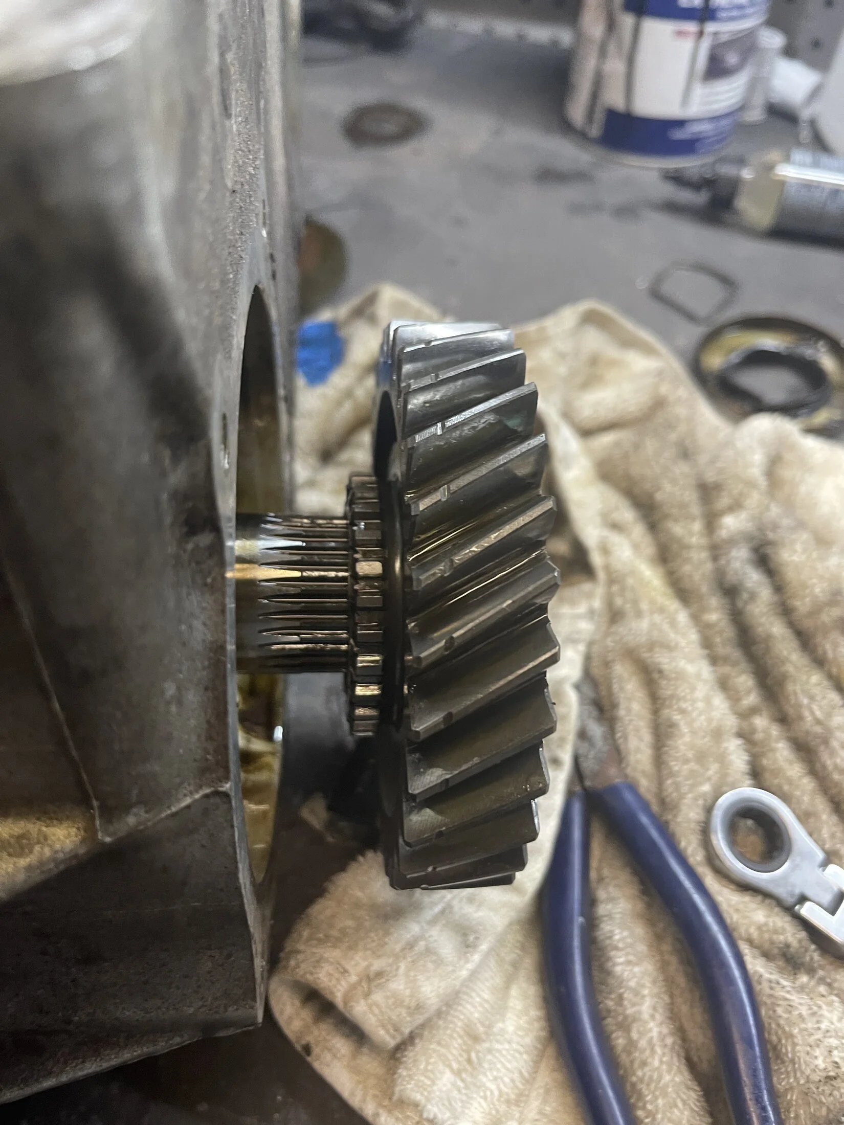

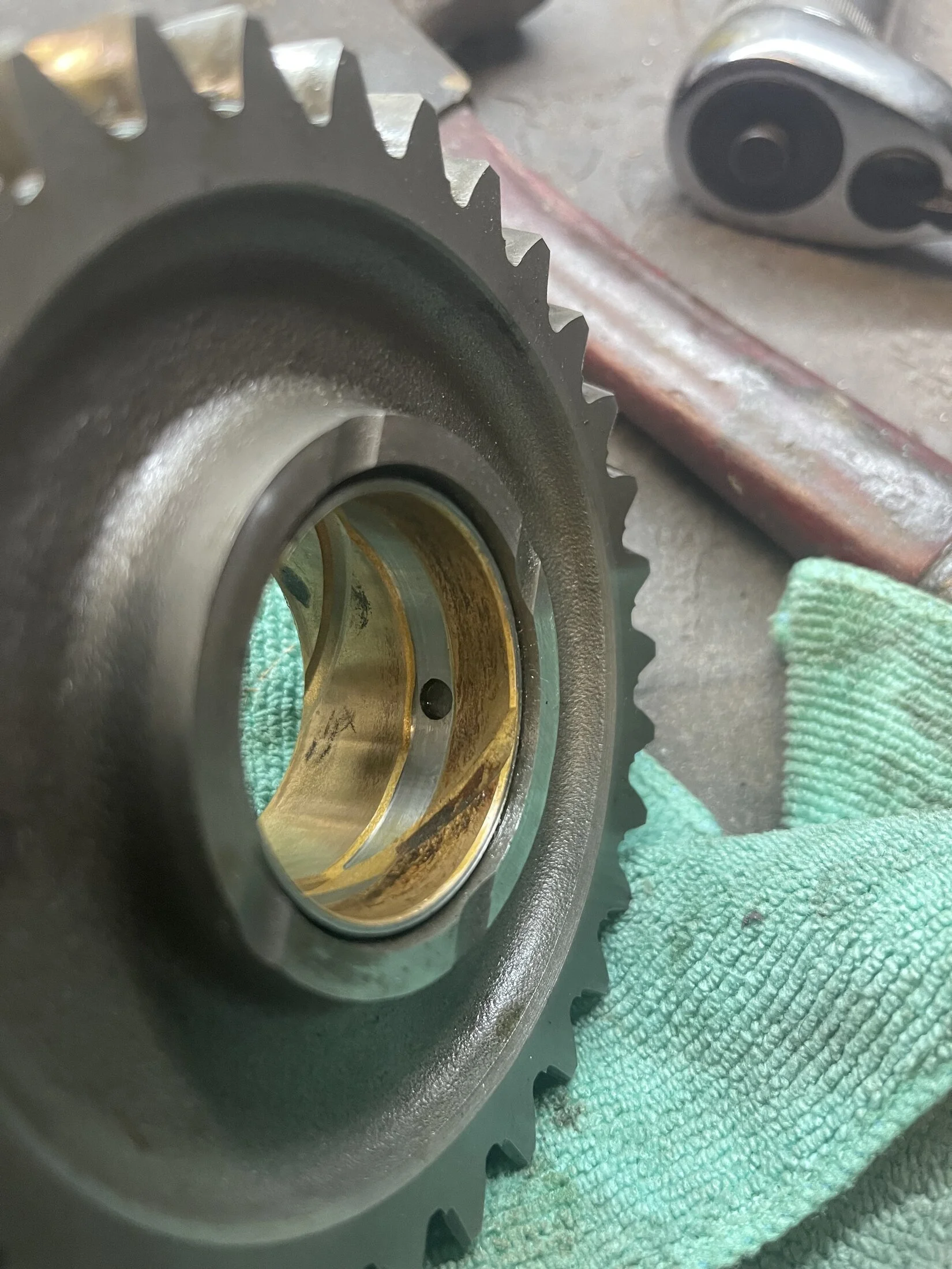

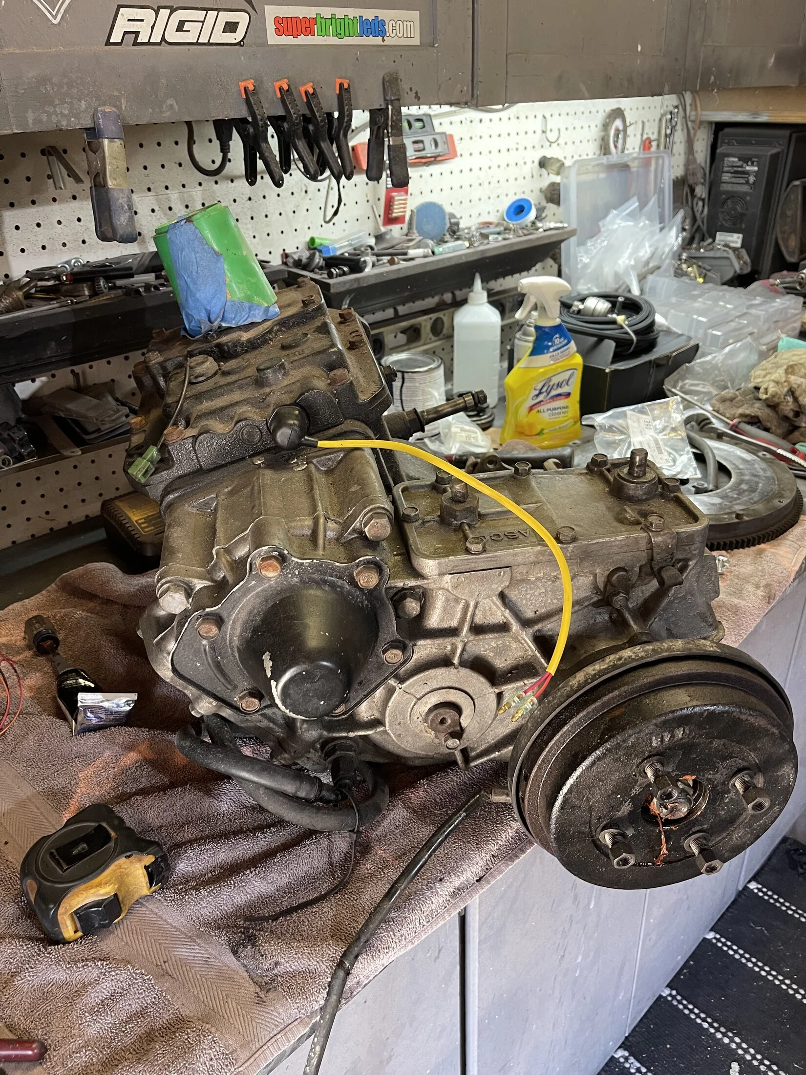

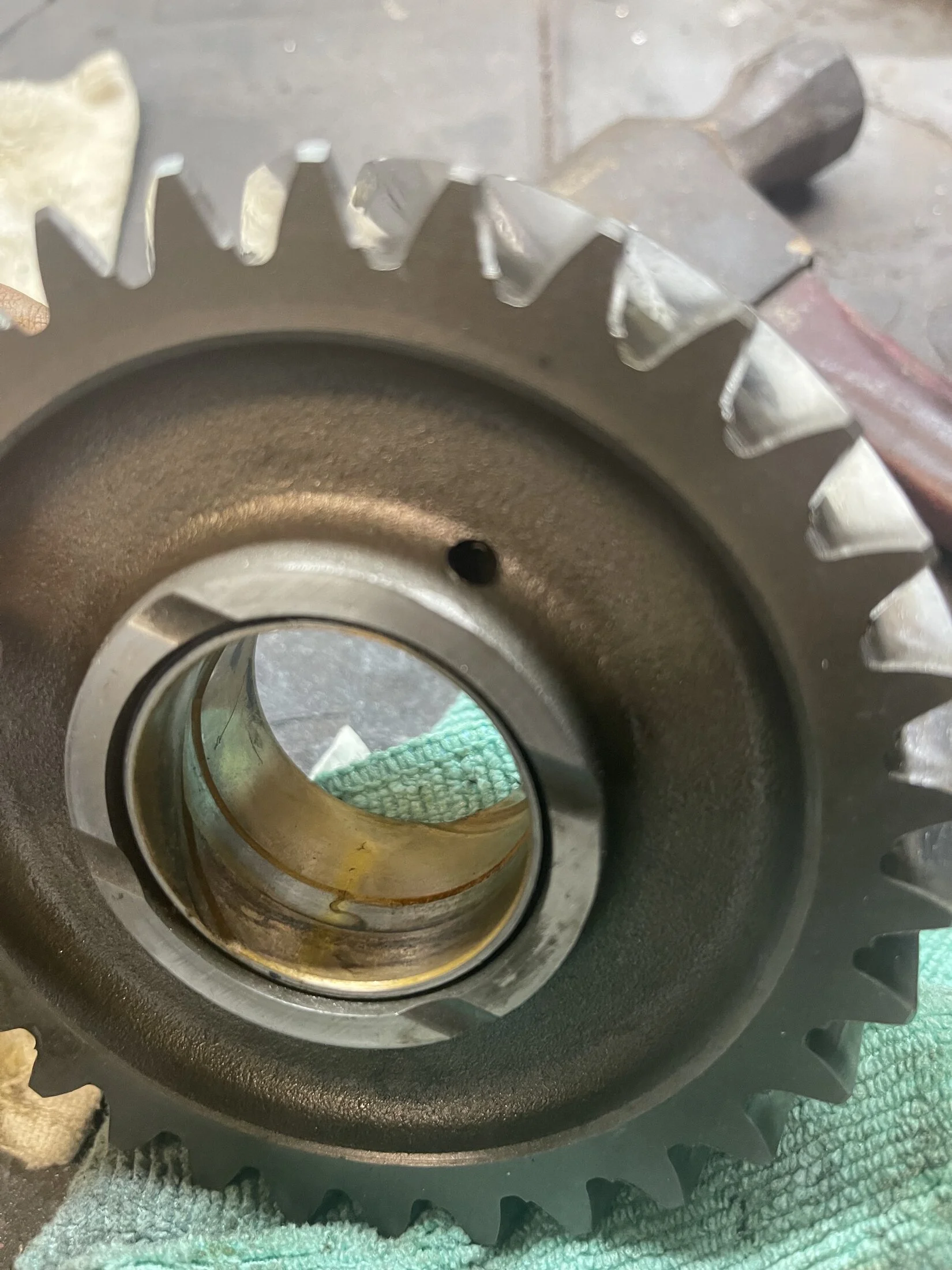

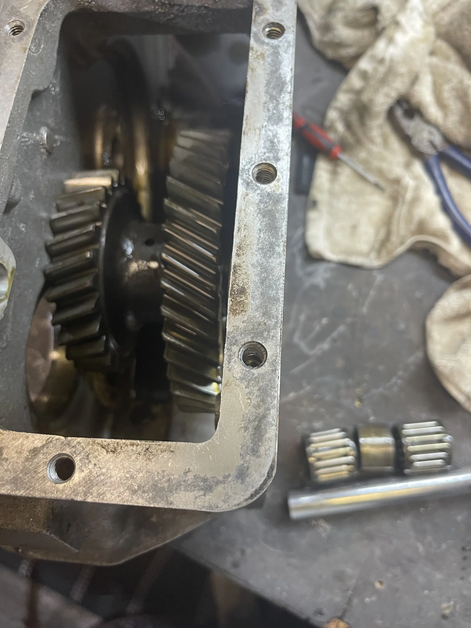

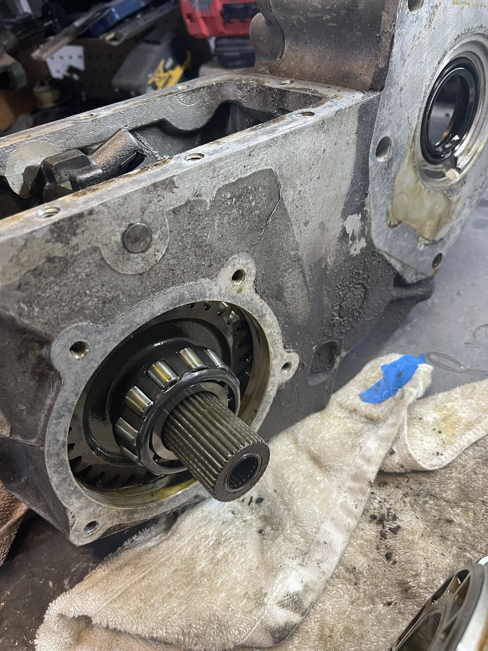

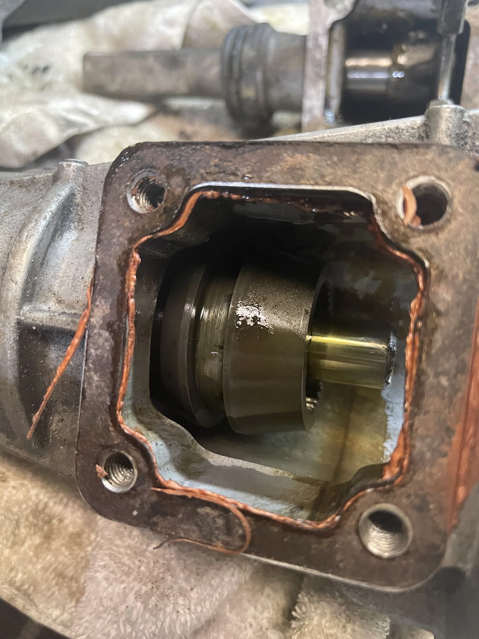

Tore to the transfer case tonight and this gear looks like the bearing twisted inside, does not line up with oil hole, and looks a little worn.
Is this something that comes in the transfer repair kit?

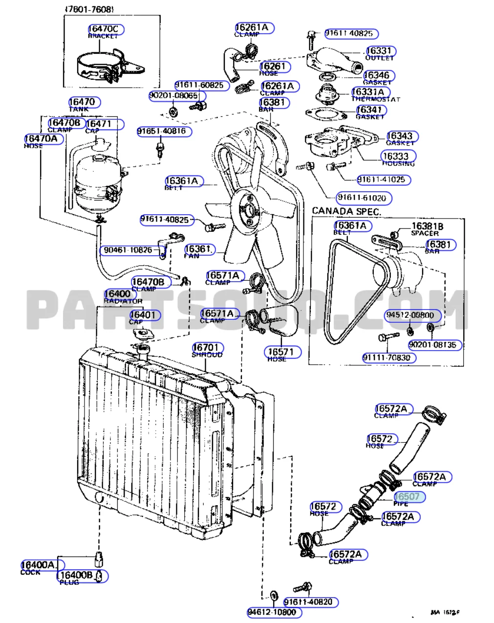

yea, I ordered a bunch from Toyotaparts and the hose side at the engine side is larger than the radiator side. Booooo

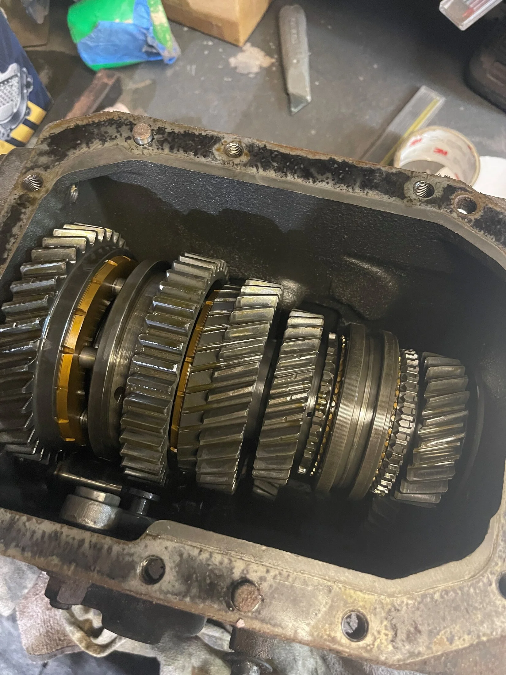

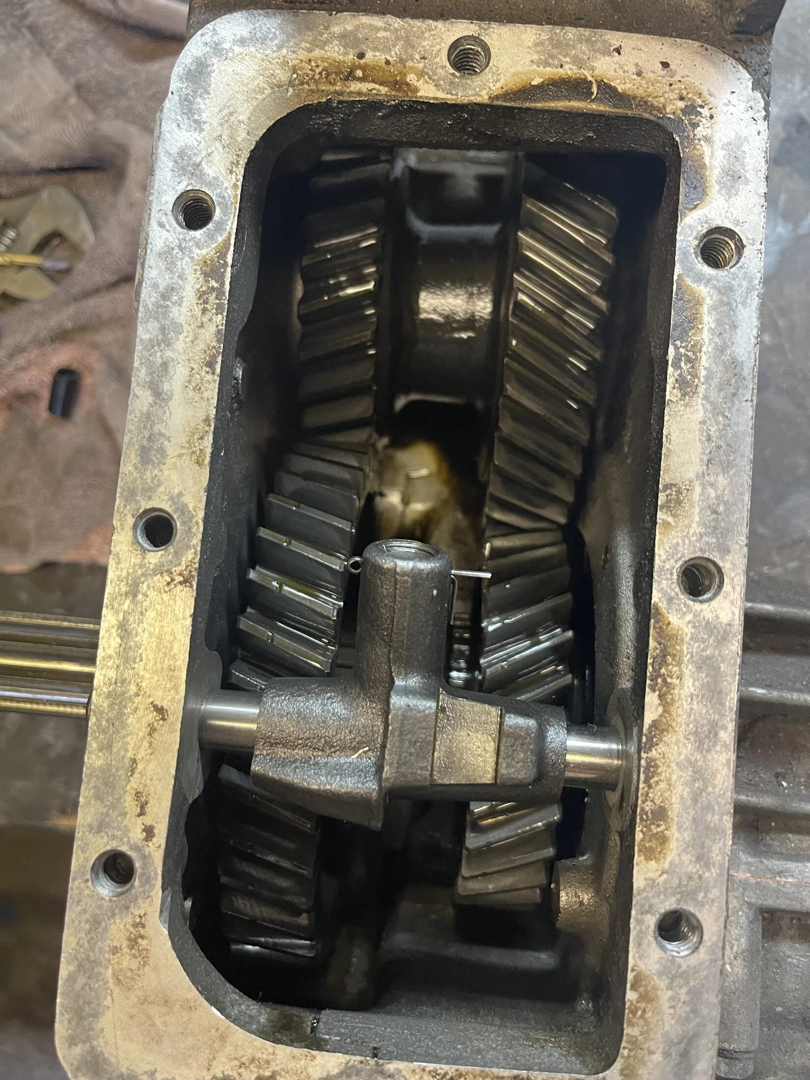

So I had a small amount of metal in the bottom of the drain plug. I suspect that is typical. Looking to change out the syncro gears. Just eye-balling the gears, looks pretty good to me. But I have no idea what bad would look like unless its missing a tooth. lol
