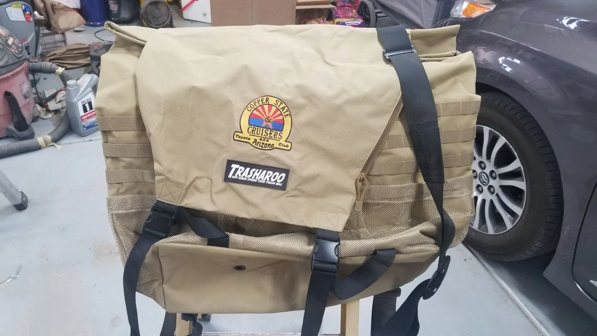

Search Trasharoo. Our local club had a group buy.
Same. Rising Sun up here in Colorado did similar ones with our logo for the club. I used to think they were kind of dorky until I used one once - they’re really so useful that I don’t care if I look like an “overlander”.

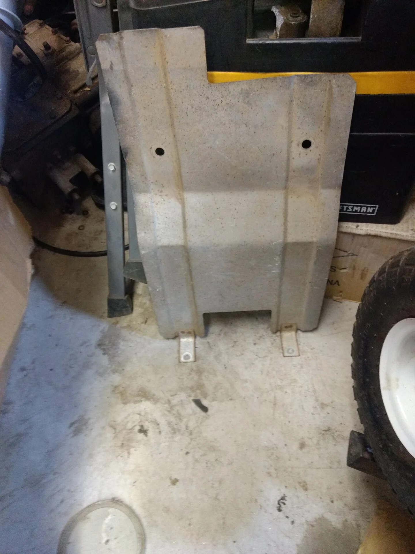

Since your trip is over will bring up a few options to help with keep heat out and moving it out of the cab. Since the heat shield that clamps to the muffler is next to impossible to find (bought my new over thirty years ago when they were still available) would suggest using the 75-78 right behind the skid plate.
Then the 1/75+ that fits under most of the back floor.
It's an interesting option but I guess the 75+ tub must have mounting points under to install them? On my 74 it would mean drilling the body and having nuts inside? (and hopefully not getting in an non accessible cavity)
But for sure the lack of thermal protection here can really be felt...

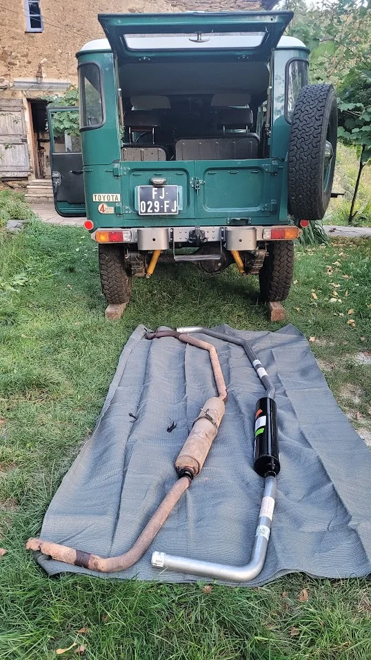

Changing the exhaust is the very last thing I did before leaving for Morocco. The tailpipe was full of holes because the exhaust had moved a little and it was oriented in a way it was collecting water...
But Silencer and center pipe were still good.
Changed all of them for an OEM silencer + reproduction pipes sold by Euro4x4parts (kept my original parts in storage).
The new OEM silencers took 40 days to come (so probably coming from far) and came in absolutely no packaging and full of logistic stickers on it, only the Toyota PN sticker was easy to remove... Also welds in the part where you insert the pipes were not cleaned flat and I had to do it to be able to fit the pipes....................... complete PITA
(checked on my factory one and all inside welds are perfectly cleaned flat)
But for your question, no I did not get any issue with exhaust in my Morocco trip... It never touched and did not went over big rock (and did not got bogged in sand).
My old center pipe touched a few time on offroad situations in Europe but never got damaged by that.

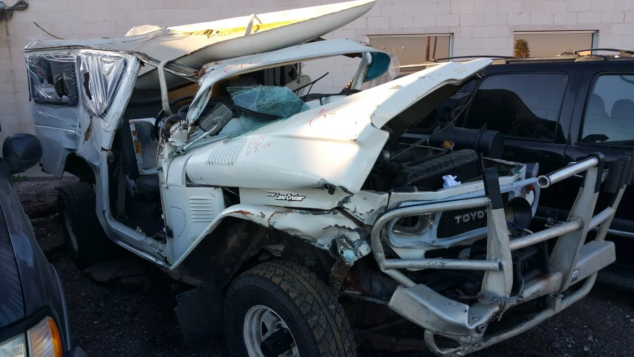

The 60% seat is out of a Middle East FJ45LP. This 6/84 HJ47RV from Australia.
It had great front seats. Different than the pickup. If there were RHD would have probably purchased them . So no I wasn't thinking the bench seat was gone after 9/72. I also didn't think Europe did not get any 40 series prior to 1/75. More that Amayama Trading does list any. They were the easiest to search for part numbers. While back they changed the diagrams to choose a section to search..figured that one out but notice how accurate they listing are is not that good.

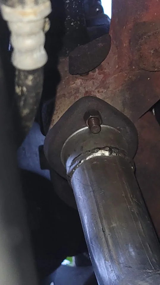

As a feedback on the pipes, they are globally good reproductions and feel a lot more sturdy (probably thicker) than the original pieces, but I'll put 2 little notes:
- Tailpipe: the final bend curve is not the same than original as can be seen on my picture. All angles are perfect and it out exactly where needed so it's really being picky and good luck to anyone to notice without putting the original part next to the reproduction.
- Center pipe: At the manifold connection, the "lip" where the flange pull the pipe is a little small (and the flange hole a little too wide), had to fiddle a little and do a few tries so it was correctly installed without leak but since then it has been good. All angles are correct to the original.

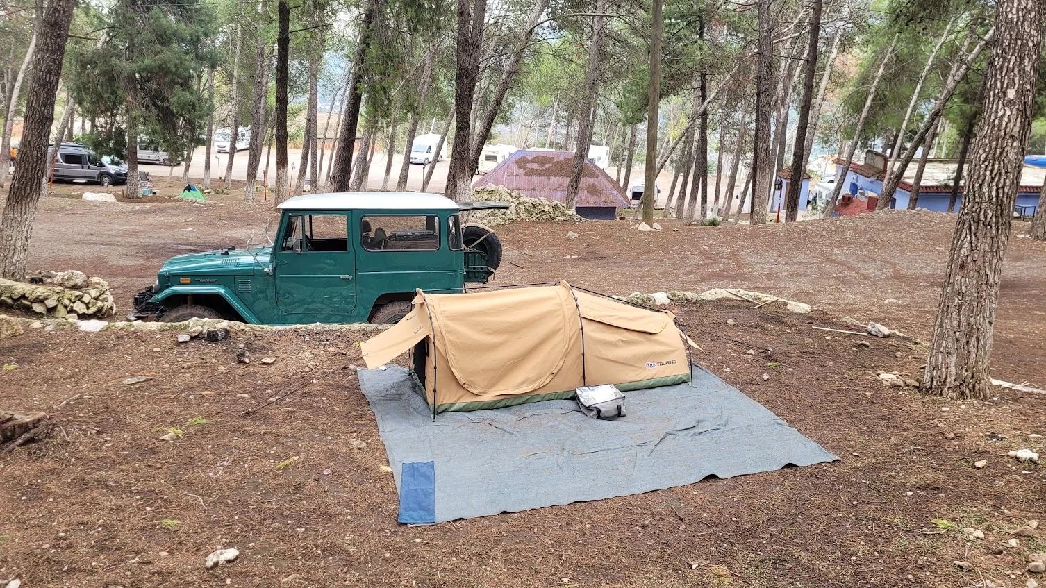

After Anergui I took the mountain road to Imilchil and went to find myself a campspot rrecommended by the lodge owner, on a plateau over the Tislit lake.
This is 2300m altitude and I really froze my ass as soon as the sun disappeared 😅
Still cooked myself a real meal, for only the second time on this trip.
Hopefully after a couple of hours in the swag, temperature inside got better and I had quite a good night.

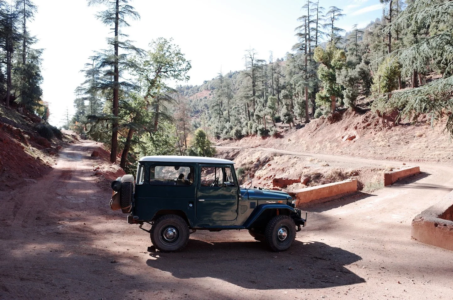

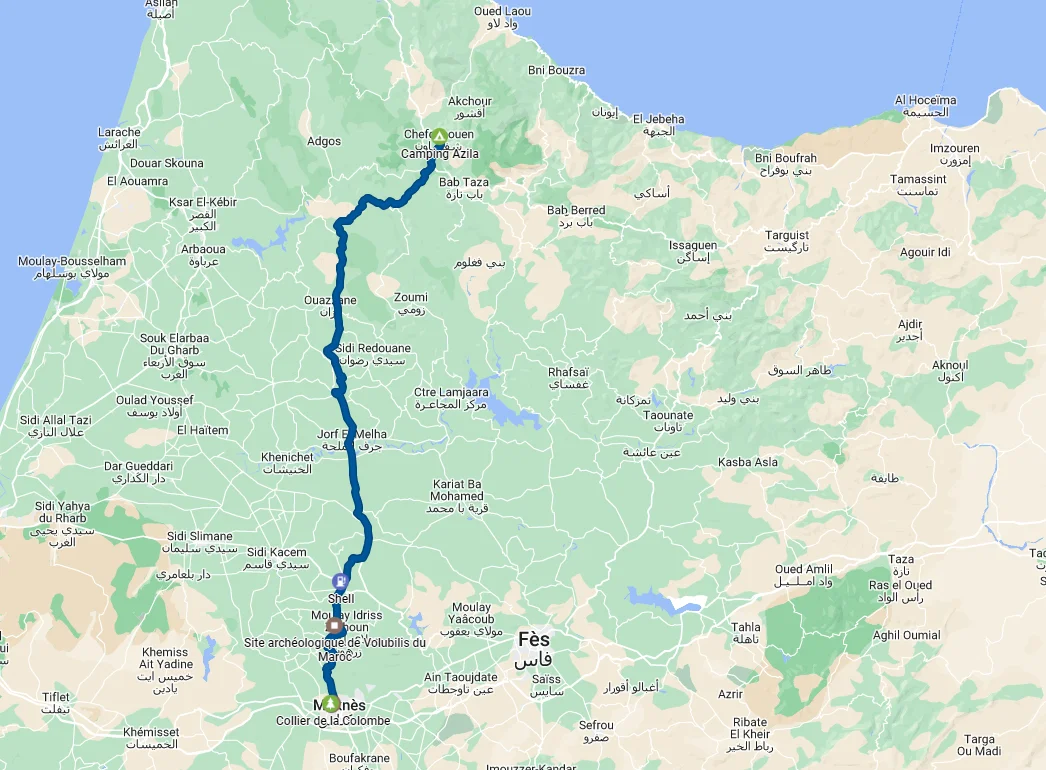

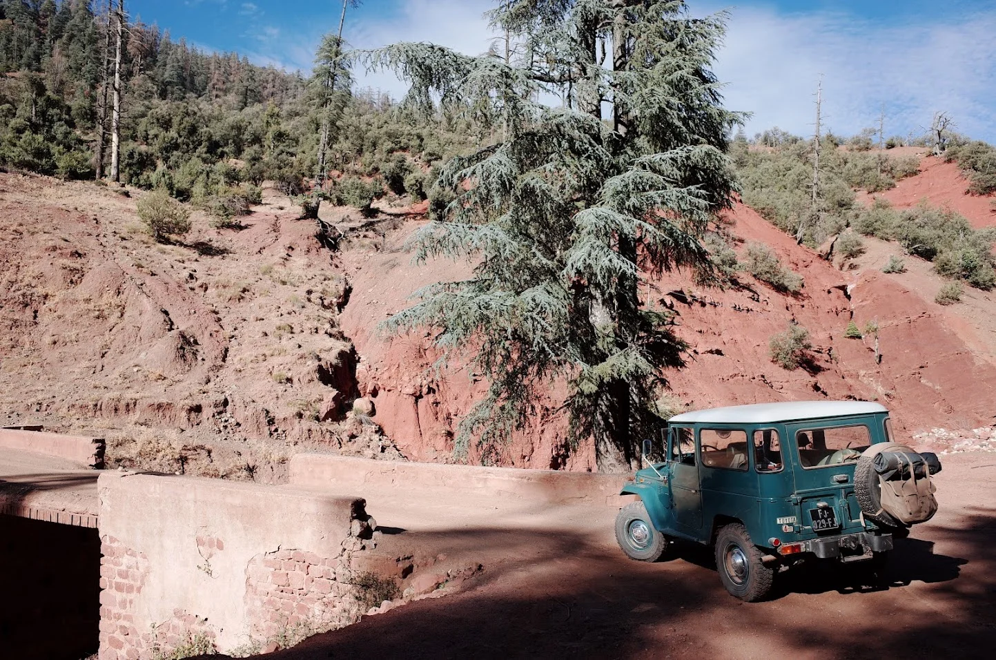

It is time for me to start heading North toward my return boat and I plan to do a little more touristy/cultural visits on the way.
Today target is to go from Imilchil to the former imperial city of Meknès.
I don't have a very specific route plan for the day so when at a stop on a little café ont he side of the road someone tells me that I should visit Khénifra national park I decide to divert and go through it instead of taking the main roads.
That was the last light offroad of this journey... I then reach Meknès at night and after getting some lost in the old city finally find somewhere to park and walk to my hotel with a very nice view over the city.
I then go not too far to visit the former Roman city of Volubilis.
On the background can be seen Moulay Driss, one of the saint city of Islam. It seems that people living in this area, spread over 3 different millennials, all decided to build their capital in this here, for some reason.
I then head North to Chefchaouen.

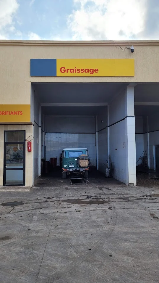

On the way I get a last grease job for the FJ40, the 3rd one since in Morocco... How cool is-it to still be able to have a quick real full service at a service station?
For 2€ they will grease every single zerks they can find, included the PTO.
Finishing the day at the Chefchaouen camping, not the wildest camping but at walking distance from the city.
