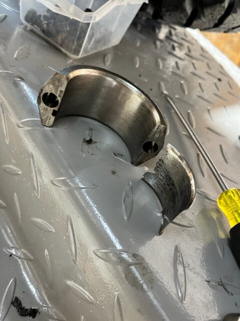

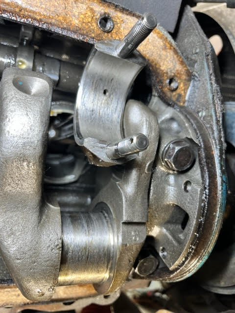

Here is what I found, all looked ok and were tight except #1, took it apart, see below. I've seen some videos of these being cleaned, sanded with 400 or so and put back together, anyone ever done that?
Stop 🛑 don’t use sandpaper. Looks like your into professional help on this one. Cant tell how+deep you are by the vid. I think .025 is the most you can go when you have one turned. Someone fact check me on that..
You have a good competent machine shop close by? I/we used NAPA years ago todo SBC’s not sure they provide that service in house.
@cruisermatt might be able to look (eyeball) at that vid/pic with a calibrated eye and give you some feedback on the viability of saving your crank, or point you to a replacement…
