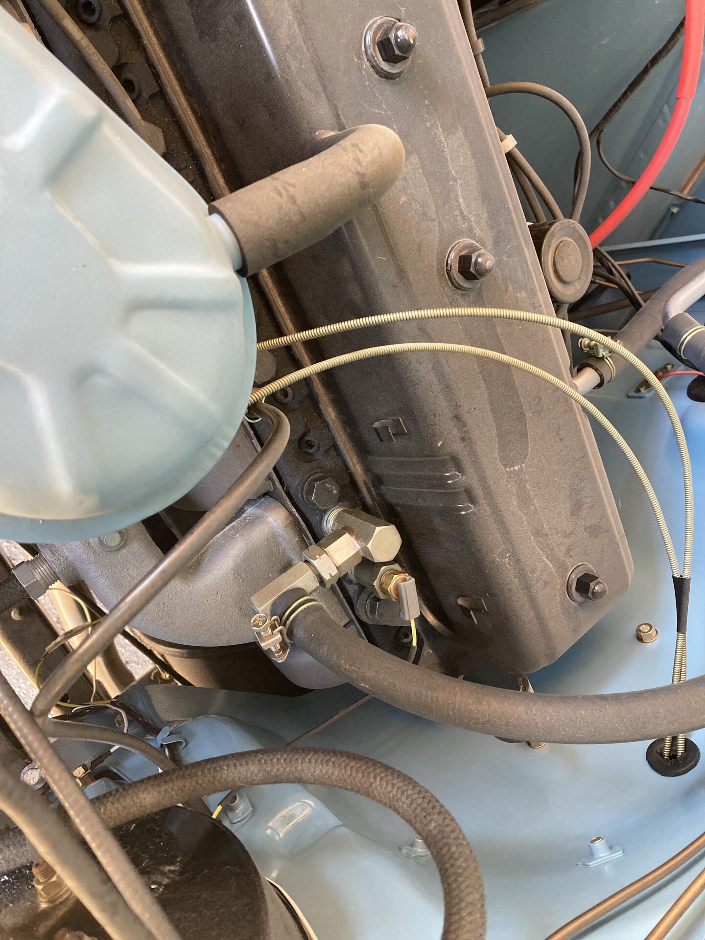

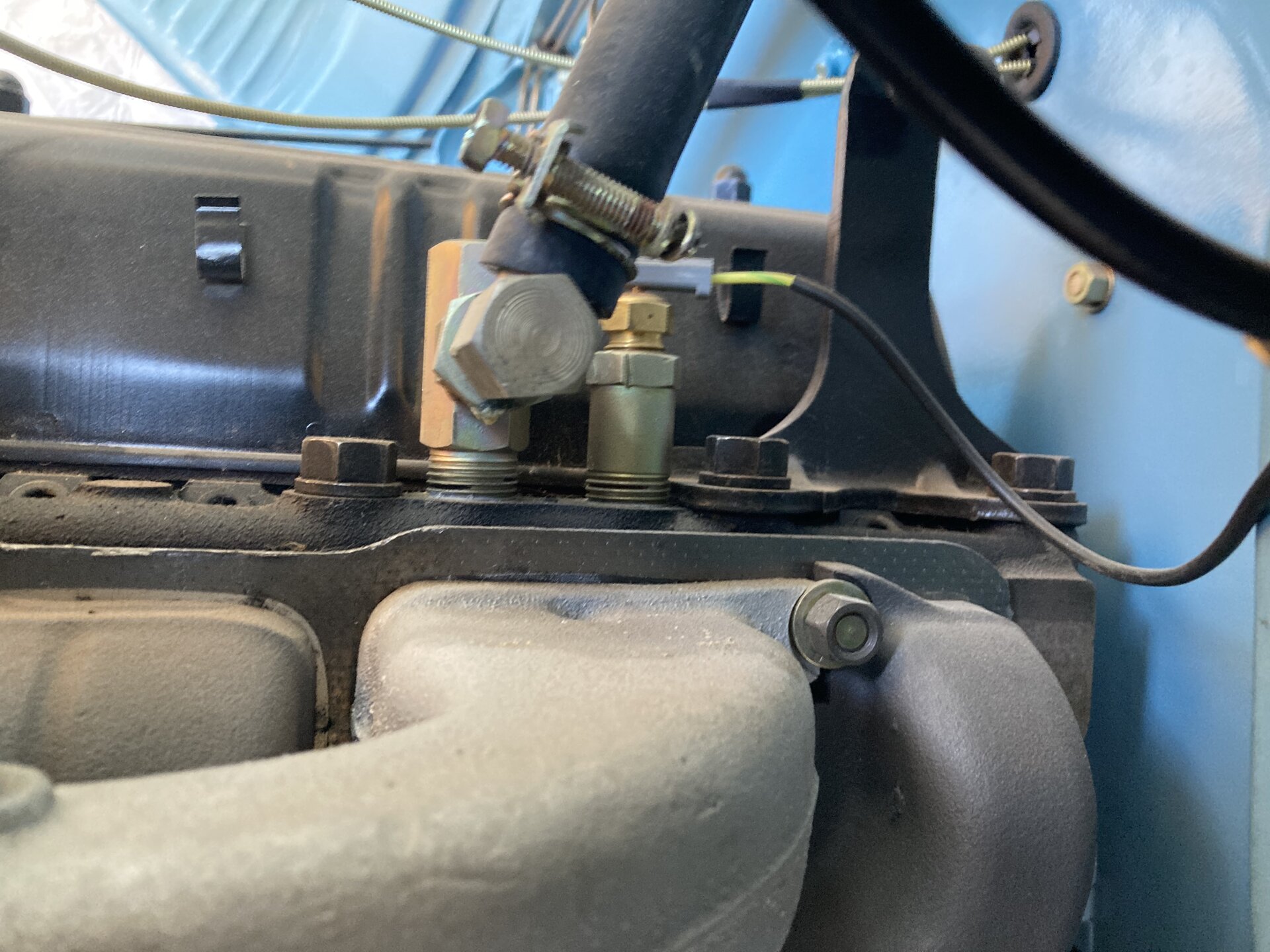

No clue for oil temperature but the port for the oil pressure sender is on the block way below the carb.

Good info, thanks. I did mean the pressure not temp on the oil, I see where it goes now, I'll just need to get it back in. When I pull the plugs and crank it over to get pressure, do I have to unhook the gas from the carb?

Perfect pics! I have all those parts and will get these mounted correctly now, thank you
