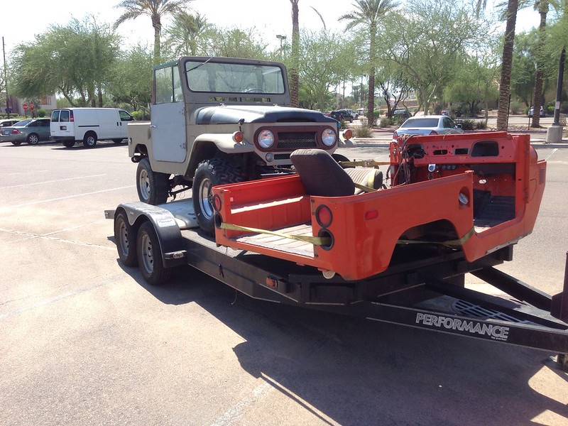

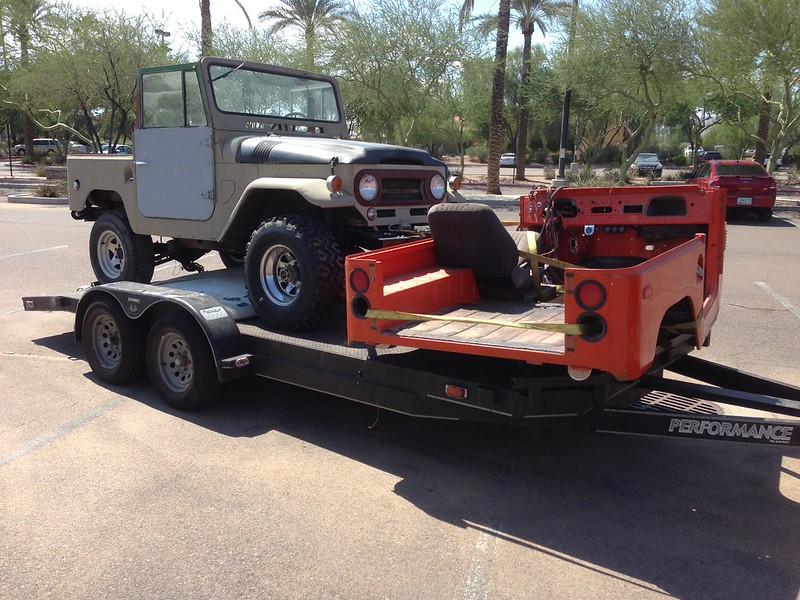

The tan project is originally an AZ truck. It's a 1963 and SUPER clean. I will be doing a resto-mod on this- 2F/H42, discs, etc. It has the stamped bezel and vents in the windshield too. The orange one was isnt as clean as the tan, but still very nice. The rear tailights will need to be filled, they are pretty ugly. It will need a little bit of work on the rear sill. It's a 1972 and will go on the this project 40.
Here is a pic of my load. It was like this from Phoenix to Austin. I got some stares along the way :) And my MPG from Phoenix to Austin was BAD, I wonder why? :grinpimp:
