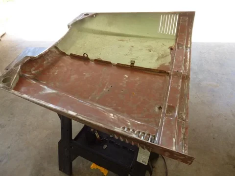

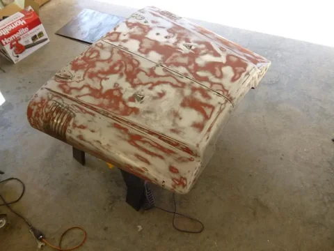

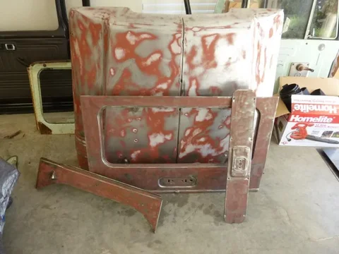

Dove into the sanding stage on some of the panels today. Hood, back hatch, and aprons.
Both sides are getting addressed. I will remove any and all rust I see.
Back of hood
Top side

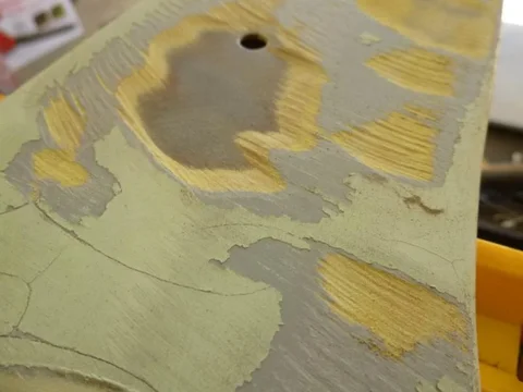

!@*? BONDO/ FILLER LOVERS... about 1/4" +/- thick (BLASPHEMY) A little is understandable, but .... Note how the paint has cracked out. We'll get it right though.

wow, that looks great J!! too bad about the PS apron, I will look for one of those
Thanks Jas, I still have a way to go though. Slowly, but surely.
I'll strip the rest of the filler off the apron and see how bad the metal is underneath. Looked like it had been beat to death by the little I saw.
Hopefully it was an inexperienced person and just needs a good hammer and dolly workout. :D
