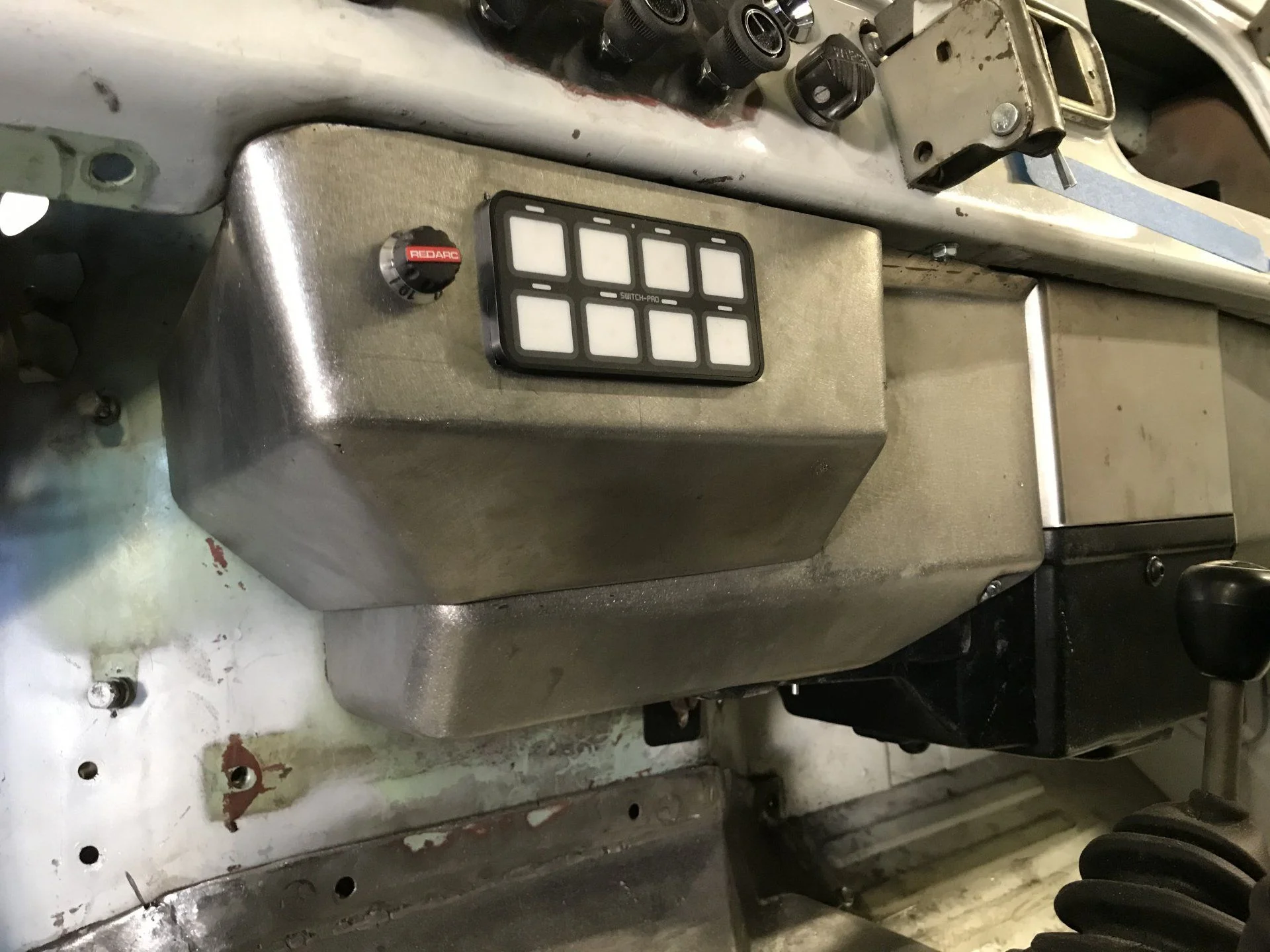

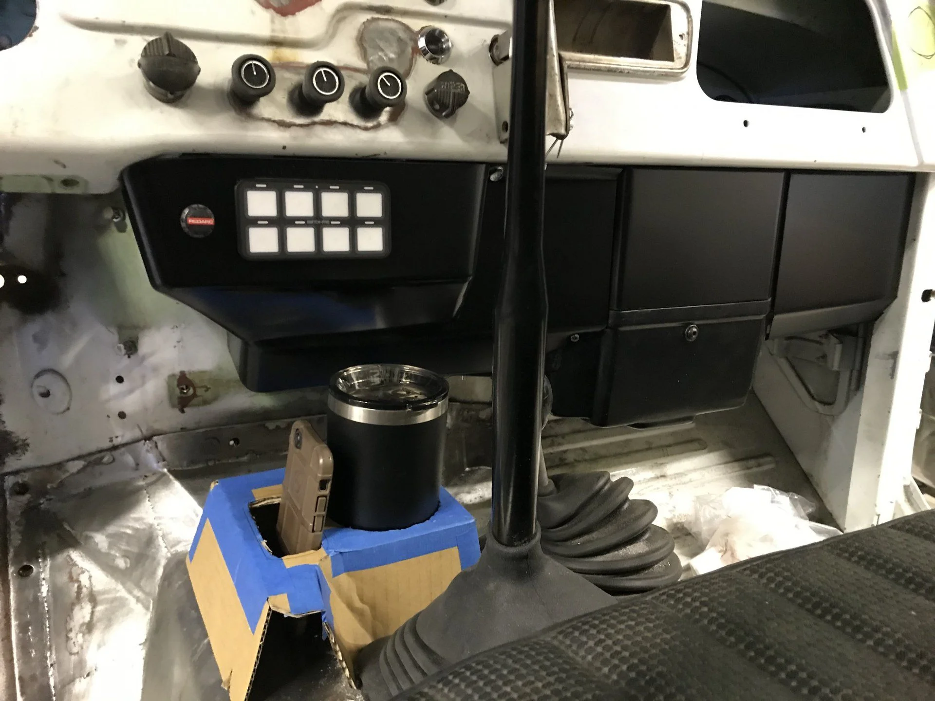

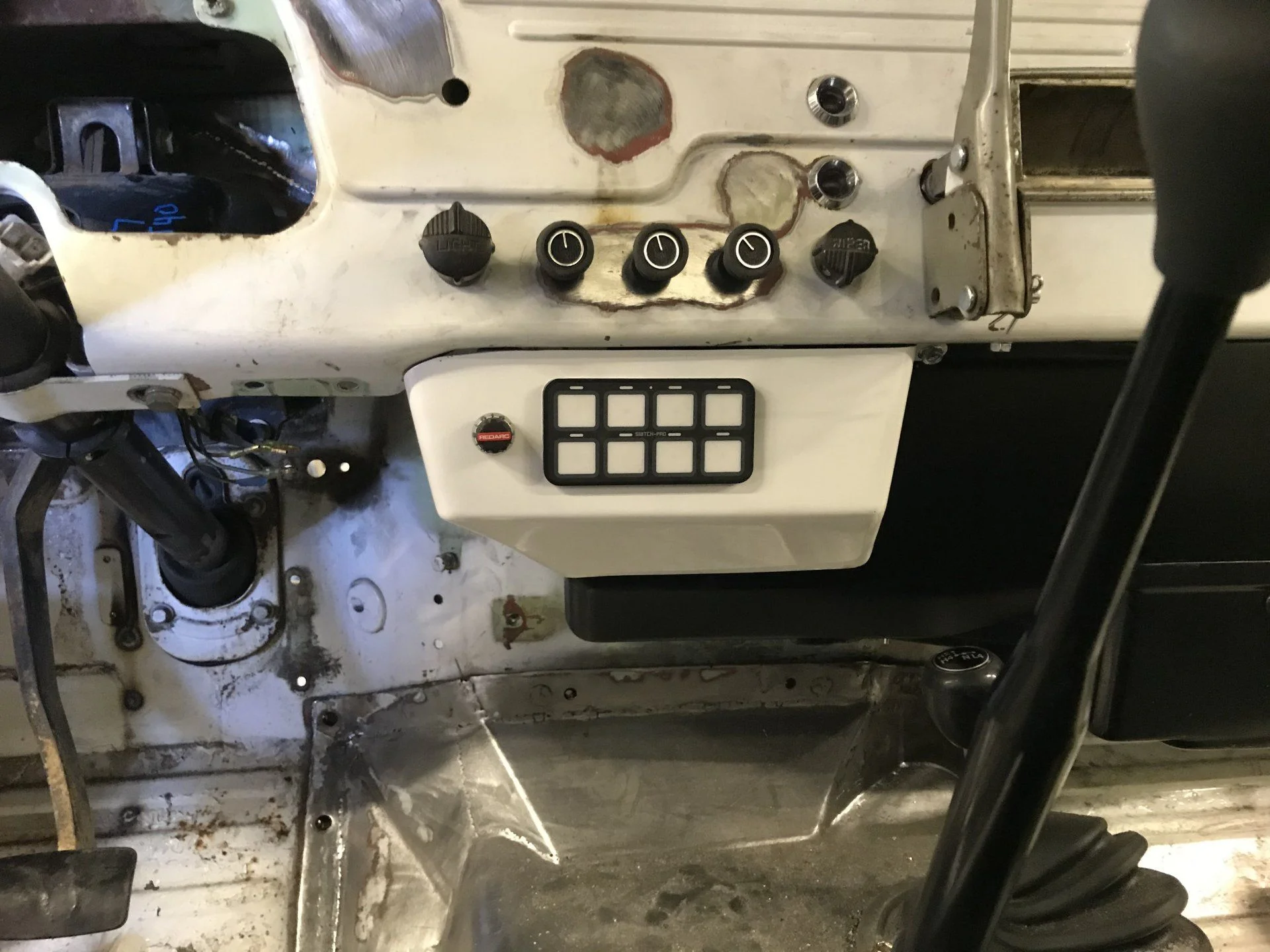

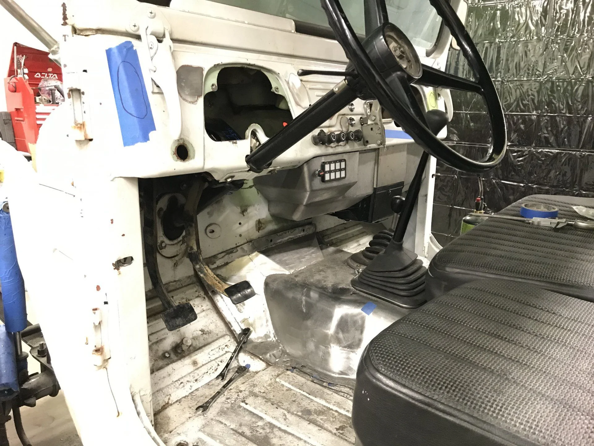

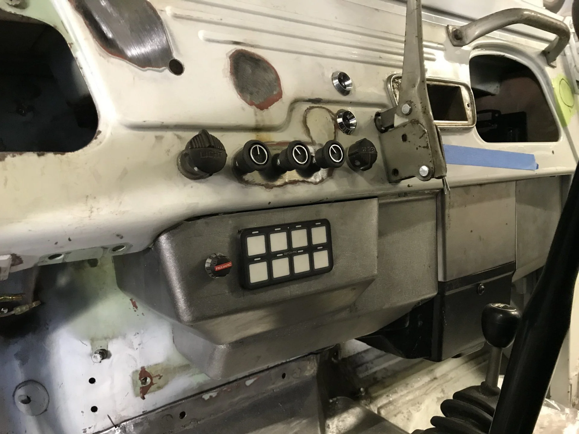

So here is our built panel.
Everything is bolt-in.
Still got to configure out vents, got something for that showing up Monday.
Cheers

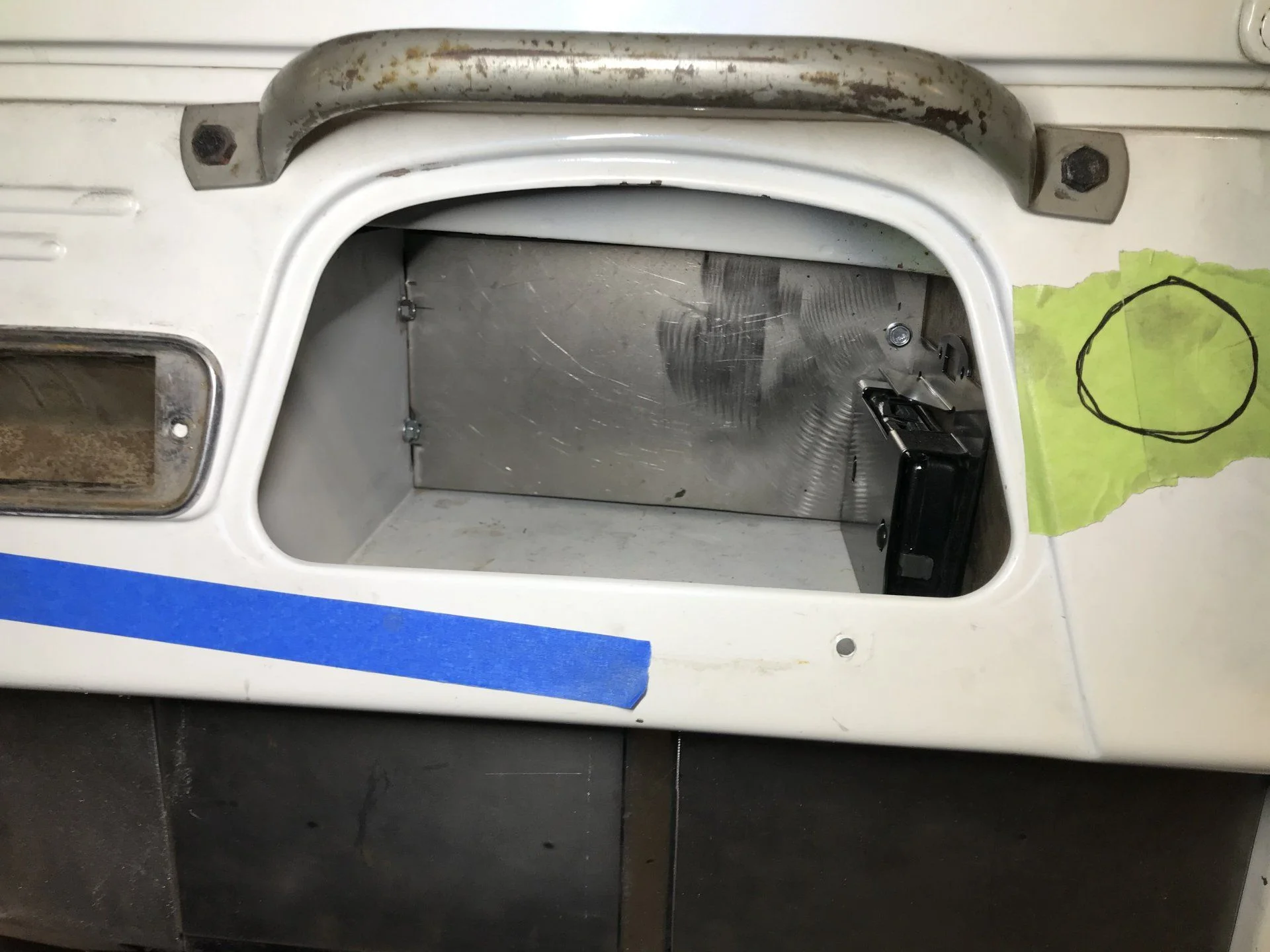

Also glove box...

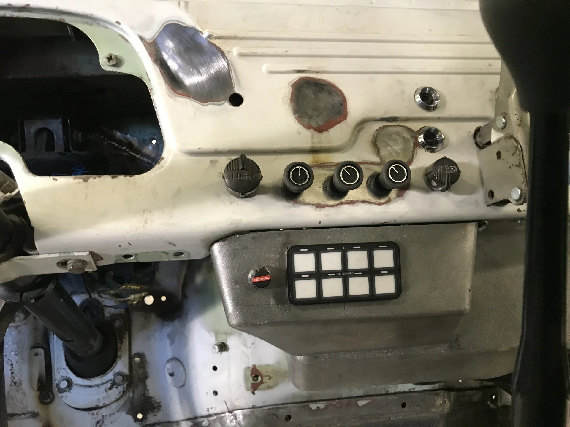

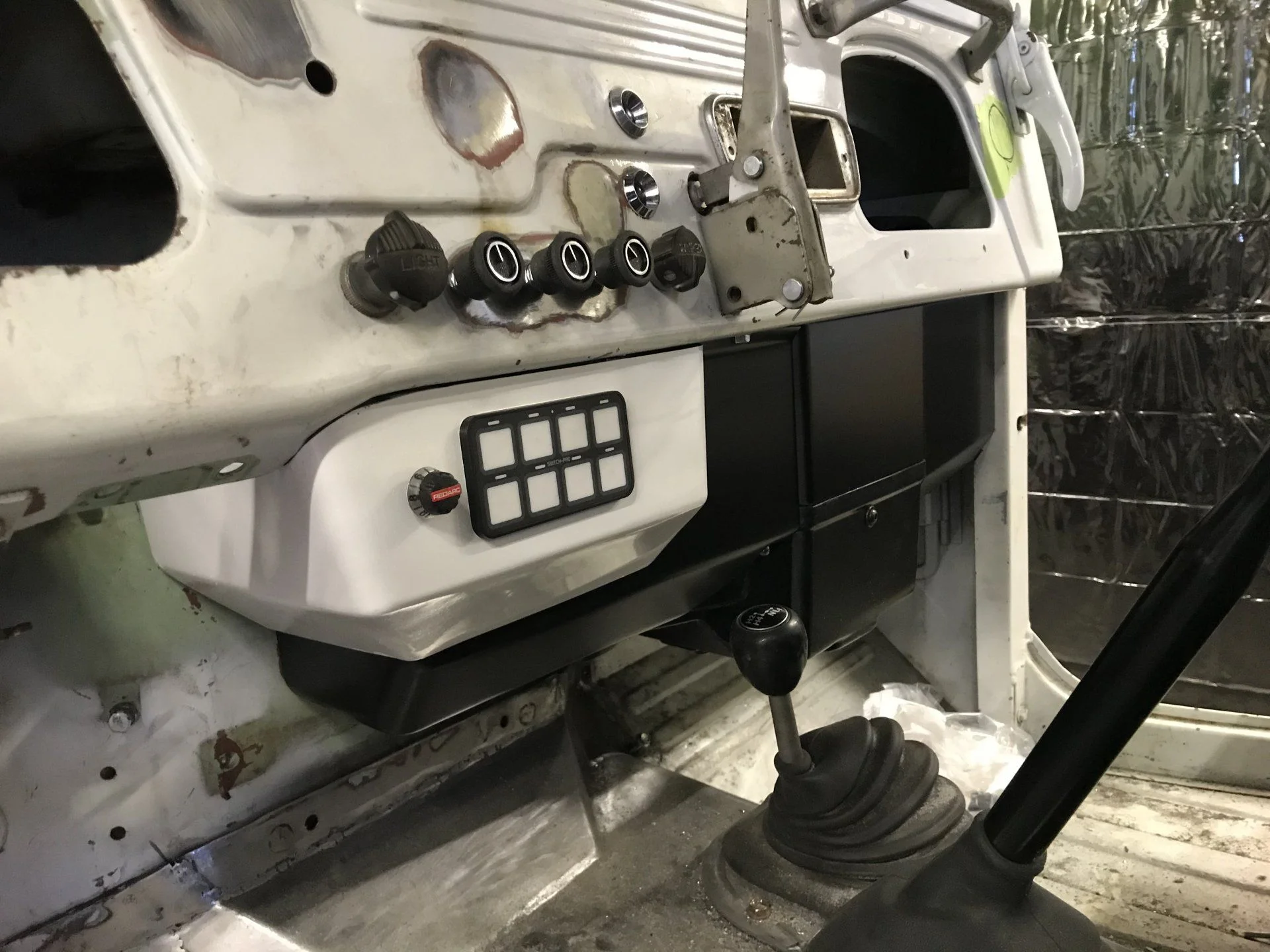

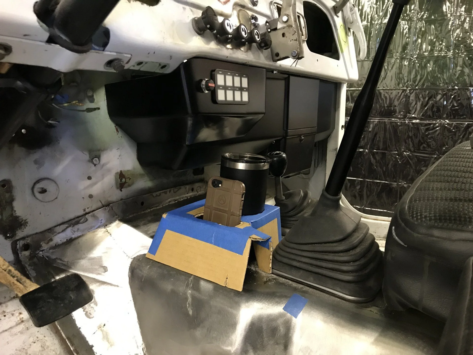

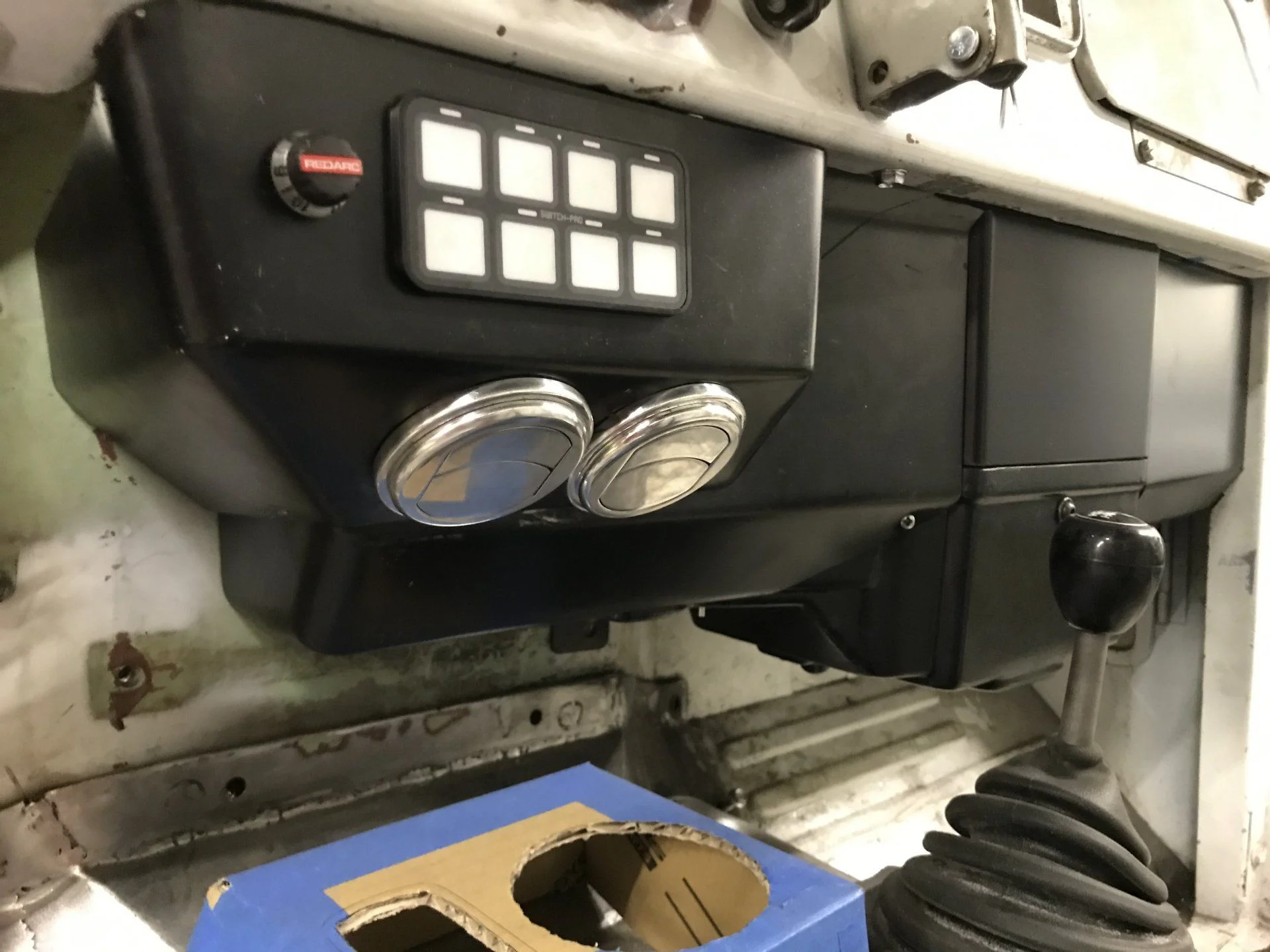

Trying some different color combos on this today.
The cardboard console is just the start of playing with ideas.
Cheers

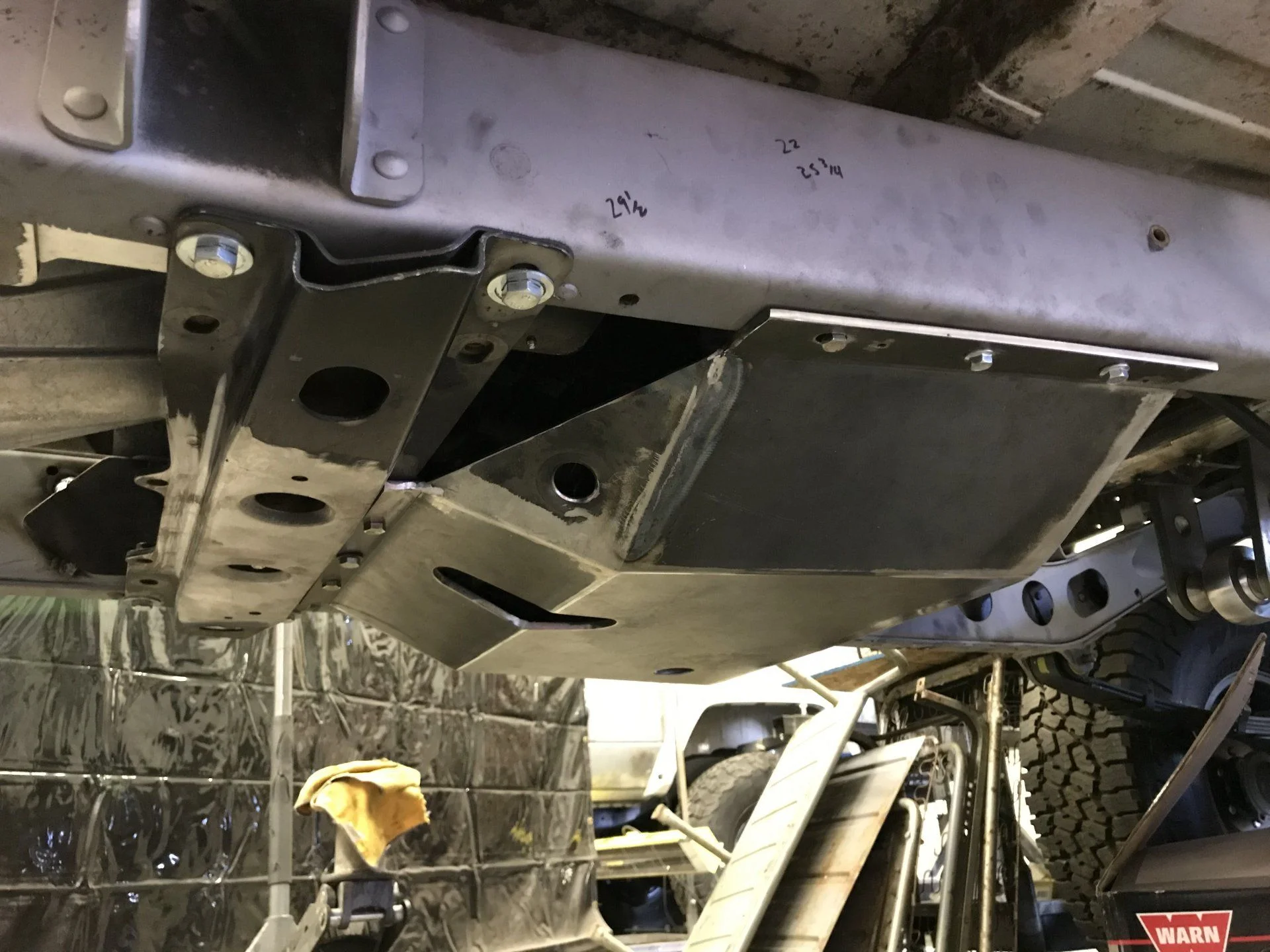

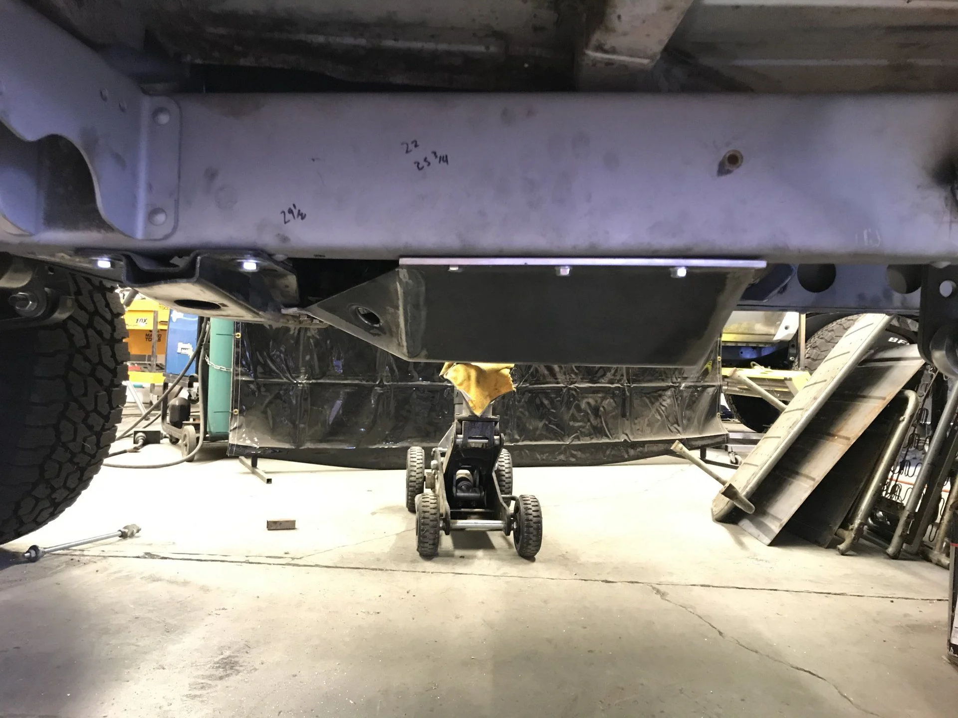

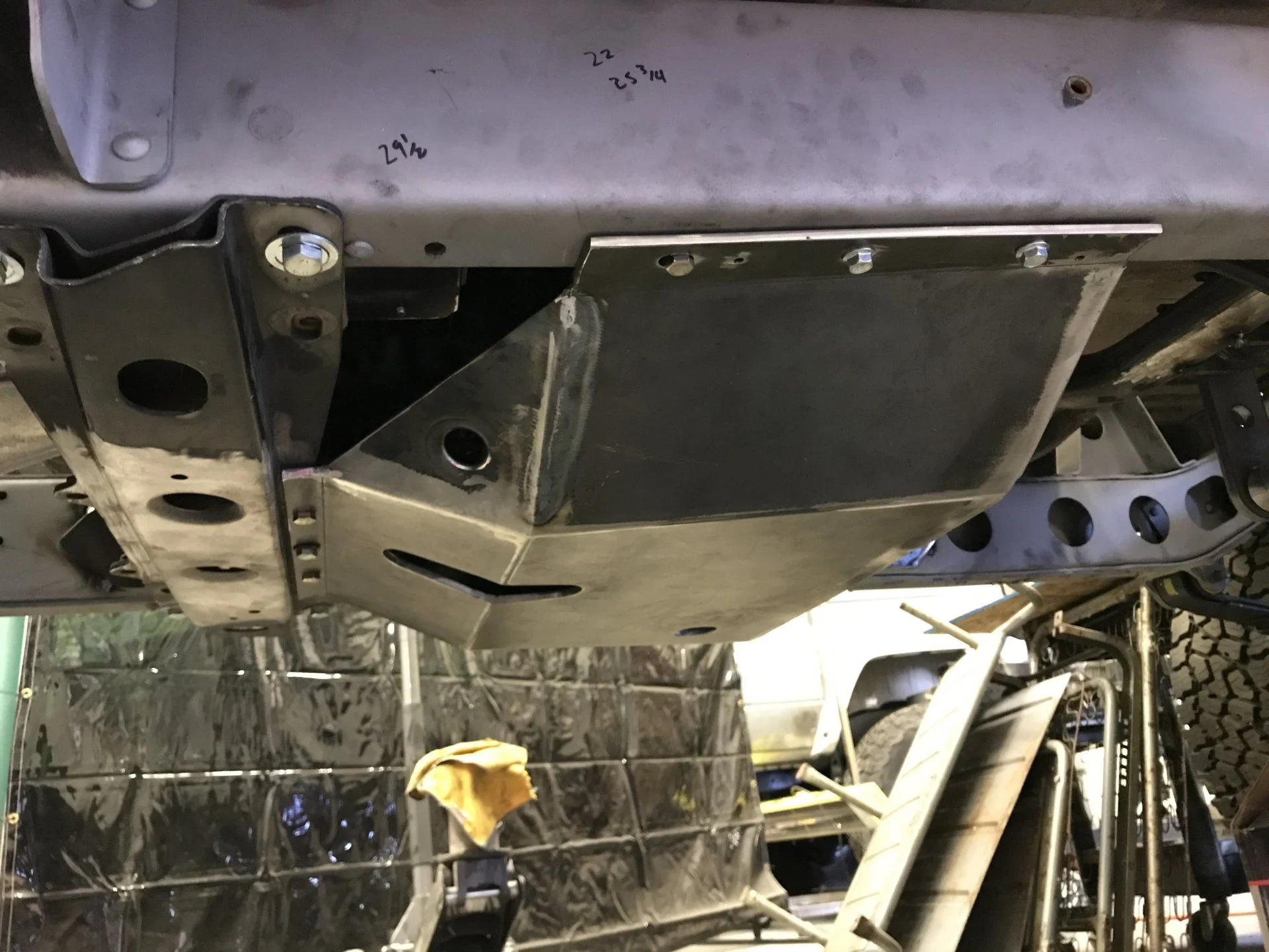

Belly skid we made, 1/4”. It will certainly take some hits but it is not meant for rock crawling, nor is the Cruiser.
Cheers

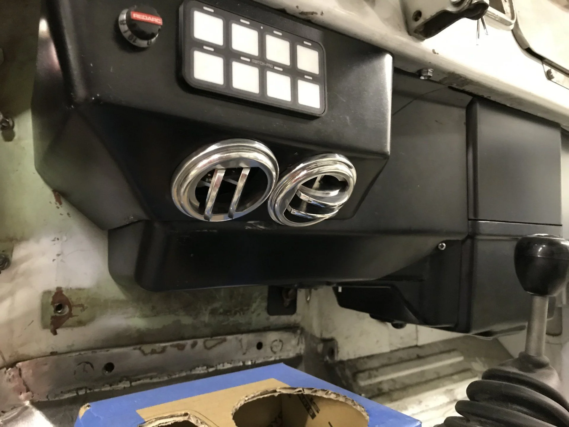

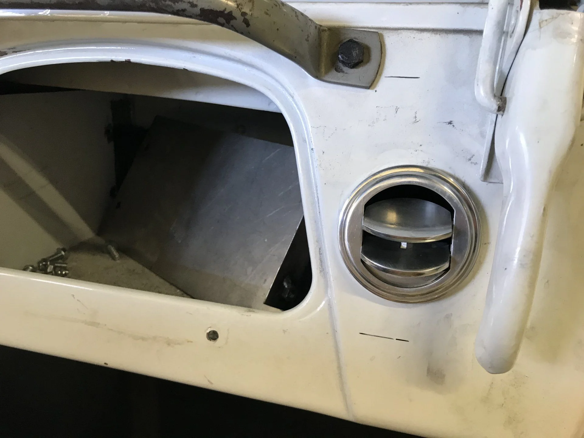

Vents in the works, these will get powder coated black.
They connect to the ducting we made behind them.
Cheers

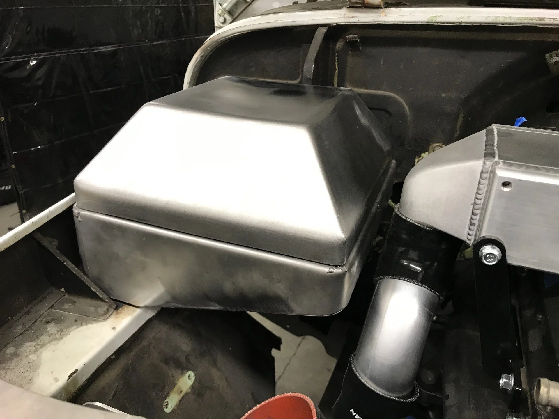

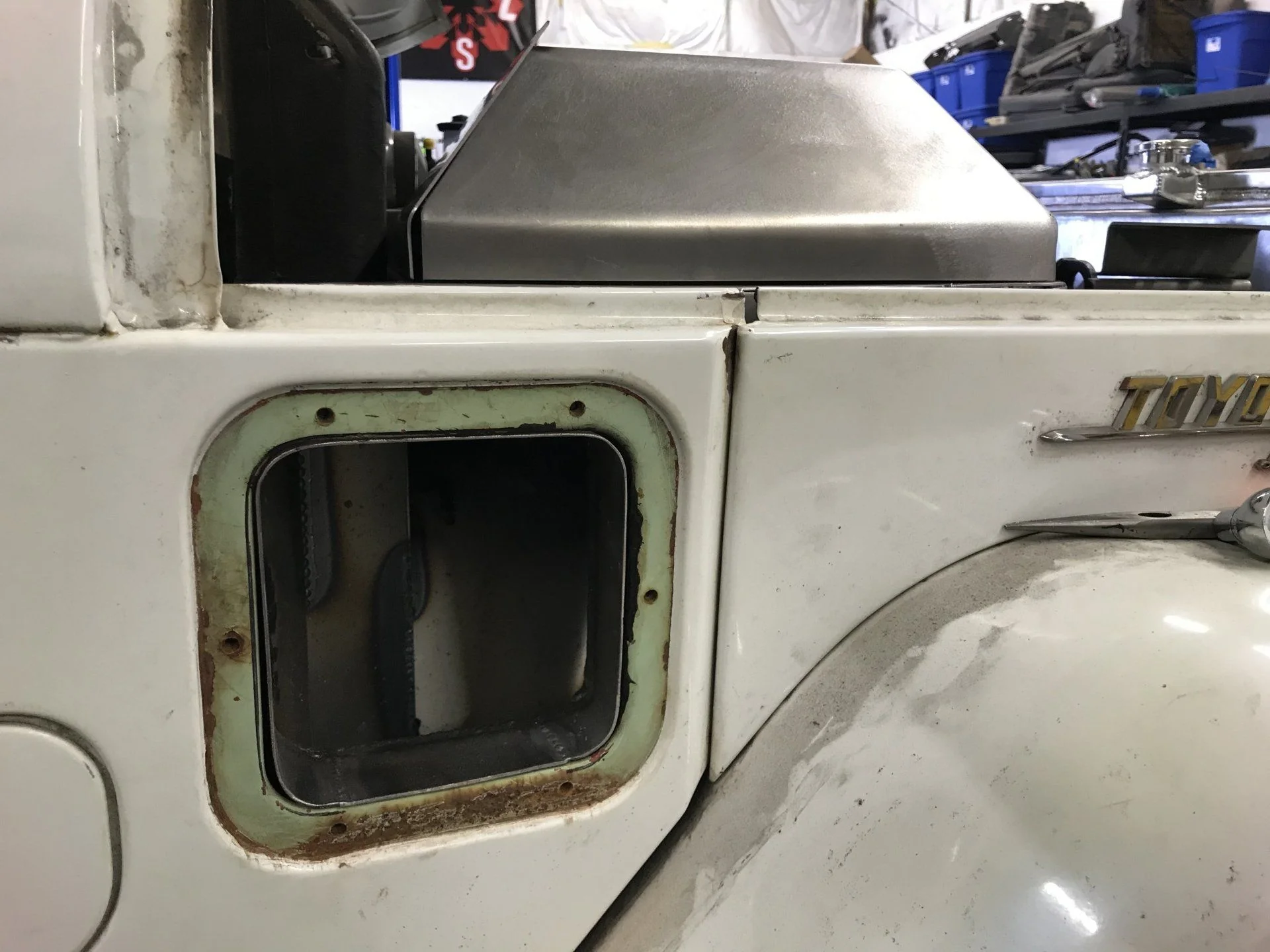

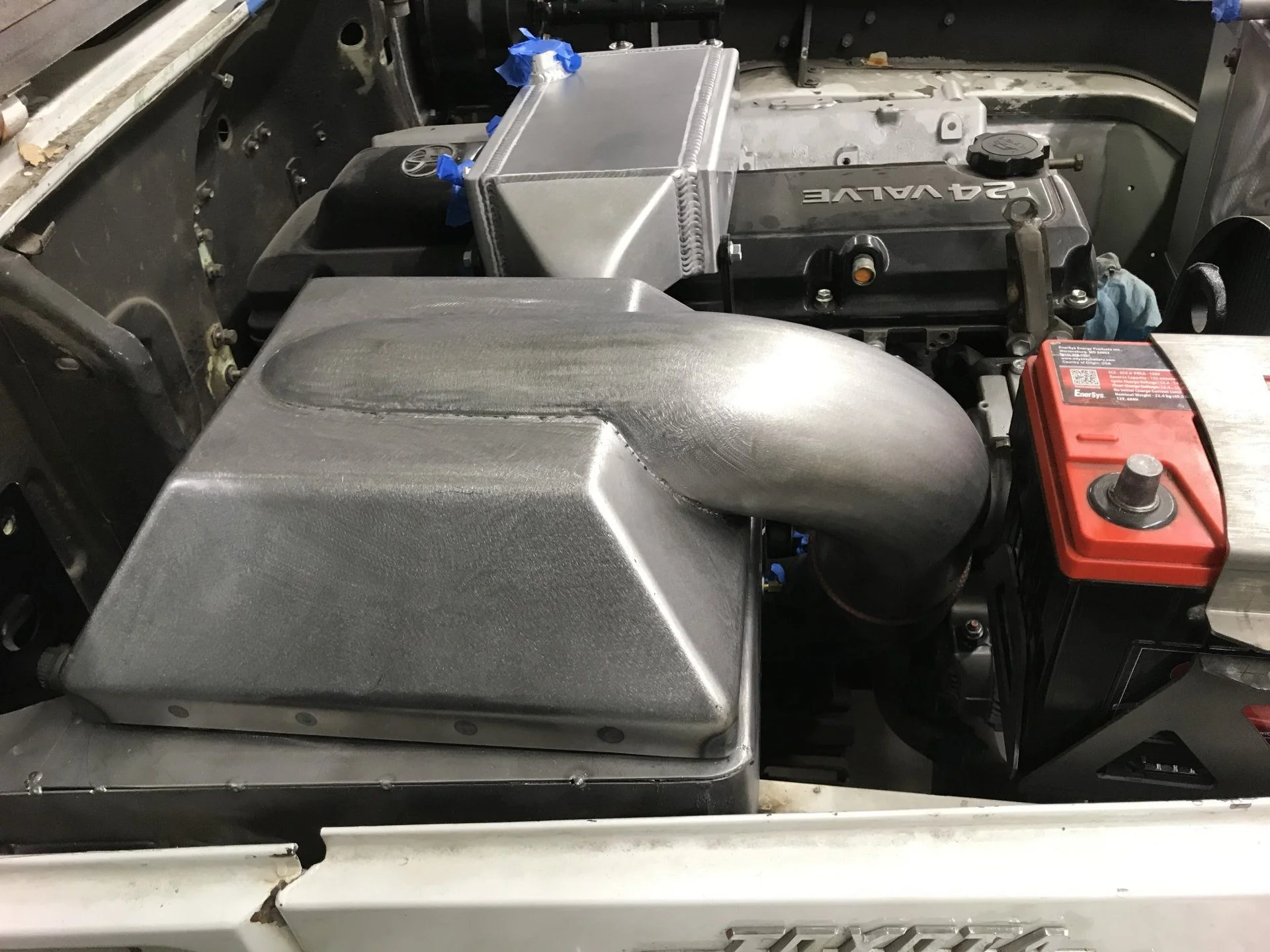

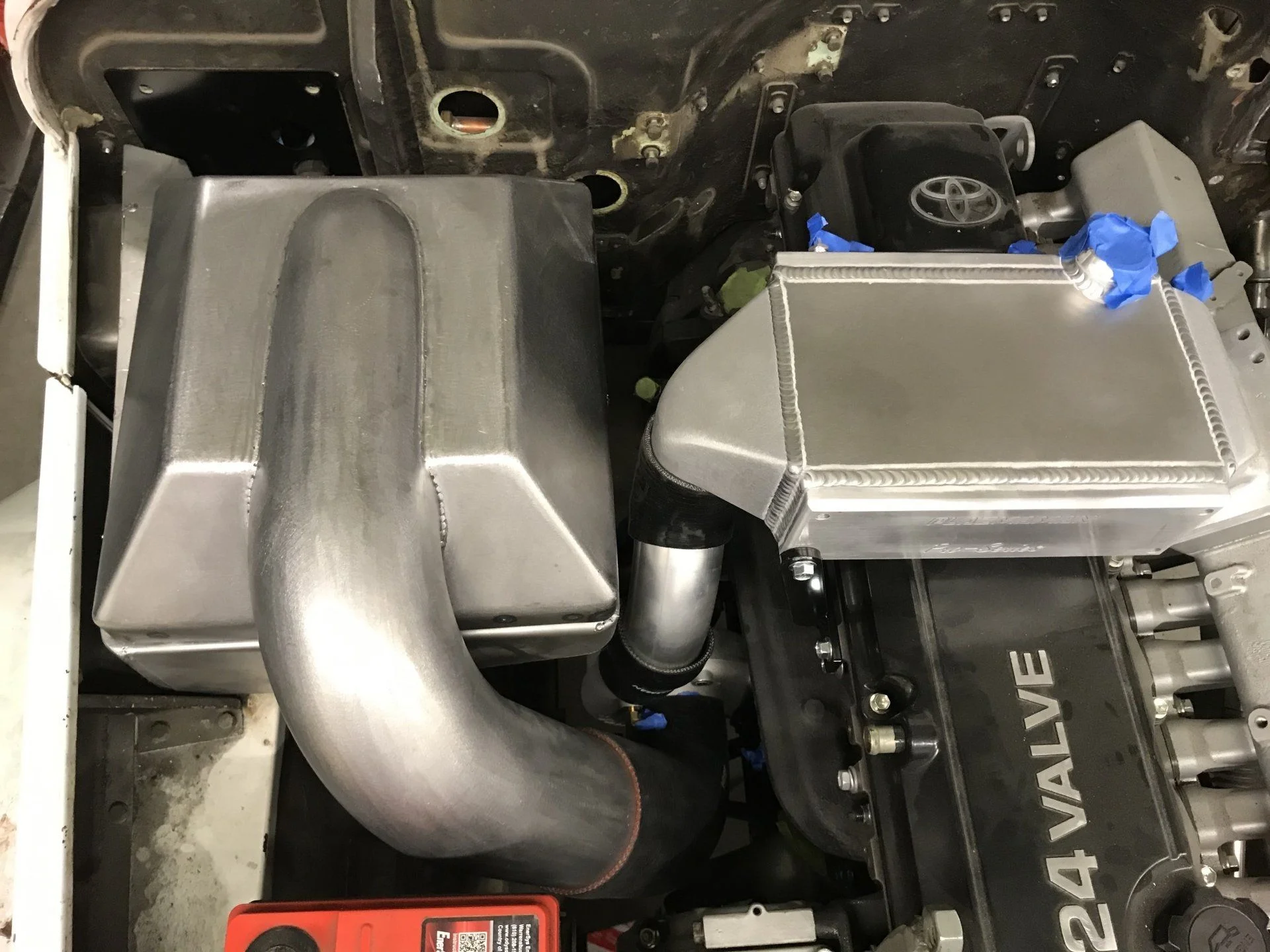

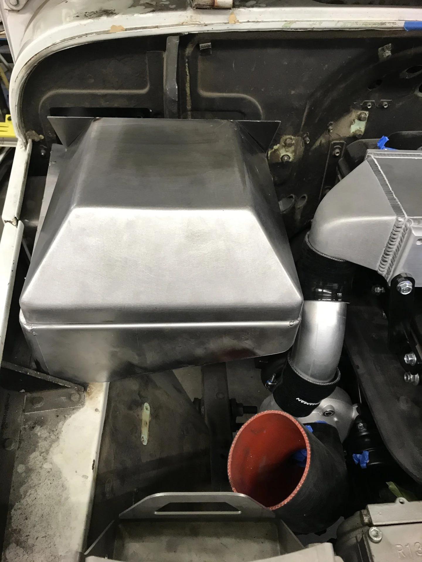

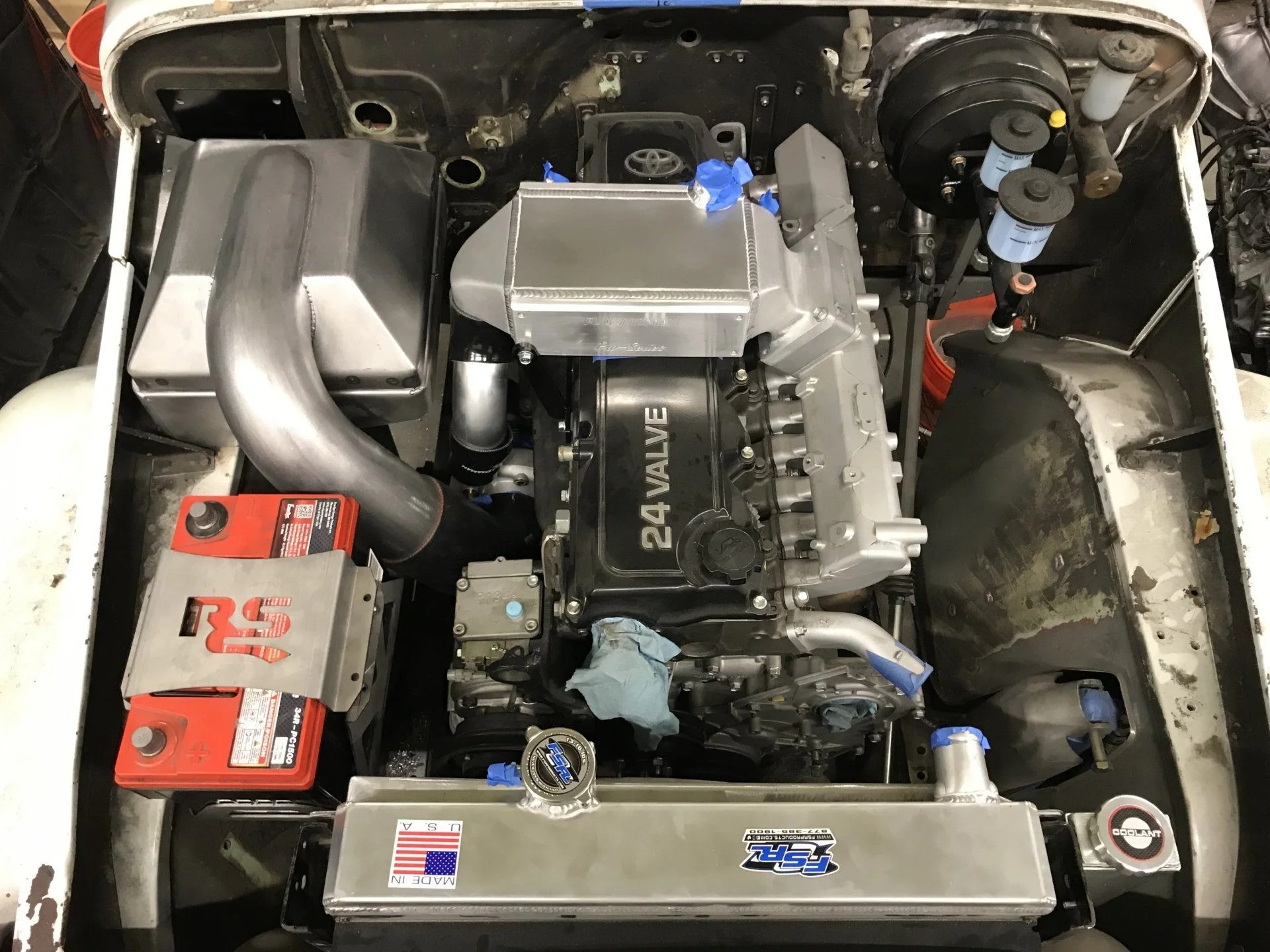

Wow that box turned out really nice. I want one! Live it!
Not 100% done. The top will be held down with latches. An aluminum heat shield will also get made for the bottom side that faces the turbo/exhaust and the whole bottom half is just tack welded right now. We are also contemplating a screen or prefilter at the vent where it pulls the air.
