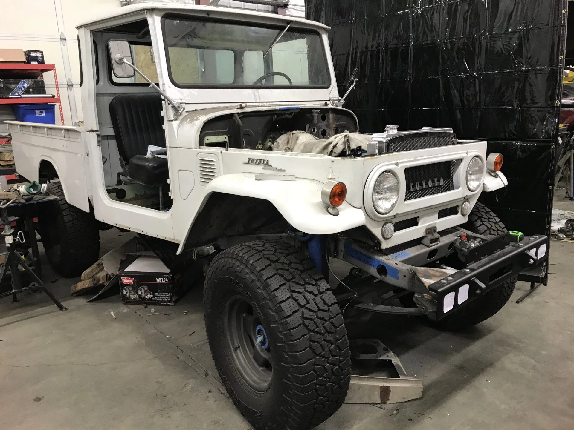

The beginnings of a rear bumper.
It is getting flush mount Baja Designs back up lights, recovery points and a tow receiver. Basic, simple, flows decent with the old school body.
The front as I am sure most of you notice is a HFS. The owner likes this simple, basic clean look as well.
Obviously we have customized the mounting of it yet kept it stock looking. Original frame horns went back on but were welded and required some coping to suit the shackle reversal. Obviously the top triangular caps we made and they are a bit bigger than stock. They are also 1/4” plate and welded on. We want this bumper to be good and stout yet retain some stockish looks and basic overall classic setup.
Front bumper is also getting some Baja Designs flush mount “ditch lights” and fog lights.
