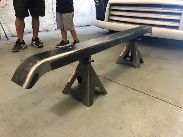

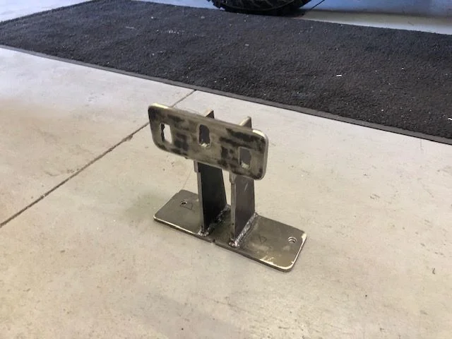

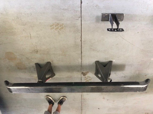

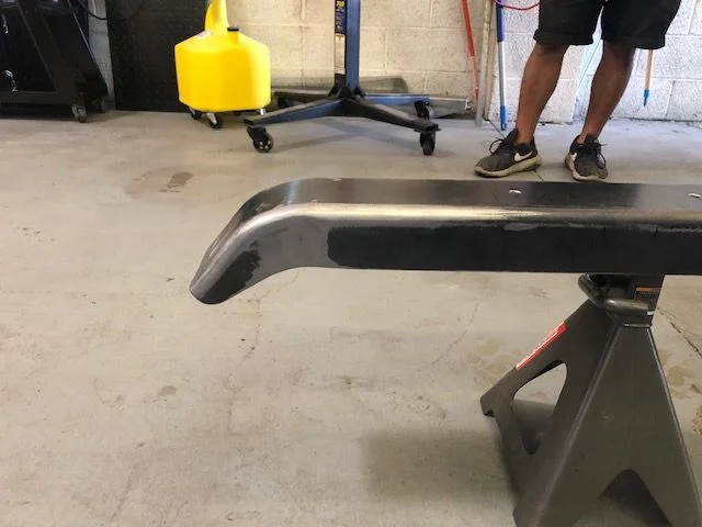

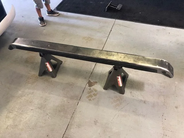

Progress looks great. How are you going to repair the Pot metal on the rear latch? JB Weld? Can't really apply heat to it. It will just melt into a pile of goop. More pictures of the rear bumper would be great.

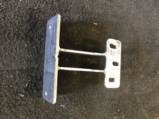

the tailgate latch we dipped in copper first and then we were able to weld it without melting. Believe me I was nervous but it worked out. We did have one spot where some material was missing so we had to fill with JB, also notice there’s a bracket on the bottom broken off so we will have to cut a small piece of flat stock into that.
Should have more bumper photos soon, it’s at powder coat now.

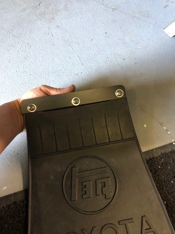

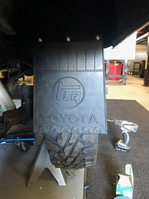

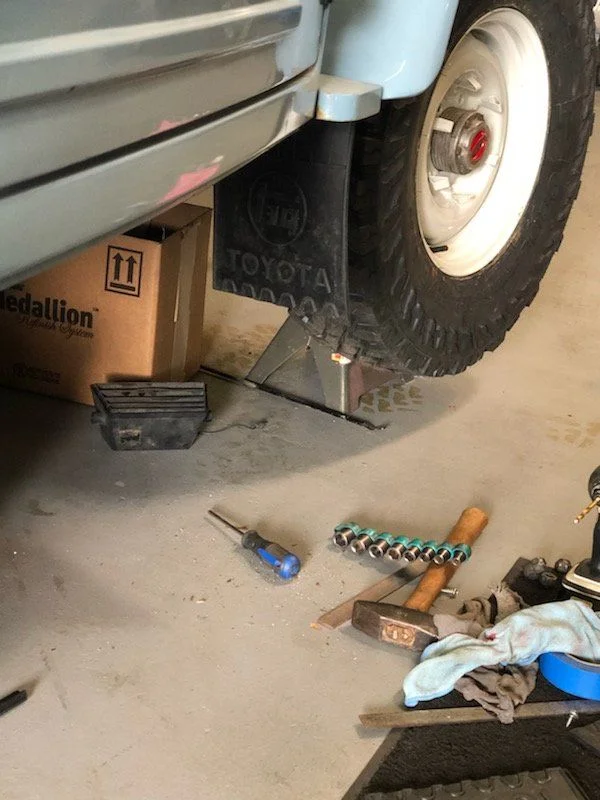

Got the mud flaps mounted up today. These ones came from eBay some guy in Indonesia I think. They’re not the GIFUs, but they look pretty good I have to say.

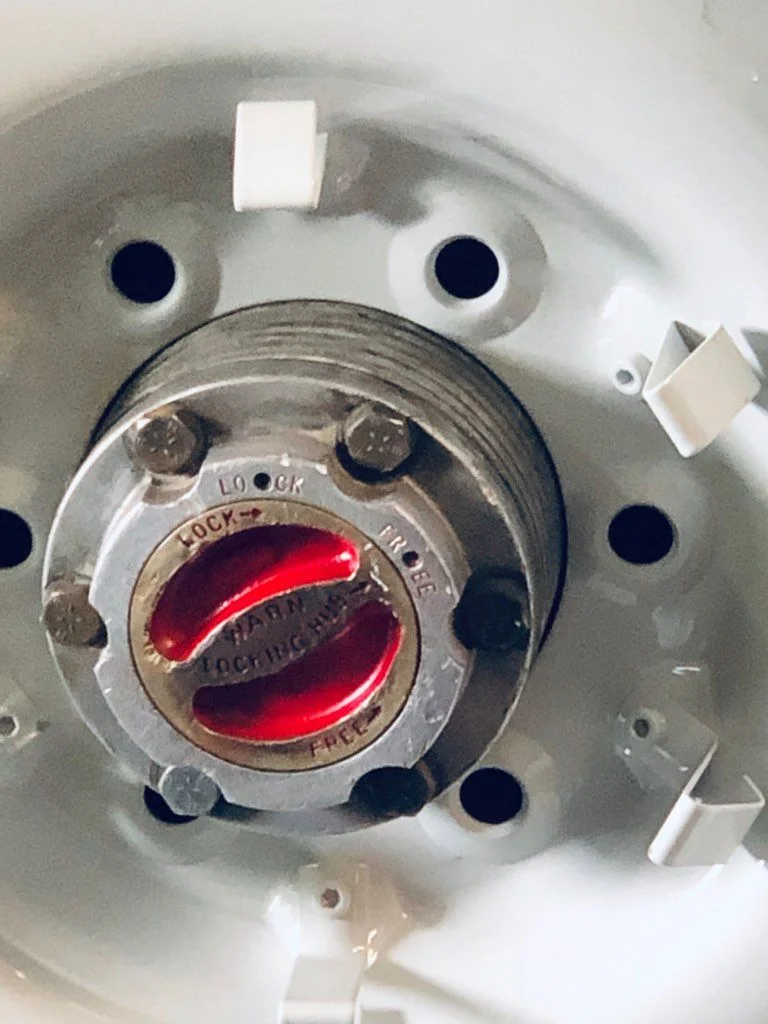

Small detail but I also painted the hubs, and note the new very light gray wheel color. I ended up wanting something lighter, and powder coated since those hub caps were just taking the spray paint off. Bad picture inside that makes it look more off-white than gray but it looks really good outside.

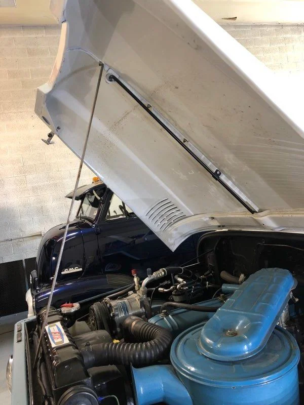

I need to take a better picture but here’s us working on the hood prop. I still had the little circular mount, and located a 40 series prop but was missing the little J-clip that mounted to the center seam to keep it tucked out of the way. We made one and just riveted it to the seam. The prop that’s actually holding it up in the photo is just a temporary one to keep the hood open while we mounted it, the real one is “parked” on that center seam.

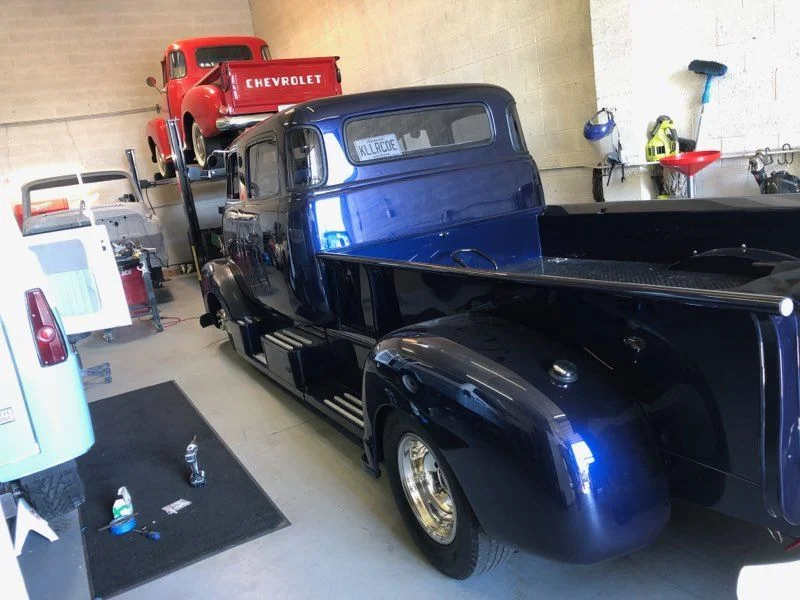

That is a VERY nice rig! It looks like your buddy has a thing for old chevy trucks. I have a good friend building a 58' Chevy coe Duramax long bed.
