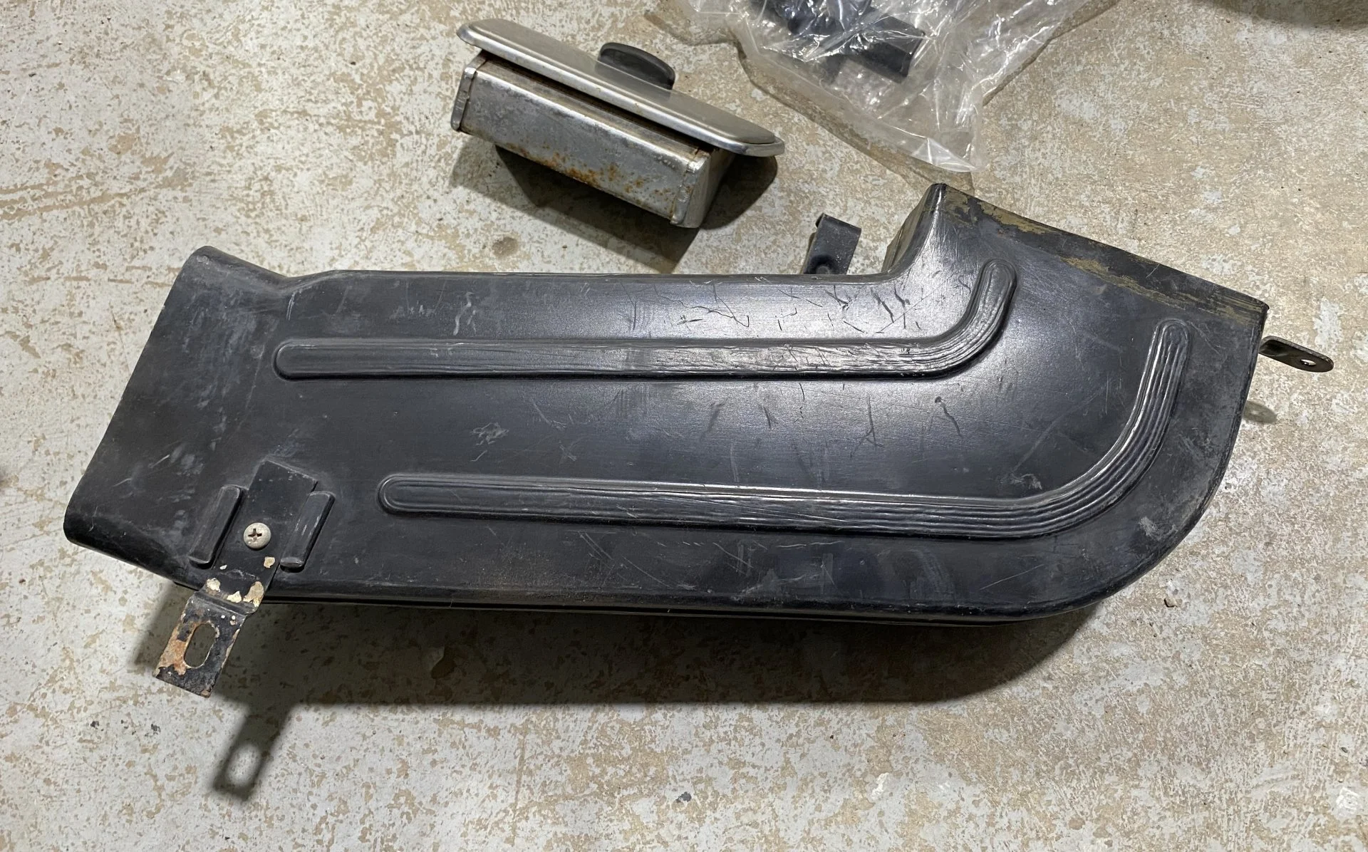

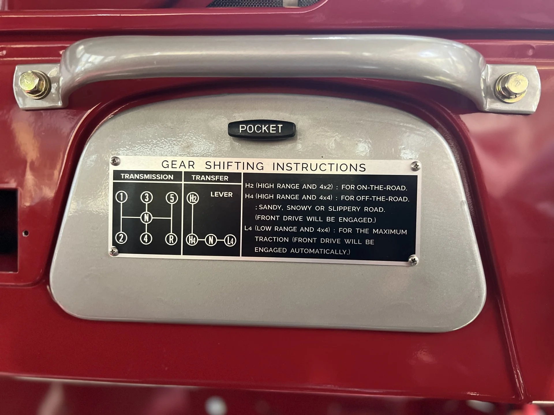

Got the glove box door upgraded for future driveline enhancements and finished up the Dakota wiring. No final pics of that because the wires look like Medusa because I have not permanently mounted it. This time I’m putting it on the upper driver cowl.
This truck is a dream to work on. It has a brand new wiring harness that I assume @ClemsonCruiser built. So nice.

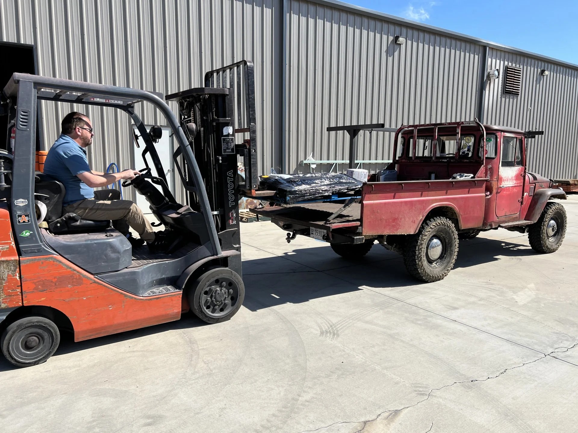

I’ve not been sleeping on Seminole. After the initial flurry of activity I settled in and started ordering parts.
Lots of stuff showing up.

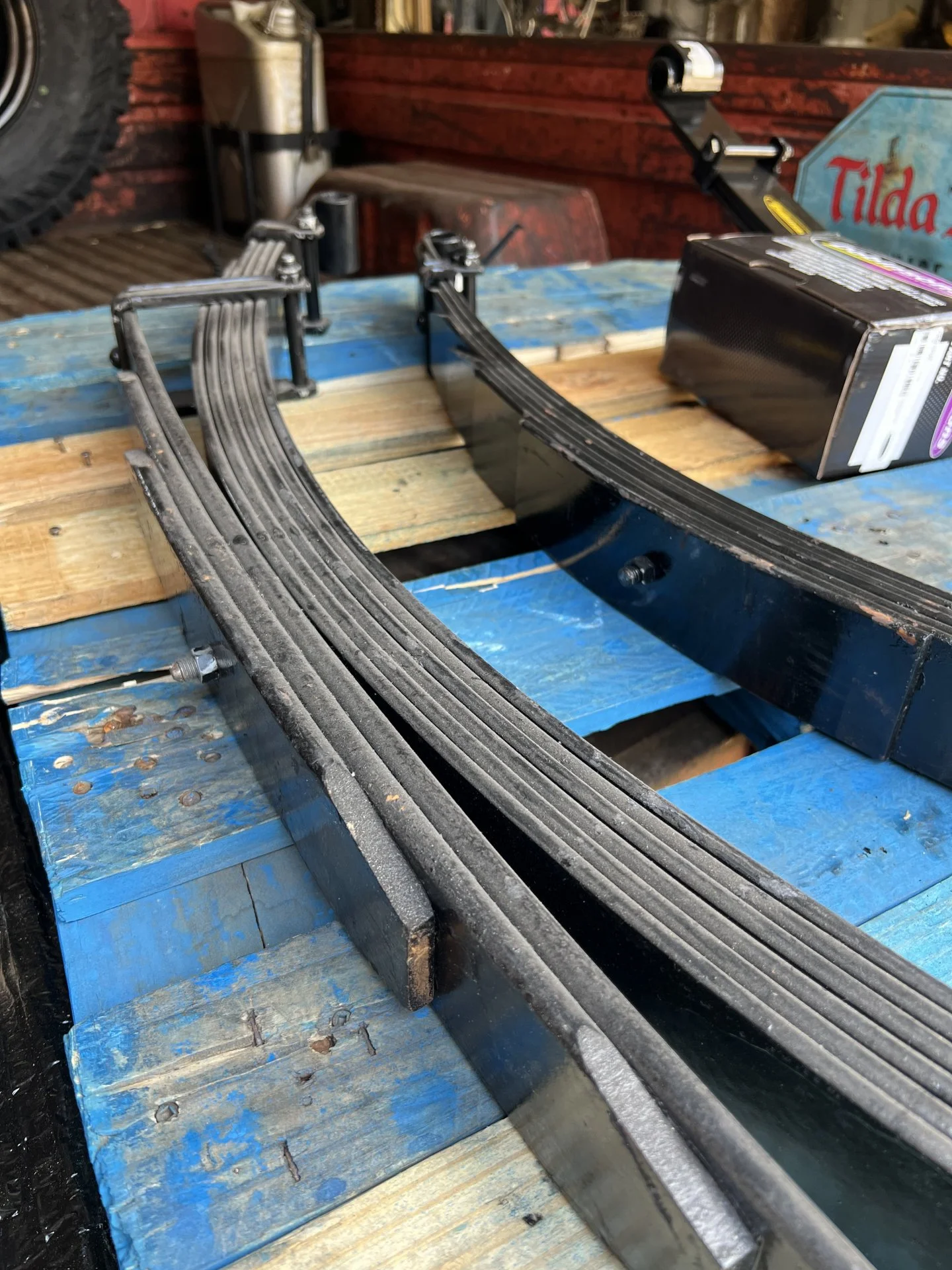

Ran down to Powder Keg to grab the Dobinsons springs I purchased via Ozark Overland Outfitters @Ozark cruiser …..
So I am looking at this set of springs I got.
Back in the summer I added this kit to a 45 LPB and kept the entire rear spring pack in the truck. Here is the stance.
I know John is not planning to use this truck as a work truck so I’m considering removing all 3 overload springs which would basically make them the same spring pack as an FJ40 Dobinsons pack. Also think I’ll drill the spring perch and move the axle back 1” to center it in the well a bit better.

I don’t think you want to drive this truck around with a set of one-ton springs in the back for the majority of its use.
