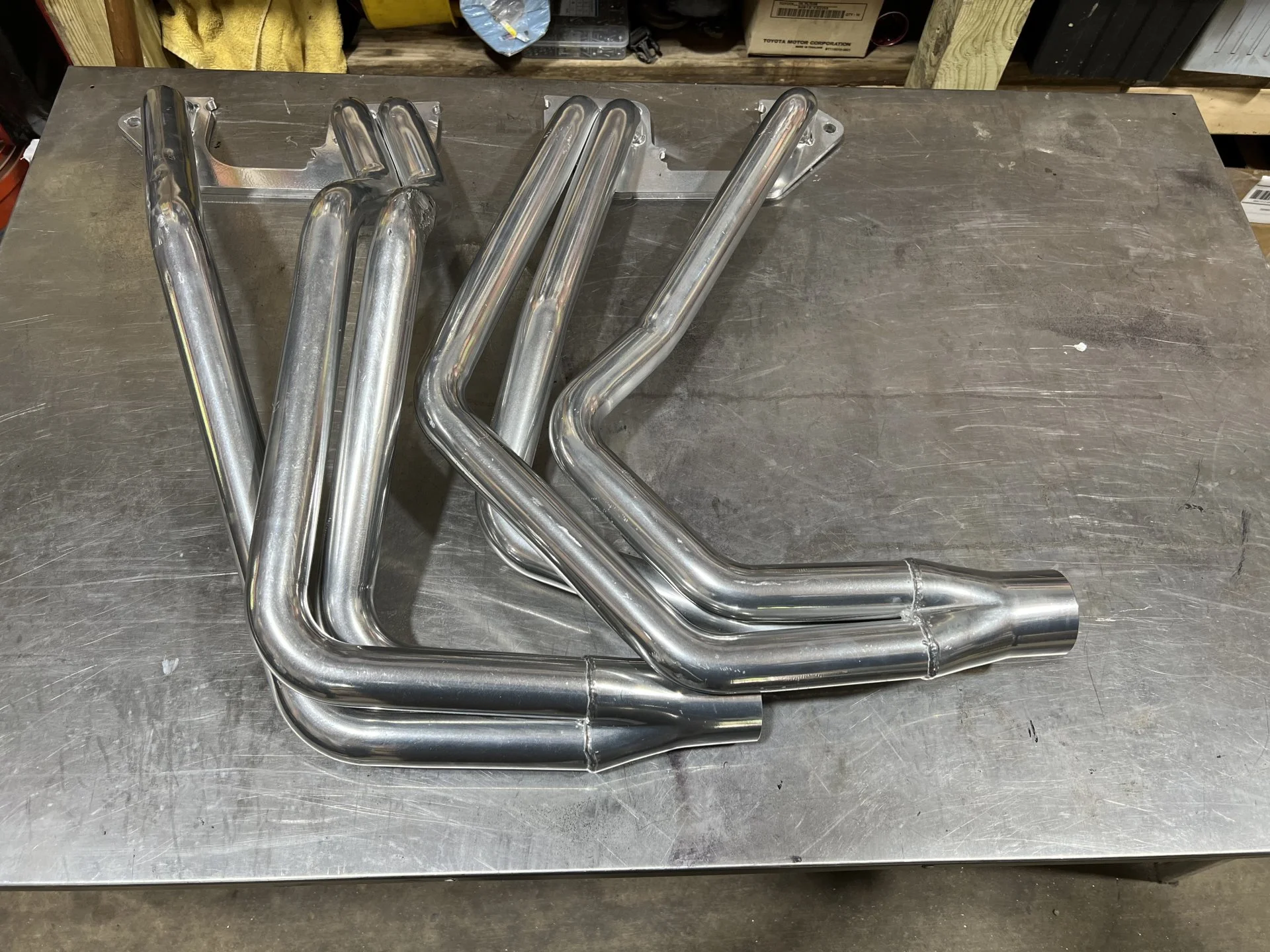

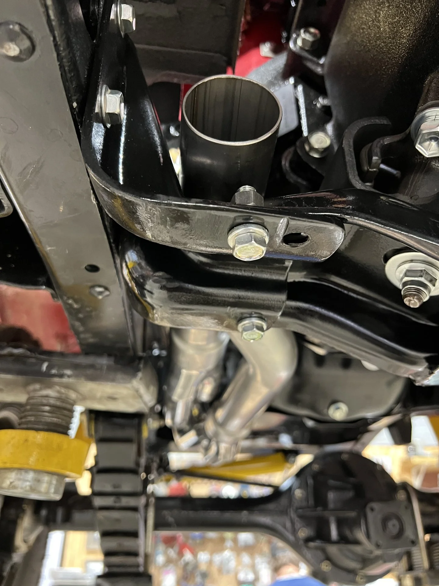

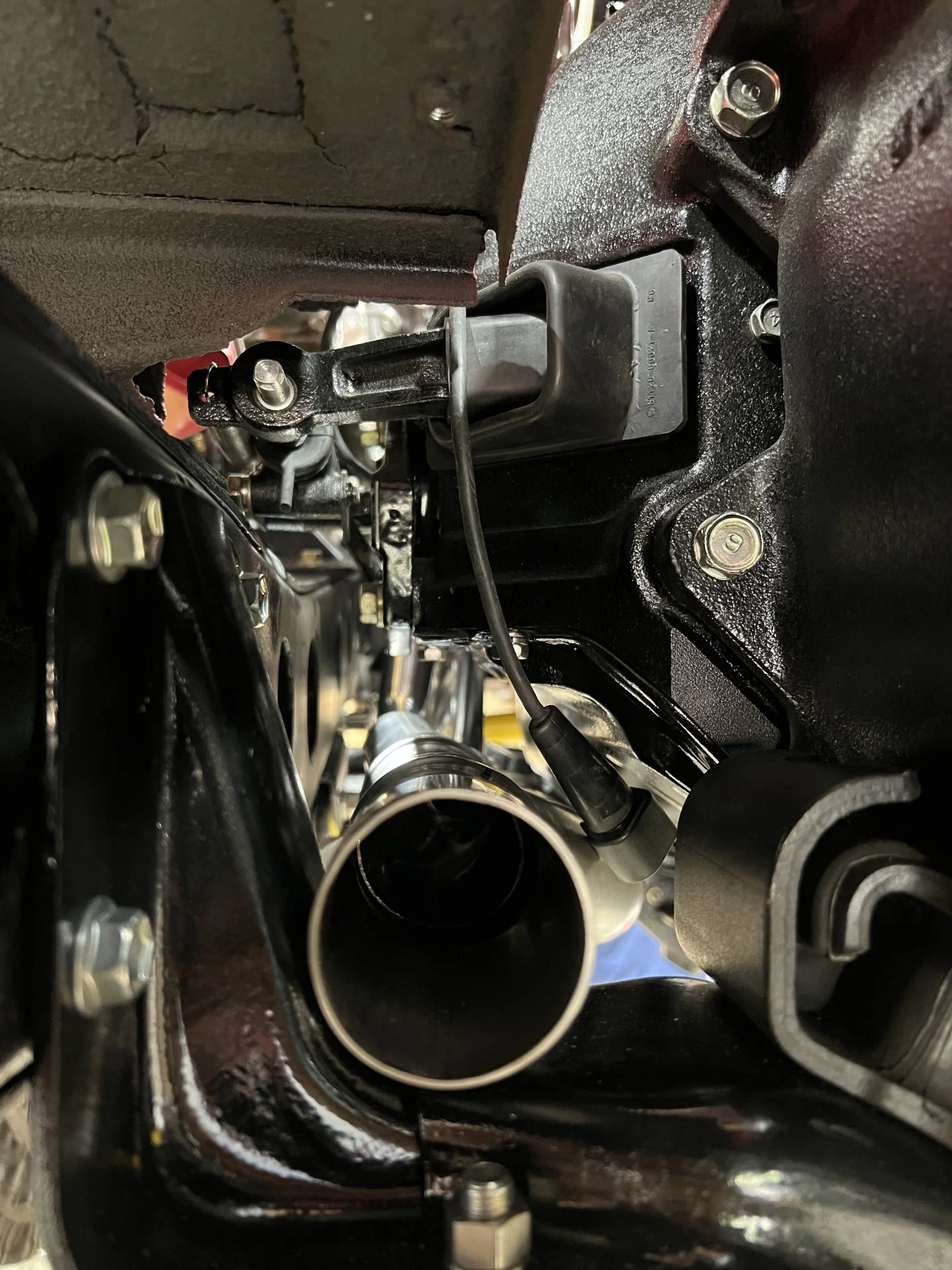

Yanked the header back off. The Tig Wizard did not like how close the #3 tube was to the Mini truck box so he’s going to properly clearance it. I ground the bolt down a bit. Also the tubes of the headers will be shortened a bit so we can modify the Y pipe for our use.

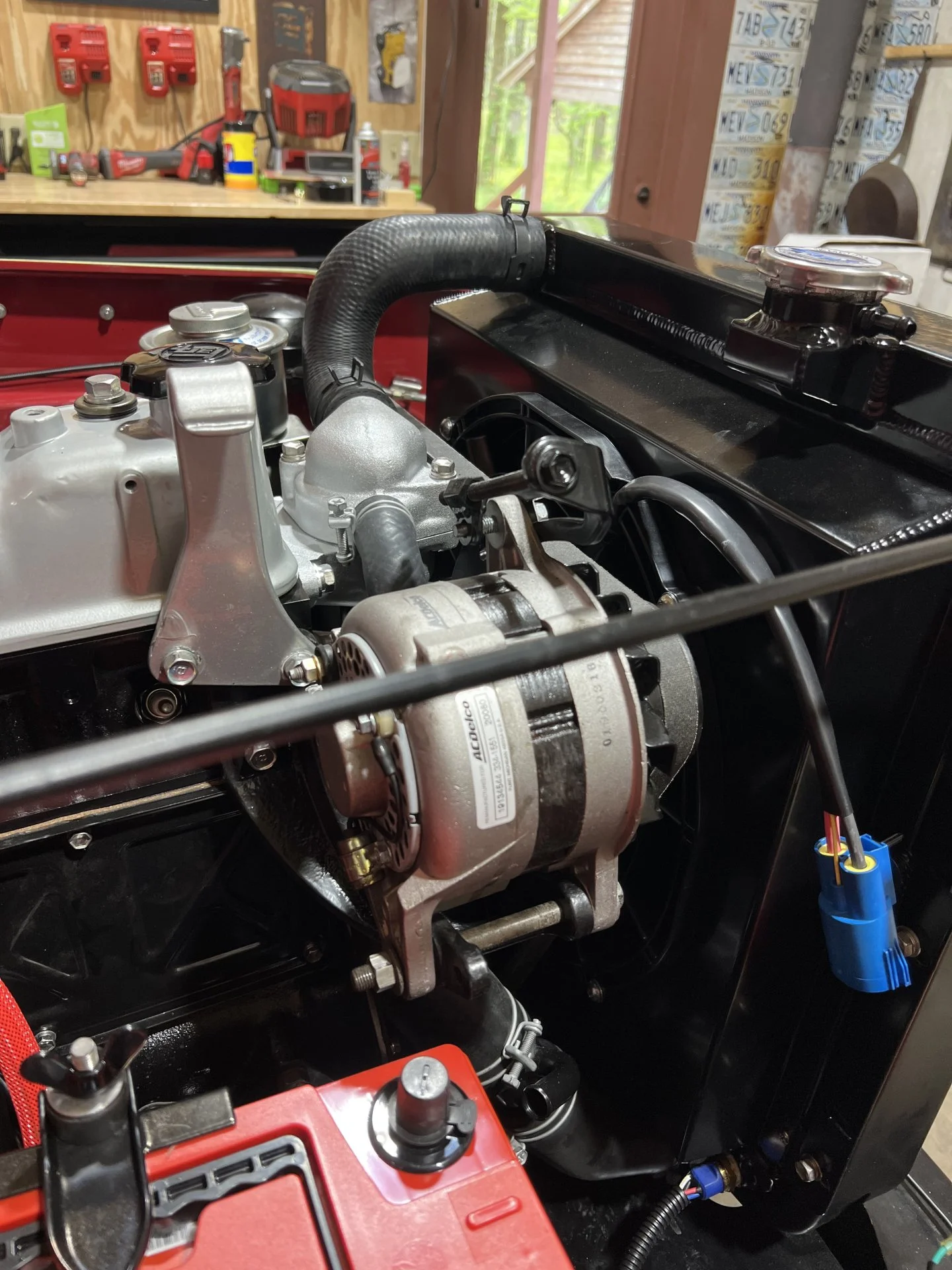

I then got all of the radiator hoses and clamps and bands installed with Toyota hoses. I don’t have enough 5/8” hose to get the system filled yet

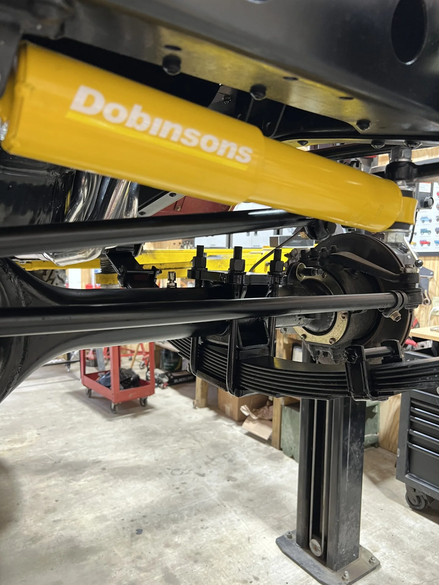

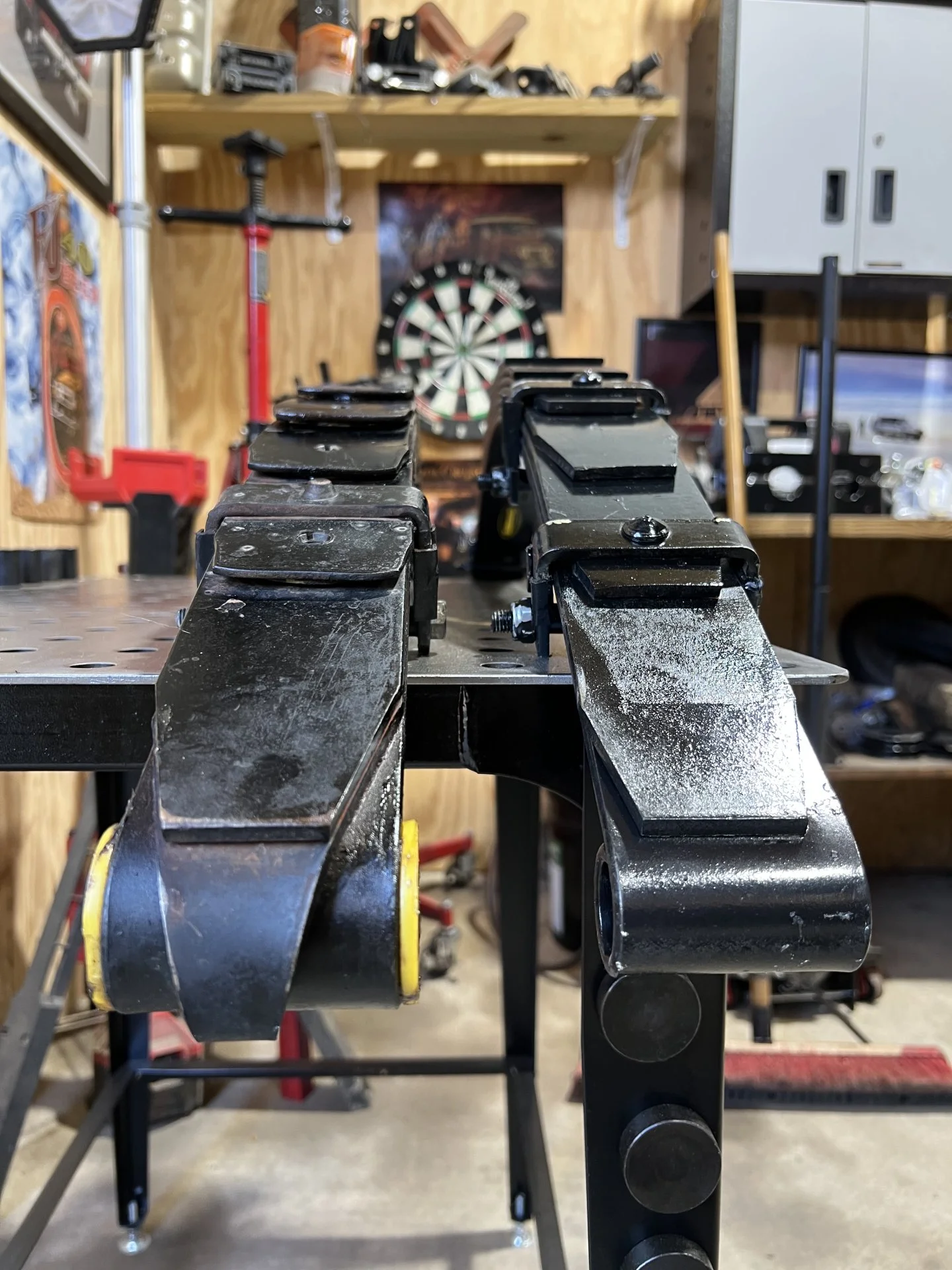

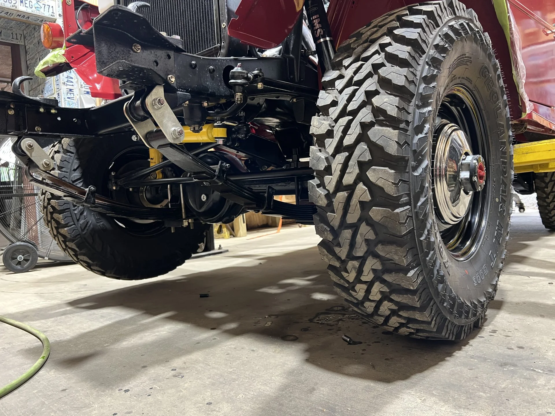

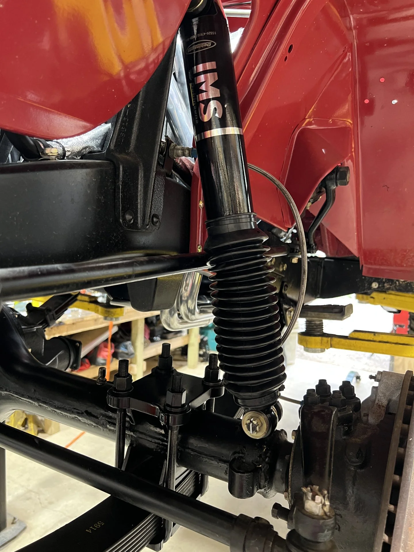

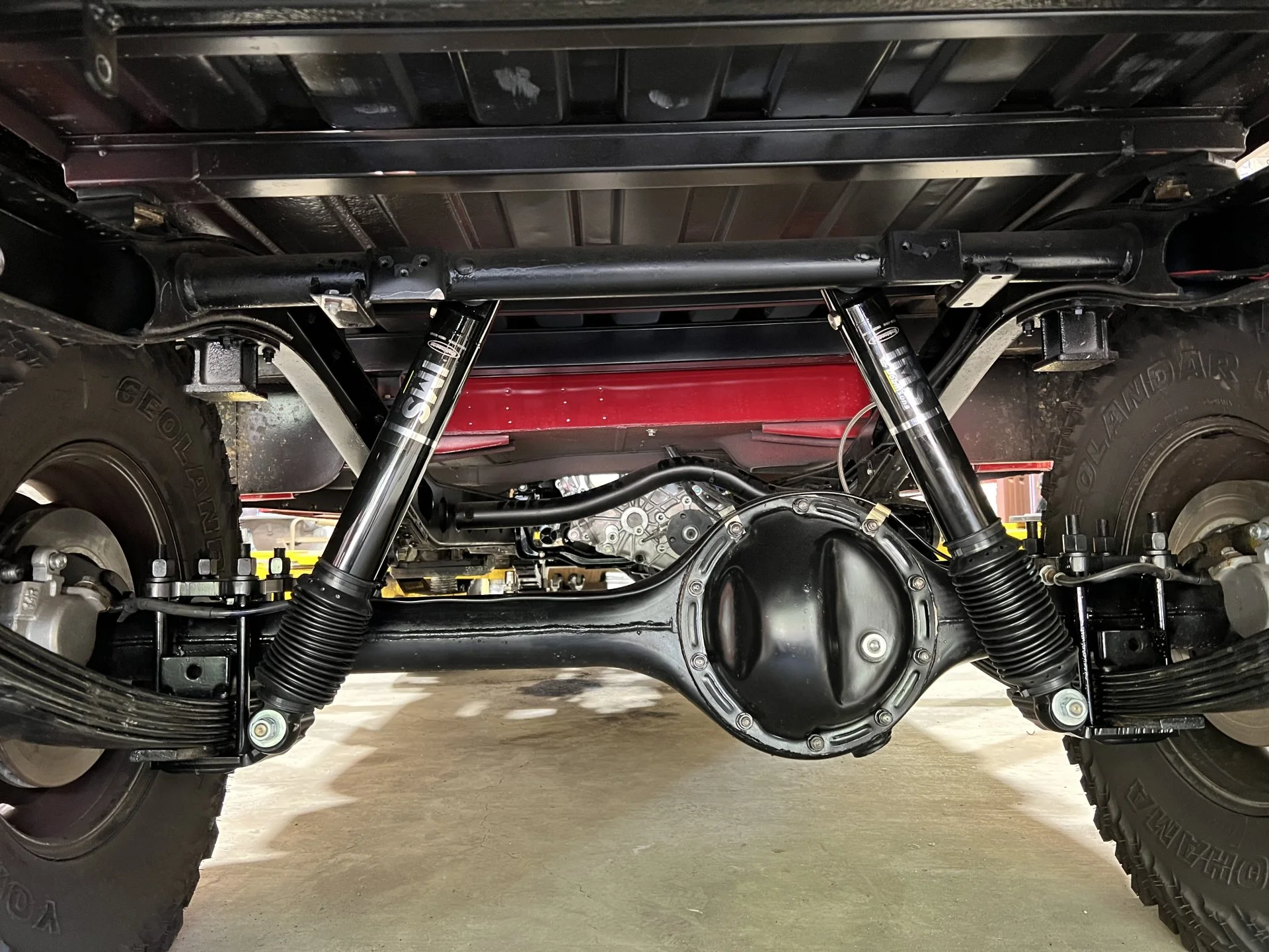

Dobinsons IMS setup going in today. I went with 2 overload springs gone.

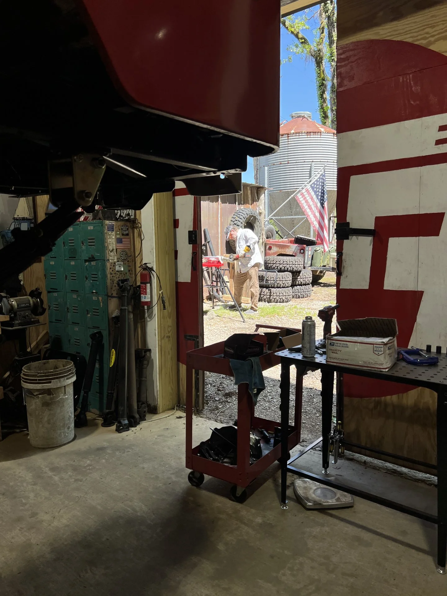

And the power is out at the Wizard’s house so he showed up and is starting in on Header and Y pipe modifications
I got the rear buttoned up until the Wizard got the headers trimmed and polished and then the Y pipe trimmed and polished then I had to stop doing suspension stuff for exhaust apprentice stuff.
Trimmed headers
Y Pipe pre trim
Y pipe in place
Dobinsons driver . OME passenger.
IMS is a worthy upgrade all day
Love me some @lcwizard flip kits
A little side by side. Dobinsons. More arch. Thinner springs. I personally think they are way softer than OME

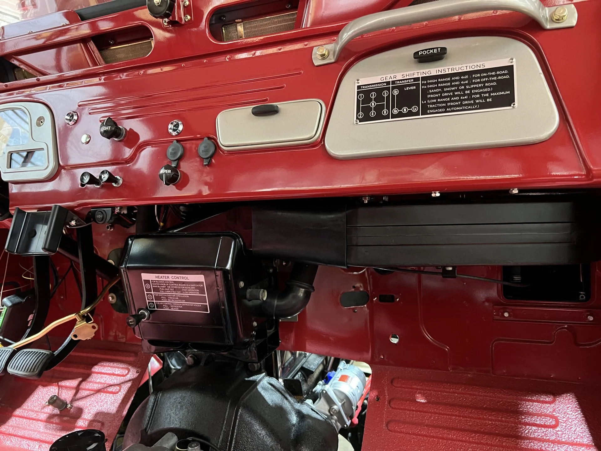

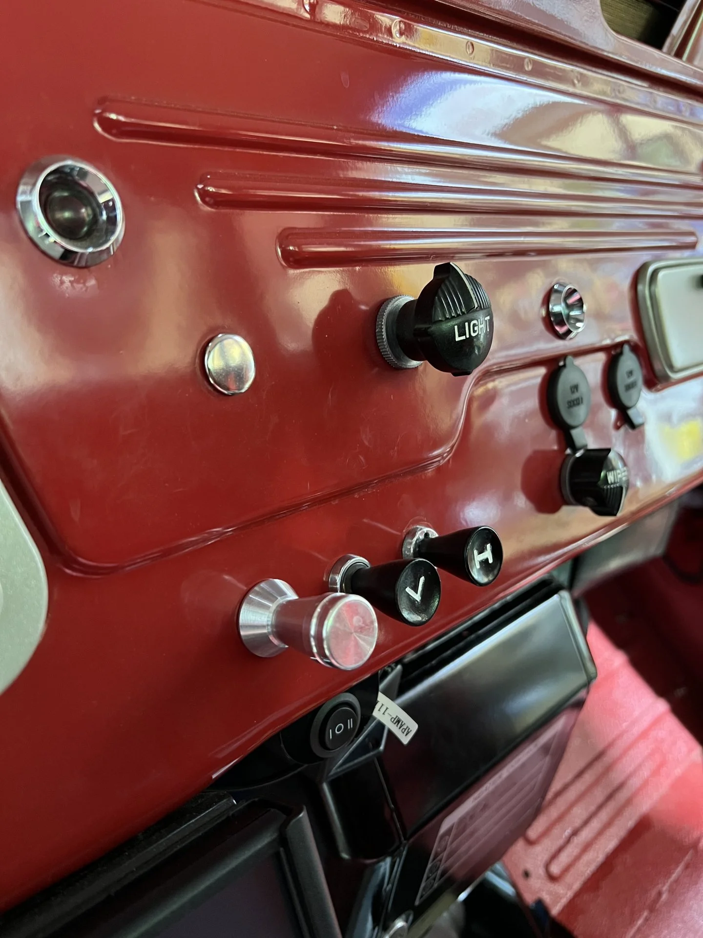

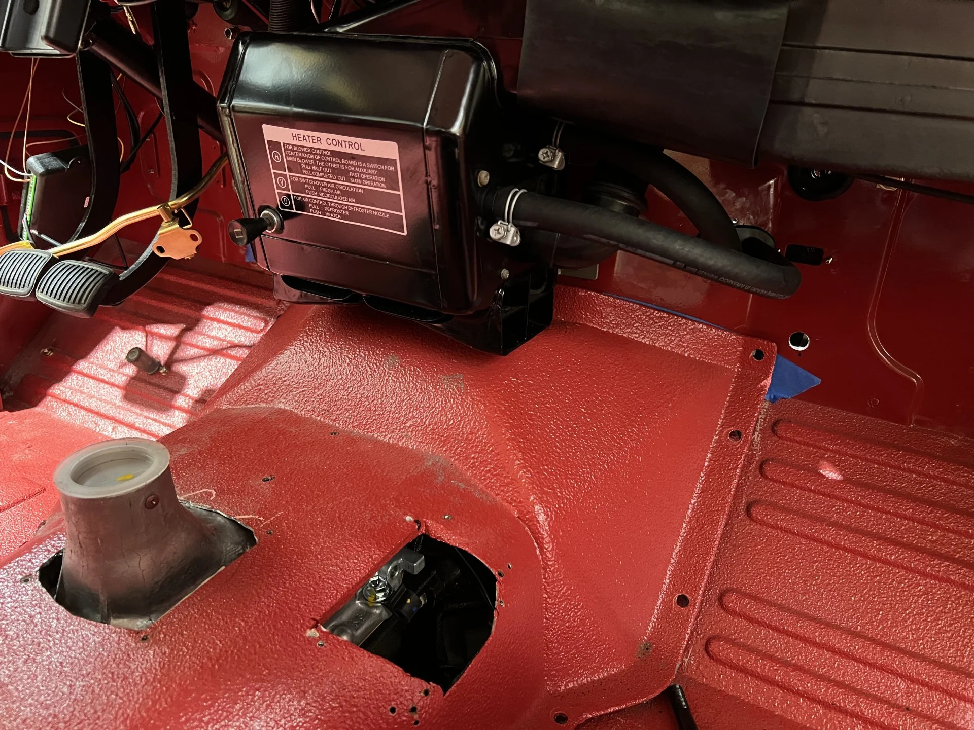

Was a bit tired for heavy work so I ended up installing the restored air l tube and knobs for the heater unit
They fit in 2 of the 3 AC holes. PowderKeg restored the knobs and duct for me

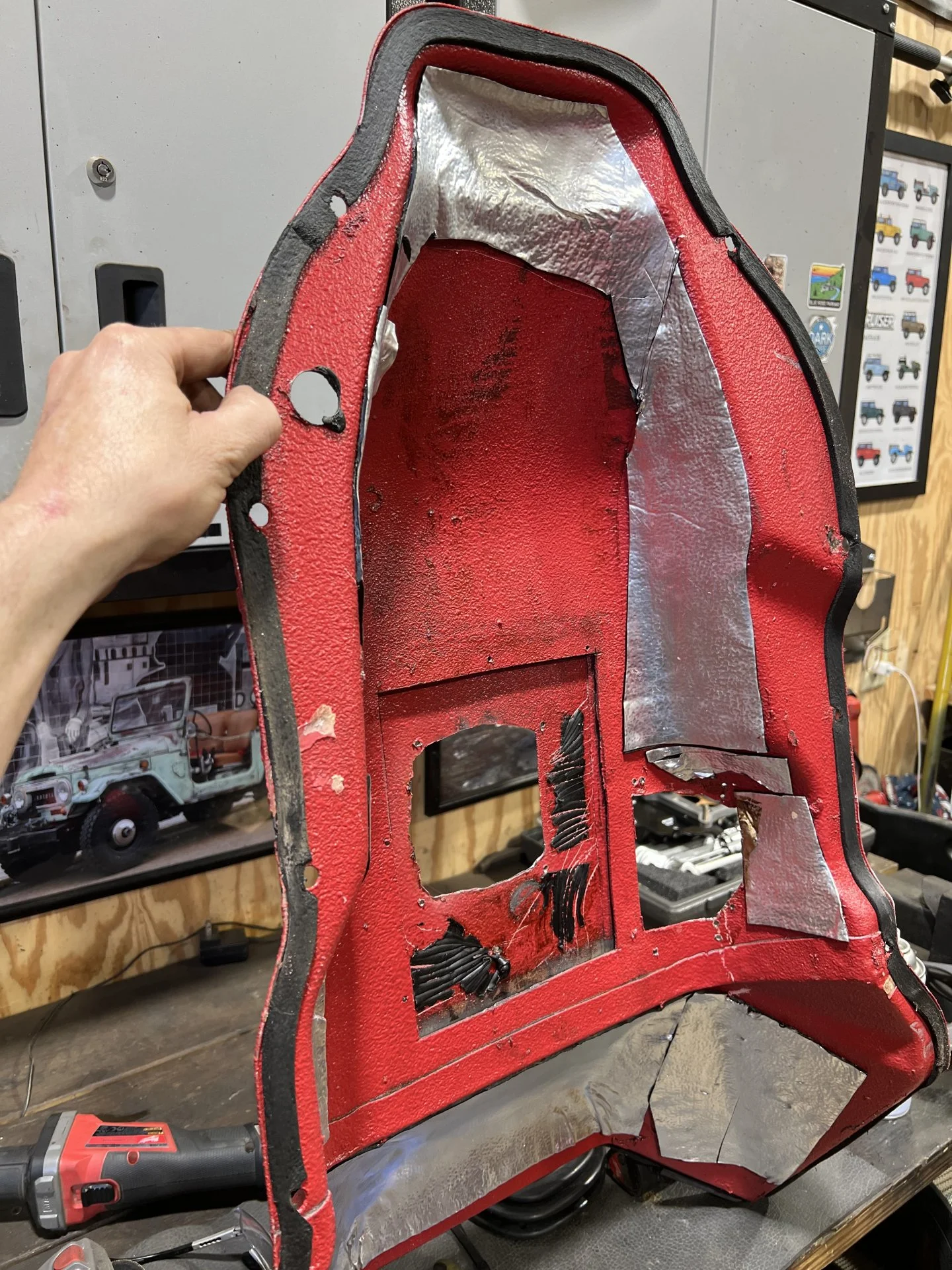

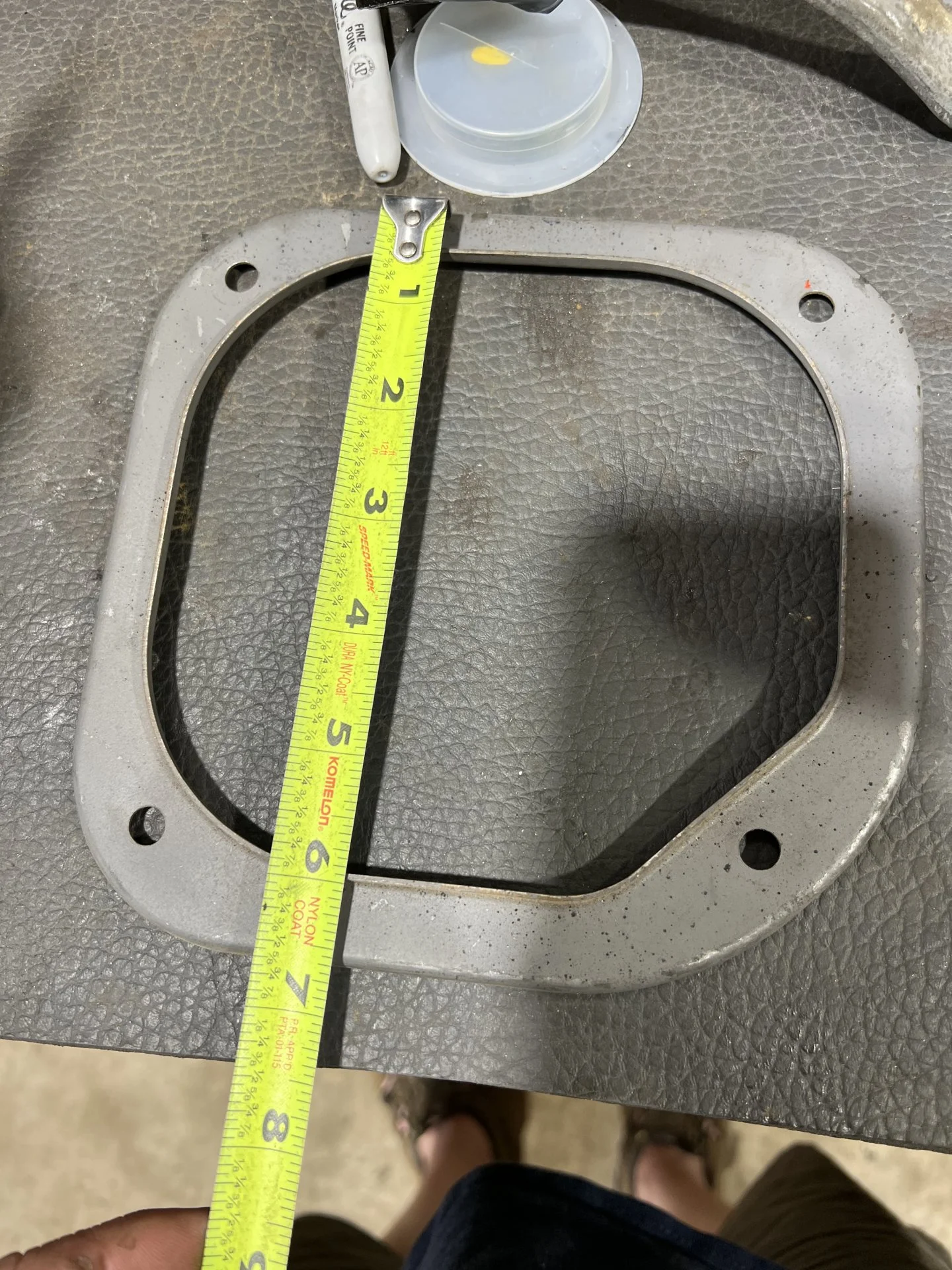

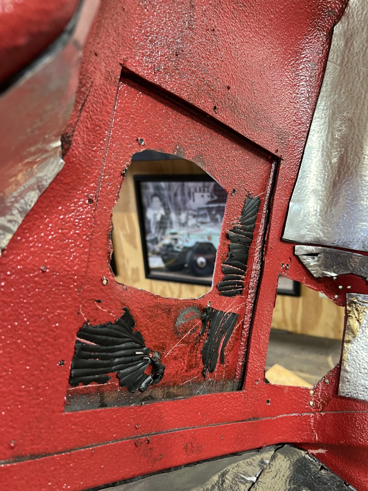

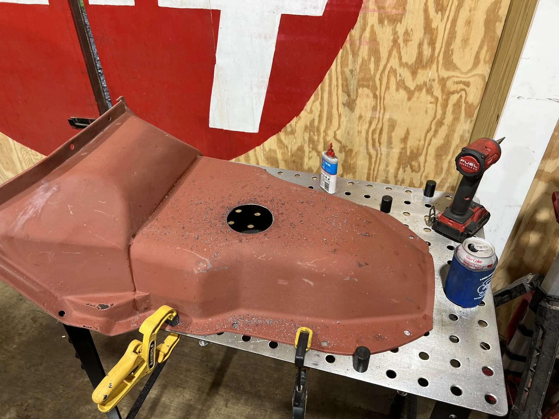

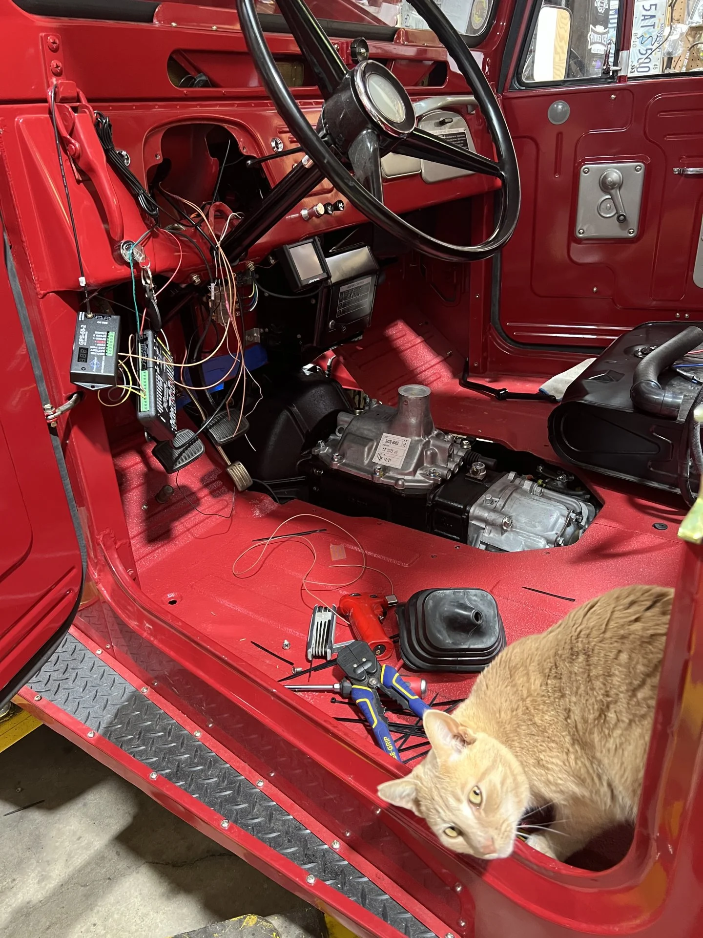

Then I broke out this tranny hump and commenced to making holes.
Once I got it marked I headed into the other shop for a hole saw and Cowboy was going nuts. Turned out she and a water snake were fighting. I took it out and again saved the day
Simple enough? That’s the way I always do it. No problem.
Except I’ve never installed an H55 into a 40 series……

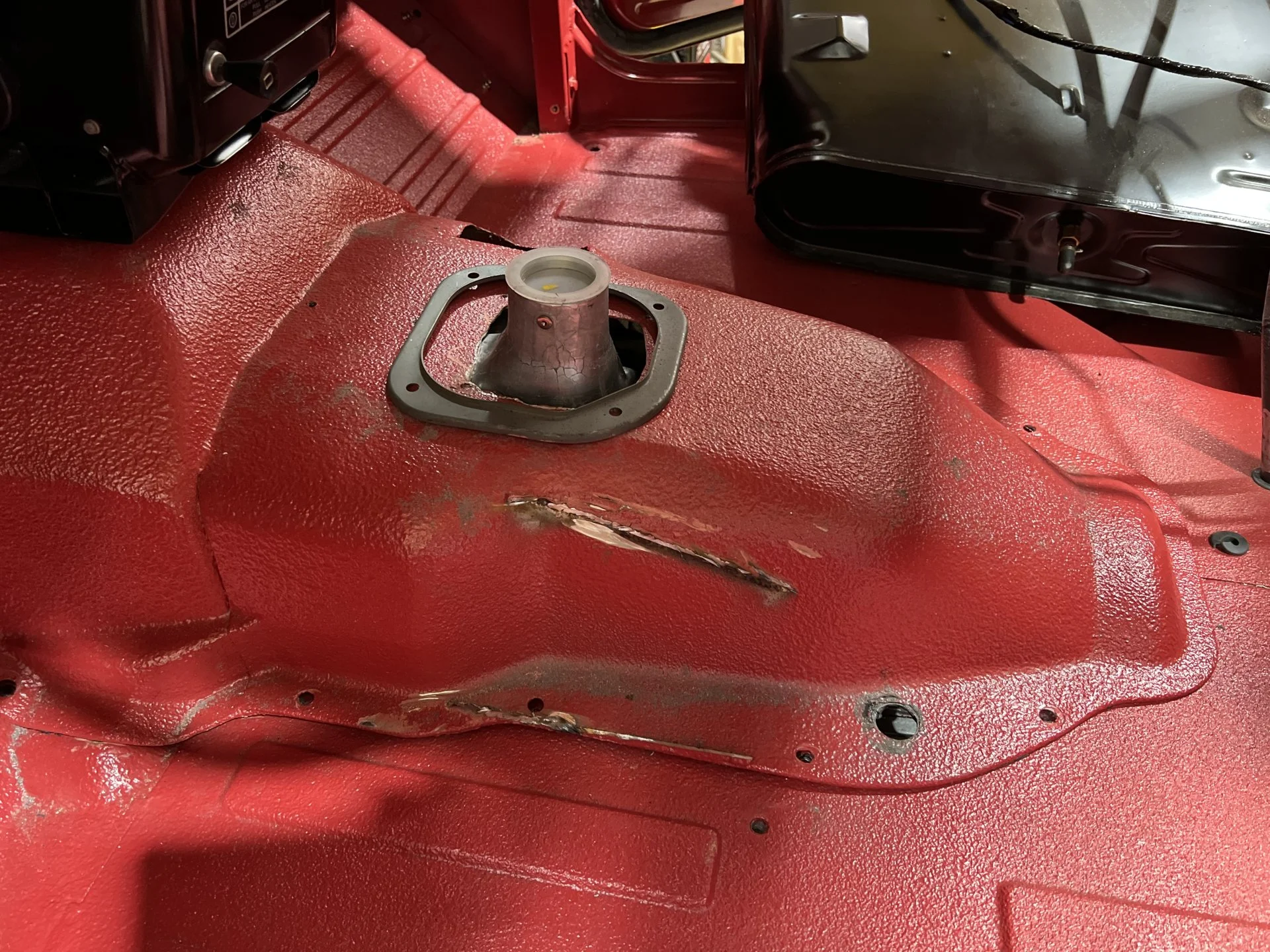

Welp. That’s a lot of hole to fill even with a 60 series boot

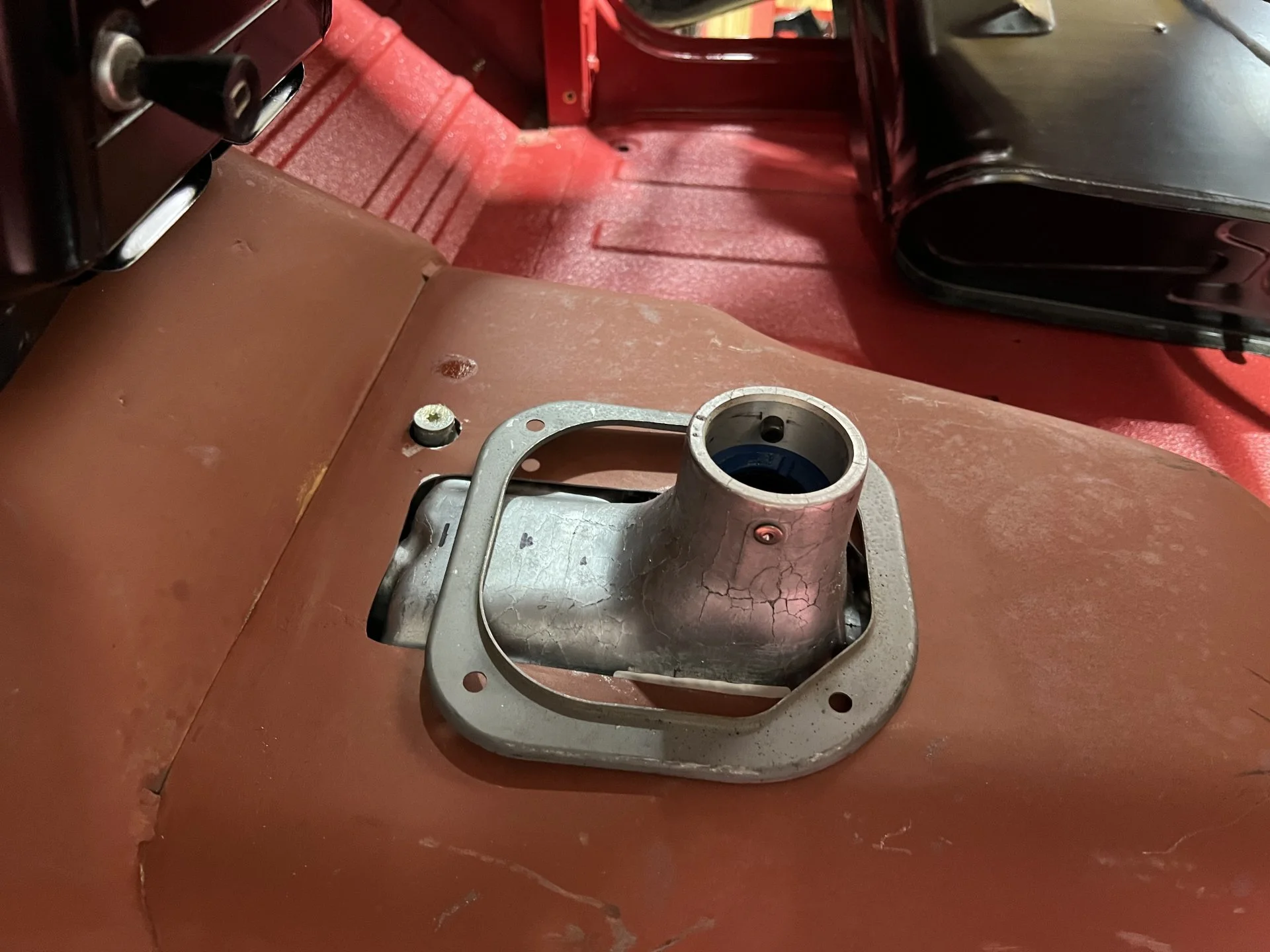

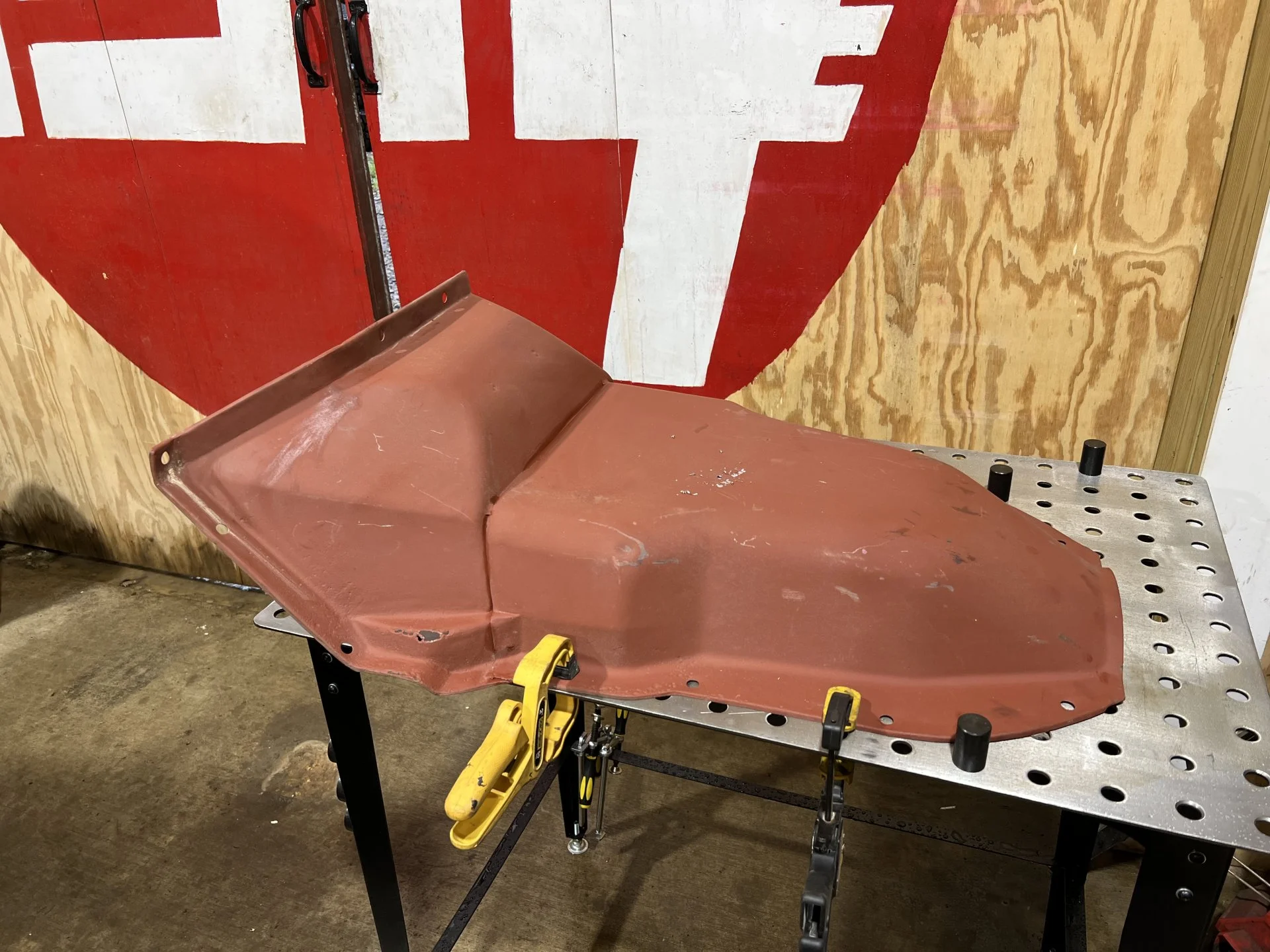

So then I remembered there was something really goofy about the old tranny hump and that’s why I chose not to use it.
The goofy was my ignorance that JP had already dealt with the clearance by adding a
Raised section. It’s not quite perfect for the H55 but it’s a massive head start.
Learning as I go…..
My guess is JP @ClemsonCruiser only does something “goofy” out of necessity.

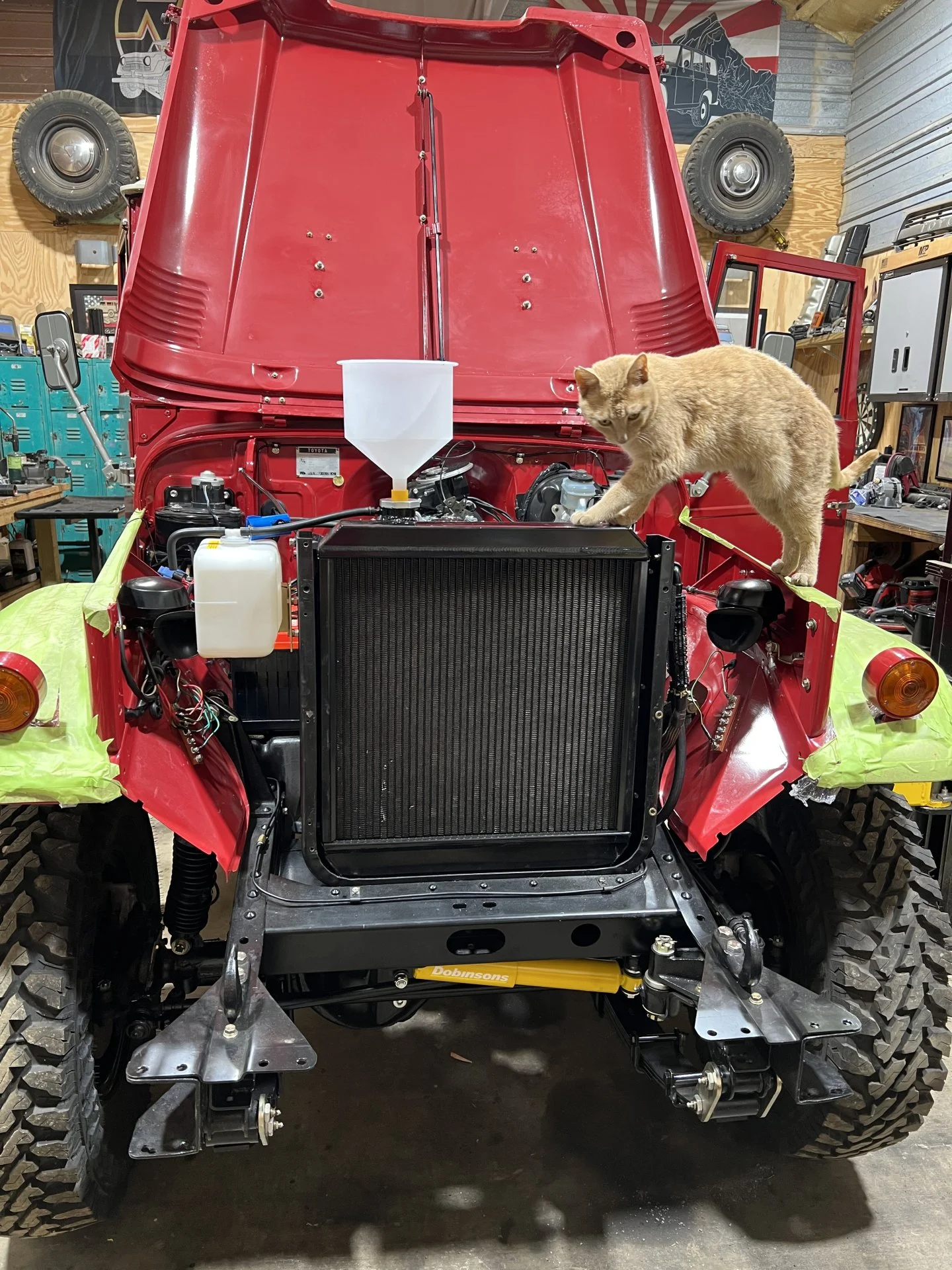

Next….I decided to plumb the cooling system to check for leaks.
Nothing was leaking in the engine which is always a great thing and then I saw some coolant dripping way back where nothing could possibly be.
The damn heater core has a hole in it and it filled up the cab of the truck and was dripping out of a drain plug.
Fuuuuuuuuu I hate coolant messes.
For now I bypassed the heater core and will deal with it later. Time for Easter lunch.

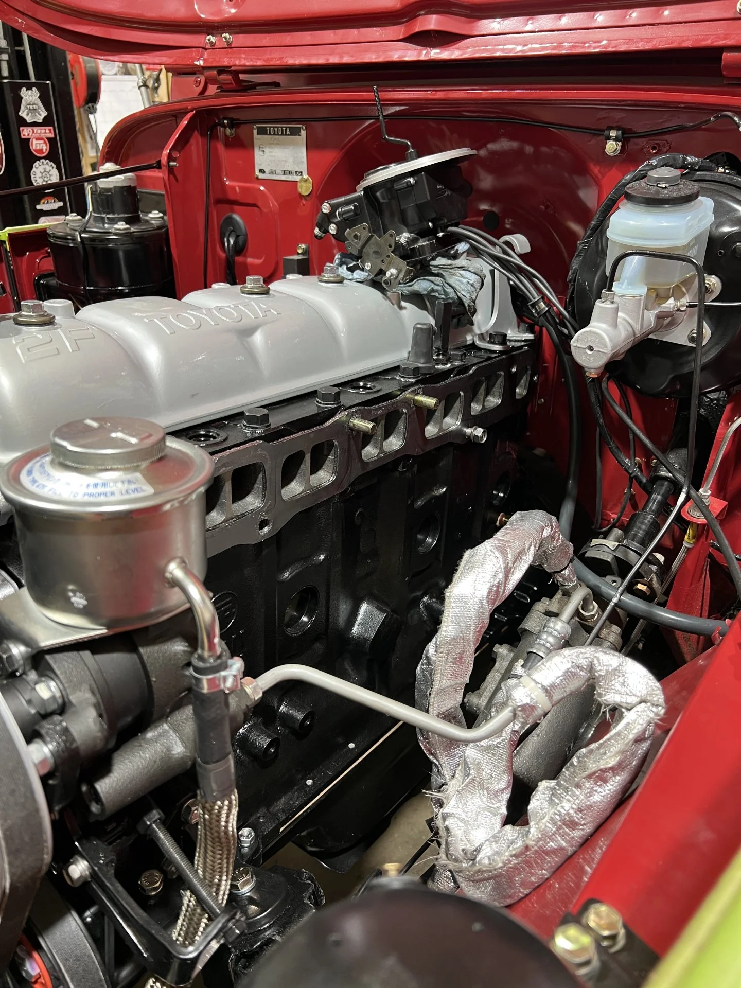

After lunch I started bolting it back together and plugging in the wiring. Slow tedious non exciting stuff like bleeding the steering system takes patience but will pay off when it cranks up the first time.

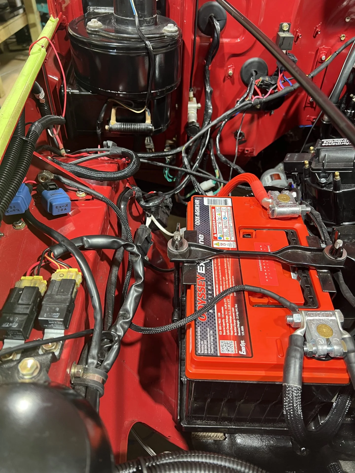

Wiring. Wiring.
Looming.
Tucking.
Spal fan. Sniper. Koito H4s.
Lots of wires. This looks like chaos but it’s all where it’s supposed to be.
I pulled the plugs and spun the motor over today to get some oil in the right spots.
