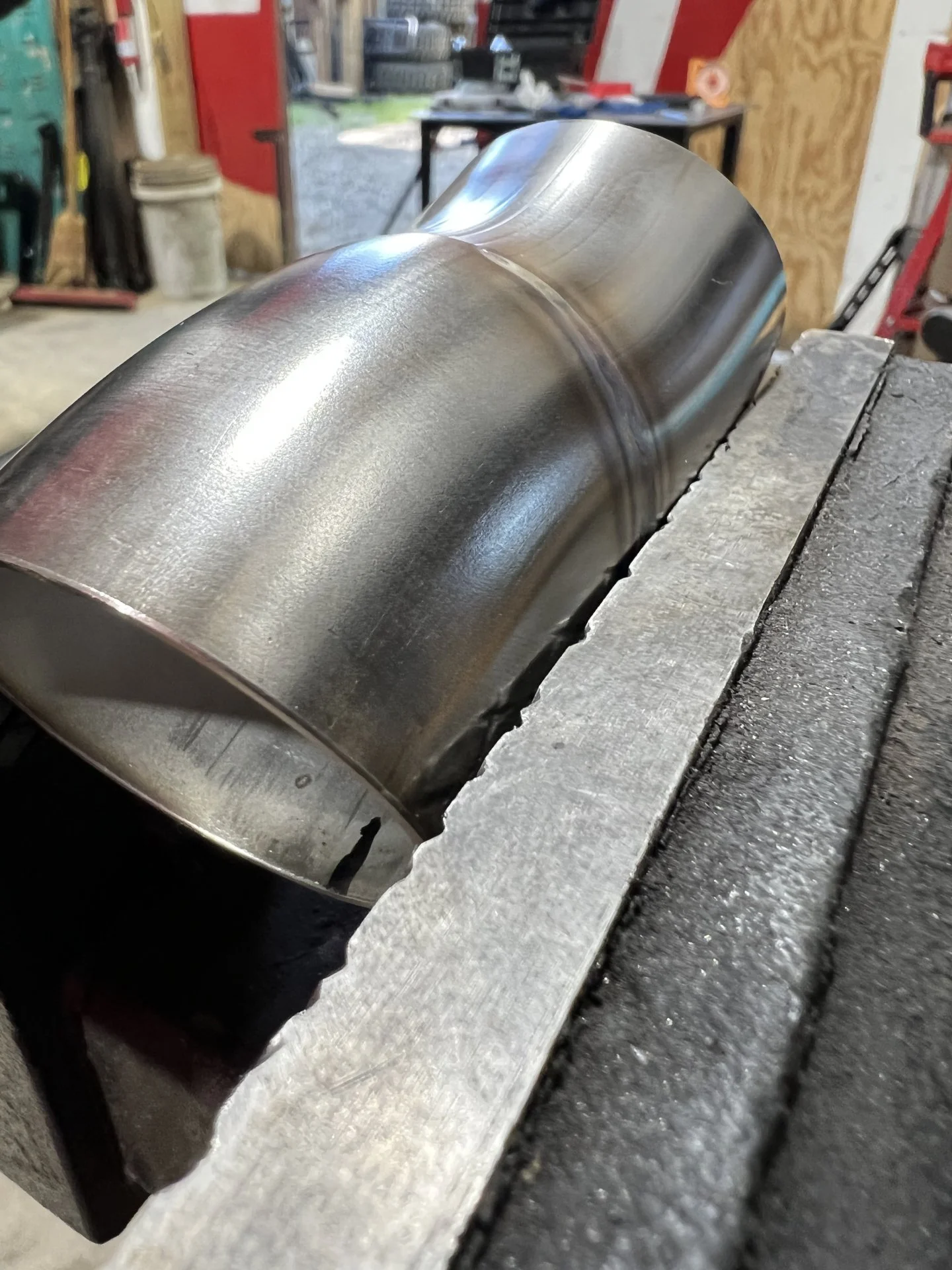

I had to pay my Wizard tax this morning. He’s been bitching up a storm about my cheap 6” vice. So I went for an upgrade. He also yelled about not having dedicated nut drivers

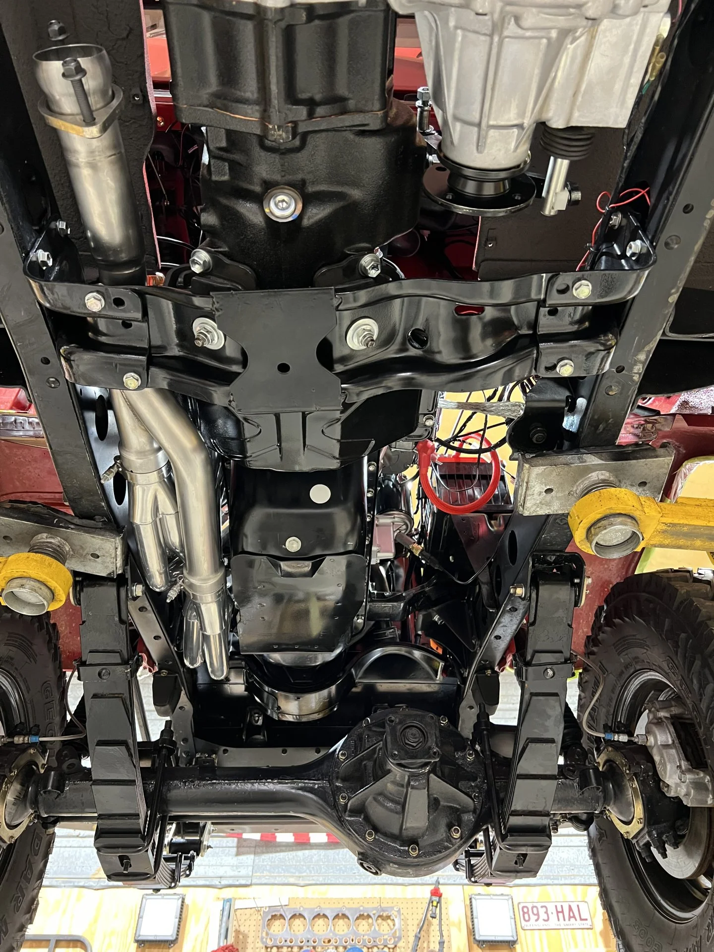

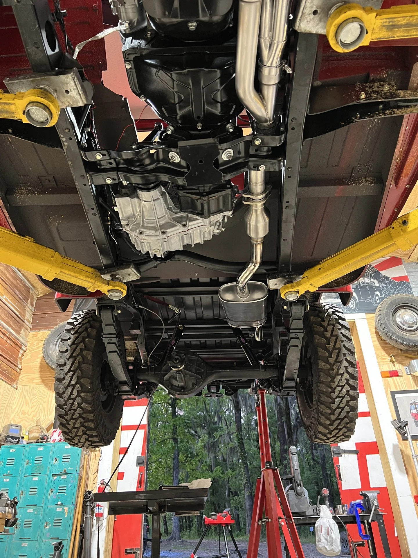

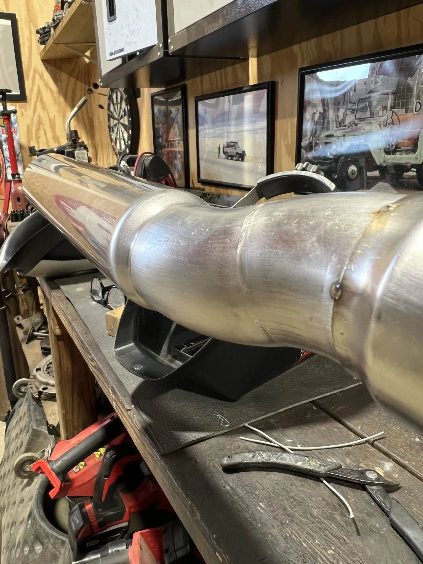

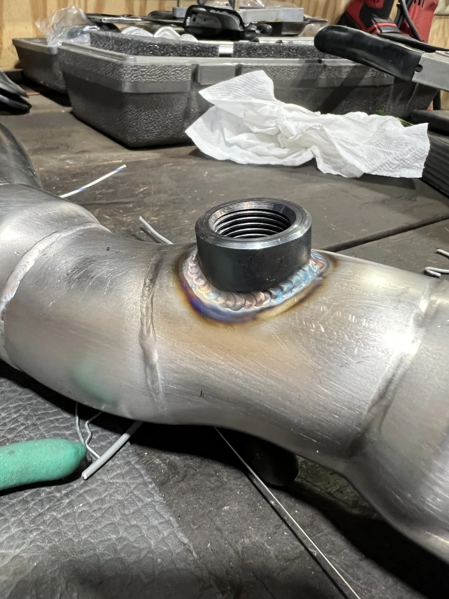

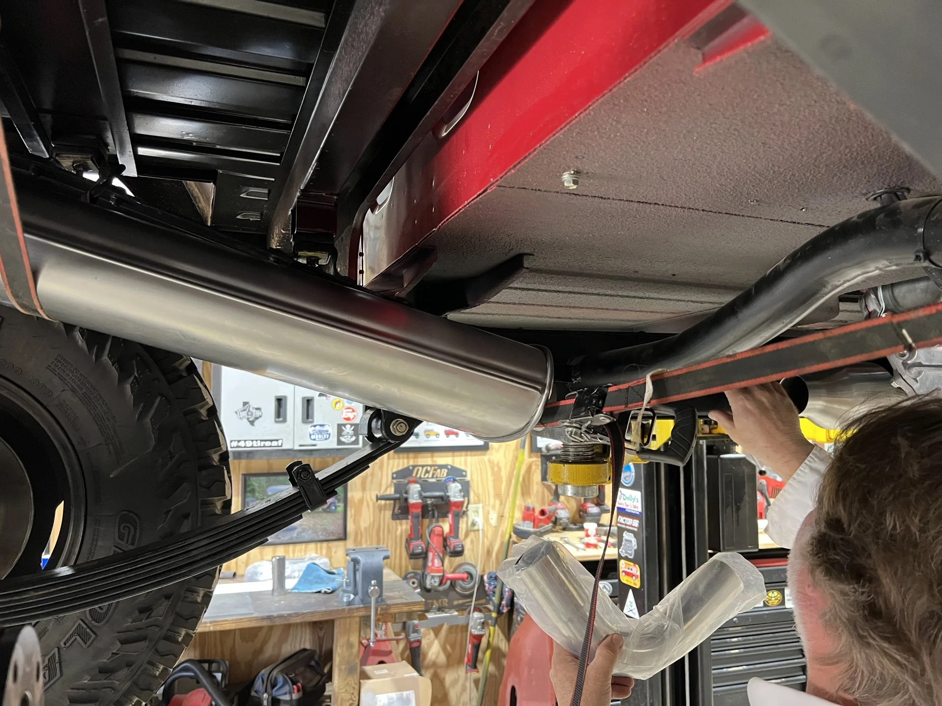

I did not get started until noon today and was in a race to get the new Remflex installed and then torqued it all back up at 20 foot pound
Sniper back in place

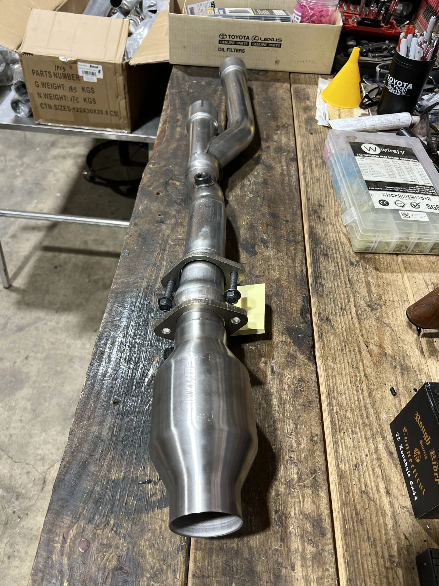

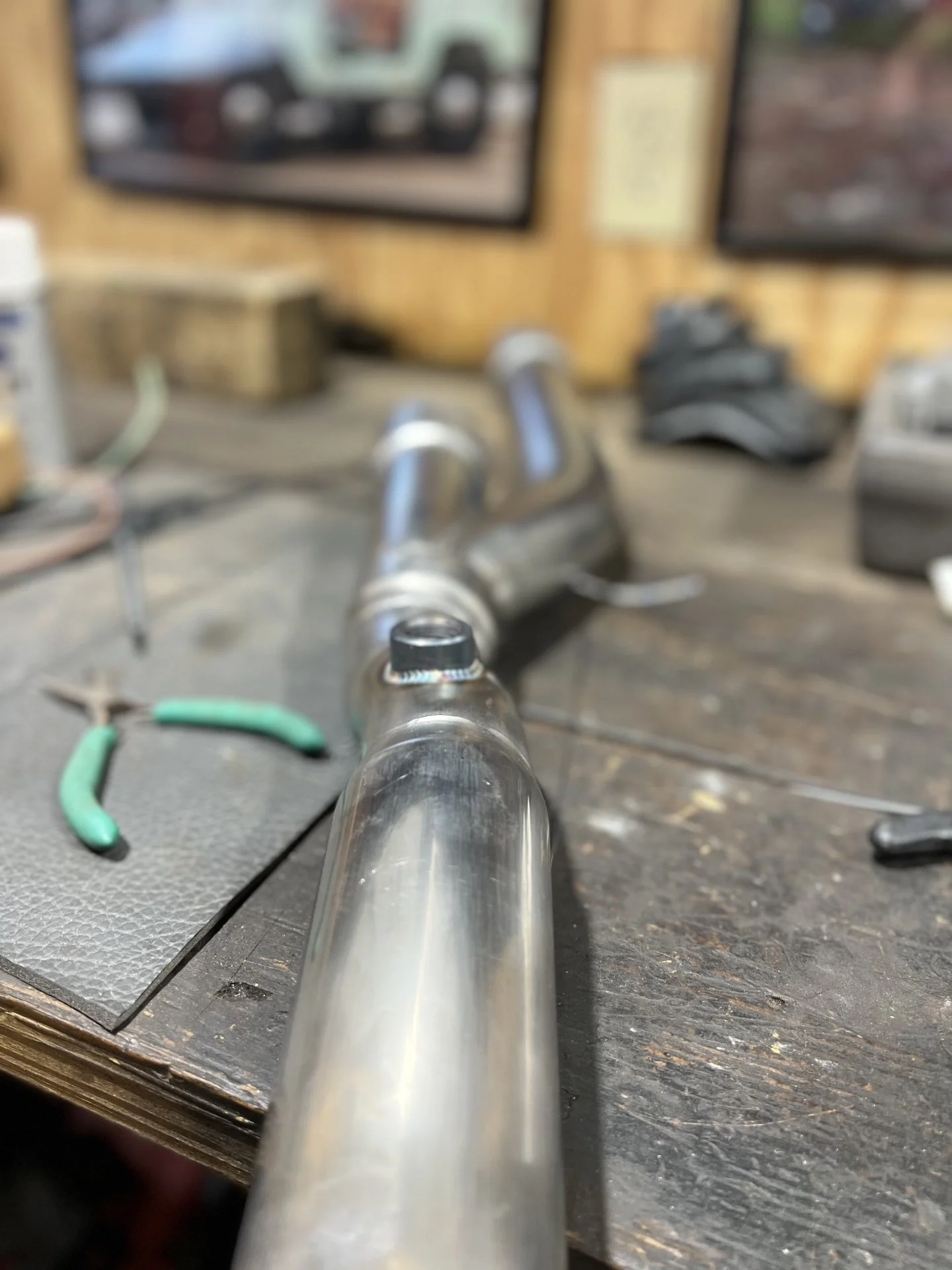

Then we got the y pipe permanently installed
100% guaranteed they both yelled through it to test it out :grinpimp:
Wizard no likey v-bands, or just prefer flare flange because he has the tool?
I like this style myself on an off road vehicle. They are expensive but easy to deal with.

Valley Hybrids sells a backing plate eliminator and the SS lines. I did not do this one but I’ve done it down the drivers side and across the firewall upgrading.
I would mock a 74 and go to the drivers frame like this. Easiest.
I see what you’re thinking. I guess they could give some wiggle room if the exhaust takes a blow. Never thought of that. I would think you meant inexpensive though?
V Bands are great if you have to take the exhaust off a lot. I used them in my tube buggies. This style gives it a more utilitarian look without worrying about another gasket.
And the 304 Stainless kit like this one is $175 via Summit so no, I meant these are expensive
Is that a resonator or universal cat behind the Y?
