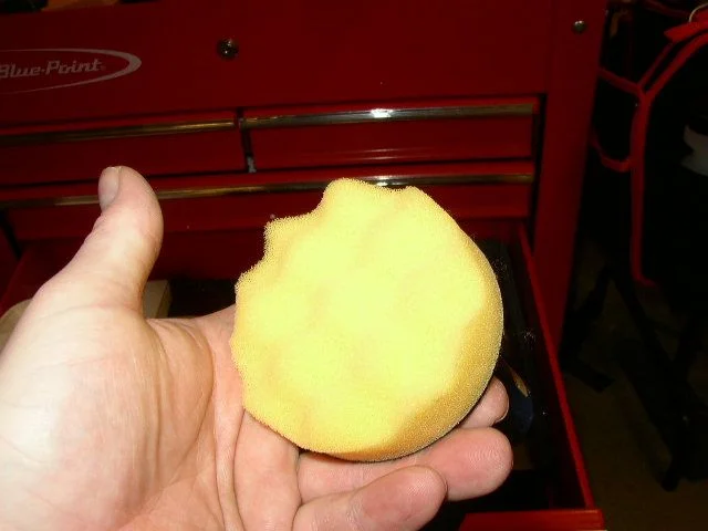

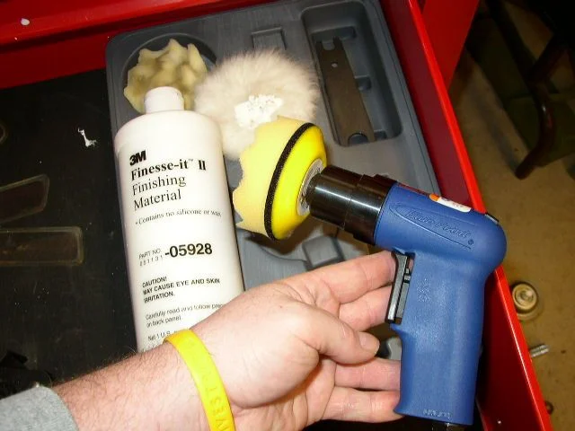

I don't paint and I won't pretend to even know anything about it. But I am the best wet sander and polisher I know of.
These micro fiber towels are the best I have use along with NEW cloth Diapers, they sell them at costco.
I also have a rockin 3" buffer from Snap-on. This thing is the best on FJ's around the hinges and tight areas. The pads are spendy and if you can get the pads from your vendor (I want all I can get) or from your Snap-on dealer you are welcome to use it.
I cant stand air 9" polisher. I have to use a Porter Cable electric.
If you have never used waffle foam pads for polishing, BUY THEM. They come is serveral sizes of cells from large (cutting) to fine (polishing) you will never use wool again!!!
I use 3M and it works great on clear.

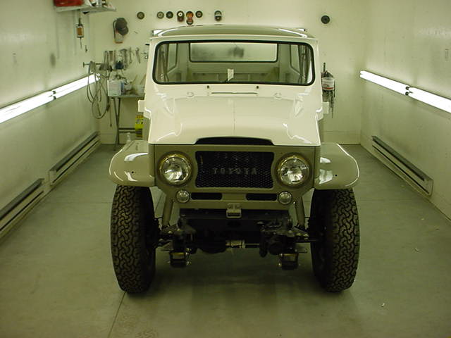

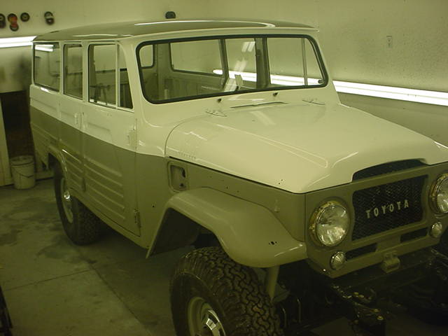

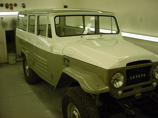

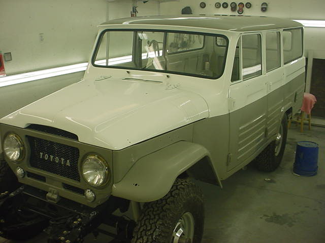

No leaps and bounds today on the lv. Didn't try to hard today, but got some stuff done.
I pretty much got up in the morning and started pulling paper and tape. That didn't take to long. Since I had a mess going with tape and paper I decided to clean up the shop and booth a bit.
Few pics of the lv after I pulled the paper. If you look closely at the last 3 pics, you will notice the paint is duller on the roof, hood, fenders and doors in the big open areas. I spent about 4 hours on the lv with 1500 grit wet sanding all those areas, took some time and I am getting really sick of sanding now. Paint actually was pretty smooth and nice, but I thought I would take the time and color sand it out......just to make sure it was like a mirror :D
Decided to call it a night. Probably going to start buffing tomorrow, hopefully if all goes well I can start bolting parts back on around Tues. or Wed.
