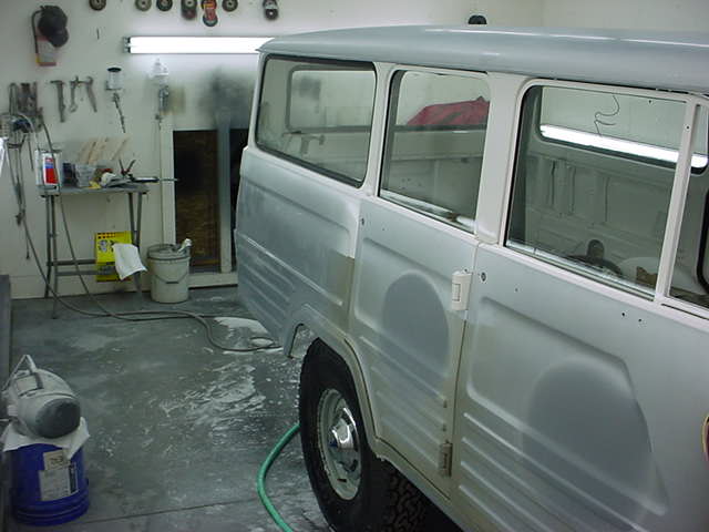

Not much done on the lv this evening. Had to work all day, so by the time I got home, only a couple hours. My new home computer also showed up on Friday, had to spend some time this eveing getting this bad boy up and running.

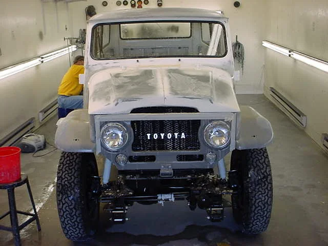

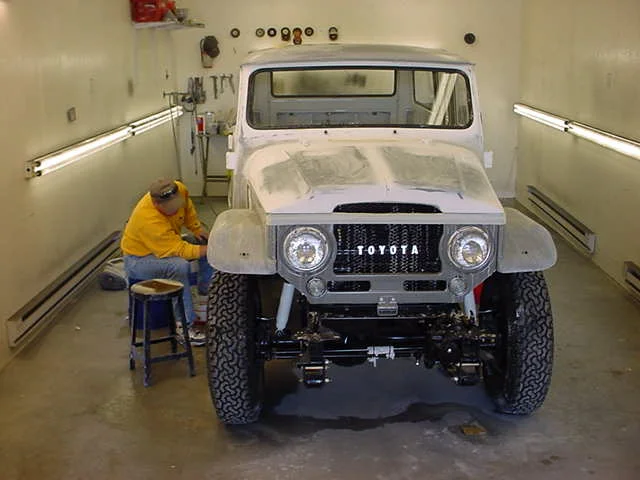

Had the neighbor come over and give me a hand pushing the lv in the booth. I had to tape off the entire vehicle below the drip edge. I wanted to shoot a couple coats of epoxy primer on seam sealer I applied a coule days ago.
Anyway, got a couple coats of primer on, shot of the beast in the booth this evening. Should be able to start wet sanding tomorrow night.........

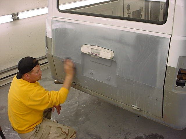

Got a good couple + hours on the lv tonight. I had my buddy, "Broncoabandoner" over this evening to give me a hand again ;)

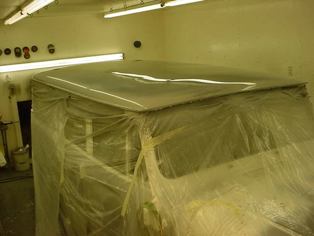

We started on the roof, both took a side and sand it down with 400. Actually went pretty fast. Wiped it down with soap and water after we were done sanding and hosed it off.

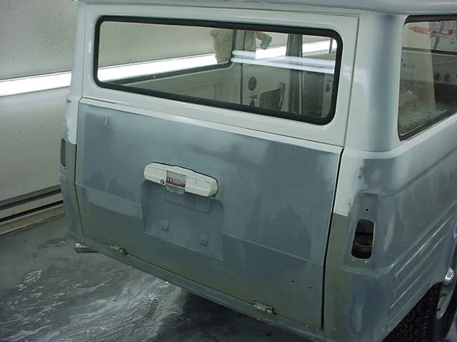

We then started on the tailgate and moved into rear quarters up to the rear door jam. All went good, there are a couple scratches that popped up that will need a couple shots of primer. No big deal, going to do that in the morning and keep on wet sanding.
Got a couple days off work, buddy is going to swing over tomorrow and give me hand. I'm hoping we can get the majority of it knocked out and done tomorrow.
Matt

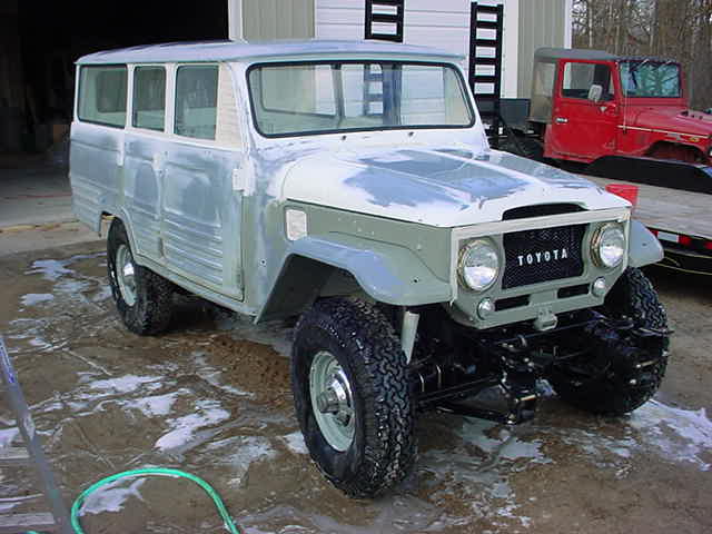

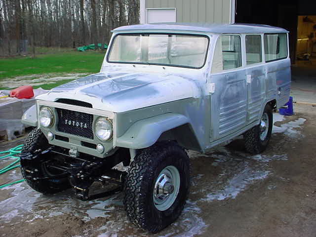

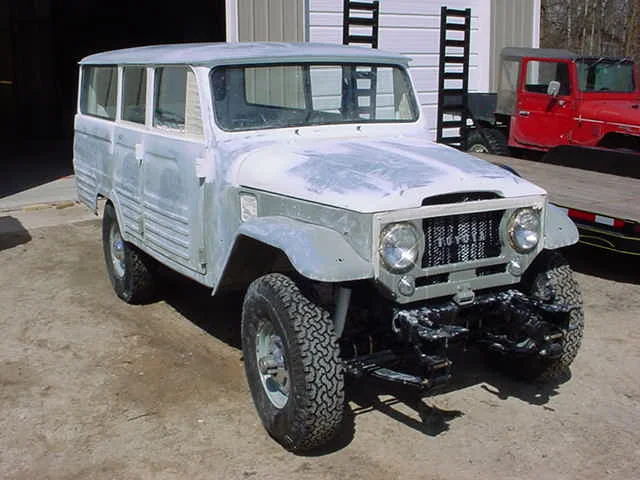

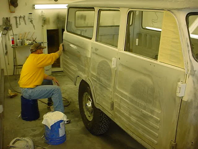

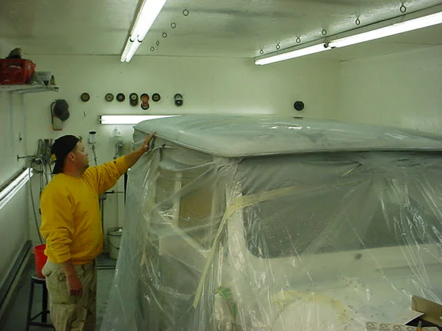

Pretty long day on the lv today. Had my buddy broncoabandoner over again. About a solid 8 hours each, total 16 hrs wet sanding today.
Doesn't look like much, but a few shots of it in the booth and my buddy sanding away ;) It got pretty nice outside today and we had a lot of hosing off to do, so we rolled it outside and did more sanding.
On my own tomorrow, more sanding to do, but I think it's looking pretty decent. The plan is still to have my autobody buddy to come up this weekend and hold my hand while I paint ;p Also to make sure everything is to his satisfaction. If it isn't to his liking, no painting.

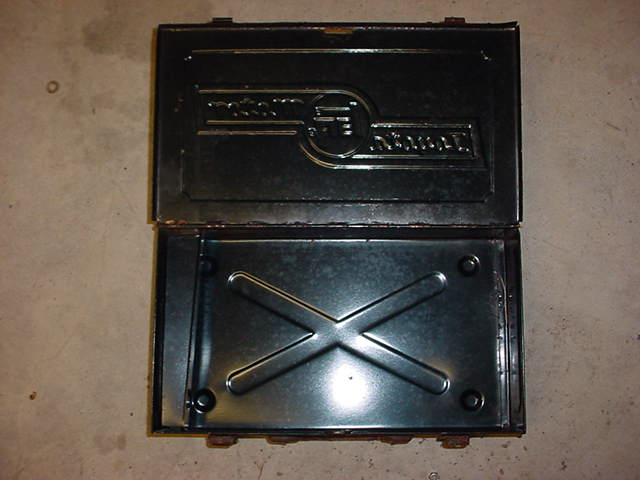

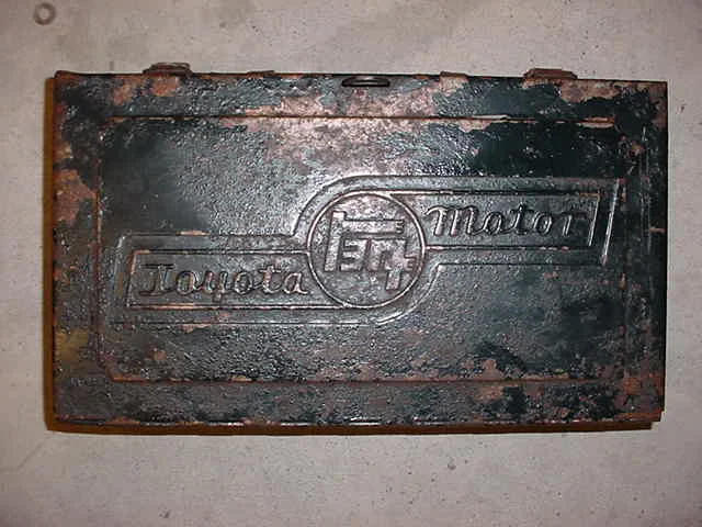

The first couple pics are of a Toyota tool box, at least that's what I believe it's intended purpose is? Henery C. (Exiled) sent this to me... He emailed me a couple weeks ago and asked if it would be something I would be interested in.......mmmm...ya..of course I'm interested :) He explained his reasons for emailing me and thought that my lv would be the perfect fit for something like this, and he had been waiting for an opportunity to do something with it. He didn't even give me a chance to buy it, he just offered it up as a gift.:)
Henry just pretty much wanted me to restore it and display and use it properly with my lv. As my lv gets closer to completion there will be more pics of me working on this box and more pics of it in the lv :D Thanks again Henry :) :beer: :beer: :beer:
